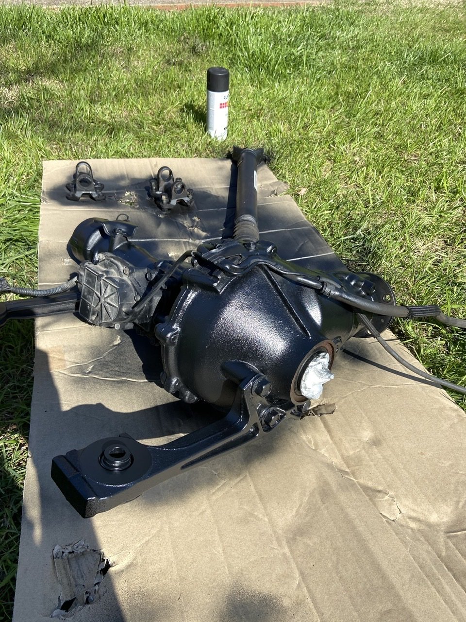

    Collecting dem parts
    This was probably the hardest and most time-consuming part of the build for me. I would recommend buying the major components first, inspecting the seals and any accessories it came with, and then order the smaller components referencing a parts diagram (included below) once you know what it did and didn’t come with. Example: the front driveshaft I ordered came with the nuts and bolts to connect to the front diff but did not come with the nuts and washers to connect to the transfer case. I had to order that. All prices below include shipping and tax to give you an idea of what to expect. I spent more than most do because this is my daily driver and I wanted parts that would last longer (low mileage transmission, brand new oem cv axles, etc).

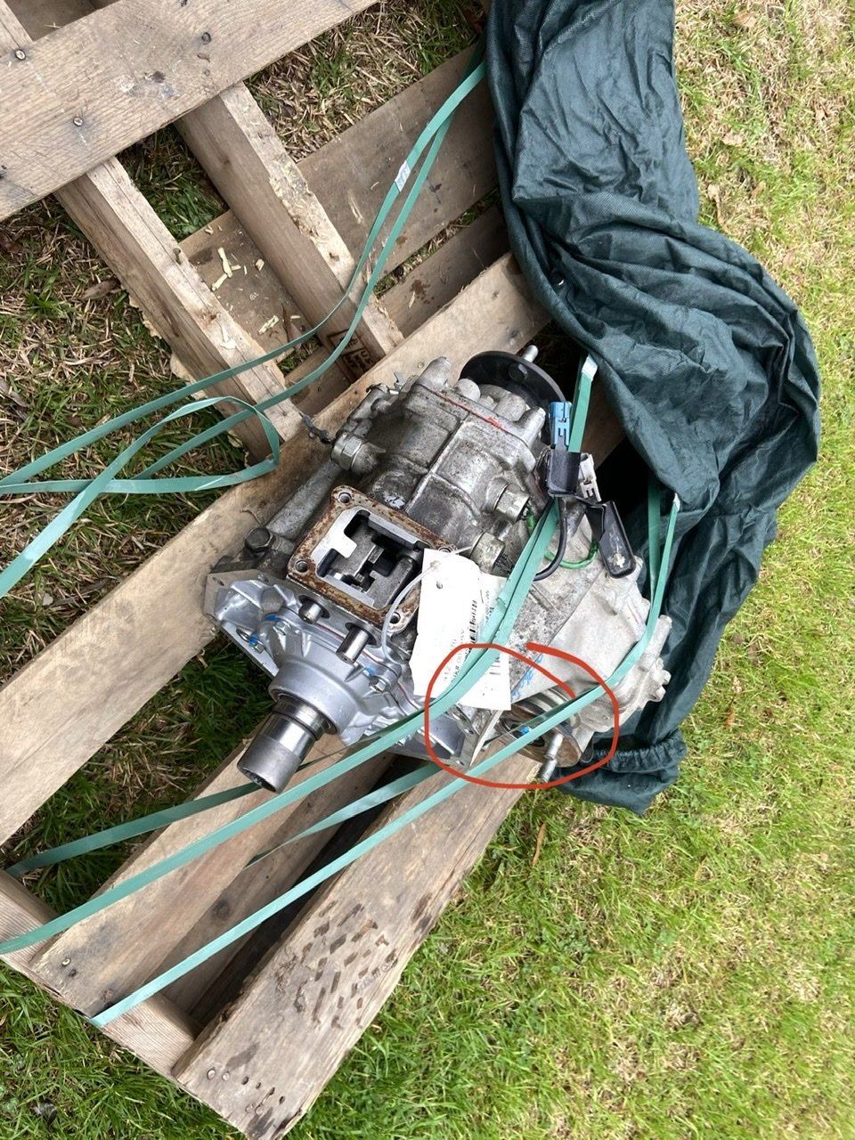

    • Front differential 3.73 gearing $315: benzeenautoparts.com. Mine was from an FJ cruiser, make sure you get one that comes with both front mounting arms AND the rear mount. Mine did not come with the rear bc I did not realize there was one (I know I’m dumb) and I had to order. Also, make sure it comes with the actuator and both breather hoses75BCC108-3A5F-43E0-8594-C443B782AC5F.jpg2EBFBD24-469D-4A06-BD91-EB7E04FB4D35.jpg
    • FJ AT Transfer case $451: benzeenautoparts.com. Make sure that it is from the automatic FJ. Also, make sure it comes with a shifter base and shifter. Mine did not but thankfully awesome people on TW exist and @Littles gave me his for free! He saved me hundreds, thanks again! You may need some 1/2 steel rod to reweld the shifter, more on that later.

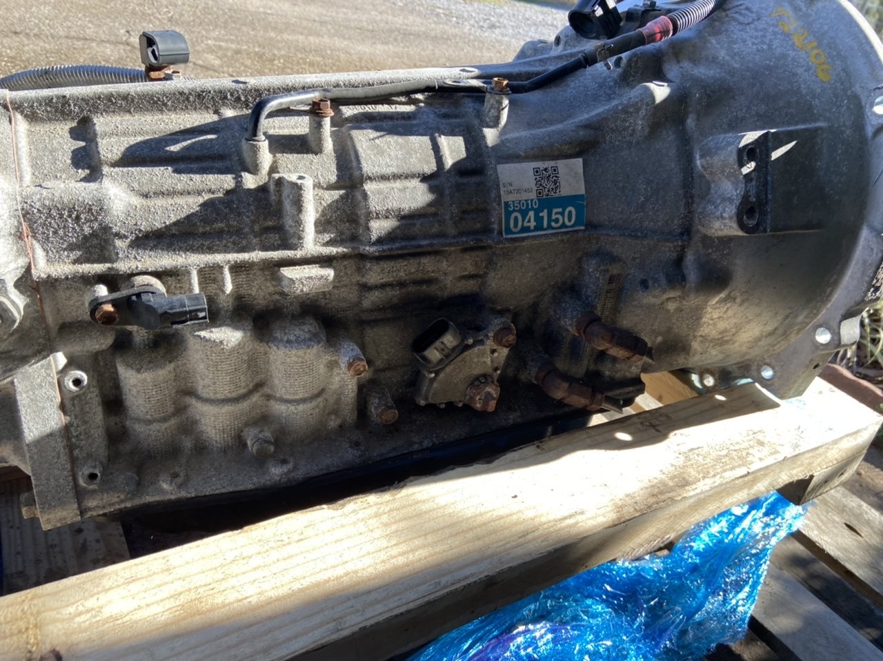

      • Trans had 55K miles on it. Make sure it comes with a 6-12 month warranty.
      • I’ve also heard of people converting their A750E transmission with an inchworm adapter but I could not find much info on that2F9BCF06-3270-40B1-9283-A186FC33C509.jpg
      • Make sure you get the correct one, the manual vs automatic front driveshaft vary in length and are not interchangable
    • Exhaust reroute $190: Shaundowntheroad.com :rofl:

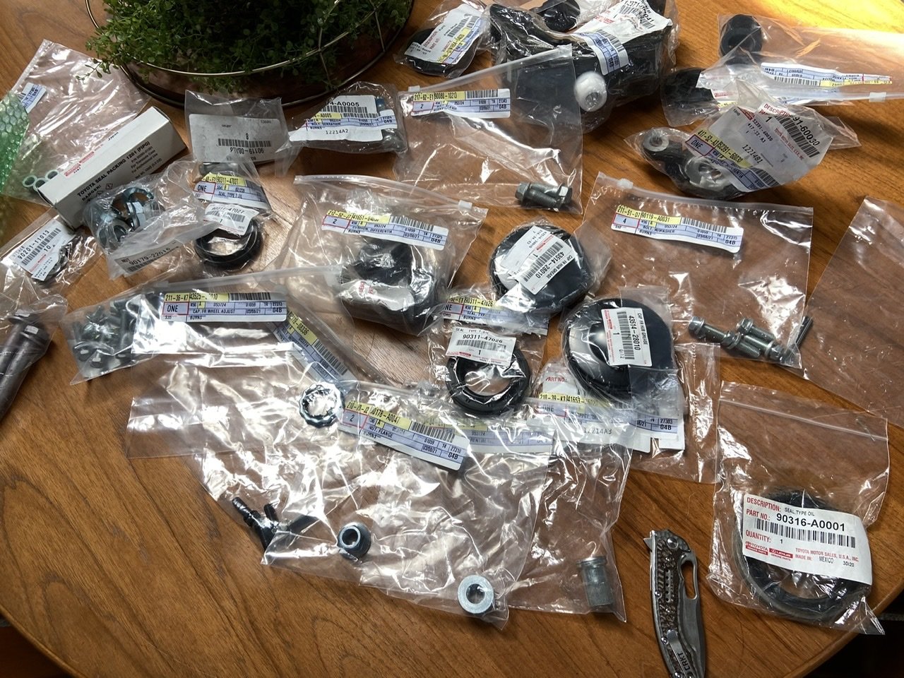

    • Mount, seals, and bolts direct from Toyota: parts.toyota.com. I’ll go over the main important part numbers you’ll need. There will be misc bolts and nuts you may or may not need

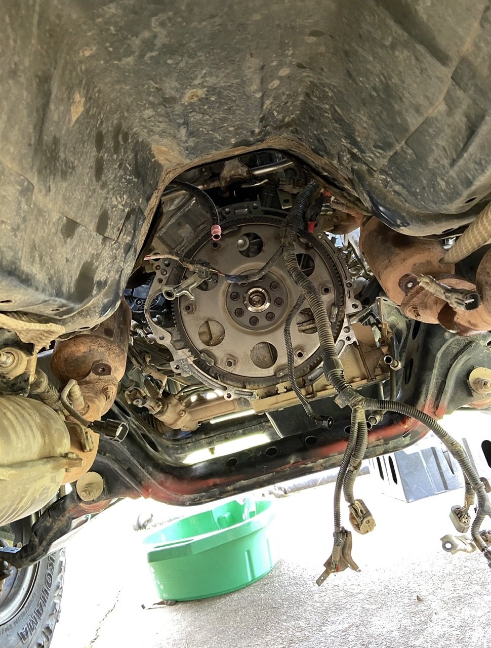

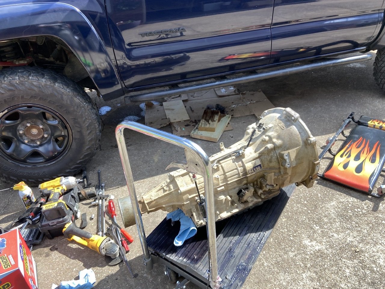

    Removing transmission
    1. Park on flat ground and CHOCK YOUR WHEELS
    2. CHOCK YOUR WHEELS again. A transmission in park does nothing for you with the driveshaft removed
    3. Remove rear driveshaft
    4. Disconnect negative AND positive battery terminals
    5. Disconnect oxygen sensors, electrical sensors, shifter linkage, trans cooler lines (if you have towing package), and breather
    6. Make sure the main harness is disconnected from the plastic holders on top. If you miss or cannot reach something, no worries, you’ll have another chance when you lower the transmission

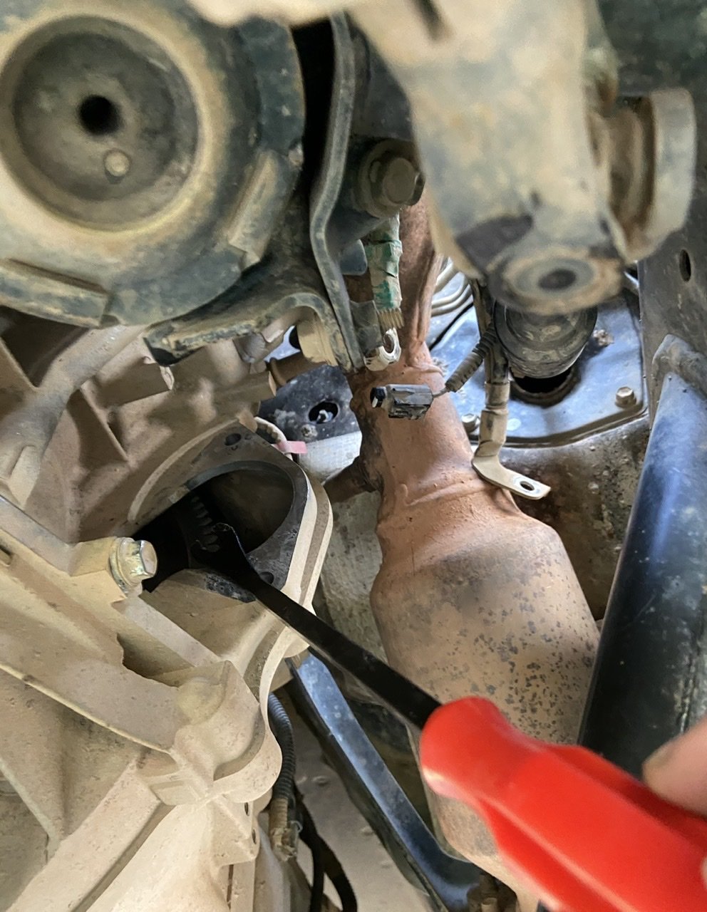

    7. Unbolt and remove the starter. You’ll need to disconnect all cables attached to it and the 2 bolts holding it to the transmission. Pro tip: it’s easier to get it out through the bottom rather than the wheel wellAA3C0D0A-FCDF-45D4-835C-714746A67D25.jpg
    8. Remove the plastic trim piece behind the starter, take note of how it is seated, otherwise you’ll spend 10 minutes trying to figure out which way it went. Trust me on this
    9. You now have access to the flexplate and the bolts holding it to the torque converter.
    10. There are a total of 6 bolts that MUST to be removed prior to removing transmission
    11. You will need to rotate the flexplate to gain access to each bolt. I used a plastic push button tool and a lot of ugga duggas to rotate it:curls:
    12. Becareful not to damage the teeth, I made sure my tool was seated well before applying force. This is why I did NOT use a flathead screwdriver, this tool hugged the teeth and did not slip off easy
    13. Once the 6 bolts are removed, the torque converter should spin freely behind the flexplate. That’s how you know it’s ready to be removed6BD493B2-BAD5-43AB-89E0-8DA8B8616A7C.jpg61A226DE-818B-4607-85BD-B1C39E8ACF24.jpg
    14. Remove the 9 bolts holding the transmission to the engine
    15. To get to all 9 bolts, you’re looking at 3 to 4 feet of extensions to get to some of those bolts
    16. Get far behind the transmission and try to find the bolts. It’s helpful if you have someone else to guide the socket in the front while you ratchet in the backA9476880-CEBA-4A3F-BF45-CD546B806289.jpg
    17. Position your transmission jack (hydraulic 500lb harbor freight table in my case) and strap down the transmission to it
    18. Make sure the weight of the transmission is supported by the jack
    19. Unbolt transmission isolator mount
    20. Unbolt and remove crossmember
    21. Remove transmission
    22. It may take some wiggling and pulling. In my case, I used an ATV winch for some help (this aint a toyota dealership, it's my driveway lol)
    23. Unplug any wire harnesses you may have not been able to get to
    24. Take a break, have a cold one:drunk:108E55E6-7481-4033-A54E-9A617EEE006B.jpg

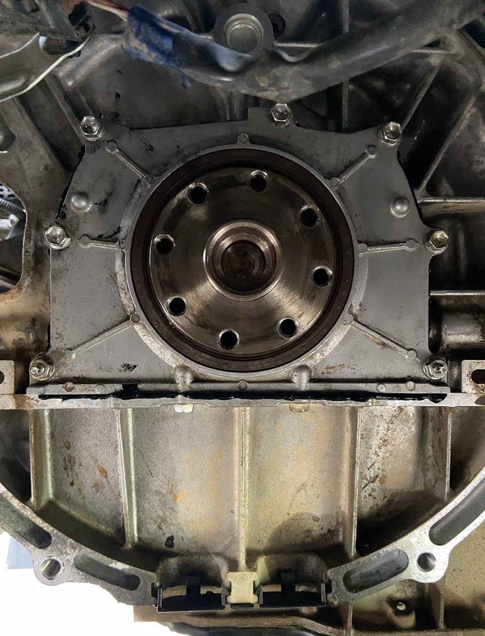

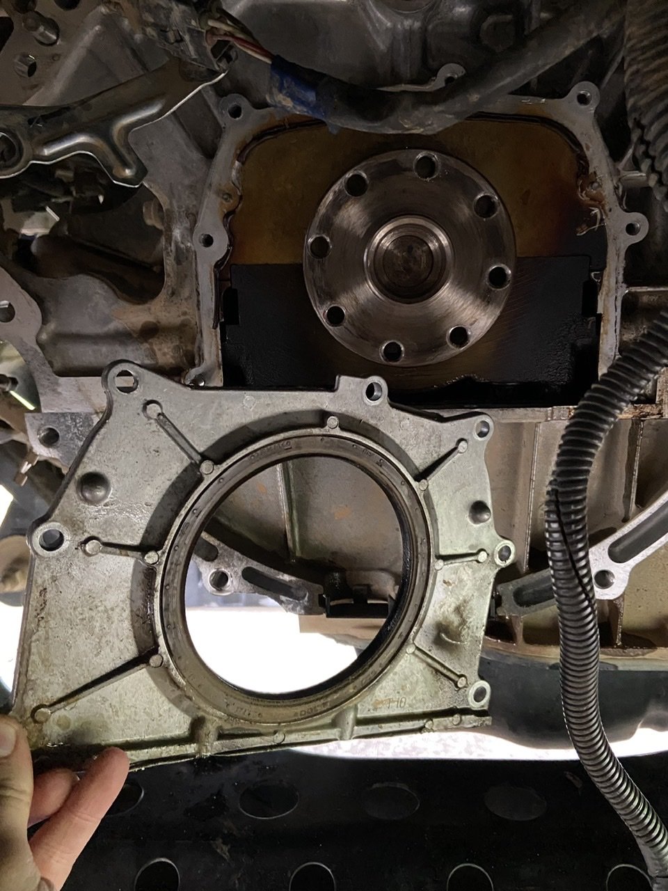

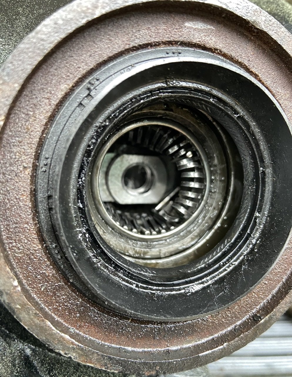

    Rear main seal
    This is a perfect time to replace the rear main seal. You will never get a chance like this again to replace it, may as well. This is a great video I referenced for my seal change https://www.youtube.com/watch?v=HiSnW_JWBhA&t=299s
    1. Remove flexplate. It will turn as you try to loosen it. I stuck a bolt in the empty torque converter bolt holes and jammed a wrench in there to provide resistance5D957D9C-EB29-4661-9114-C061EA643AE7.jpg
    2. Remove rear main seal cover. Some people skip this and use a seal puller tool, I found it easier to remove the cover53B62F4E-F84A-49D4-8803-96F6ECDFC069.jpg
    3. Pop out old seal
    4. Clean up the cover with brake cleaner
    5. Install new seal
    6. Make sure the flat side is facing out
    7. Make sure the surface is DRY, that’s what the manual calls for
    8. I used a piece of wood and evenly hammered the seal until it was flush
    9. Remove old gasket material from where the seal cover was on the engine
    10. Install black Toyota FIPG around the cover
    11. Lubricate the inside of the seal and the crankshaft with motor oil to help it slide on
    12. Reinstall flywheel, torque to specE8BF0DA9-1BA3-4441-98D5-6F0F0BD839EF.jpg

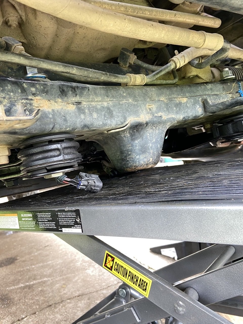

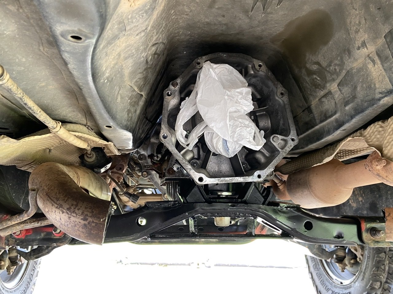

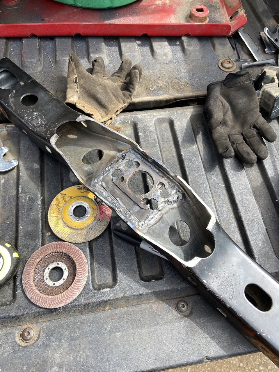

    Crossmember

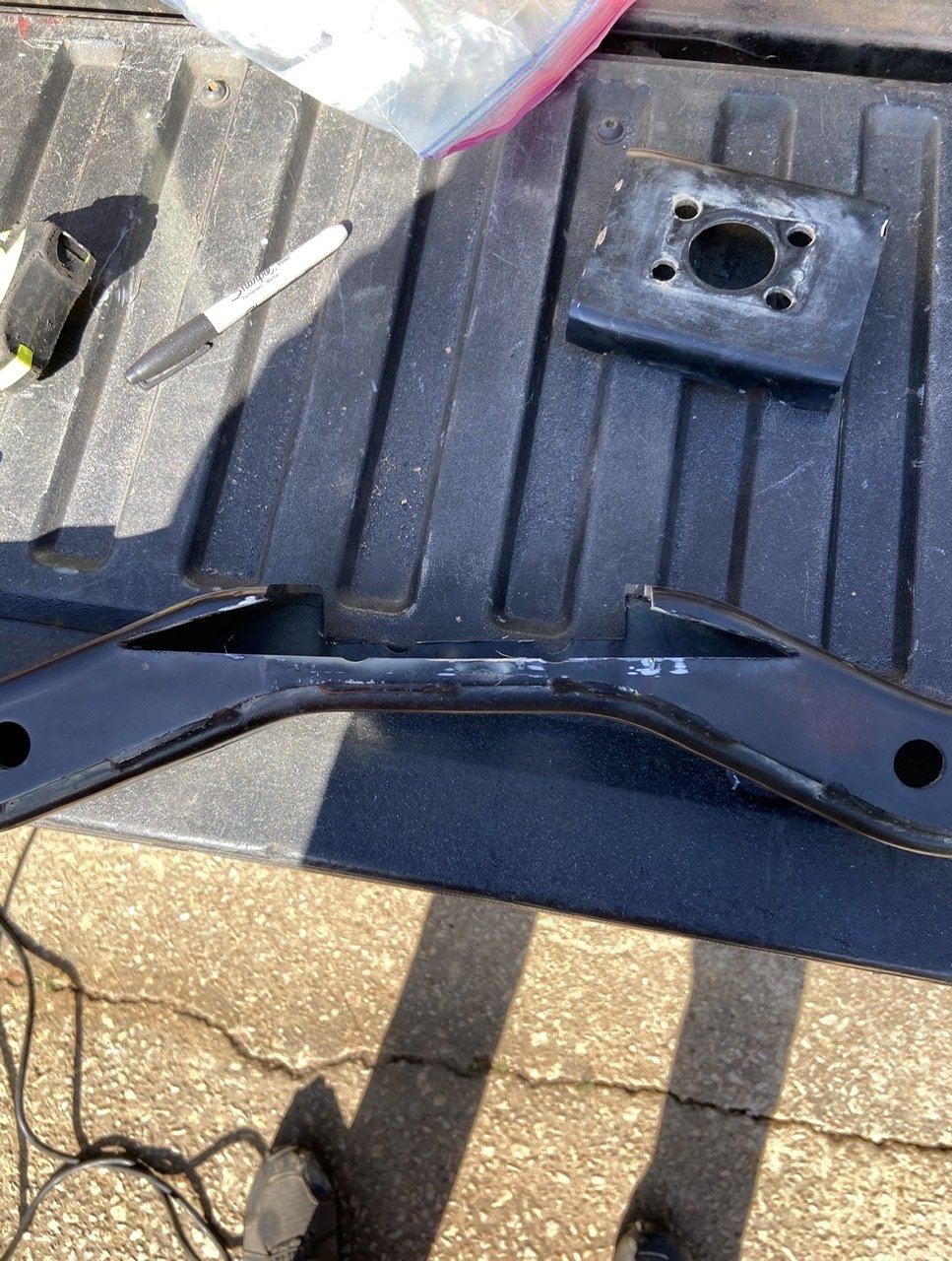

    Definitely the most technical part of the build. You will need to modify your existing crossmember or fab up a new one since the 4wd tacoma’s crossmember is relatively an inch forward and an inch or two down. The exact measurement seems to vary by model, year, engine, etc so make sure you do your own measurements.
    There used to be a company, whom shall not be named, that made these ready to ship but they are no longer a thing, there is no good way around this step. I opted to use my existing crossmember.

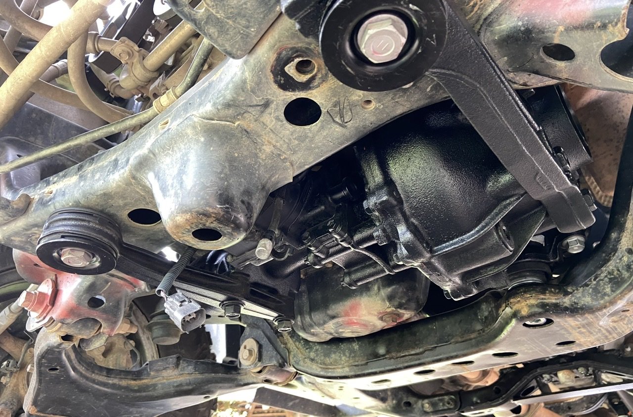

    1. You will need to get your measurements, to do this we need the transmission mounted
    2. Go ahead and chop off this section of exhaust, it will be in the way of the new trans and t case. We will have to get it rerouted anyways
    3. Prefill the torque converter with ATF, probably about 0.5-1 quart
    4. Don’t fill too much, you don’t want to make a mess when you hoist up the trans. It will “double seat” when you know it’s on there good
    5. It won’t fall out or move easily but just be sure it doesn’t come loose as you are mounting on the transmission
    6. Install new transmission
    7. At this stage, I only tightened 4 or 5 of the bell housing bolts. I came back later and put the rest on along with the electrical connections
    8. Install new trans isolator mount

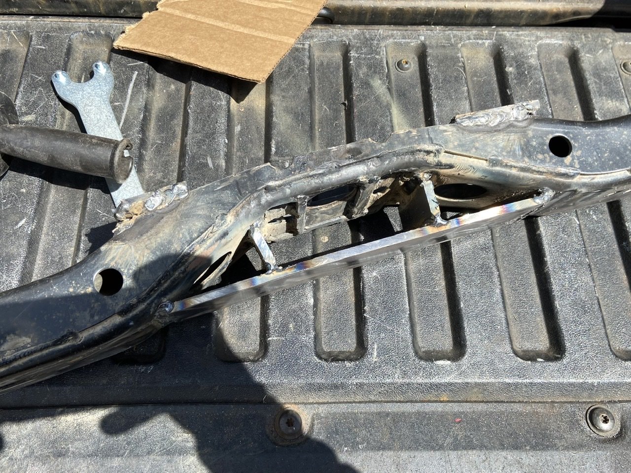

    9. Mock up crossmember and try to get a measurement on how far forward and how far down the new mount will beB757637C-7D32-4DD3-85CF-EB7DFB9F1A5D.jpg
    10. Mine turned out to be roughly an inch forward and about two inches down
    11. Cut off the top of the original mount like so and use that as your new mount1E153D22-72C6-491D-AF0D-DBC126FFAFC4.jpg8968BA6E-A45E-4BBF-866C-EF567B2731C6.jpg 43F9B1C1-AE83-43C6-ADD8-3D196C48A7B3.jpg
    12. You don’t have to do this but I did not want to have to drill that giant hole again
    13. Also, the 4 small holes will not line up if you go this route, new ones will have to be drilled anyway
    14. Reinforce the crossmember. i had some ¼ steel I used to beef it up. She’s a bit ugly but she strong

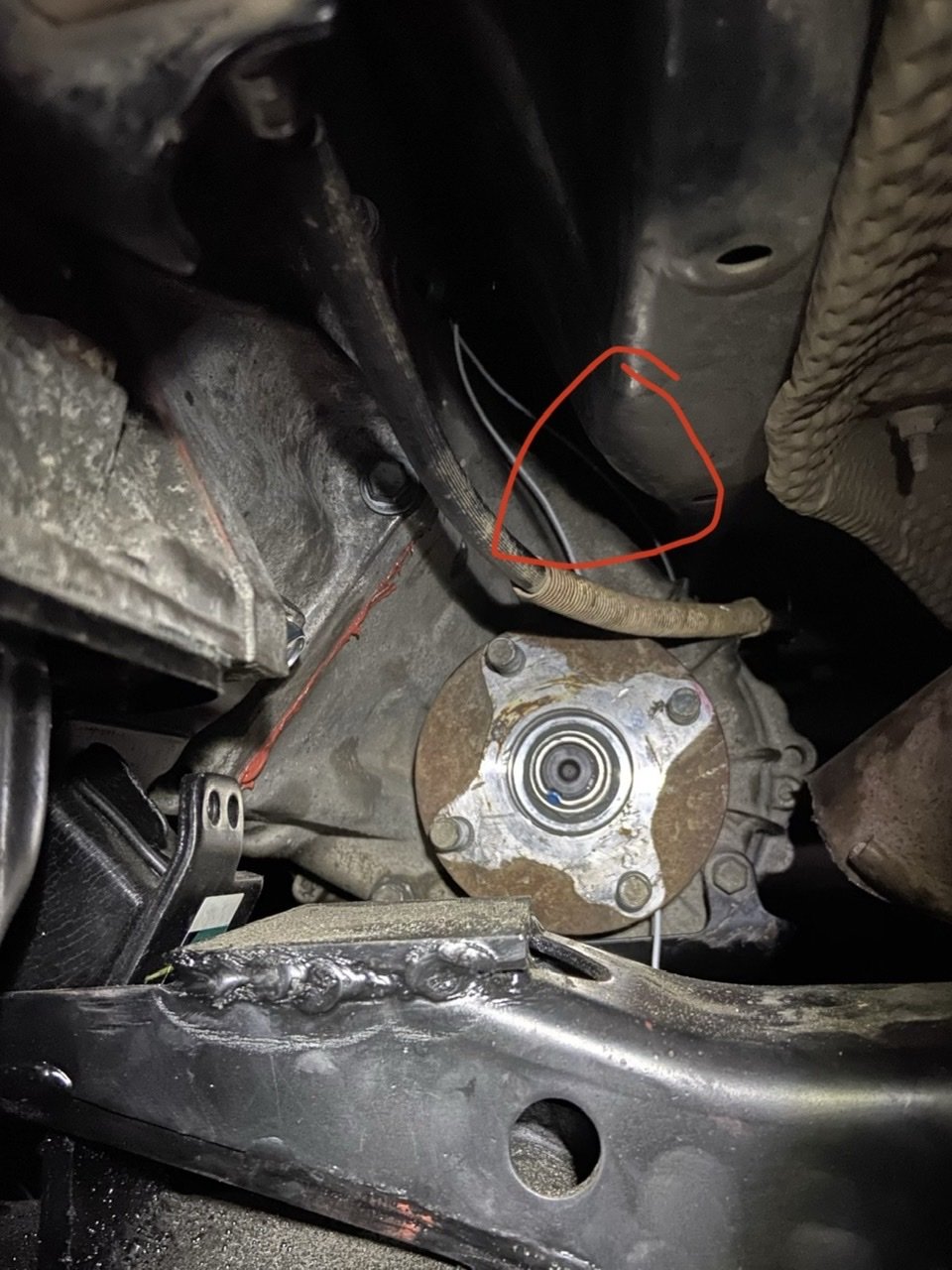

    15. Test fit making sure the trans isn’t hanging too low or too high
    16. There’s no official gauge to tell that I know of but it should look like so in step 2
    17. Also make sure the front driveshaft will have enough clearance. I had to pull my crossmember off again and cut and reweld it2C2332E0-F9B5-450C-8A7E-EF50C54D7E8B.jpgAF9D9DEA-151A-49A2-A423-922783529C1E.jpg
    18. Reinstall all trans bolt, electrical connections, cooling lines, etc
    19. I did NOT put the 6 torque converter to flexplate bolts on at this stage, in case I had to remove the transmission again

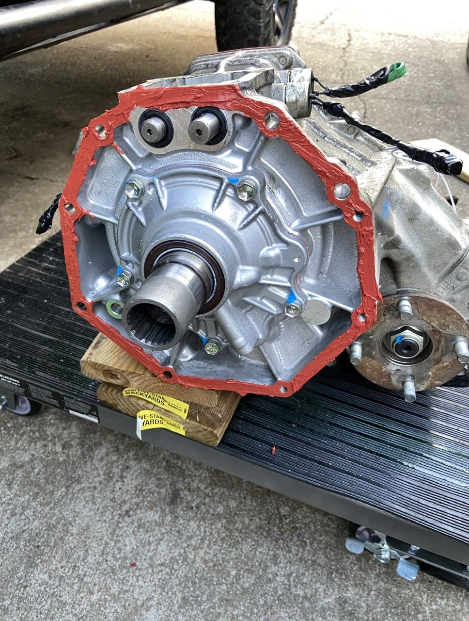

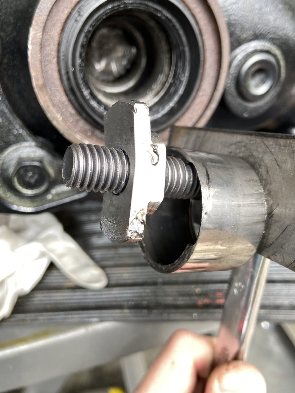

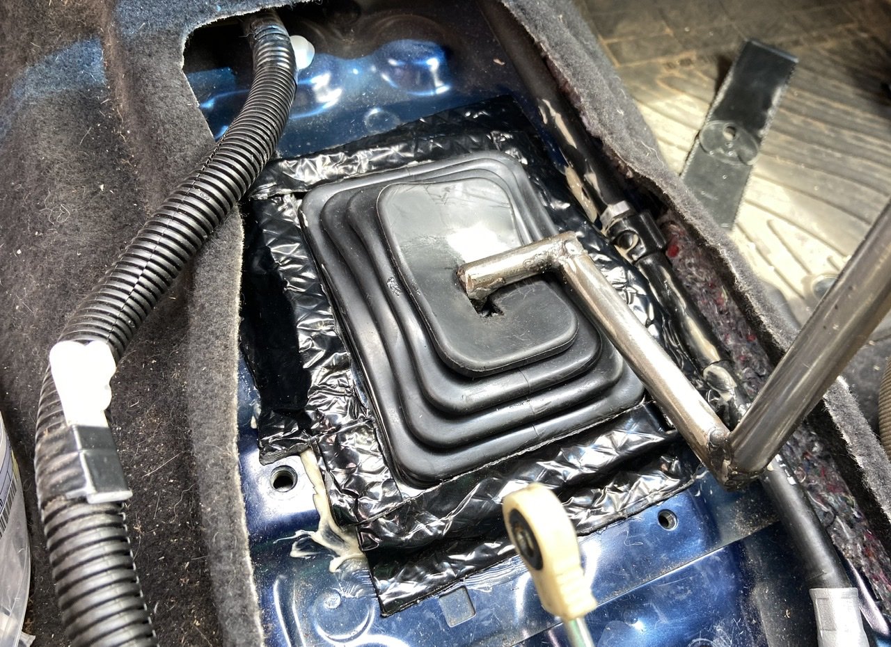

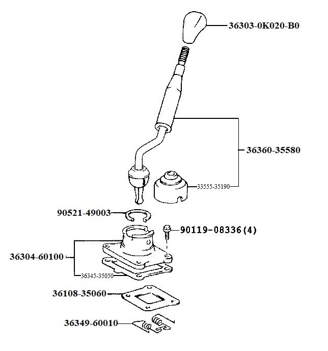

    Transfer case and shifter

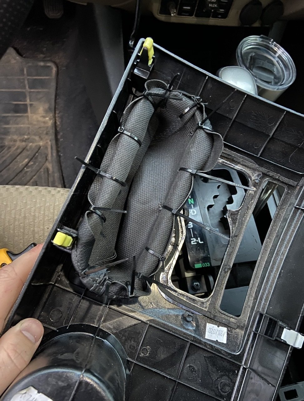

    1. Remove center console trim and transmission shifter assembly
    2. Remove the center console
    3. Remove the plastic shifter trim
    4. Remove the cup holder trim
    5. Remove the 4 bolts holding down the shifter assembly
    6. Unlink the shift cable inside the assembly, just pops off to the left
    7. You want to have a completely free working space

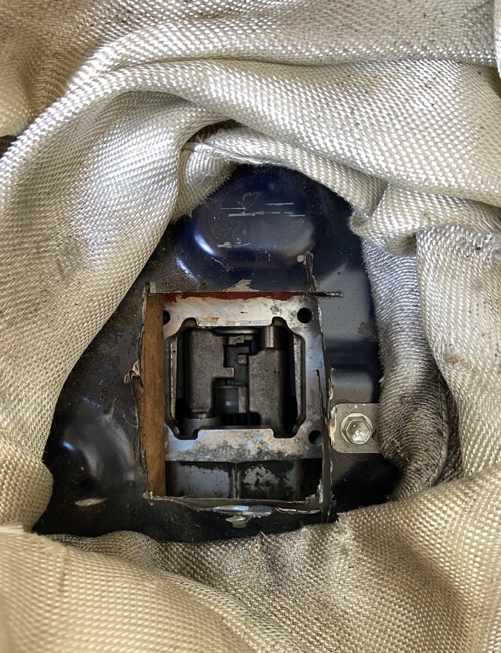

    8. Drill a hole from underneath your truck where the transfer case shifter will be
    9. I used this hole to know where to cut later on

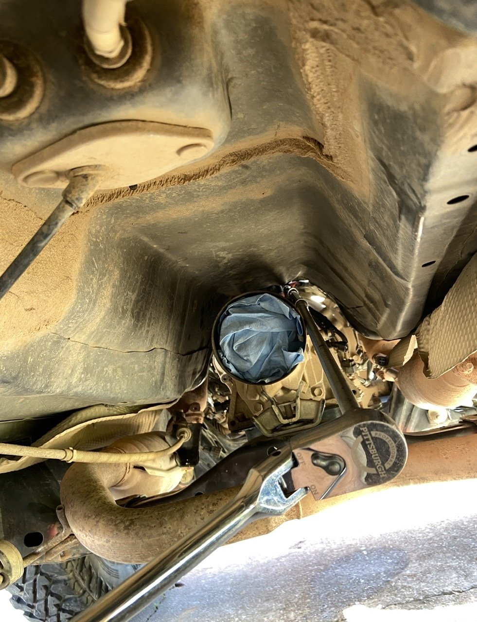

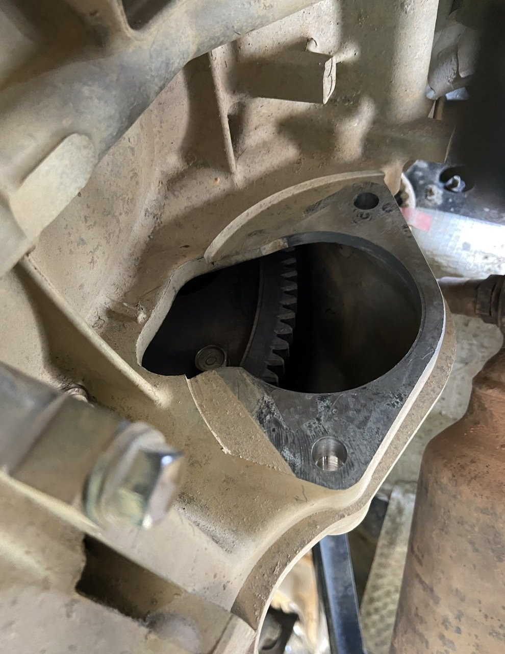

    10. Install transfer case to transmission
    11. EDIT: turns out this is not necessary but couldn’t hurt) Use orange Toyota FIPG around the edges like so before matingFE39C0E5-D3D5-4515-858B-8E57B8BB3D53.jpg
    12. Use extensions to tighten all 8 bolts
    13. If the top ones are hard to get, try removing the crossmember and steadily lower the trans with a jack until you can reach it
    14. Alternatively, you can get to the top bolts from inside the truck depending on the size of the hole you cut

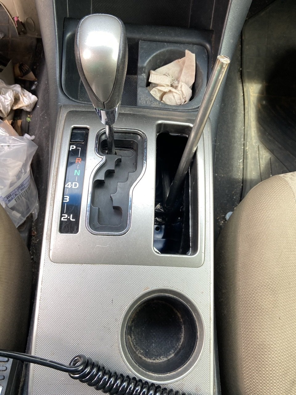

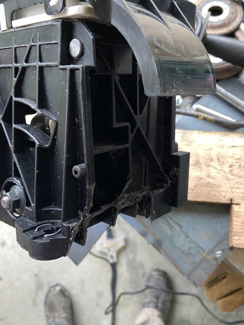

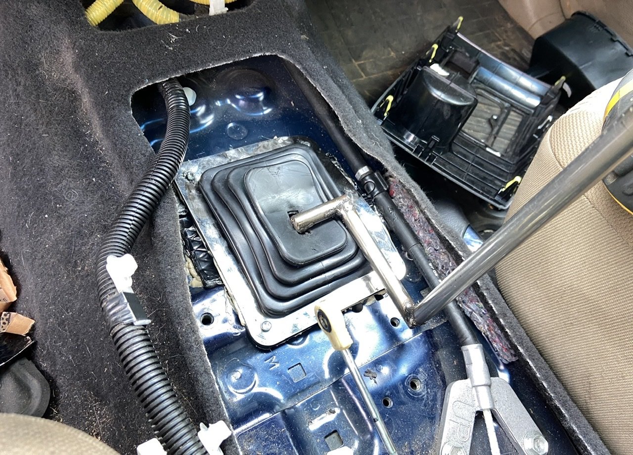

    15. Cut a hole for the shifter
    16. I took a grinder and went to town13FE33CF-2970-4408-B103-909A796FDD1D.jpg
    17. Make the hole big enough so you can put the shifter base on and tighten the bolts
    18. You will lose one mounting bolt for the shifter assembly this way but it is still plenty sturdy
    19. Alternatively, use a 4 inch hole saw instead of a grinder for a cleaner look. I did not do this because I wanted to access the bolts for shifter

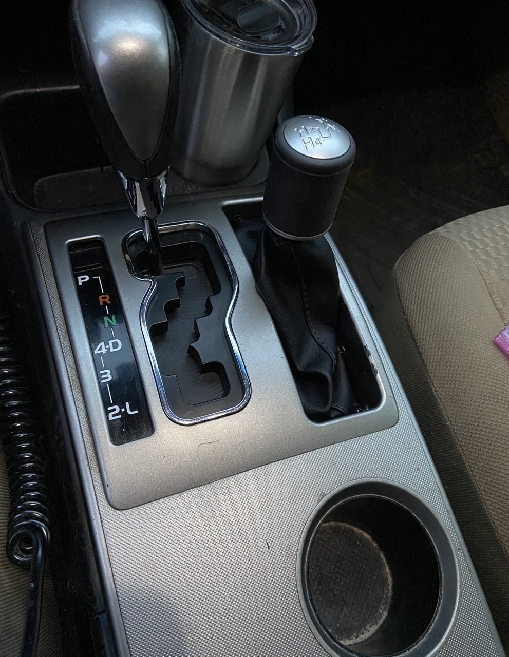

    20. Route your shifter up through the coin slot

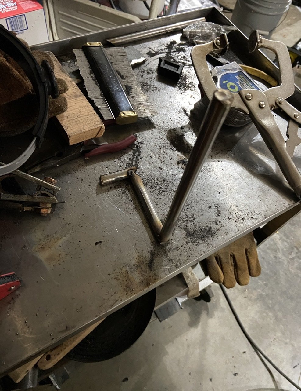

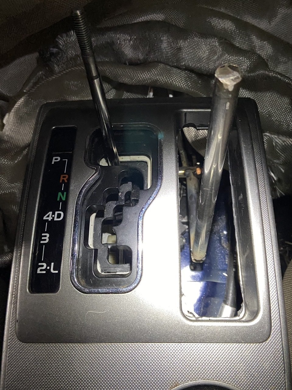

    21. Weld up a shifter with the ½ steel rod
    22. With the shift angle I used, I had to trim the shifter assembly a good bit
    23. Keep in mind, the shifter will wiggle while offroading, give it some room away from the sides of the coinslot
    24. 4 lo was also much higher and to the right than I anticipated, and it rubs the right side of the coin slot. Not a big deal to me but nonetheless
    25. Also may be a good time to figure out your shift knob. I ended up welding a 12MM bolt to the top of the rod to screw on an FJ shift knob, avoiding having to thread the rod. Shoutout @EatSleepTacos for the idea
    26. Seal the hole with sealant and the shift boot
    27. I used some 3M waterproof adhesive and screwed down my shift boot on top of it
    28. I used sound proofing material to further seal it and reduce noise
    29. It’s kind of goofy but I think it works alrightACEA0DF3-67CB-4359-B4FE-69EE6DC2BA98.jpg147CEA22-9372-43A4-9216-E5E7DE5A4450.jpg C9E89735-DDB1-444F-AEB8-779CEFA6D384.jpgE118F5A2-773B-4CDC-BCBE-FE310EE35D58.jpg 2EBF6DEA-839A-4851-A9FE-0499950A6F2A.jpg90D1DB76-CADD-4286-AE81-820255D8DE84.jpg

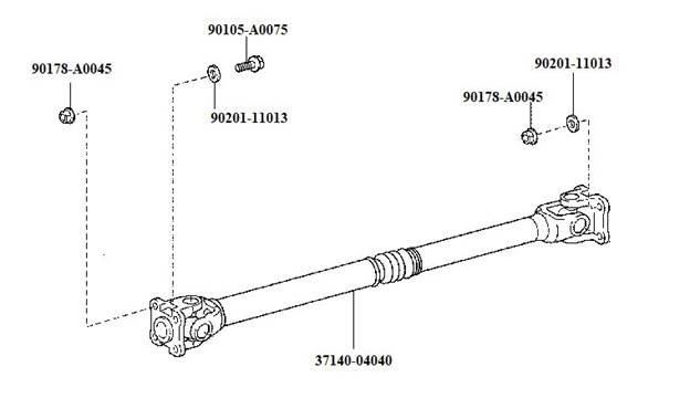

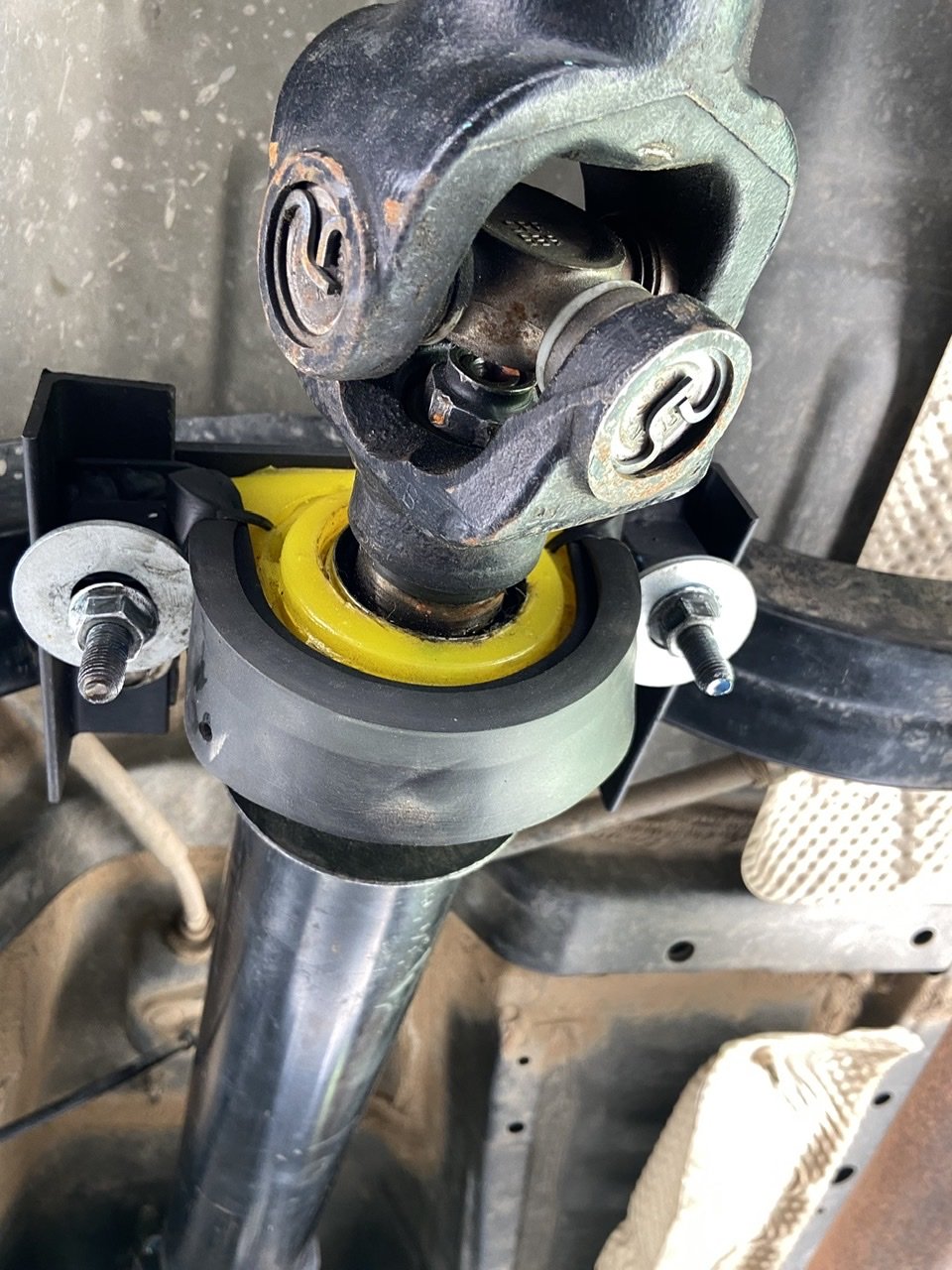

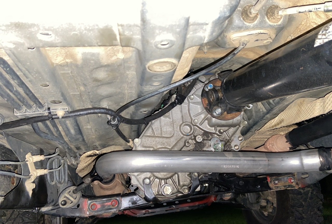

    Rear Driveshaft
    I chose to buy a 4x4 rear driveshaft and extend the mounting holes. I used 1/8 inch steel angle iron to extend the holes back approx. 2 inches. After about 2 weeks of driving, the center support started to bend downward. This is probably because it was not design to carry offset weight. I strengthened it with some 3/16 steel plate, I’ll see how it does now. CD91776E-9DC5-42B9-9C0B-62AED974FD8B.jpg 370EC542-51C5-4146-A3E7-4F91E46201F8.jpg
    EDIT UPDATE: I was getting some vibrations, I suspect it was the driveshaft itself and not the mount but I went ahead and shortened my old driveshaft, no more vibes at all. One thing to note, my prerunner used a slip yoke that went inside the transmission so basically it needed to be converted to accept a flange on the end and a slip yoke in the middle of the rear shaft. I just took it to a shop nearby and they did everything, parts included, for $290. Here’s another good thread about shortening the driveshaft:
    https://www.tacomaworld.com/threads/prerunner-to-4x4-conversion-guide.534480/

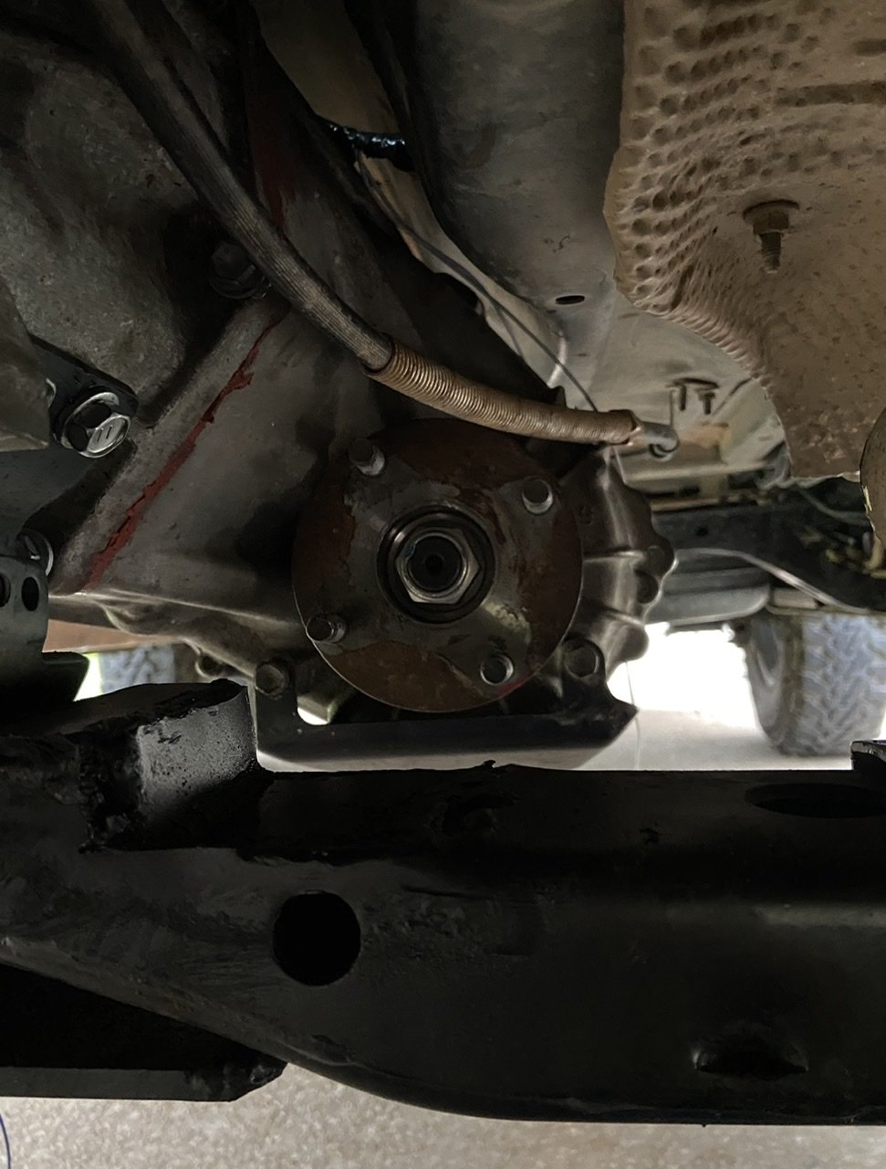

    Finalizing transmission and transfer case
    At this point, you should almost be ready for a test drive. Few final things to button up
    1. Reinstall the 6 torque converter to flexplate bolts
    2. You will have to line up the holes
    3. Simple put your hands behind the flexplate and rotate the torque converter until the hole lines up
    4. Once you get one bolt started, the rest will be lined up
    5. Also, be VERY careful not to drop a bolt inside. You will have to remove the transmission to get to it
    6. Reinstall the starter
    7. Don’t forget that stupid piece of plastic I referenced earlier
    8. Fill up transfer case with oil
    9. It will seep out the fill plug when you have enough
    10. Pour in new transmission fluid
    11. A750F has a capacity of about 11 quarts but your transmission should not be “dry” if you bought it used, there is still some in there
    12. I put in about 6.5 quarts before the transmission was properly filled
    13. Here’s a great thread on how to check fluid levels since there is no dipstick: https://www.tacomaworld.com/threads/how-to-drain-refill-automatic-transmission.63851/
    14. Also here’s another great reference i…well, referenced: https://www.purefjcruiser.com/docs/2007 Toyota FJ Cruiser Repair Manual/A750F Automatic Transmission/Automatic Transmission Fluid/01700210.pdf
    15. Go for a test drive. It’s safe to shift into 4 hi and 4 lo, there is just not front wheel drive…YET!

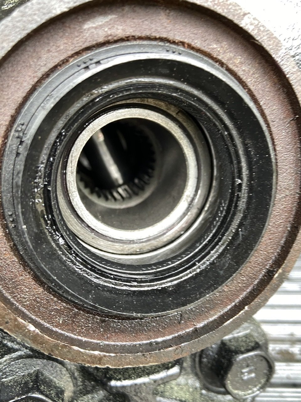

    Front differential
    1. While the diff is out, go ahead and replace the needle bearing with the ECGS bushing. Great upgrade to prevent future vibrations
    2. I completely fubar’ed this step. Don’t be like me. 36CFB53B-49F0-428C-9928-E62CC9E60426.jpg This is a great video I referenced: https://www.youtube.com/watch?v=WJ4_7G12Esw36CFB53B-49F0-428C-9928-E62CC9E60426.jpgF4FC4009-2780-4ACA-8395-3688C4867EC1.jpg
    4. Install new seals if needed (mine looked fine)
    5. Remove ADD cover and reseal with RTV
    6. Do this if you are keeping the ADD (more on that later)
    7. A common failure point on these motors is water seepage
    8. Using a jack or hydraulic table, finagle the front diff into position
    9. Once you get the back end above the crossmember, the rest is easy
    10. Make sure you install the washers and stoppers in the correct order3ED71E66-149C-4013-8FD5-345CDBE725F9.jpg6732877E-EE5E-40E3-BCBD-F87BF1F87A00.jpg

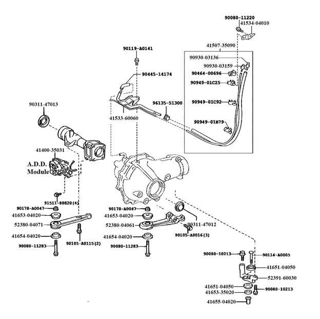

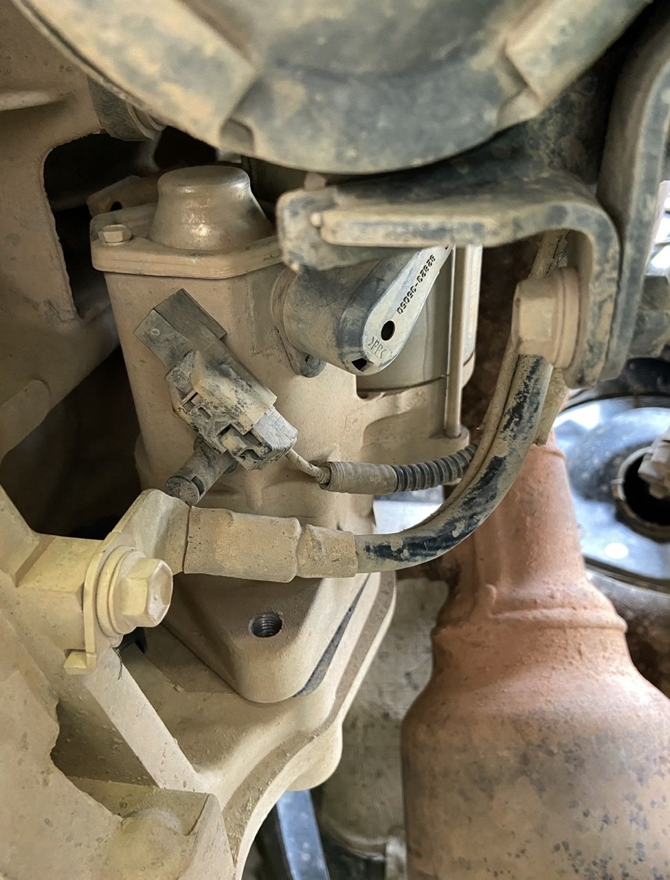

    Automatic Differential Disconnect (ADD)
    If you don’t want to keep the ADD, read this thread for using an FJ tube instead: https://www.tacomaworld.com/threads/how-to-deleting-add-system.427258/
    Or read this thread for keeping your current front diff tube but welding it to the always on position:
    If you DO want to keep your ADD, keep on reading.

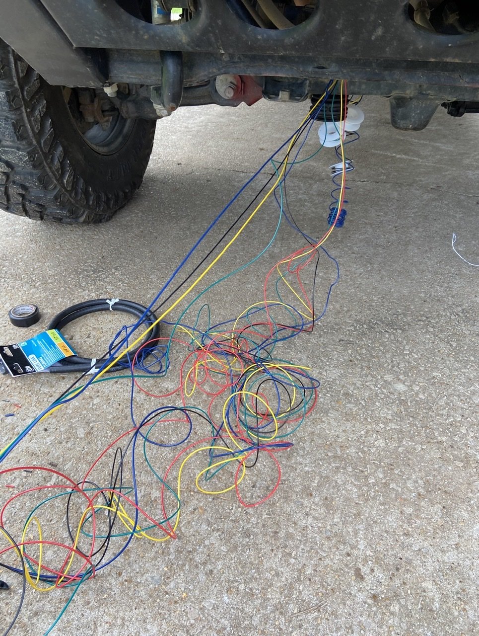

    If you want skip making your own switch, here’s a link for a premade wiring harness for $150: https://12thstateoffroad.bigcartel.com/product/add-actuator-harness
    Or you can make your own for about $30:

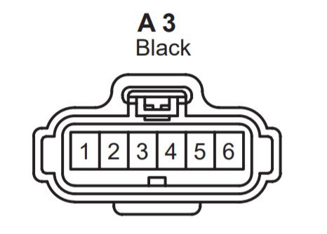

    The stock 4wd tacoma uses a 4wd ECU computer to shift both the transfer case and front diff electronically at the same time. We already bypassed the transfer case with a manual shift rod, now we are going to bypass the front diff. The 10 pin DPDT ON/OFF/ON switch will replace the 4wd ECU. It is important you get one with a ON/OFF/ON function as when you flip it on to activate the actuator fork in the front diff, you don’t want the motor continuously running. When activating 4wd, you will flip it on for 1-2 seconds, then move it back to the middle position. When you deactivate the front diff, you will turn it off for 1-2 seconds and flip it back to middle. Here’s an EXCELLENT thread how to do the wiring, go to post#176: https://www.tacomaworld.com/threads/lets-see-your-fj-case-swap.455278/page-9
    If you’re like me and that still did not make sense, @6 gearT444E broke down where each wire goes one by one for me. Huge thank you again! Literally, just follow what he says below one by one and it will work. It’s wired so that the light will only show ON when the actuator fork is in the ON position and the sensor in the front diff detects that so you know it’s actually working. For the “keyed +12v” wires, I used a fuse tap to tap the 20A fuse that says “4wd” below the steering wheel (how appropriate). Ran one wire up to the switch and jumped the two other keyed +12v pins from that one wire. For the illumination wires, you can tap into any green/white wire behind the dash.
    Switch pin # - ADD side
    1 - keyed +12V
    2 - Red wire from ADD connector Pin 1
    3 - Pink/Blue wire from ADD connector Pin 5
    4 - Light Green wire from ADD connector Pin 6
    5 - Black/White wire from ADD connector Pin 2
    6- keyed +12V
    7 - Light Green/Black wire from ADD connector Pin 3
    8- keyed +12V
    9 - Illumination Negative
    10 - Illumination Positive
    This is looking "into" the ADD connector for the pin designations.2E24D319-063A-469E-987C-0E8F00153E06.jpg

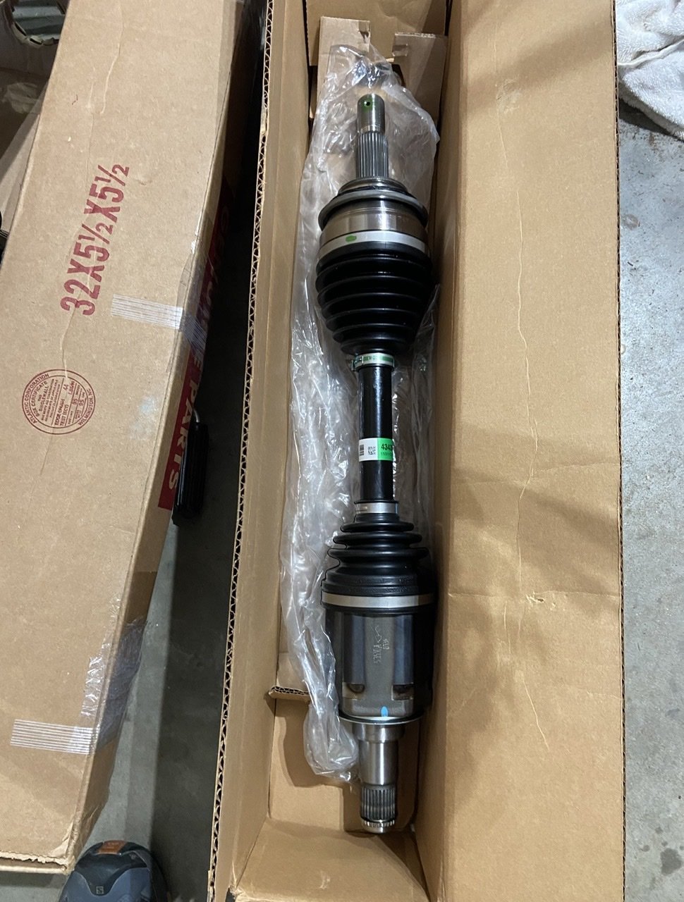

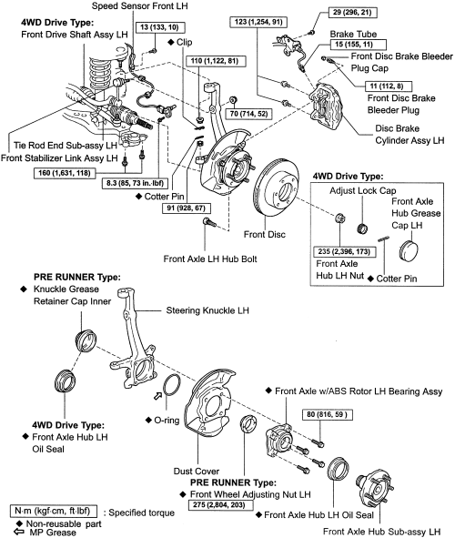

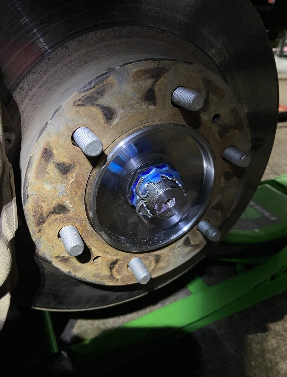

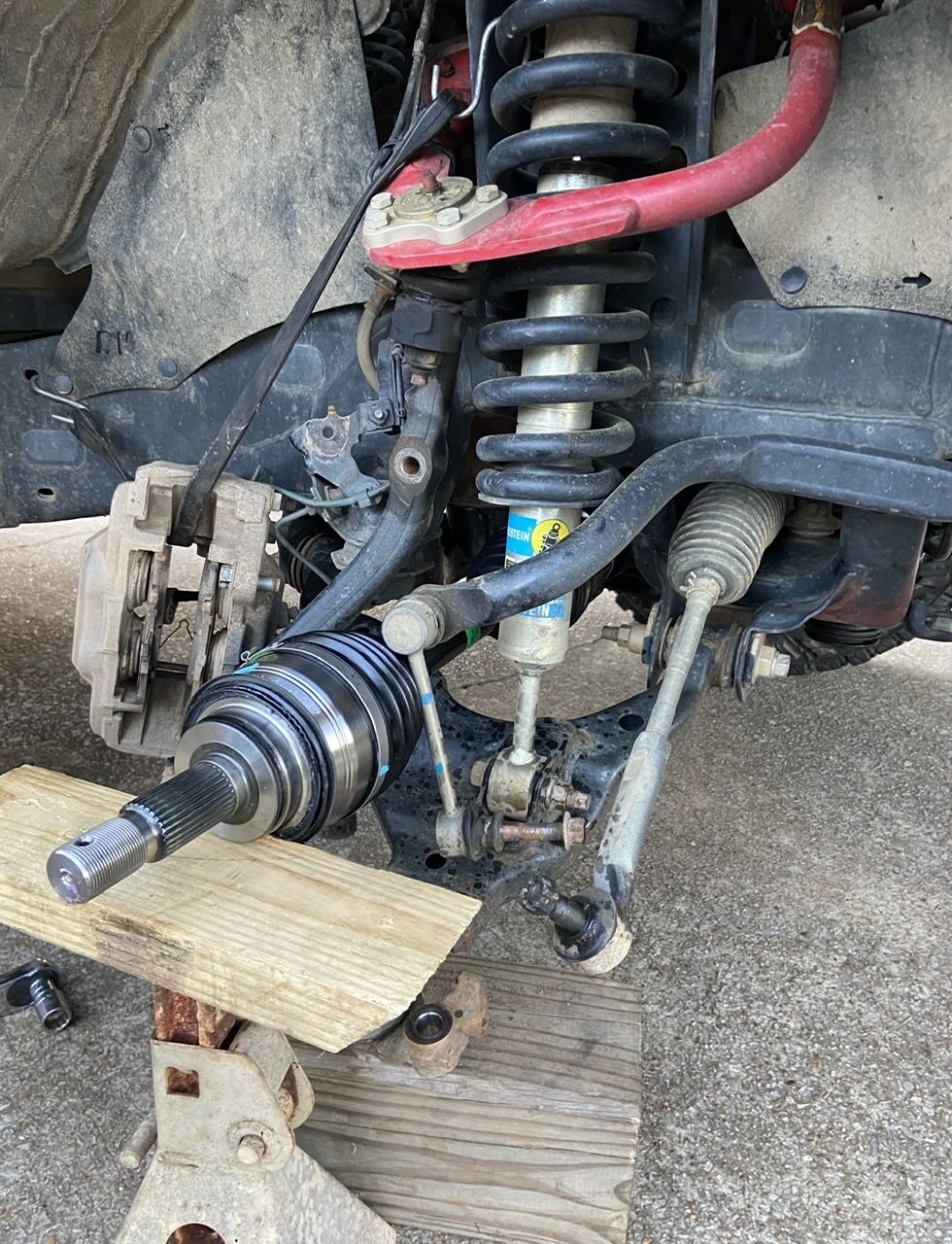

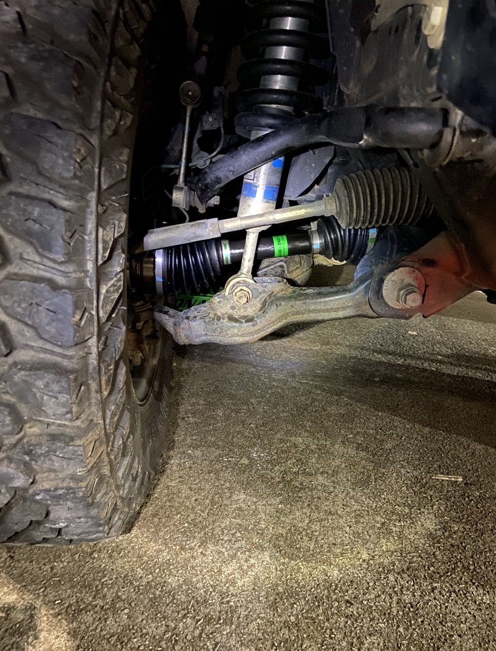

    Wheel Bearings and CV Axles
    1. Remove tire
    2. Unbolt ABS sensor
    3. Unbolt ABS sensor bracket
    4. Unbolt brakeline bracket
    5. Unbolt brake caliper and bungee cord it out of the way
    6. Remove rotor
    7. If it is seized on, give it a solid whack from dead blow hammer
    8. Remove grease cap (will not reuse)
    9. Unbolt hub and remove
    10. Set aside dust cover, will reuse later
    11. Unbolt sway bar stabilizer link from steering knuckle and disconnect
    12. Unbolt sway bar link bracket, helps accessing CV axles
    13. Separate tire rod from steering knuckle
    14. You don’t need a tie rod separator
    15. Remove the tie rod nut and rethread it on the top so you don’t damage the threads
    16. Give the end of the tie rod some solid whacks from the big friendly hammer, it’ll pop right out
    17. Separate the lower arm from the steering knuckle. It’s the two bolts, don’t mess with the uniball
    18. Install the 90316-A0001 hub seals facing inward
    19. Insert CV axle inboard joint into the diff
    20. It helps to grease the C clip if you are having trouble getting it in
    21. I had to hold the CV axle straight while someone else hammered it in with the deadblow hammer
    22. Insert CV axle outboard joint through the steering knuckle
    23. Reinstall sway bar and stabilizer link
    24. Reinstall tie rod
    25. Reinstall lower arm
    26. Install 4x4 hubs with dust cover in between
    27. You will see the cv axle has a gap on the backside of the hub. This is ok, we will tighten it up in just a second
    28. Install rotor
    29. Install ABS sensor, brakeline bracket, and brake caliper
    30. Torque the axle nut to 173 ft/lbs.
    31. There should be no gap on the backside of the hub now
    32. Place locking cap on and lock with cotter pin
    33. Install grease cap
    34. Reinstall tire
    35. Repeat for the other side
    36. Fill front diff with oil until it seeps from the fill plug
    37. The plugs uses a 10mm Allen wrench (nice one Toyota)DC080D85-B420-496D-85F8-4DAF9263D4BD.jpg7FE4F355-F54E-4899-9085-DE5752F18F6A.jpg
    Last thing to do is install the front driveshaft. At this point you should have a functioning 4wd truck, you can test drive it to the exhaust shop for the reroute.14EEEC51-29A7-4F4C-BB01-B05D9028C86D.jpg
    You can also wire up the transfer case lights to display on your dash. I tried but could not get them to work, probably because I tried to use bare wire instead of a pin in the switch. It’s recommended to get the wires wired up and ready BEFORE installing the transfer case as it will be hard to wire them while it’s mounted. This thread has a good writeup for that: https://www.tacomaworld.com/threads/prerunner-to-4x4-conversion-guide.534480/
    The last piece of the puzzle will be making the shift boot look good. I drilled holes on the side of the coinslot and tied it down with zip ties. Some people use gorilla tape. The shift boot I ordered wasn’t perfect but I’m happy with it, link below. It’s good enough. Also keep in mind not to drill through your finger while doing this, it hurts.BCBAA9B4-9B46-4EC2-9E88-37F7614F814F.jpgBF85B94B-94CD-4FD9-B571-025E34BD7289.jpg 5C30A5C6-D70A-4993-B476-19C66807B5E1.jpg
