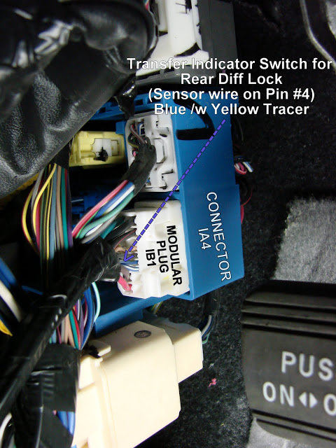

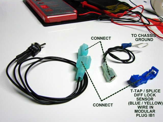

    I found an answer to a question that was asked a few years ago in this thread. What happens if the ABS kill switch is active and you attempt to engage the locker?
    The answerer is nothing really.
    The 4WD ECU still activates an internal relay, but the diff will not mechanically engage. It does not hurt the truck.
    If the vehicle operator wants to engage the diff lock, they must disable the ABS kill switch, then use the factory locker switch.

    Your initial observation is correct. That's why I added a simple circuit of a transistor and a resistor to provide the necessary grounding to the ABS system. Since this is a low-current system, this simple mod works beautifully! Again, I can provide a schematic if anyone is interested.

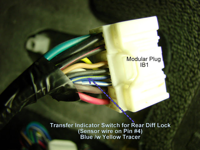

    The switch can be used to switch to ground without additional electronics if you want to forgo the lighting options. Just connect the green/yellow wire to ground and the red/yellow wire to the 1B1, pin 4 connection needed to disable the ABS. This will work, but without the light options.

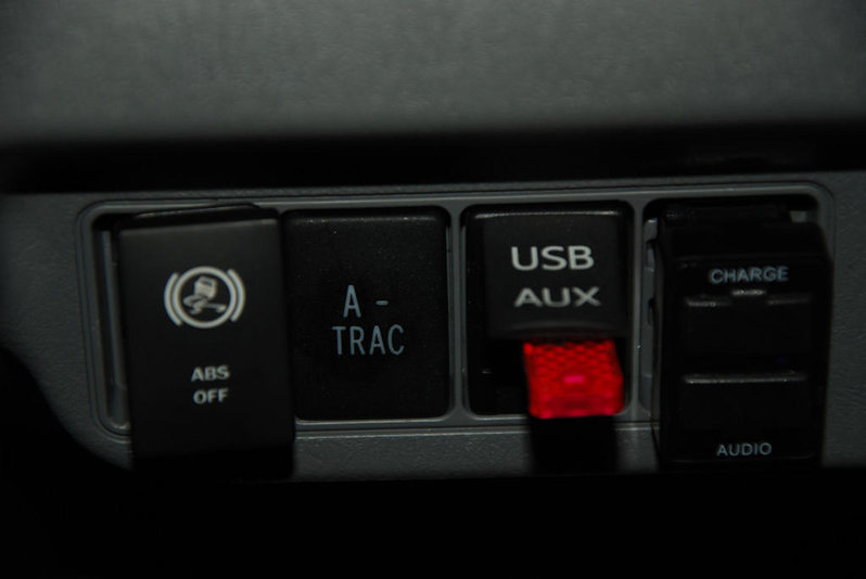

    Well this is certainly the most factory looking switch you could use if you have the stock location for it, which fortunately I did.

    Did the mod today, with some shoddy dremel work. Oh well, the switch works and it wasn't hard to do.

    It looks beautiful! :)

    Where did you get that switch??

    I had it made at rockerswitchpros.com

    So when toggle switch is switched on. It just grounds out the blue wire , basically ?

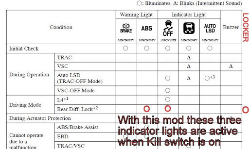

    Installed ABS kill switch. I haven't actually try it out yet , but looking forward to it. And my rear dif light also lights. So I have a total of four lights on , when switch is on Thanks !

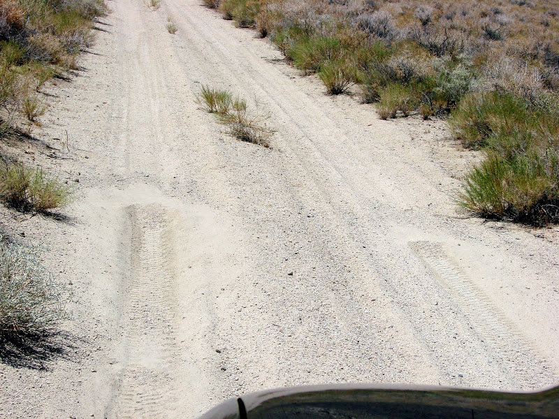

    Update: I used this today in both 2WD and 4HI, it worked flawlessly. There is a stretch of whips on the beach approach here that used to send my ABS into panic mode, but worked just fine today, especially while two-footing it. No issues switching off to employ the locker on a steep and loose dune as well.
