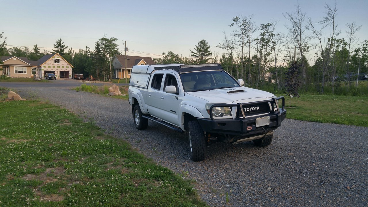

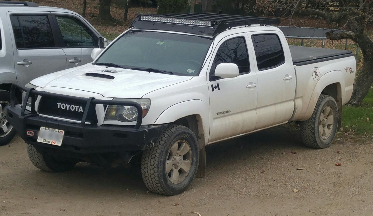

    05 Oct 19 **Spoiler**
    - As she currently sits vs the day I brought her home
    13-May-13
    -Day I brought her home.
    -Came off a 3 Year lease, at 81 xxx kms for about $22k. First major vehicle purchase of my life. Never looked back
    -Choice was between SW DCLB fully loaded, Silver DCLB stock or Speedway Blue ACLB. I definitely chose right. Love me a white truck. Looks good dirty, looks good clean.
    04-Aug-14
    - turned it into a camper, travelled through ON, QC, NB, PEI, NS, ME, VT, NY
    29-Dec-16
    -First "unoffical-they-didn't-know-it-was-a-meet-up,-meet-up" at the local World Gym

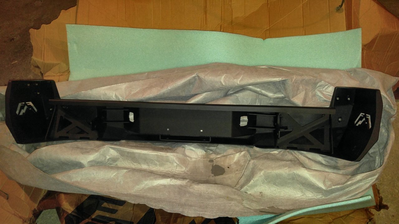

    How about a nice pic of the Fab Four rear bumper
    Manfred[OP] likes this.

    Very nice does that work with a factory hitch? I'd like to look at a bumper but I have to retain a hitch for my utillity trailer and camper.

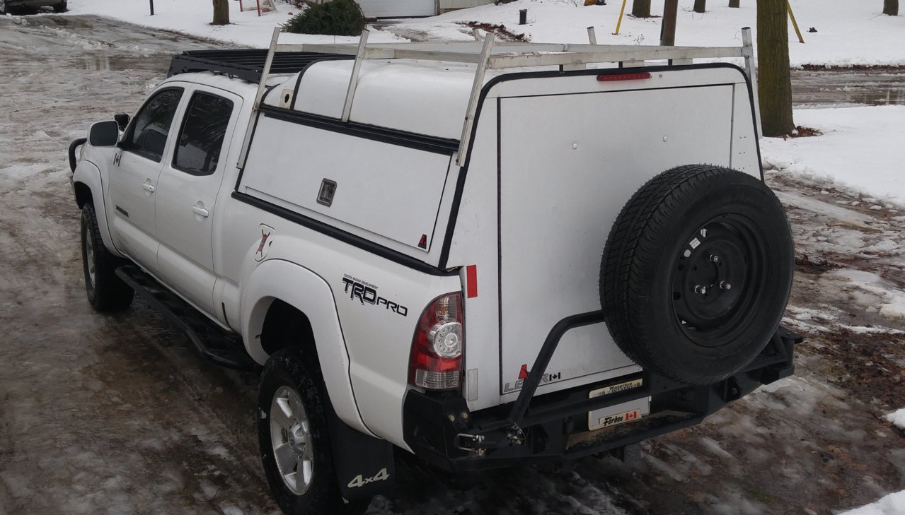

    So I only have a few pics of the bumper pre install because I did it on a Sunday night at 2230 haha. Tomorrow she's getting a bath and be sure to show her off then ;)
    That's exactly what it does. Keeps the factory tow hitch but beefs up the rear bumper. and the reason I picked it up.
    Super clean with build and happy I picked It up. Took maybe 10 minutes to install.

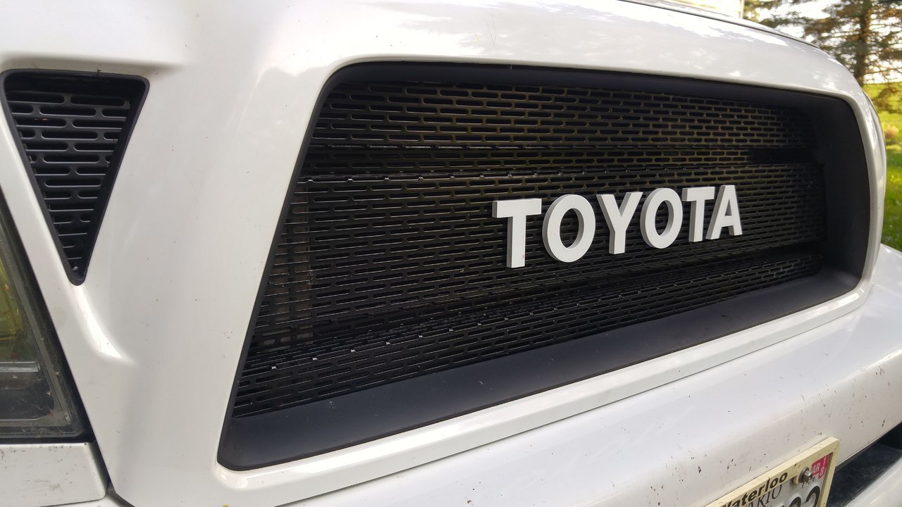

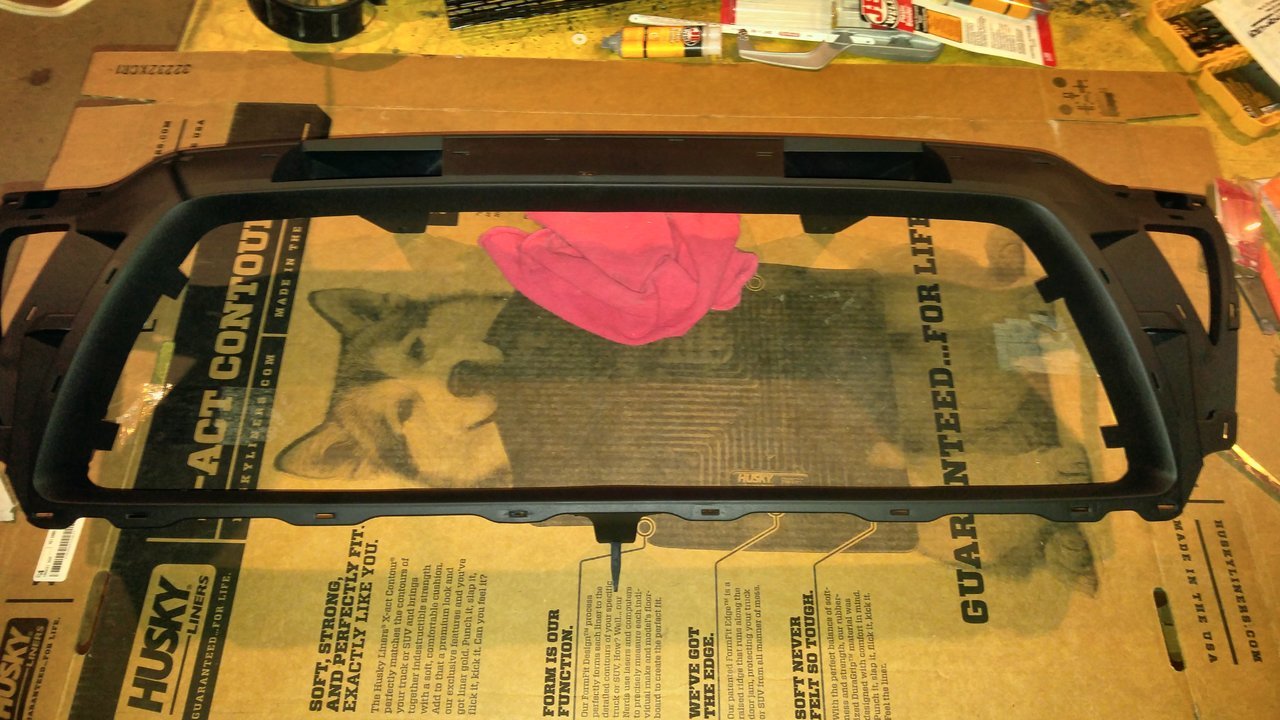

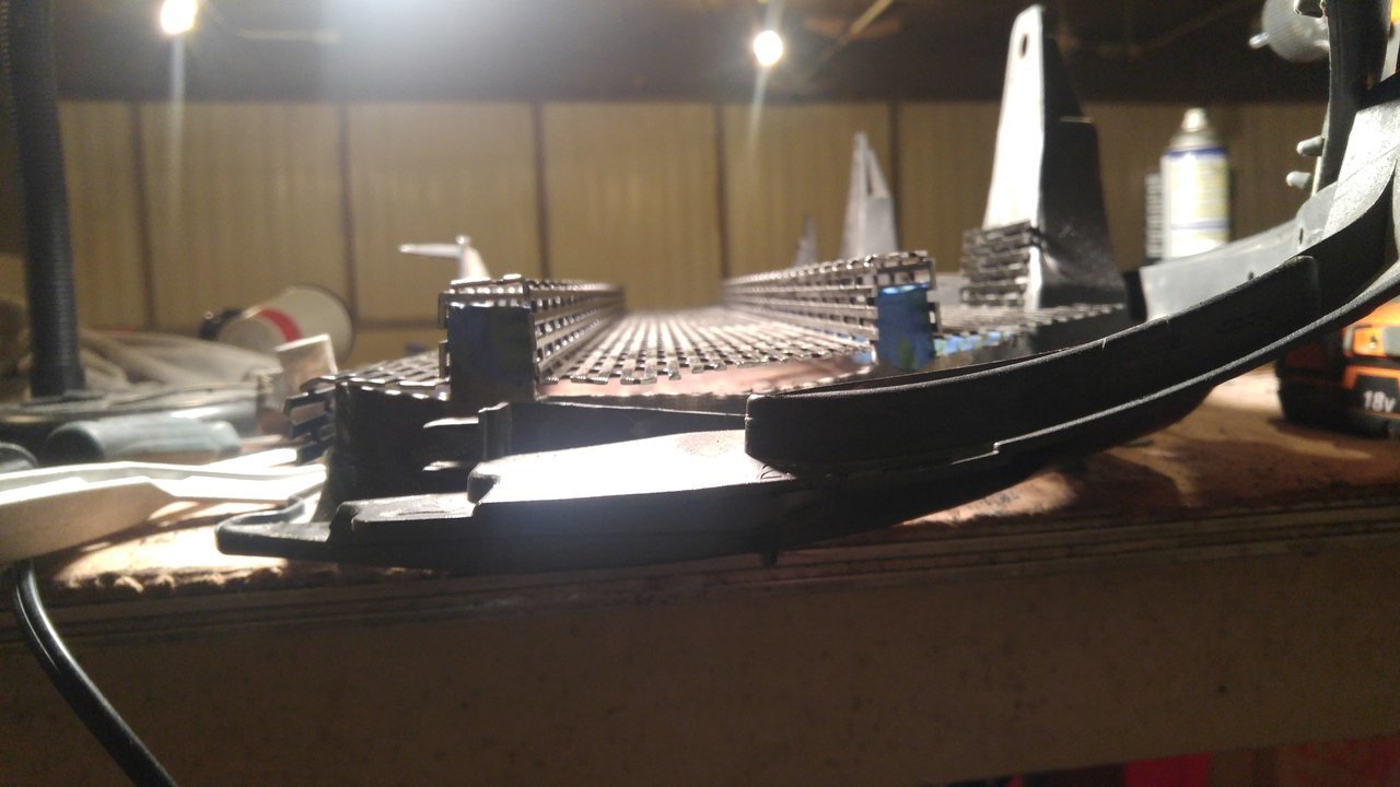

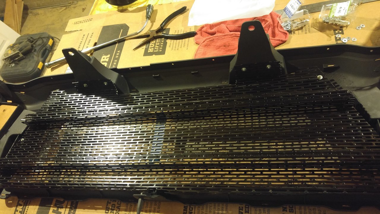

    Raptor Grille + FJ Lettering
    Big thank you to:
    @HomerTaco
    @Dozer
    @Tyler07

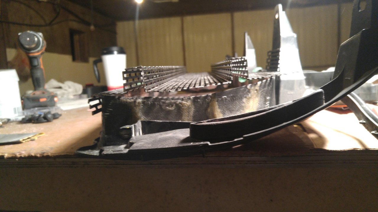

    Thrown onto a 2010 DCLB

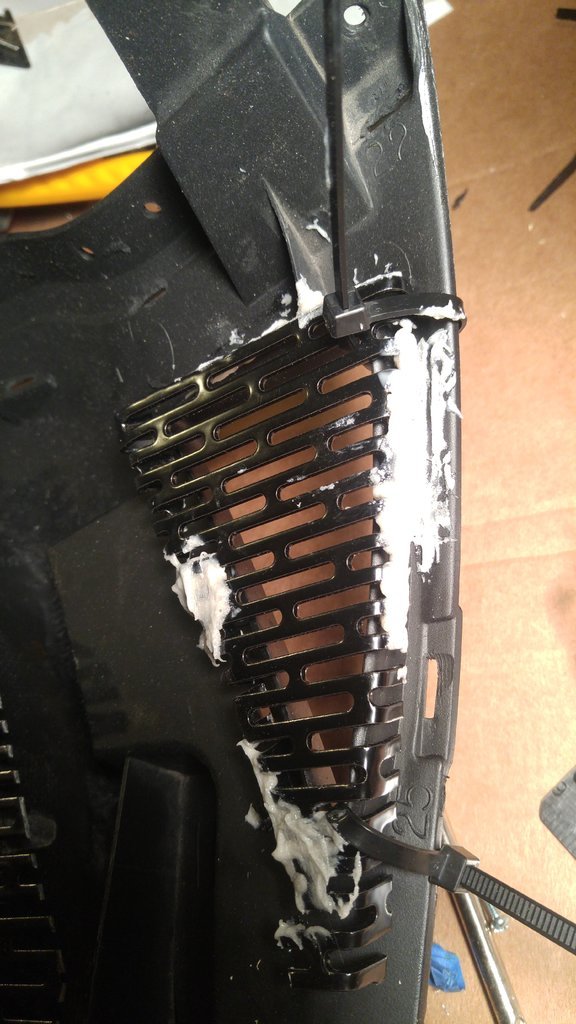

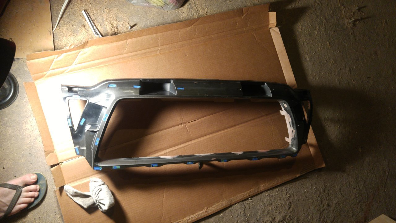

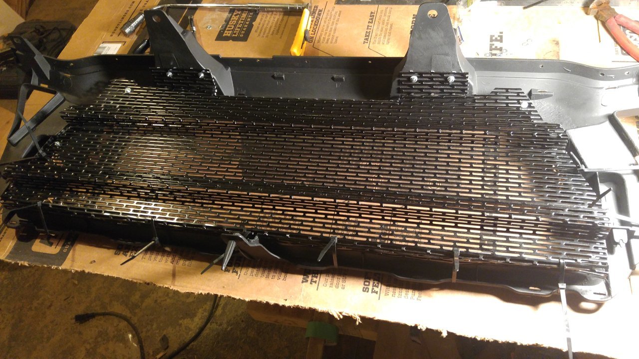

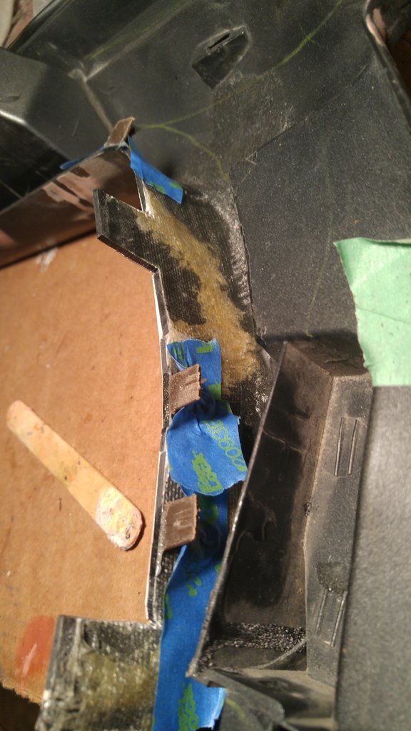

    Didn't take any pictures of the cutting process but its pretty simple.. just cut it out.
    used bondo fiberglass and JB weld to rebuild the sides that were cut out.

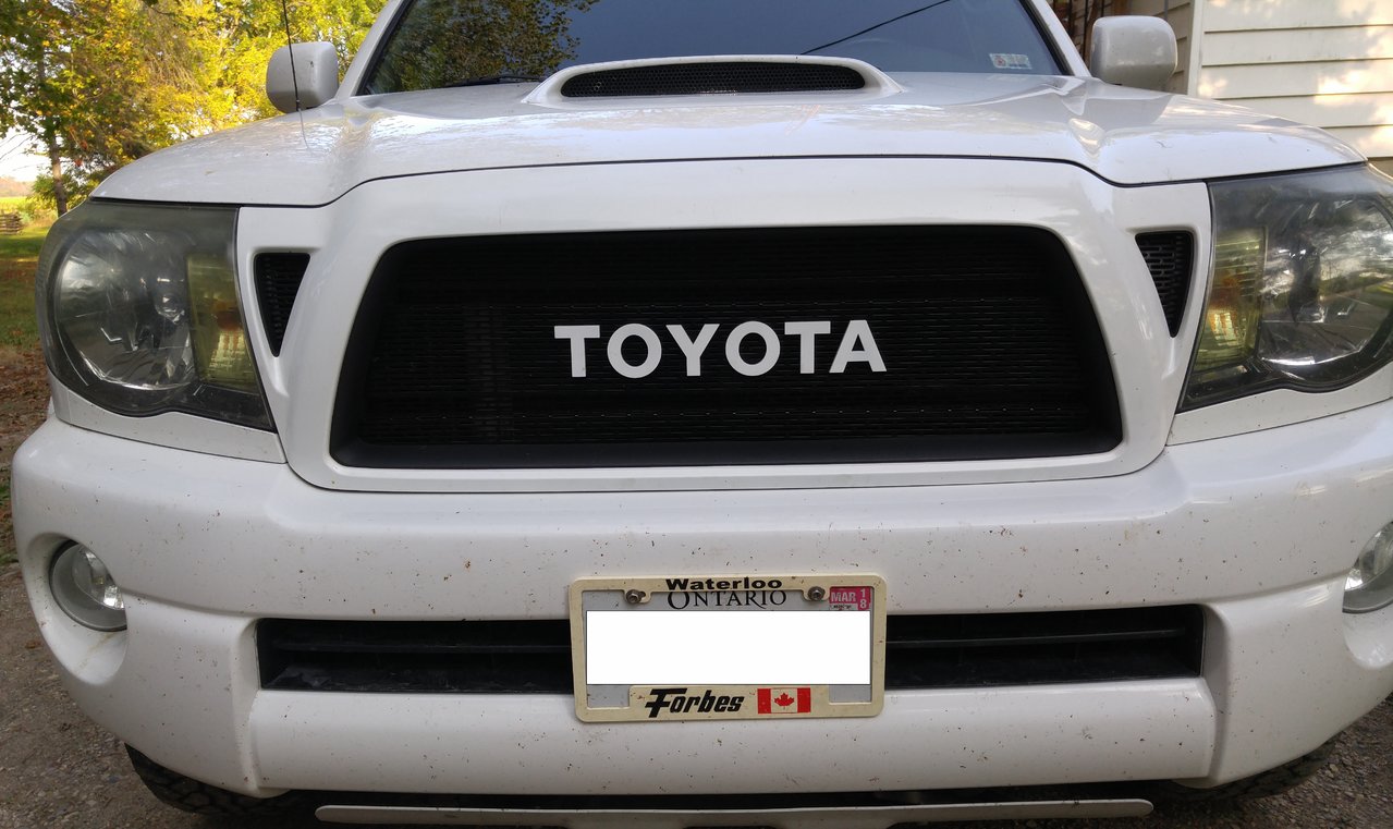

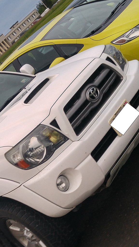

    the grill fitting before cutting out the raptor mesh
    the grill fitting after cutting out the raptor mesh. took about 2.5 cm off though i might have been able to gone to 2.55
    You can see in this one a) my flip flop b) the the sides cut out, bondo'd up.
    [​IMG] first couple coats of black matte paint (rustoleum matte black)

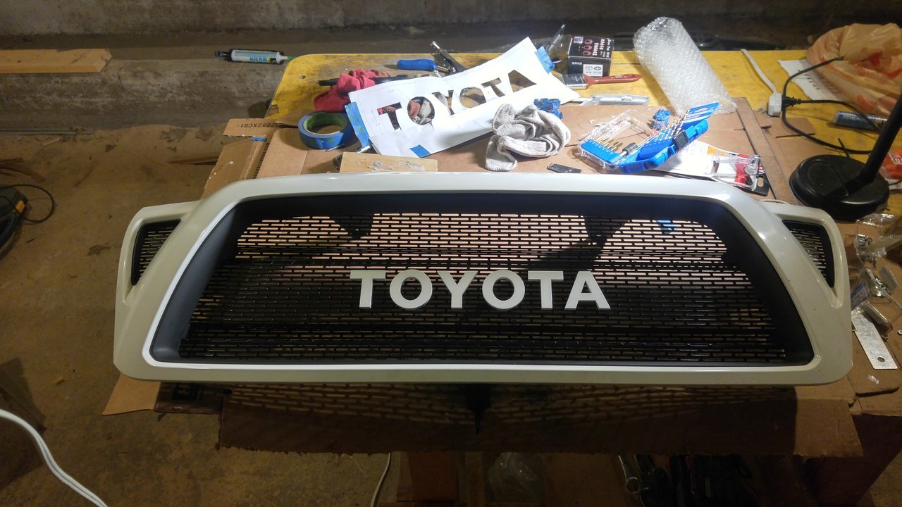

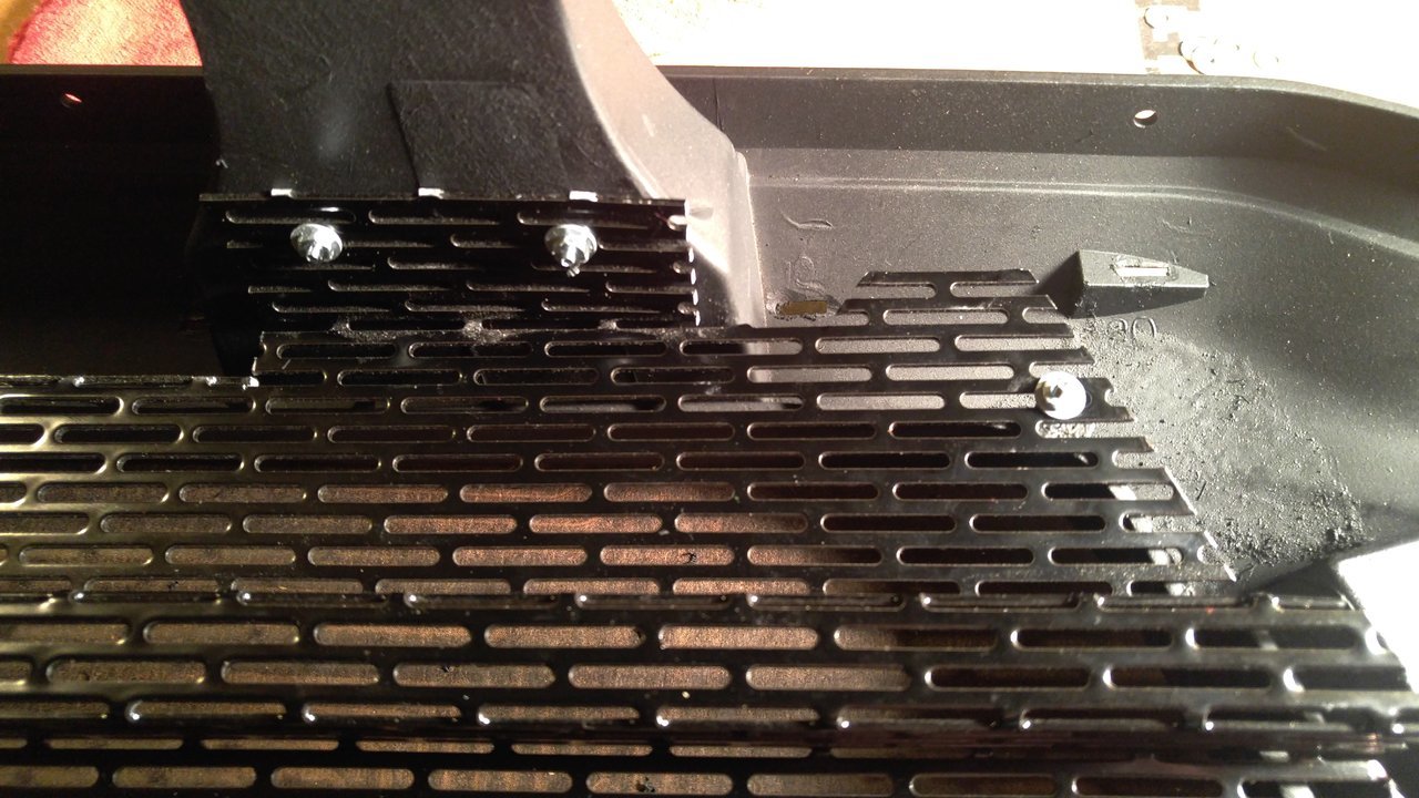

    now for securing the grill i went two fold:
    1. 4-40 screws with #6 washers
    2. JB weld around the side. I bent the ends of the raptor mes to fit the front profile but beware; too many bends and it will snap and the profile curves
    just the trianlges jb welded, made sure to keep them lined up with the front grill
    8 different points to secure the grill to the plastic front , on the bottom portion I used JB weld all around the seems. "Two is one, one is none"

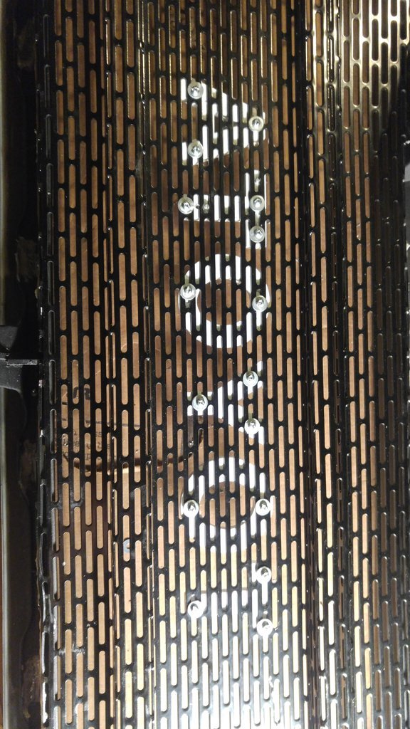

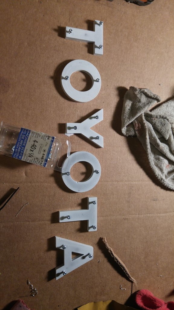

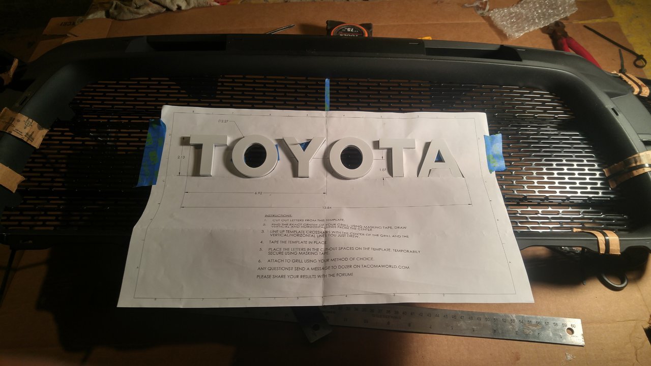

    Metal FJ Lettering:
    marked, drilled and tapped to 4-40
    backside of all the lettering test fitted taps
    I broke a couple of threads off the screws so the letter T literally has 5 different holes drilled and tapped with 2 of them containing broken screws. I also used JB weld on the threads so the only way these letters are falling off is if i take a hammer to it
    letters laid out
    finished product on a dirty girl
    Overall fairly happy with the mod. First real big mod i have ever done a vehicle. took me about 4 full days and 2 half days to complete because i wanted it to be perfect, which its not haha
