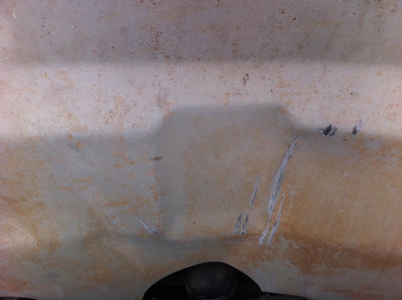

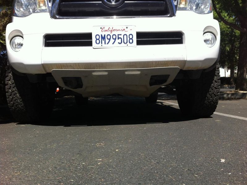

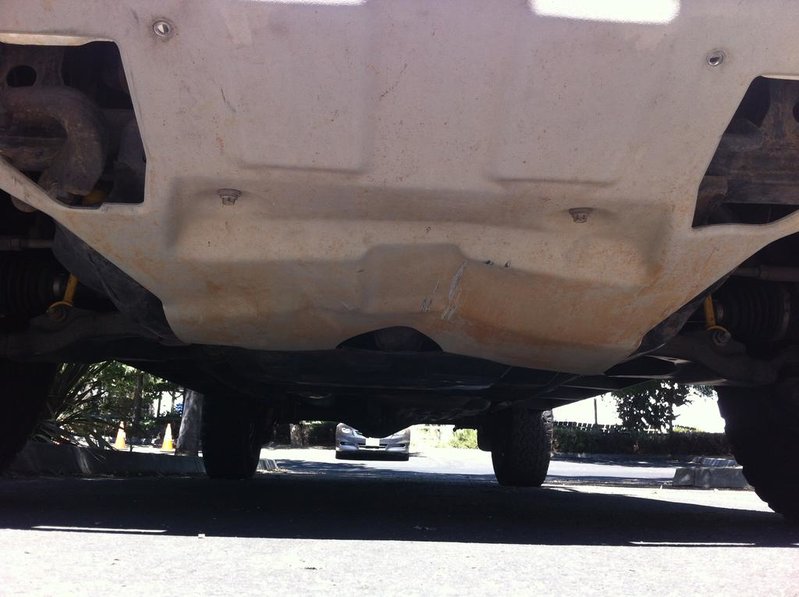

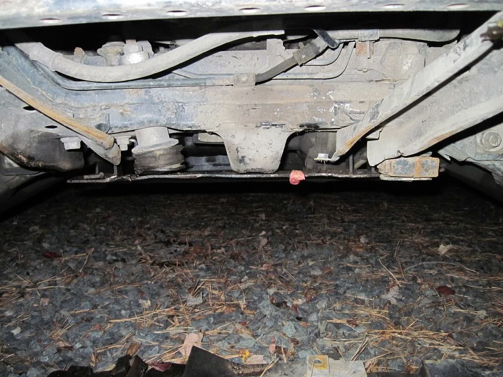

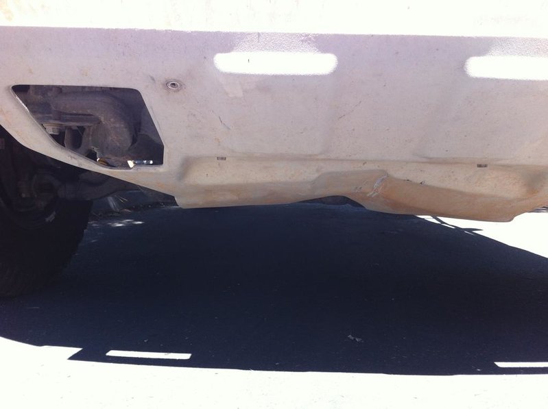

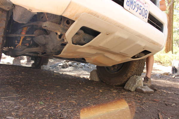

    you asked for it!
    and i threw in a pic of the phone... it's kind of weird cause its in a mirror, but I think you can figure it out haha
    Edit: and i know some of you will notice that the front two screws are out... i just did that, im going to take it off for now so thats why the bolts are missing.

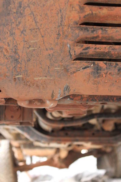

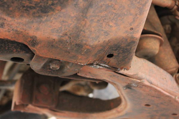

    You may be talking about my truck during this incident:
    http://www.tacomaworld.com/forum/ar...entire-weight-your-truck-ato-t-case-skid.html
    I was very impressed with how the skid held up. The crossmember was bent upward some as was the skid, but without it I'd have caved in my t-case, driveshaft, and possibly the ass-end of my trasmission housing. I was a little taken aback when I looked under the truck and saw the whole thing was balanced on, essentially, a rock point the size of a basketball. We could tip the truck corner to corner and side to side, It was prefectly (accidentally) balanced on the t-case skid and crossmember.

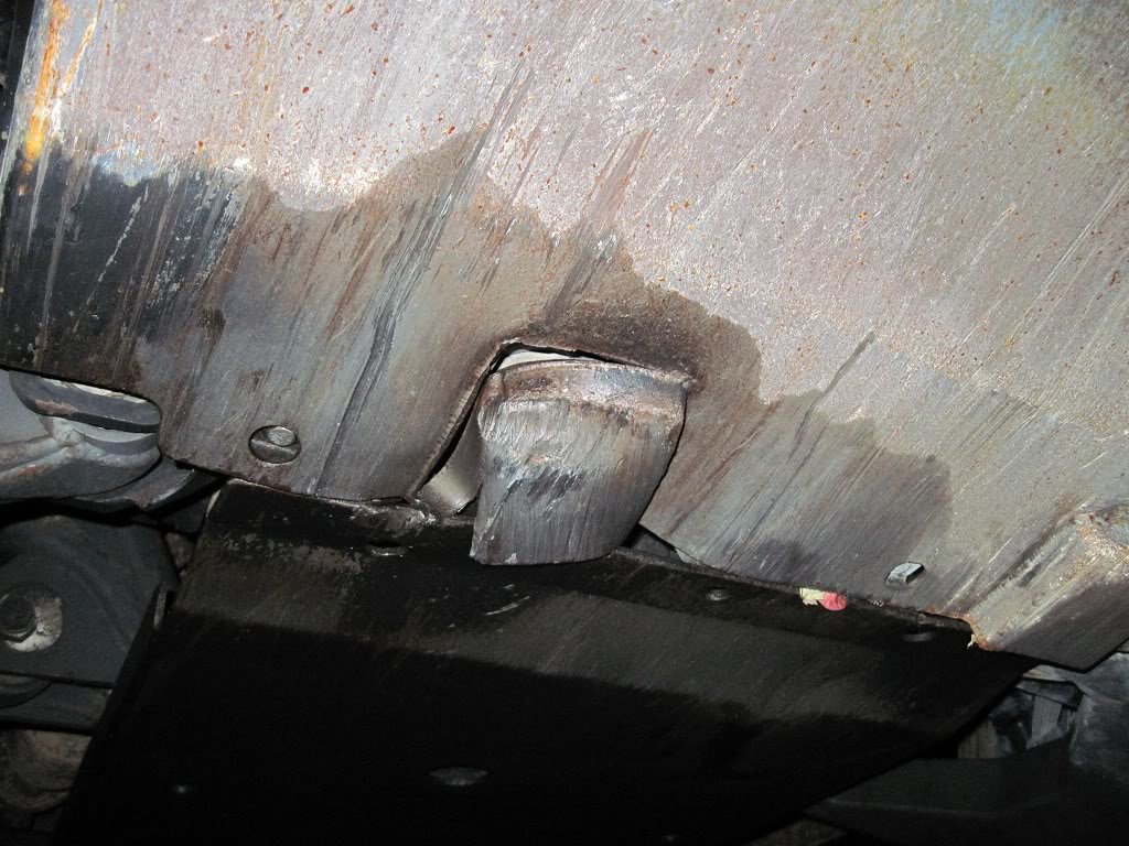

    This is good advice. Those t-case skids with the bumps/cutouts for the exhaust crosspipe just make me laugh when I see them. That's asking for this to happen:
    http://www.tacomaworld.com/forum/2nd-gen-tacomas/118545-remove-differential-drop-your-05-tacoma.html
    MJP2 crushed in his skid plate housing that was making room for his diff drop, cracked the differential mounting arm, pushed the differential upward into the crossmember and oilpan, bending the first and breaking open the second. Basically, fucked his front end hard.
    I'm not a fan of skids with hangup lumps in 'em. Just sayin.

    Those welds failed.
    It should also be noted that he races (really) his truck. As in race truck.
    It wouldn't be good to hit your crossover drop at those speeds but it should hold together. The welds broke on his. They should have been stronger than the parent metal.
