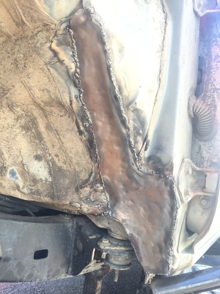

    I can finally be part of the tub club! :yay:
    Gonna start cutting the fenders tonight.
    Sadly I won't be ordering tires till July.

    what size steel are ya'll using for the tubing? Came up on a big piece of steel! I wanna tackle this!

    Also used 20ga. I wanted to use 16 but its too stiff to shape it without real body work tools.
    Fernando likes this.
