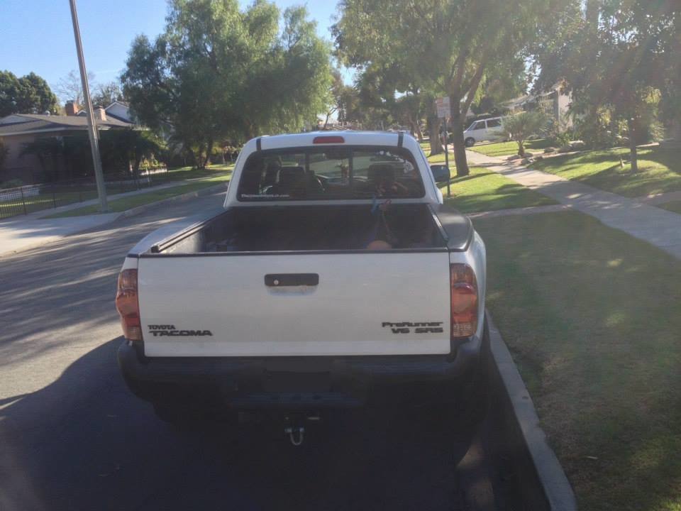

    Here's my 2007 Toyota Tacoma, TRD Off-Road, Access Cab, Prerunner.
    Currently Sits.
    2-16-18
    How she looked like the day I bought her.

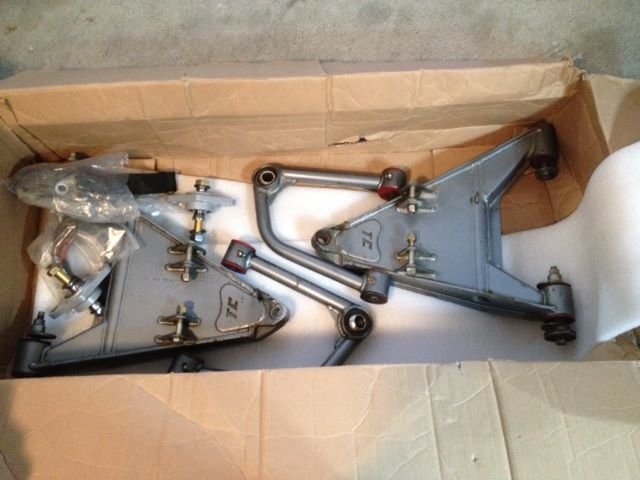

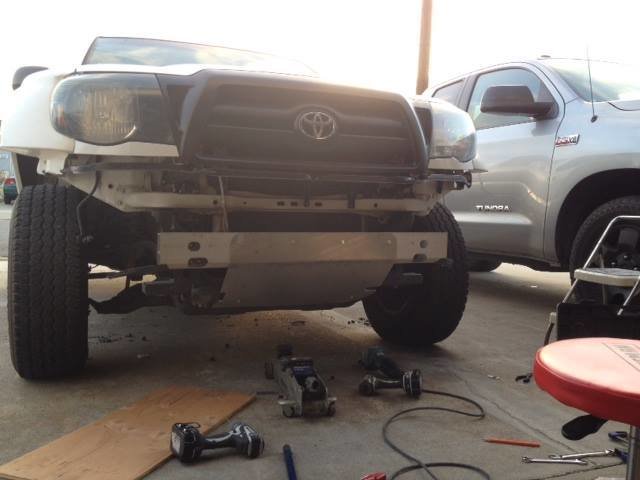

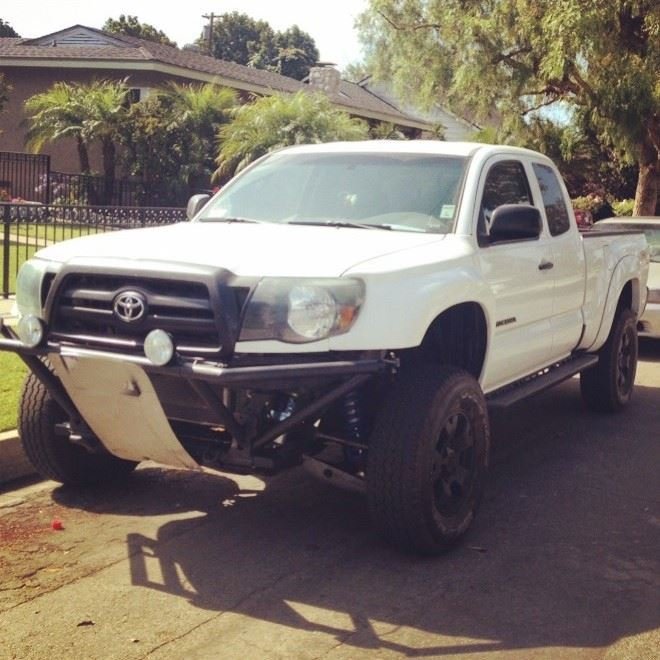

    6/12/14 Total Chaos 3" Long Travel kit
    10247207_1422089348076199_71929539364187_f699f3666d966b5eebf9dc8bd70e267d7d18b057.jpg

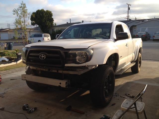

    6/14/14 Finished Welding Bumper and Gorman, CA trip
    10378087_1423259411292526_40381394216533_ecc6e1caab19510d2a33095b906db35db028a782.jpg

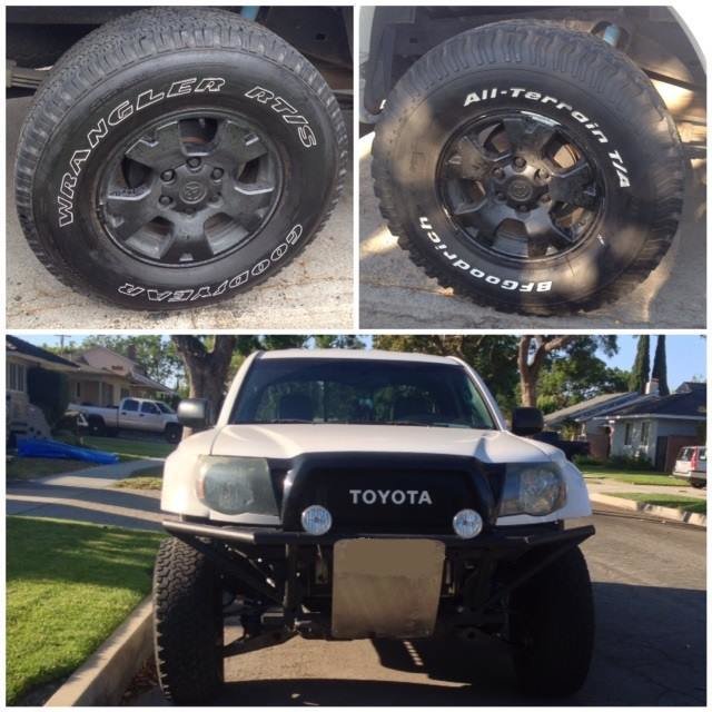

    7/17/14 1st set of used BFG A/T 285/75/16s
    10524573_1441722766112857_13784064129967_8f338877ea64cde9dc613e0f8349a72ad7908ca0.jpg

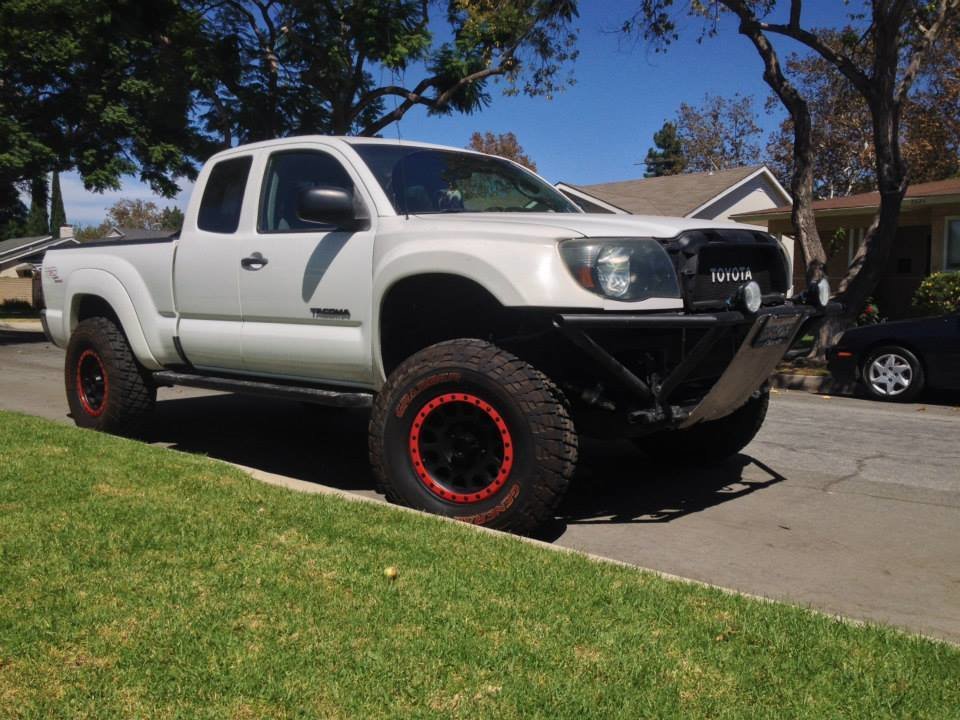

    8/26/14 Method NV wheels and General Grabber Red Letters 285/75R16s
    10646811_1459069497711517_18857232812975_a95c2482defd3a625f4ffaf7abd99fd6a9d65753.jpg
    8/31/14 Plasti Dipped my Method NV two tone.
    10653352_1466022617016205_89434788683630_b5eec1ed6a002eb3c524f709b9a1ffd04b0c72e2.jpg

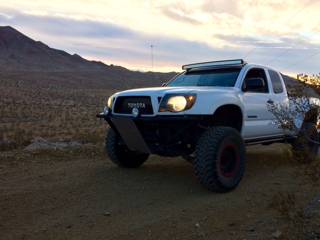

    5/17/15 50" Curved LED Lightbar.

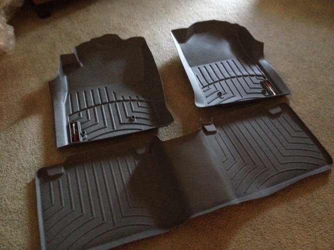

    -WeatherTech Floor Liner bought from a TacomaWorld Member. Group Buy.

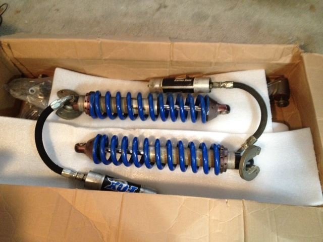

    -Total Chaos 3.5" Long Travel kit(Used) Installed Thread here.

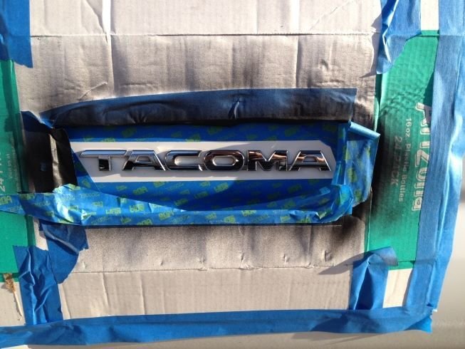

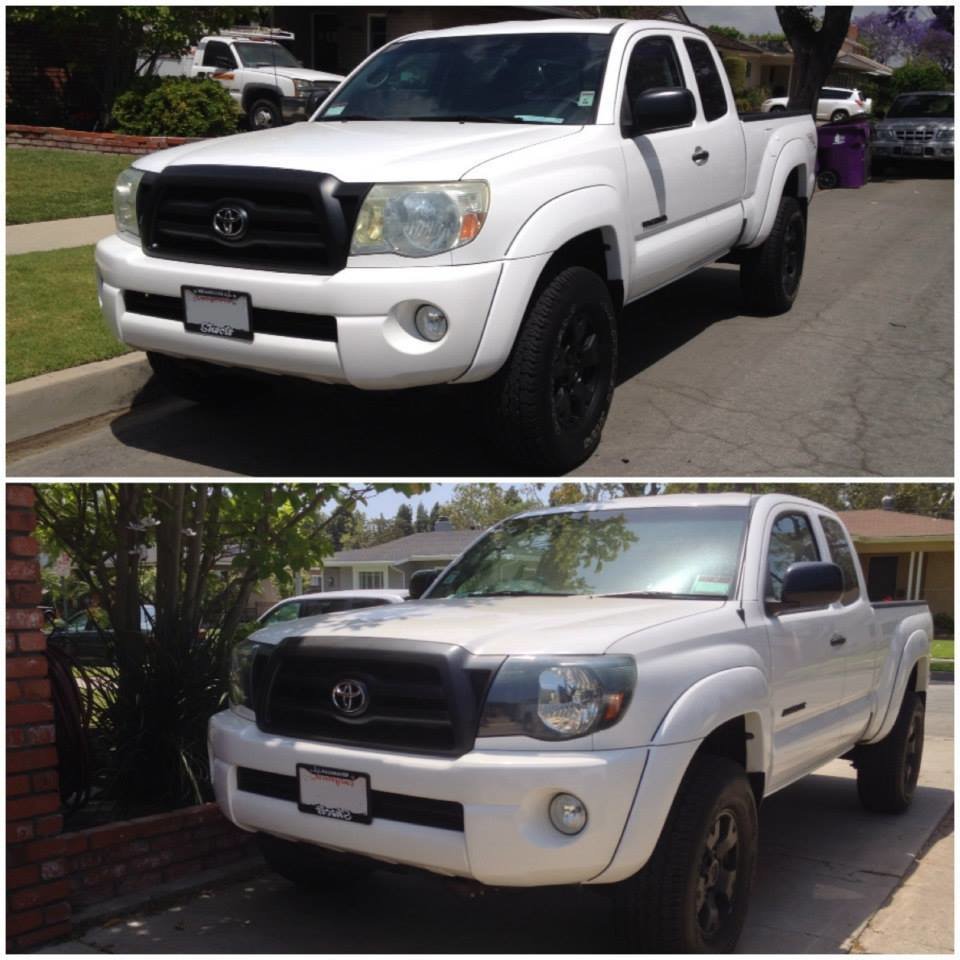

    Plasti Dip Rampage!!!!!
    I knew about this stuff and watched my friends use it, but never tried it myself. Till NOW!
    I used newspaper/magazine pages the next time I did it...
    1908014_1395230357428765_260794571414441_d4ebff194f4cb960cf95445ab141d50e2ec38463.jpg
    10308161_1395230350762099_89484132734090_9f12c27f6e02b8857b017f869658a365575b2bca.jpg
    10171119_1395230470762087_43611246009694_585c7e097258d6df7a09ab626381ce099cac8401.jpg
    My friends Tundra and my Tacoma. Brotherly love.
    Before and After.

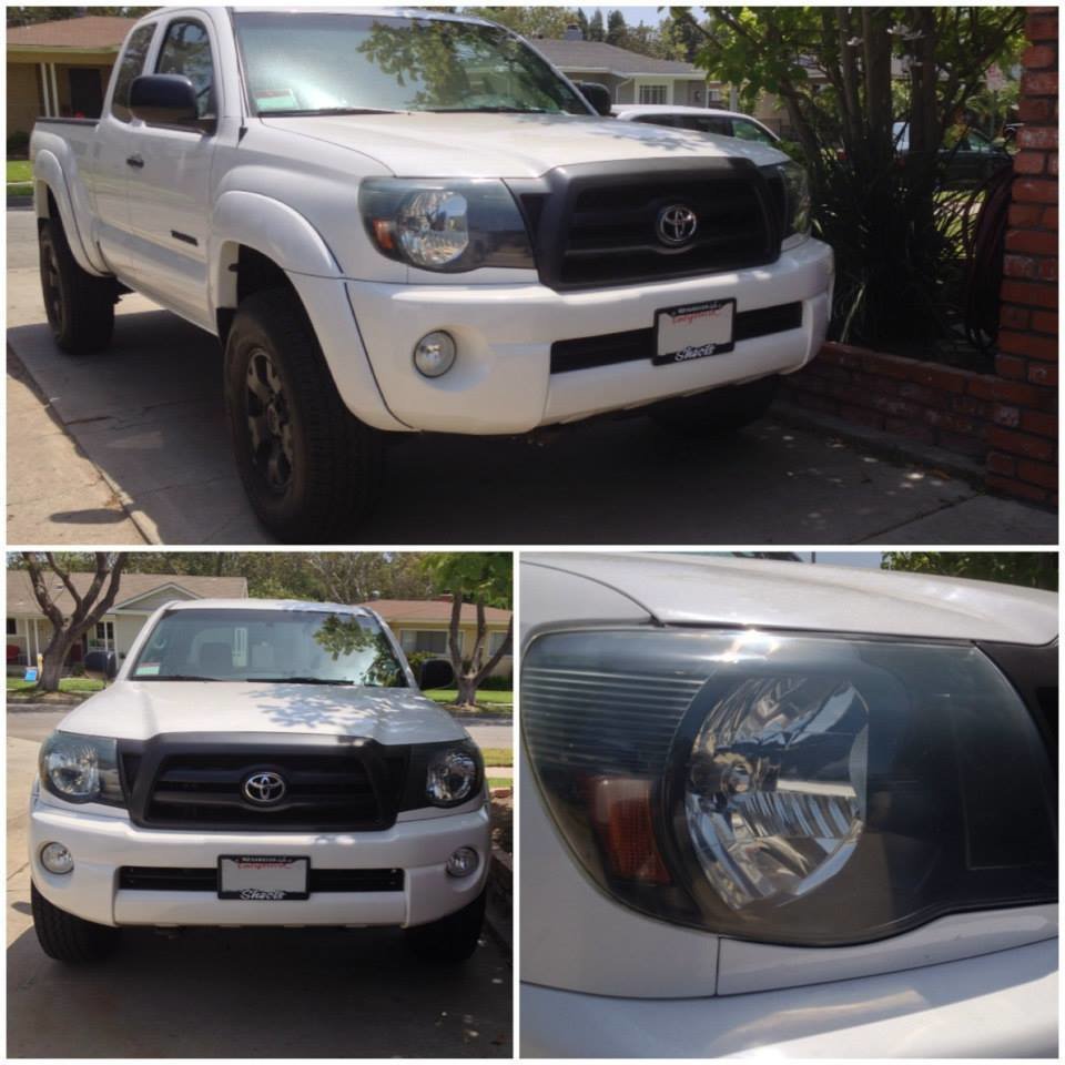

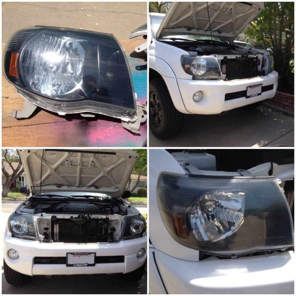

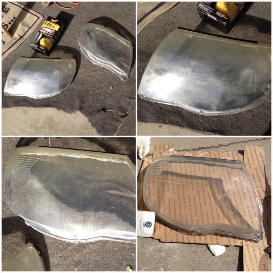

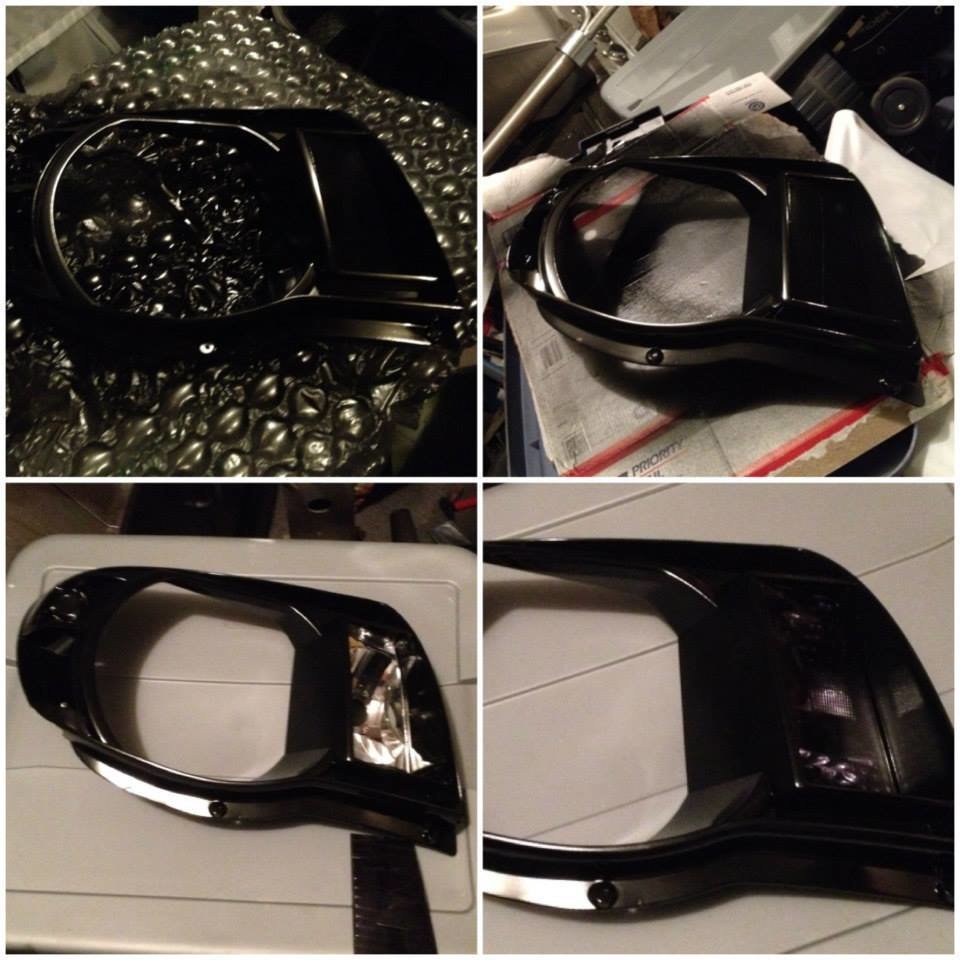

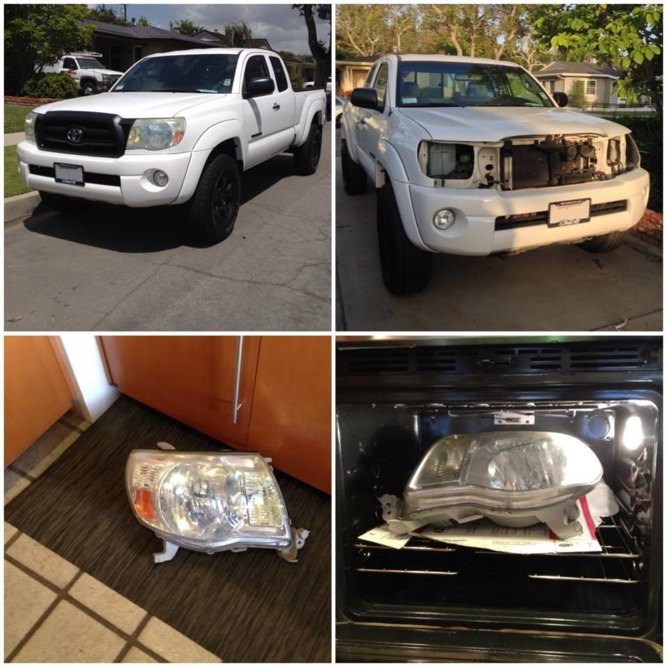

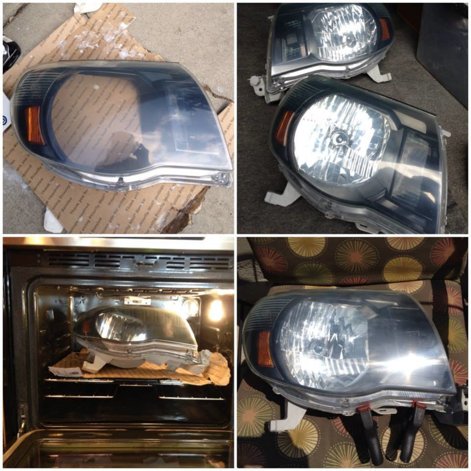

    Blacked out Headlight Mod.
    Got around to Blacking out my headlights and restoring them too. I love the way they came out.
    Basically I read this thread Here and just kind of winged it.
    It took about 6 hours all together.
    1st day after work took the headlight out, baked it, pulled apart, painted and tinted left to dry overnight. about 3 hours.
    2nd touched out paint, restored headlight, put all the reflectors/lenses in, put back in housing, baked, silicone, reinstalled everything. about 3 hours.
    Before vs After Comparison.
    10351080_1398025837149217_60045572903244_42f1b2910a730f074fb0679c70026783fec81bc1.jpg
    Materials
    -Flathead skinny.
    -Flathead a crappy one that you don't care will get messed up.
    -Torx screwdriver (I used an allen key that fit, but I had to push down to make sure it didn't slip or strip. You can use pliers too. Both will be a pain I wish I got the right tool.)
    -Old oven mitts
    -Oven
    -Cardboard
    -Valspar Plastic Gloss Black spraypaint.
    -Headlight/Taillight Smoke spraypaint.
    -Silicone.
    -Masking tape/Painter's tape.
    -Meguiar's 2-Step Headlight Restoration Kit Sanding and Polishing System
    -Sandpaper. I used 600grit all they had at Lowes and it worked good. I'd say anything between 600grit - 1,000grit will be good.
    -Spring clamps(Forgot to add to picture)
    10313352_1397993877152413_65868258462273_c1dd4f3fc3e82b34ecbf56441a0da19e1b09cac4.jpg
    Before picture.
    Taking off headlights.
    Getting headlight prepped.
    Baking headlight in the oven set at 200°F for 10 minutes.
    10330504_1397907723827695_21572329932464_1a9923d2083dff39a4505141e81408a3f47a2ba0.jpg
    Pulled headlight housing apart, Sanded and Masked the Blinkers.
    Back view of Blinker lens.
    Blinker lens inside housing.
    Light coat of spraypaint
    10245458_1397907717161029_22043779068707_76424f25708477fee7fa7fc0e8b2875e1e874fe6.jpg
    2nd coat of paint.
    3rd coat of paint drying.
    Took the blinker lens off and took off the tape.
    Tinted the blinker lens and reattached the blinker lens.
    10338855_1397907720494362_86162884765019_2dd4908c10cdf32cd8b82c8bf56ff058d0e3d66f.jpg
    Before headlight restoration.
    After sanding and and using the PlastiX(Buffing cutter compound).
    1908012_1397907767161024_229047348157582_7539d5442dfb2dbec9d82b908fb1faadde01724a.jpg
    Cleaned and painted part installed on headlight lens.
    Test fit getting ready for the oven.
    In the oven set at 200°F for 10 minutes.
    Smashed the headlight back together and made sure the clips were on. Also used spring clamps to help hold it together.
    10277510_1397907790494355_69305396211851_071a2432f3c1b04e42164654130f7fd87e7ff749.jpg
    Put a bead of silicone around the entire headlight.
    Put headlights side view.
    Headlights front view.
    Close up.
    10172722_1397907797161021_30976772397023_bbab7fef6314e25b33707dd545b186b902cd669c.jpg
    Reattached grill and Finished!
    1958170_1397907810494353_681084651426152_8a3a959fdac9a891bfee5406af4435ddd18104e2.jpg
    Hazards on.
    https://www.youtube.com/watch?v=g9ypqk4nCCA

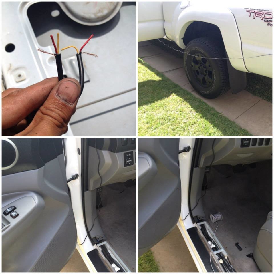

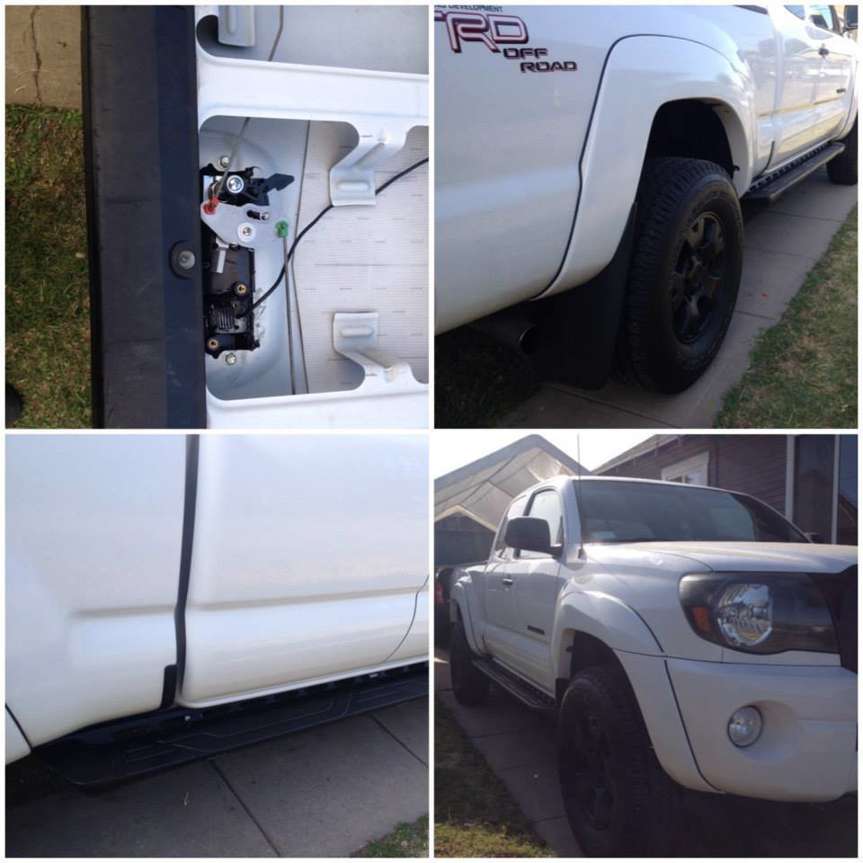

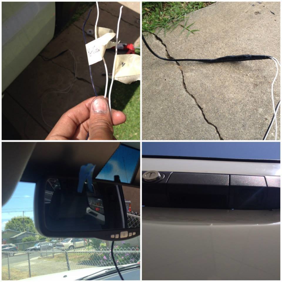

    Pop & Lock and Mirror Back Up Camera.
    After my friend told and showed me how easy it was to take off my tailgate I looked it up here and got super paranoid. I went to go look for a locking tailgate and found a Pop & Lock I was about to order it and saw one saying "With backup camera mount" and one "Without"
    I went ahead and ordered the one with a backup camera mount.
    By the way my Tacoma didn't have a backup camera when I got it.
    So I looked around for a backup camera and found the Peak Rearview Mirror Back Up Camera System. I figured I could make it work and I did some dremeling and modifying to make it fit and work. I heard the closer the transmitter is to the screen the less interruptions and cutouts you will get so I mounted it to my front windshield.
    Pop & Lock and Peak Rearview Mirror Back Up Camera System.
    The stock tailgate latch (No backup camera).
    Took off the tailgate plastic cover.
    Made sure the tailgate lock worked.
    10289789_1400402403578227_86447602780818_7936e09a91a3b5f5af99438862f96111cdd6ccbe.jpg
    Putting Camera in place seeing how much wire I need and where to cut it. Running the wire threw the drain hole in the tailgate.
    Wire with tailgate up.
    Ran the wire behind the bumper.(Picture was taken under the bed by the rear bumper)
    10308112_1400402413578226_15966601482138_e32cabfe24f8042eb3bcce537267ddfc88f178b4.jpg
    Cut and stripped the wire cover off.
    Measuring how much extra wire I need and then some.
    Made sure the orginal wire that plugs into the transmitter goes under the door step plastic.
    Another picture of the wire I ran from the tailgate.
    10299085_1400402410244893_51452676946171_ccbed5da29acf8ede3902f4f016142e1e381011b.jpg
    Labeled what color the wire that was connected to know where to connect them back to the same wires.
    Wrapped them up individually then all together with electrical tape.
    Hard to see in the picture, but the camera is on. (I used tape to make it easier to see from the tailgate when moving the camera.)
    Camera mounted with Black Silicone again hard to see in the picture.. — with Peak Backup Camera.

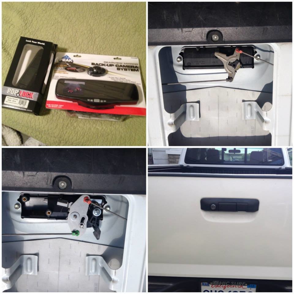

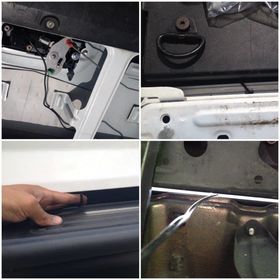

    10264415_1400402456911555_64239609644699_5e8fefe79d779cba915488caaa35f2bfe6f01b91.jpg
    After the silicone dried a bit. I took off the tape holding the camera and started to Silicone the back and let that dry. Then put the tailgate cover back on.
    Put my dad's Double Cab running boards on. I had to drill new holes so they would mount correctly. They look a little awkward since they go past the my cab, but they look good to me!
    10357119_1400402460244888_22766086961759_a221852855e3a944ed1265880ee2725497801e9f.jpg

    Total Chaos 3.5 Long Travel Kit.
    I got a couple packages in the mail!
    10274293_1407340182884449_50585458535584_29b5f3c873ed57d64770da01ec61f965ef7522f3.jpg
    10365845_1407340186217782_67603751251567_d0e5a7c3ff8327e154c381151f258fd4a099e65d.jpg
    Just waiting on some hardware.

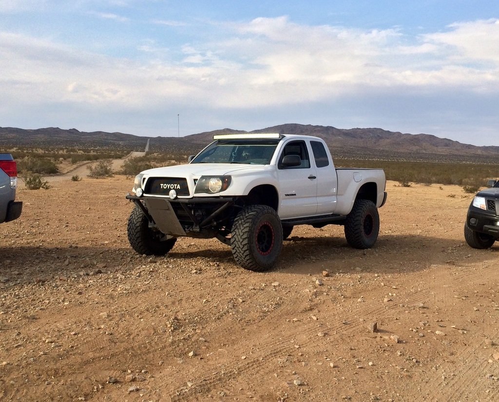

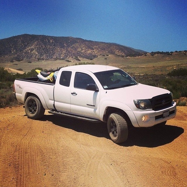

    Gorman, CA
    Finally was able to take my new truck out! Only damage I got was a dirt biker lost his balance (first time rider with his friend) crashed into the side of my bed when I pulled over to let them by. After I checked on him, picked up his bike and talked with them a bit. I got back into my truck and told my girlfriend "Oh well, now I have an excuse to get fiberglass bedsides too right?" :D
    5:00am just about to leave to Gorman.
    Messing around with the Instagram settings.
    :D We all had a great time.
    All of us had GoPros too. I just need to get all the files from everyone then find time to edit all of them.

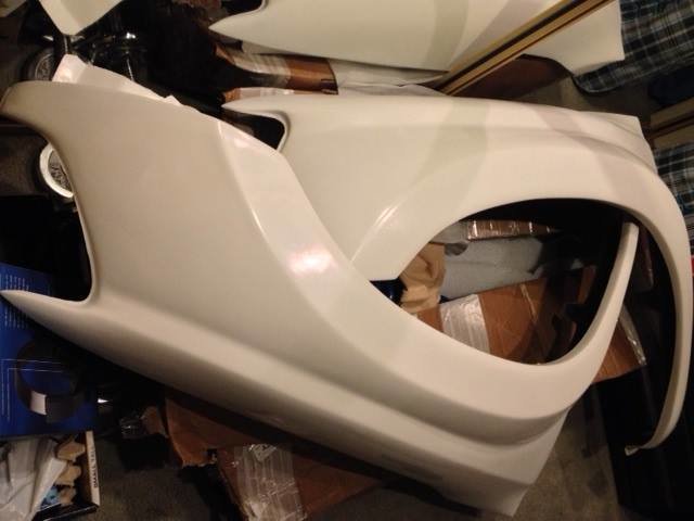

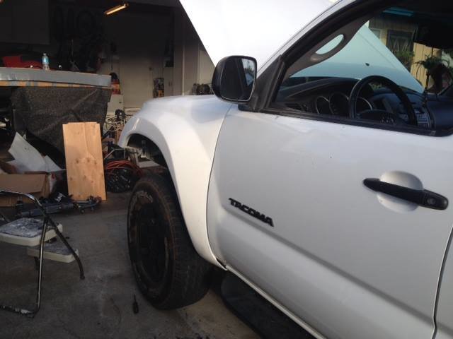

    Glassworks Unlimited Fenders with 4″ Flare and 3″ Rise.
    Met up with John at Glassworks Unlimited and bought some fenders! I found out Glassworks is about 10 mins away from my house lol.
    10350519_1419326355019165_37940783714662_9b6203b174d92ff8112b85f8ba5ea82e94350fb3.jpg
    My Tacoma pile in my room.
    10455129_1419326358352498_11422850494947_db0342d472040dde3d697ada3117f6b4c02a5222.jpg
    Finally got around to putting them on. 6-11-14.
    Test Fitting and see how it would look.
    10426292_1421523718132762_10970795936073_5ae41b5e09b296920cd708a06243ad82b5cb3b05.jpg
    10464322_1421523721466095_79724303438078_cb54f96f9c576a3ef54ca8a7d52b90ea28414bc0.jpg
    Side view
    10409634_1421523724799428_21788622487486_388c87067c8c35ac01f2b2e997897e9833131f3e.jpg
    Passenger side.
    10390406_1421523754799425_74555574524197_72f538ac4527f9370bbdc23996e26add20b01873.jpg
    Front view finished.
    10472732_1421523758132758_27843288972227_2e79a54286e3a8e9322a03abdb4725fa5aac54dd.jpg
    It was defiantly an adventure putting these on. I took off the driver side stock fender and my friend took off the passenger side till we got to the antenna (Headache). Finally got the passenger side stock fender off and we both installed the driver side fiberglass fenders pretty easy, minor very trimming. Then started the passenger side we had to take it off a bunch of times and trim it a lot it was annoying... We finished up and started to put the bumper on and I hated the look. We took it off and took a little break. I grabbed a piece of wood and held it up like a skid plate and the hamsters started rolling. My friend took a street sign he had in his room and we used sheet metal screws then hit it with a hammer to bend it! It looked better and was fun messing around. When I was working on the driver side fender I was looking on the ground for tools or bolts and hit my head on the fiberglass fender I looked at my friend and said "It's so wide" and we started dying lol!
