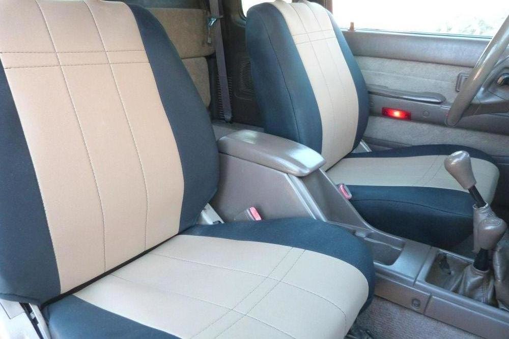

    FINALLY got my seat covers... after the WO fiasco I got these Caltrends for $135 and less than 2 weeks after ordering them. They look decent, if I can get 4-5 years of solid service out of them I'll be reasonably happy.

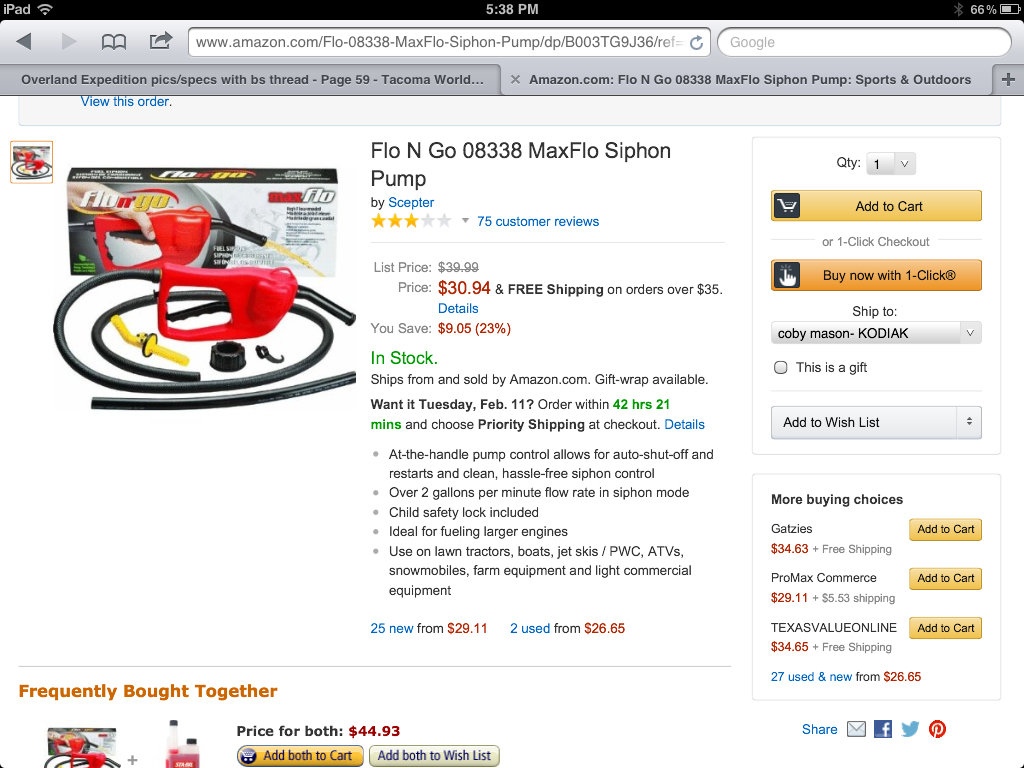

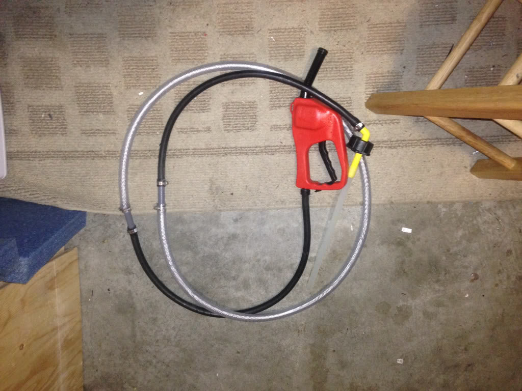

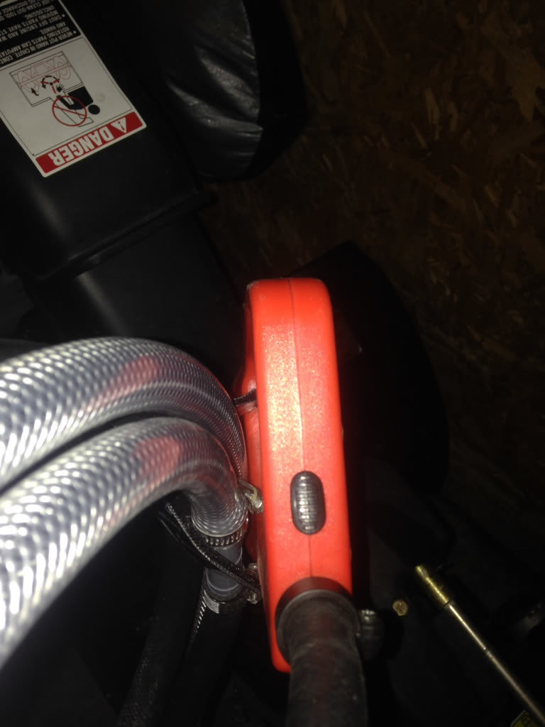

    Its been awhile but here is my write up
    Ok so I started with a flo n go max flo that I got off of Amazon
    914249513591619acc6a0154e3eb8e48_zps4404_8861380eaf5aea411580992114da44c4469603b8.jpg
    The hose wasn't quite long enough so I went and got some 1/2 in hose to extend the length out ( I need to cut it down some now it's too long :rolleyes:) also got some 1/2in plastic junctions and some tube clamps
    Ended up with this
    3f641ec924f7ae2637a6a75373b4ee50_zpsd204_3ada79707da35e3490c37332ba451f4e653156e8.jpg

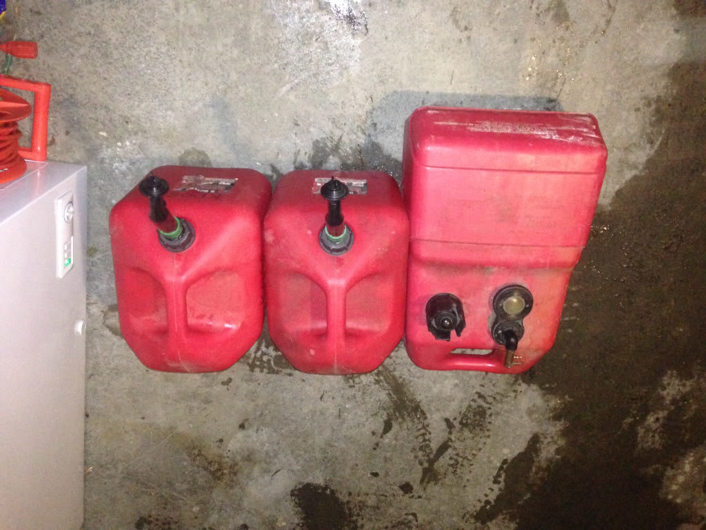

    So I have 3 fuel tanks that I can use (2) 5gal tanks and (1) 6gal boat fuel tank.
    8982254379599856b1946f818727d990_zps8ee8_f6721642c3b749dd9755440f85451ddddecb6ab0.jpg
    I trimmed the fuel pick up tube so it would be just above the bottom of the 5 gal tanks and for the boat tank I just put it in at an angle.

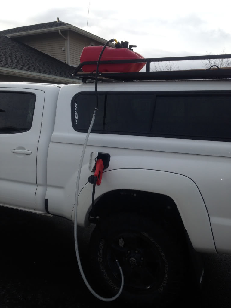

    All 3 will be mounted on the front side of the rack. 0f2421762f87992249e8fa3f4bff0ac5_zpse9b4_5b98663e1ac67cb687bf6307b26ecc350f00b153.jpg

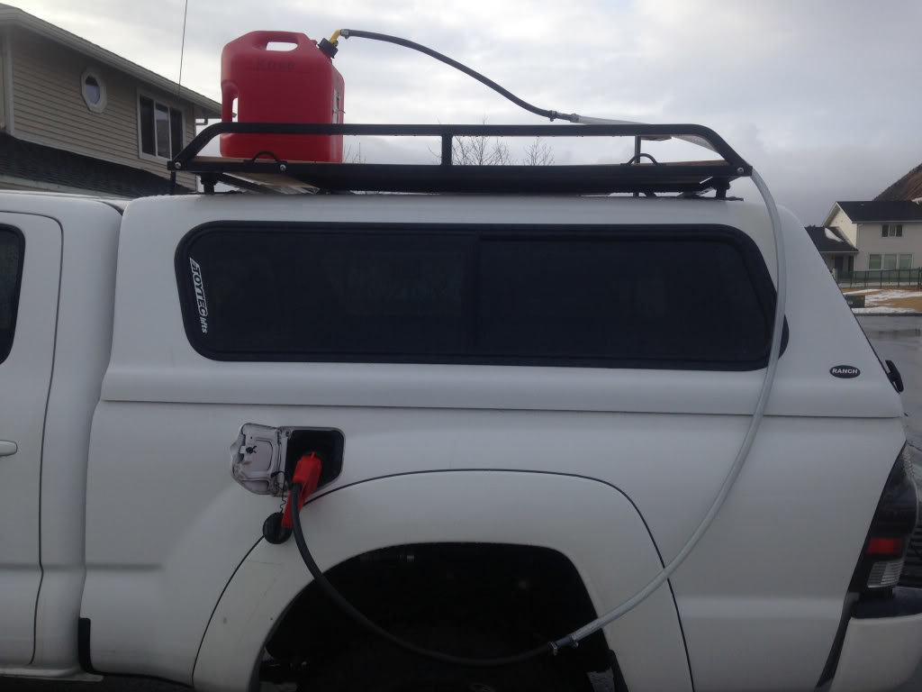

    And to get flow started just push down on the black tab and give the handle a few priming pumps and then just hold it open. The flow is pretty good once it starts flowing. Now I just need to make some thing to hold the handle full open so I don't have to hold my hand on it.
    5 gal
    df82784d7634565c96cbcdbec3ecf282_zpsc38c_7c2571fcd15bf59550626cf6f134249340902ba7.jpg
    6 gal
    5562eb35172fbaf4478ac4d18dc1ca9e_zpscbc0_e67b1736bb35a21e630ea360efe9836965a59727.jpg

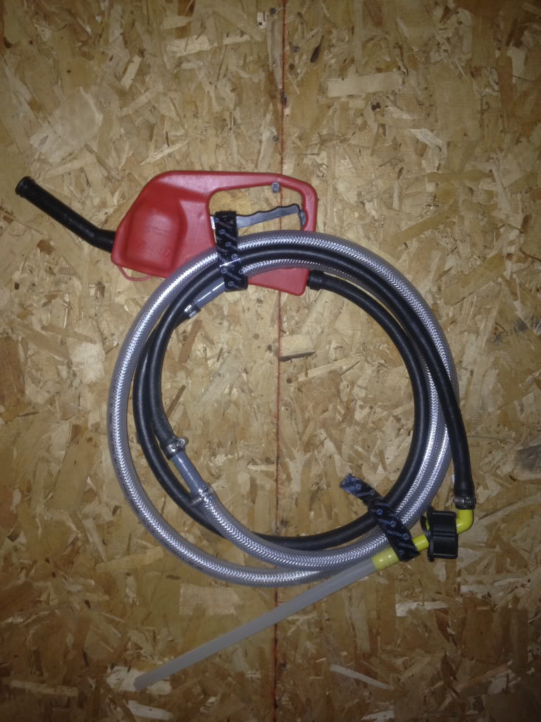

    Obviously there is enough slack to just leave the tanks all strapped down and just remove the caps and just insert the fuel pic up tube. All done and coiled up.
    7a5701a4bec45b4ad88efaee28536e60_zps637d_1fba76325b3e40138f9947073343fe403d653157.jpg

    Thanks for the update. Might be a dumb question, but will it pump from the tailgate, in case you had the fuel in your bed... or even from the ground? I suspect it might but the flow may be terrible.

    The flow from the bed wasn't too bad once the flow is primed by pumping the handle. But I still have normal fuel spouts in the five gal cans if anything happens to the hose.

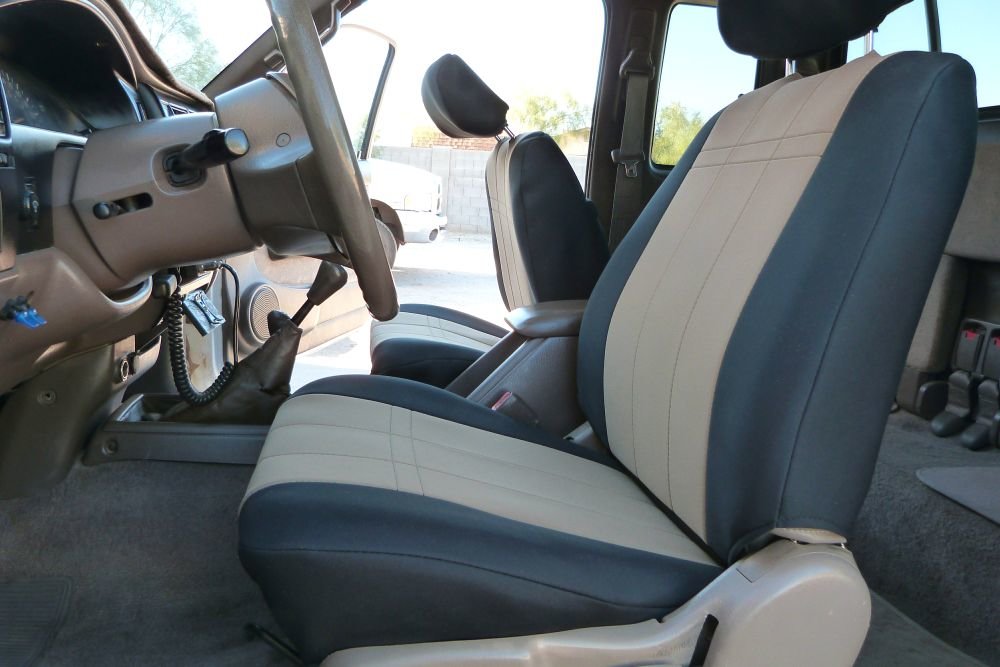

    Caltrends Neoprene seat cover update: These have been on since early December and have seen medium-hard use. Although the price was reasonable and shipping fast, I'm afraid these are not holding up too well. I'll edit a pic on here when I get the chance, but there is some fraying on the driver seat. I'm pretty disappointed.

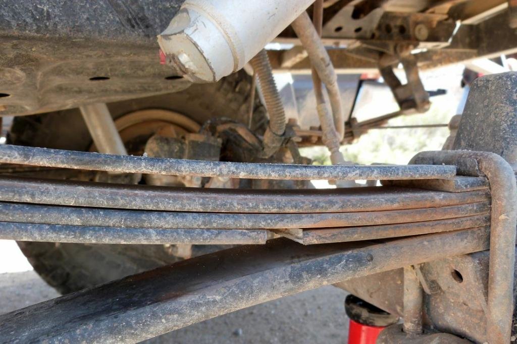

    Rear spring update: I removed the 5 year old Wheelers 5 leaf HD springs because I broke one (see pic in previous post). I put on new OME Dakars and went back to my trusty (and cheap) shocks I like from before. I was not real happy with the Rancho 9000s. Here is a thread on that.
