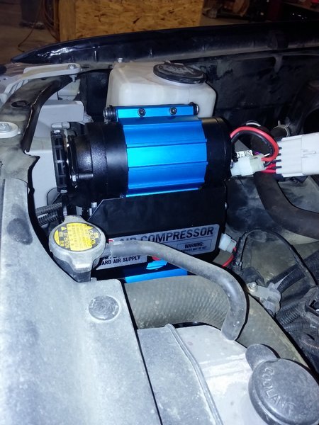

    Added the ARB twin compressor to the rig, need to get a shot of the wiring and switch install. Could have got a different switch so I didnt have to dremel the hole out as much, but I liked the ARB rocker switch that lights up.
    I installed it with the Slee off road ARB twin mount, its a nice mount. Even has a plate for the ARB manifold I am not using currently. So I will drill a hole and tap it to thread in the 90 degree fitting that comes with the slee mount. Then I can have the ARB quick connect disconnect mounted temporarily up at the compressor. I will be running 2 lines with quick connects one out the front somewhere, and one to the rear. That way I wont even have to pop the hood to air up. Just flip the switch and bam.

    Spent Saturday working on the rig. Got all the things airline and compressor done.
    Cleaned up the wiring for the compressor. Redone with black zip ties.
    Modified the Slee off road ARB twin mount for my needs. Then mounted it.
    Ran a 25' x 3/8" airline with 1/4" NPT fittings on both ends, from the compressor to the rear of the truck, mounted in the bed box right under my diff breather with an ARB quick connect.
    Could not be happier with how this turned out:yes:
    Dreamed about it for weeks, then made it happen just as I saw it laid out for me. :D
