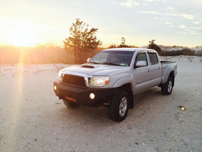

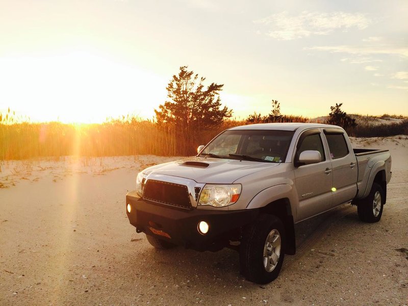

    Alright. Went with a steel Body ARmor bumper because it was cheap 900, no shipping and can be picked up at my local 4x4 shop. Went with the ToyTech ULK for the 3" lift and a new black grill with chrome trim. Threw in a K&N Air filter in there too.

    Rode real nice on the beach. Everything works great, bumper has a little rattle to it, working on modding that.
    Thanks
