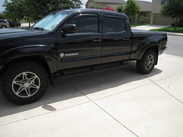

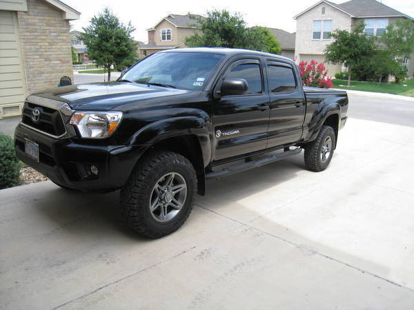

    I'll post my numbers in a minute. Rough numbers gave me about 2.5" all around though.
    Before:
    After:
    CV Angles:

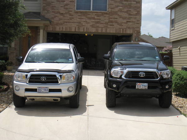

    My helper also drives a Taco....lifted vs non-lifted:

    What did you put up front & what did you get?
    885s on 90000 Sport Nitros gave me 2.5" w/ 1/4" top place spacers.
    What did you put in back & what did you get?
    Dakars gave me 2" w/ tonneau, my stock leafs only had about 1,000 miles on them. Recently had the drive line vibration TSB done.
    If you got Dakars on a 2nd Gen share your measurements with OZ 2nd Gen OME Dakar hub to fender measurements ([​IMG] 1 2 3 ... Last Page)
    I'll get to that later.....
    Are you running trail armor & how much lift did you loose or what did you do to regain/maintain lift?
    No armor or bumper
    Tire & wheel specs & rub or what you did to eliminate rub.
    265/70/17 Duratracs. No rubbing yet. Already removed small front flaps..
    Are you still running a sway bar?
    Yes.

    Everything looks really good! CVs don't look taxed. And... You got it done in one day!

    Took about 7 hours for everything, except the brake lines. Haven't put those on yet. We definitely didn't rush either. Luckily it was smoothly for the most part. Those UCA bolts were a bitch though!
    The CV boot splines (or whatever you call them) are barely touching each other so hopefully they won't fail any time soon. I didn't get as much lift as some folks. Not sure why. Rides really nice. Now I just need to find a place that'll do my alignment for me.

    So you only got 2.5" with 885's and the top plates installed?

    Yeah, I didn't get quite as much lift as some people are reporting. I definitely could have went with the 1/2" spacers in the front. The Dakars only gave me about 2" of lift as well. I need to double check my actual measurements for the front but I'm at 24" in the rear. I'll do another measurement this afternoon.

    You did 885's AND the 1/4" top plate spacers and you only got 2.5"? That's odd... I got the same 2" from my 884's and with the 1/4" top plates I would be sitting at the same height as you.

    Interesting... I've got 1/2" spacers and was thinking of going to 1/4" instead... Everyone gets something different! Now WTF do I do??!! :annoyed:
    and only 2" with Dakars?... Hmmmm
