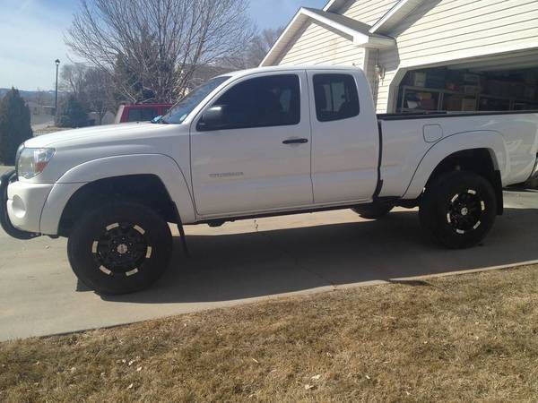

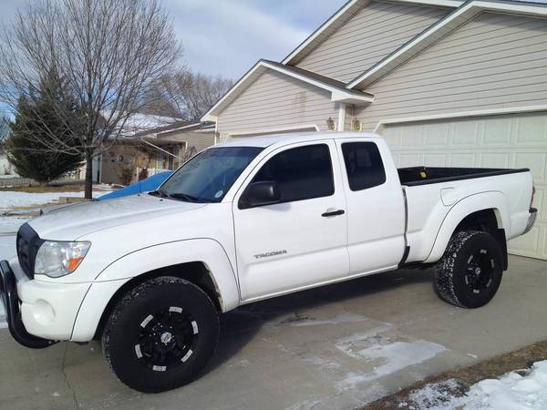

    here is my 2010 access cab before and after OME lift.
    [​IMG][​IMG]

    ^ looks awesome! We need details! Like this-
    If you have OME post a pic or two & tell us what you got.
    What did you put up front & what did you get?
    What did you put in back & what did you get?
    If you got Dakars on a 2nd Gen share your measurements with OZ 2nd Gen OME Dakar hub to fender measurements
    Are you running trail armor & how much lift did you loose or what did you do to regain/maintain lift?
    Tire & wheel specs & rub or what you did to eliminate rub.
    Are you still running a sway bar?

    this is for the picts posted above in post #756
    Thanks i think it looks awesome myself and ride quality was not compromised i will however invest in some light racing UCA's to get better caster results but no complaints on ride at all best investment so far:D

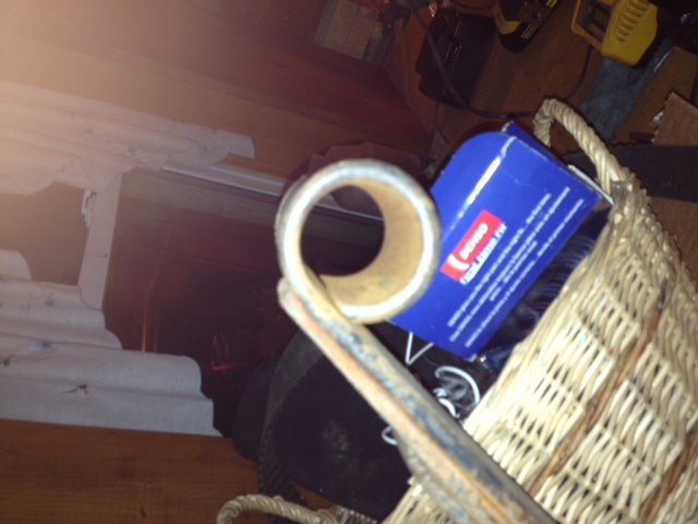

    SO! I got a set of used Dakars for my first gen. They were wicked cheap and are in great shape. But, one side is missing the little bushing sleeve thingy. Anyone know where to get one? worst comes to worst i can chop up a poly bushing to make it work, but i want a sleeve... :(
    Also Where can i find new friction pads?

    With second gens you can use OEM bushings in the dakars, so if that is the case with first gens (which i dont know) you can get them pretty quick from the stealership or online

    Is it the front or rear bushing that is missing ? Looks to be the rear
    http://www.trail-gear.com/leaf-springs
