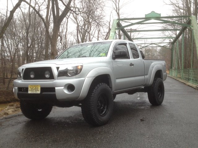

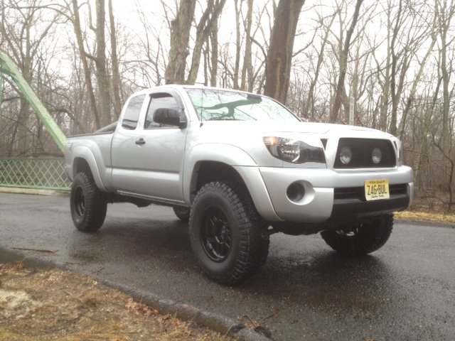

    Thanks, I'll update from the initial installation a few weeks back..
    05 Access cab
    What did you put up front & what did you get?
    885's & Nitro Charger struts
    Before
    LF 20.0" RF 20.5"
    After
    LF 23.25 RF 23.5"
    What did you put in back & what did you get?
    Before
    LR 21.5" RR 21.5"
    After
    LR 25.5" RR 25.5"
    Are you running trail armor & how much lift did you loose or what did you do to regain/maintain lift?
    No trail armor.. yet. Planning on adding a rear bumper with swing out tire carrier, front mid & diff skid plates & possibly a front bumper eventually.
    Tire & wheel specs & rub or what you did to eliminate rub.
    Are you still running a sway bar?
    285/70/17 Tread Wright Guard Dog M/T's on SCS Stealth 6 rims (17x8.5") I had minimal trimming to do on the front bumper, fender flare behind the tire & a little massaging to the inner fender well. Look's like I'll get away without having to do the cab mount chop :D
    I removed the sway bar during the lift installation & the truck drives great on road, with the new tires as well.. just keep two hands on the wheel :rolleyes:

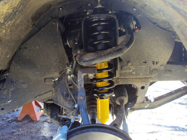

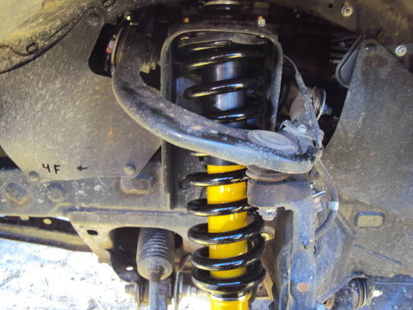

    Hey guys im looking for some help, I recently installed OME 885 and nitro shocks w/ stock uppers and threw on 285s. The ride is great on and off road but the issue is it sounds like my suspension is loose!! More specifically when hitting large bumps, heck even small bumps, it sounds kind of like the suspension is either bottoming out or compressing too much?!? It is coming from both sides. I read on another thread that some said it might be the stock control arm drooping too much and hitting the spring but I dont see any evidence of this...
    The sound is severe enough to where it sounds as if i jumped the truck and landed hard but that not the case! even driving down a wash board its like *bump *bump*bump*bump... so annoying.
    Oh and the shocks were preassembled and I did the install myself.

    Is your sway bar contacting the coils ?

    Do you have any pictures of the suspension?

    Is it just me or does the top of the driver's side coil look weird , like there is a gap at the top front ?
