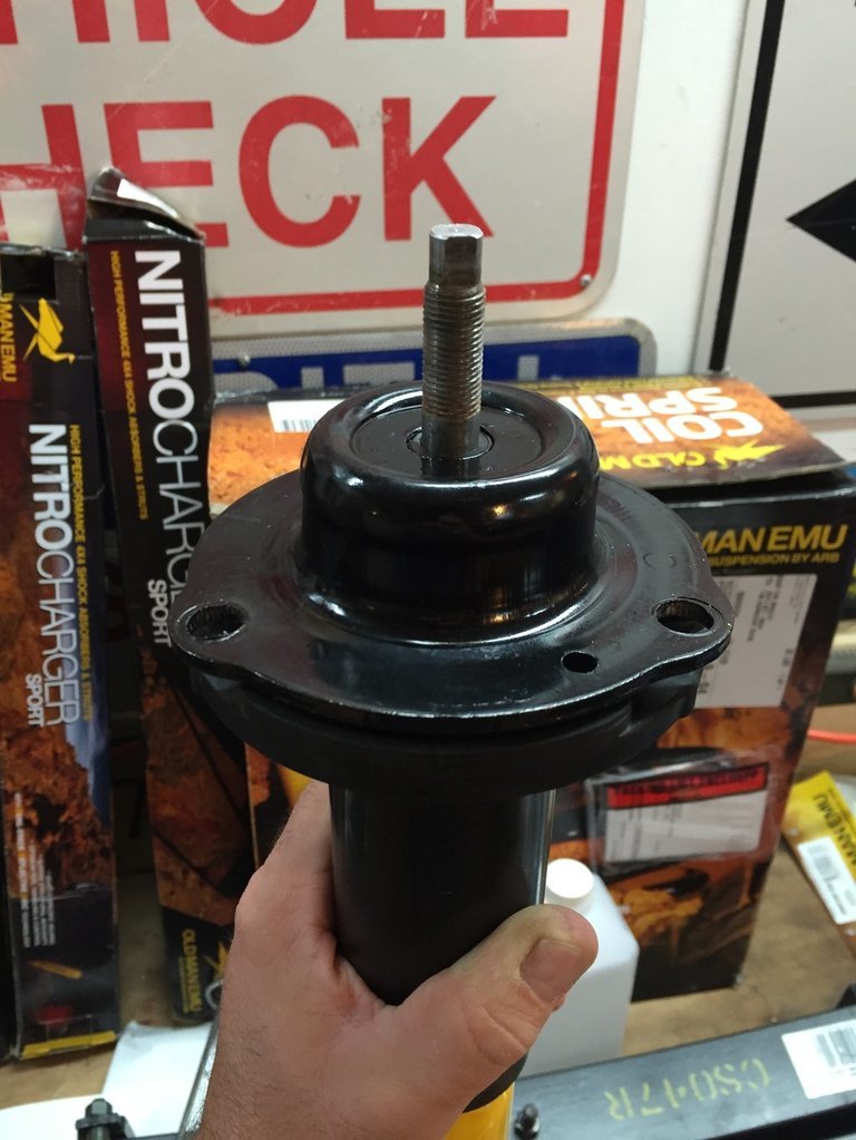

    You're good. The spacer goes on top of the assembly. No need to Take anything apart.
    I don't have an assembled pic, but it goes right on top of this. Between it and the upper mount.

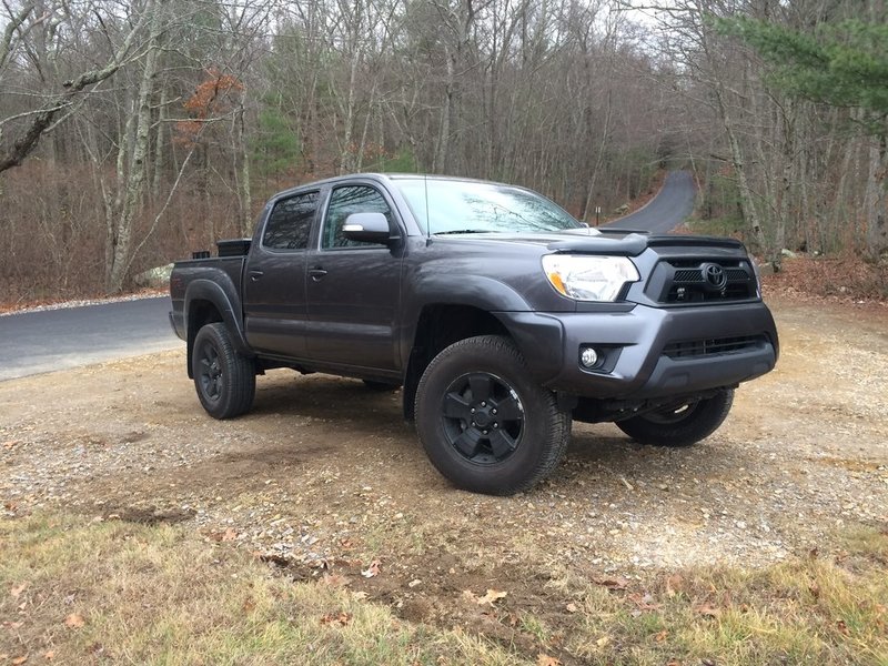

    I wouldn't use 886 try the 885! image.jpgThis is my current set up and with almost 200 lbs. the ride is rough!!!

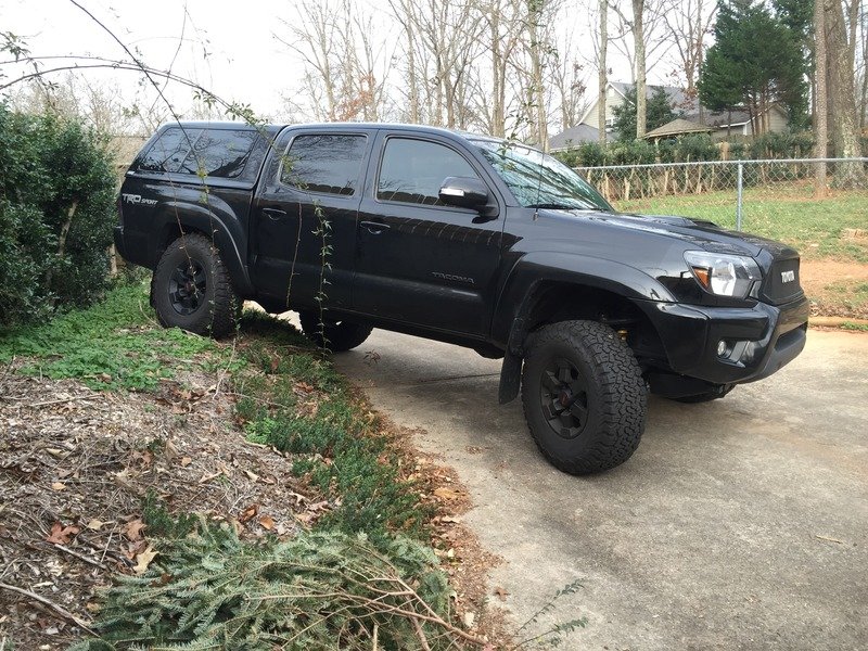

    Truck is 2015 4wd Sport with ~10k.
    So I installed my 887s and dakars back 7k miles ago and besides the creaking dakars and some spring/sway bar contact (remedied by a sway bar relocate), I've been really happy with the lift.
    I installed 285s a few months back and had a little rubbing on the inner portion of front mud flap. I took a heat gun and molded the plastic back and rubbed no more on the street.
    I was recently checking articulating clearance on the hill in my driveway to make sure it didn't need anything else to clear the 285s. I first backed up the hill like this...
    B8B5897F-CFF2-45AC-BAF5-F3122A1CEC03_zps_31d6e3e8828e621cec8900d90712dfefa5e3682d.jpg
    Everything looked good... No rubbing the CM or anywhere else.
    I pulled up, turned around, and then put the driver's front tire in the same spot. No rubbing anywhere there either.
    Thought all was well and good. Backed down and backed into the carport. Truck sat for a wet/rainy day or two. And I went to get in two days ago, started it up, turned the wheels a bit to pull out, and there was a loud pop/clank from the driverside front suspension.
    It has happened a couple of times since then. Slow speed (0-5mph) and happens intermittently while turning.
    I looked underneath and everything looks fine. I plan to get my buddy's torque wrench and recheck all bolts we loosened during initial install. Anything else I should be looking at?
    Appreciate any help...

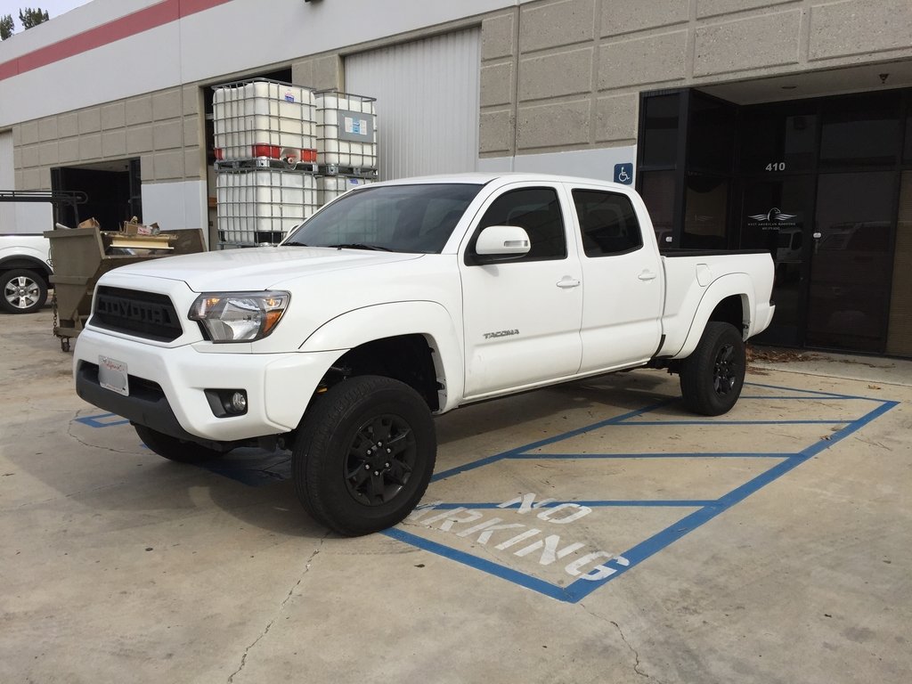

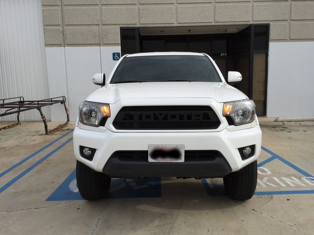

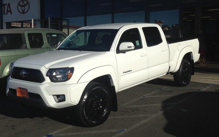

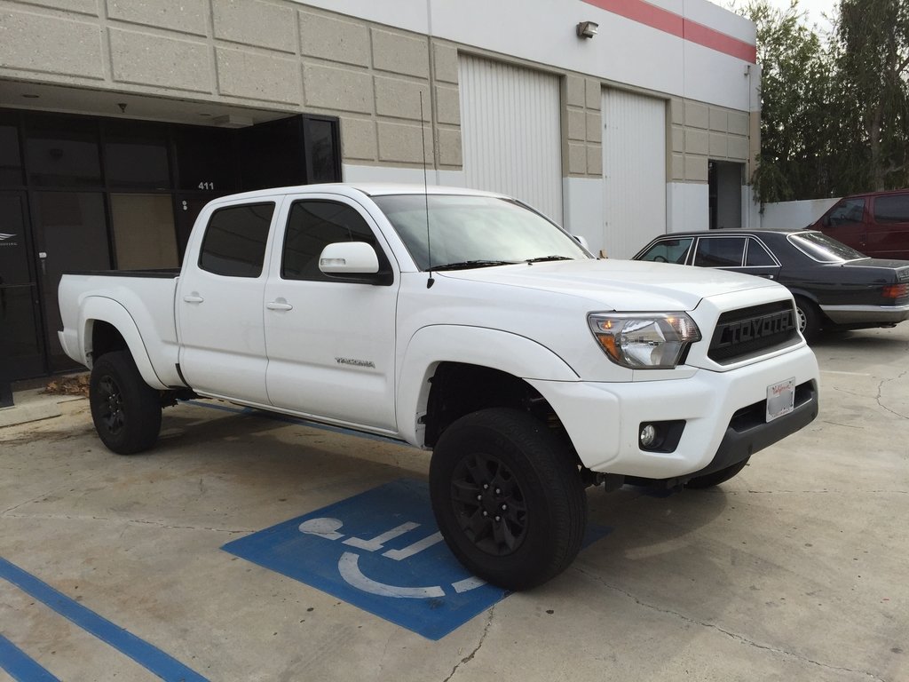

    Just installed my setup today.
    Ordered from ToyTec.
    Front: 885 Coils, 90001 shocks, ToyTec top plate spacers. Got about 3" up front (didn't actually measure).
    Rear: Dakar leaf pack, removed longer overload leaf. Gained about 2" in the rear (didn't actually measure).
    Before:
    ba5b4489-0af1-435d-b214-d3bf209baa09_zps_bda00244af6dfc7020769e42604fa12971cf2785.jpg
    After:
    A3851881-3421-4524-91E0-CFF6C5E54C27_zps_939c35c515b2371307755afcfbb83d1b0e7b0901.jpg
    1862D0C3-7A4F-422B-AD31-C27F9897CF08_zps_d10673efec312fce7639adc267132e9cd815ecc1.jpg
    I THINK it's sitting level. Didn't do anything to formally check but I like the way it looks. I'm really glad I used the top plate spacers and removed the leaf from the Dakars. I would have been pretty bummed if I wound up with a major rake after spending all this money and time to install.

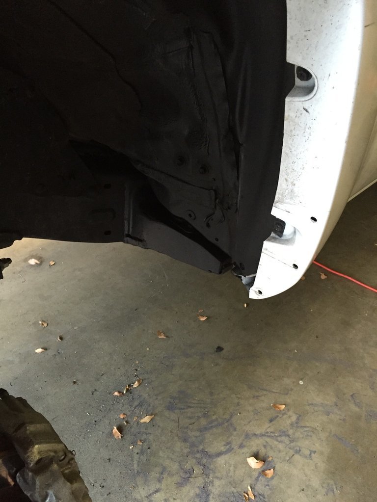

    Other mods also performed in this install:
    Chopped my cab mount, flattened my pinch weld, and did some trimming to make room for the 285/75R16 BFG KO2 tires that I'm having put on tomorrow.

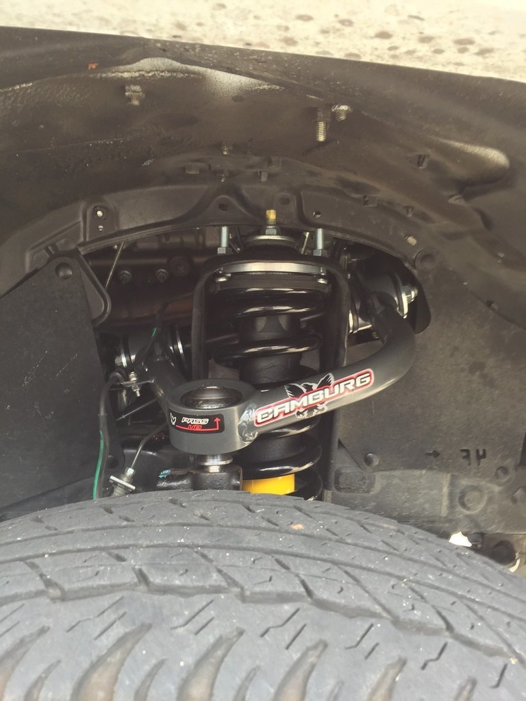

    Camburg Uniball Upper control arms.
    18BBA649-B103-4B6D-942D-DD68FE3E79C6_zps_ad80521e6bcd88f2beb71d79562e58358b6d6b94.jpg
