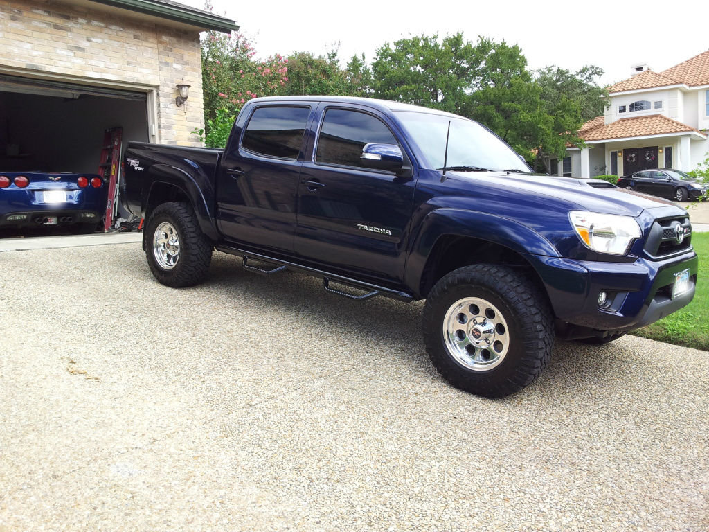

    265/75/16 S/T Maxx 16X8.5 Level 8 Trackers 5100 1.75 HID, LED interior, 3" N-Fab step bars

    I'm finding it so damm hard to decide whether to lift or just level with 5100's.

    i'll hopefully be doing my 5100's at 1.75 this week. 265/70/17 duratracs on the stock wheels, i'll post up pics as soon as i get it done.

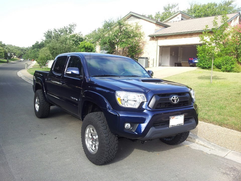

  9. Oct 13, 2012 at 11:33 PM

    Looks good, glad you finally pulled the trigger.

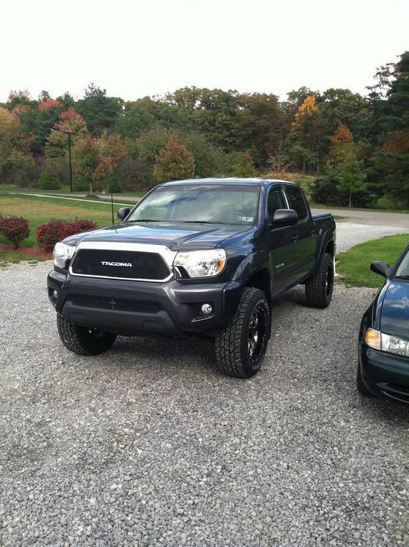

    I just decided to level... 265's is plenty for me, especially with 5" backspacing on 18x9 wheels :)

    No I don't go off-roading, ever, so I used a 1" top plate spacer. The knock on most spacer lifts is when you try to get 2.5 or 3" out of them and then try to wheel like a trophy truck.
    With that said - if you go off-roading, don't do what I did. Buy 5100's or OME.
    Yes - DIY with spacers is pretty easy if you reserach it enough, takes about 3-4 hours if you know what youre doing. I didn't the first time, so it took me about 6 or 7. 5100's would require a spring compressor though, which I didn't have to use to do my leveling.

    by the way i'm not talking about 'off roading' down to the nearest pond/hunting spot, that stuff is fine with a leveling kit - it is still a truck after all. and with my leveling kit (1" spacer) that means i'd have to use all but 2" of my truck's total travel to bottom out the strut, which I'm never going to do if i'm going 15 miles per hour down a dirt road.
    What you don't want to do is go mudding or pre-running or some crap with a leveling kit -thats just asking for trouble.

    Well if you can tell the difference between a 2" leveling kit and 5100's set at 1.75" based purely on the stance of the truck, I'll give you a cookie. Your request was to see pics, my post accomplishes that. :)
    Spacers are fine if you're on the highway 99.9% of the time, and you're not driving like you're in the BAJA 3000 for the other 0.1%.
