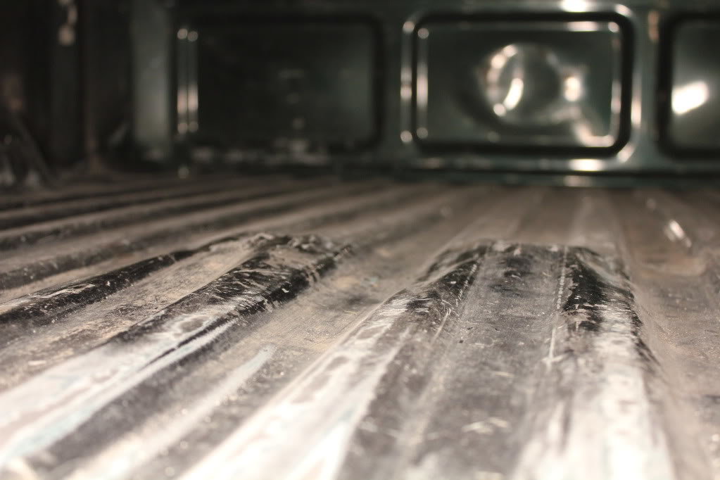

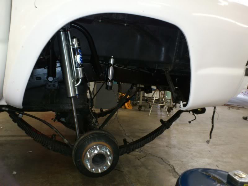

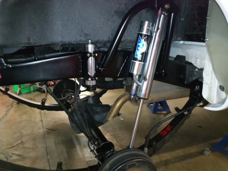

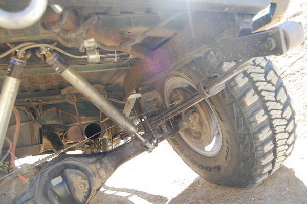

    I'm running 14x2.0 Foxes, 64" Chevy springs, 6" shackles at about a 35 degree angle, and Ballistic creepers as shackle hangers. (About 3-4 inches of lift.)
    My goal with this set-up was to maximize articulation and clearance, withOUT going through the bed.
    While I didn't actually go through the bed, I sorta cheated. :laugh:
    The downsides to this set-up are: ride quality, (since the more of an angle the shock is in relation to the axle movement, the less efficient the shock is at dampening), and I had to deform the bed a little.... IT's hardly noticeable after bedliner, I belive this could have been avoided with 12" shocks (wich would be plenty long for a typical 3" lift set-up). I originally planned on running 12" shocks, but someone locally was parting out a baja bronco, so I got these for cheap and decided to make it work.... :notsure: It could also be said that the lack of up-travel in my set-up is also a downside..... but since the 64" chevy springs deteriorate quickly when allowed to flex past negative, and my 37s start eating things under my fender wells if I tried to stuff them any more, I really don't need any more up travel... and I think the down travel makes up for it nicely. :D

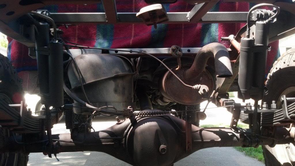

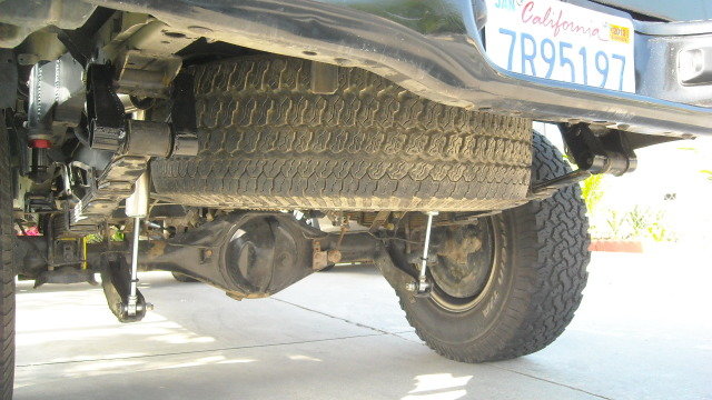

    Heres mine, I built it for high speed whoops desert stuff. After many times revalving it handles really well, and Its capable of doing 65mphs through somewhat decent whoops.
    Bilstein 7100's 12" Short Bodies, Custom 4" shackles, 2" Air bumps, Limit straps, Deaver j59 leaf pack.

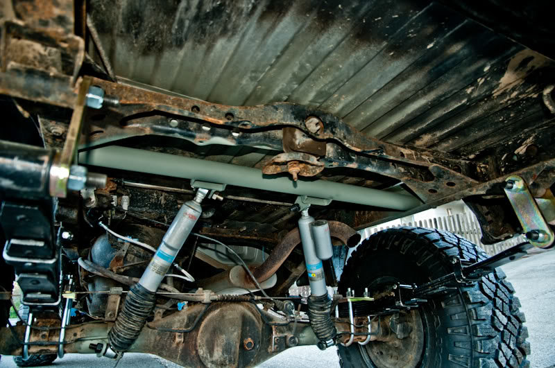

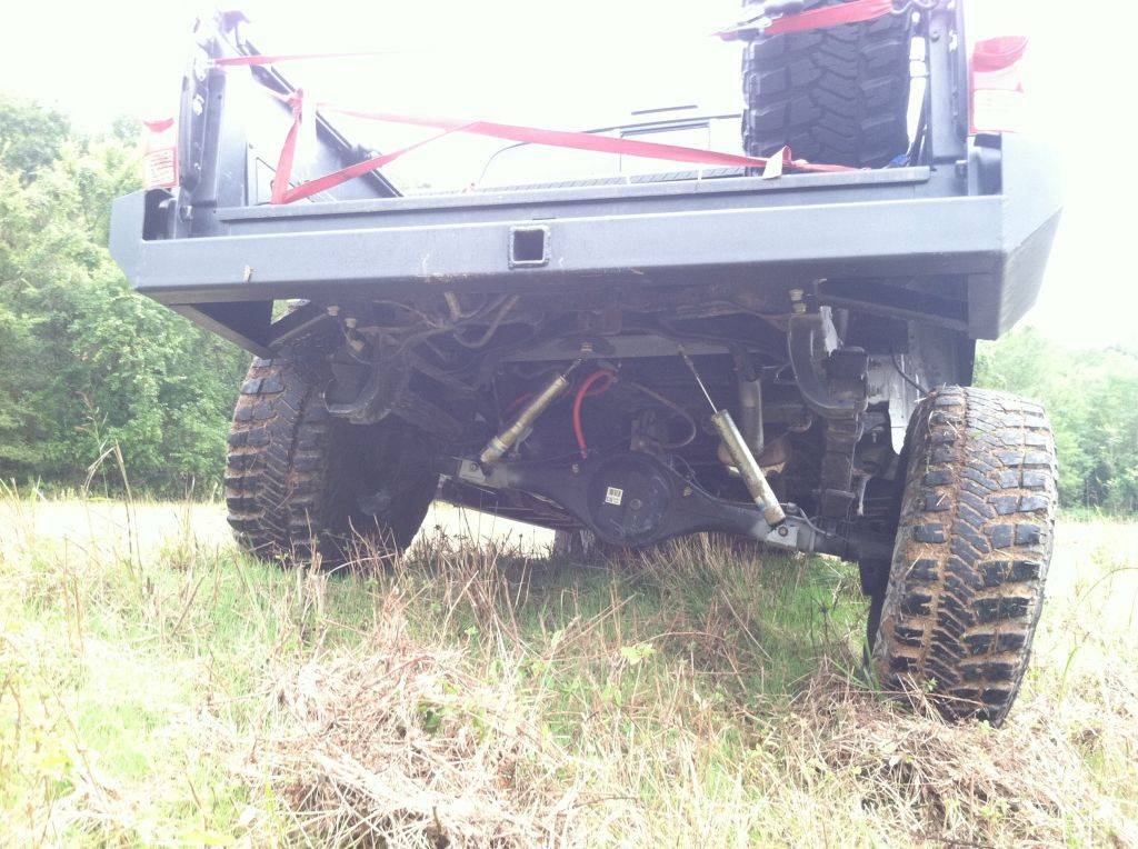

    Relocated the shocks and added some support, rides way nice now with the expo packs, not rough at all and corners way better Don't know how it flexes yet.

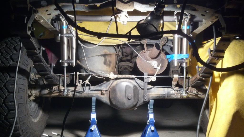

    Toytec 16" coilovers with Tundra Bilstein 5100s, Light Racing UCAs, Alcan Leafs with Orbit Eyes, 12" Bilstein 7100 short Bodies, ARB rear locker, 33x12.5 Duratracs, CBI sliders, Bushwacker fender flares, self made front bumper, M8000, Vision X 6.7" Hi/Lo Beam HIDs, full skids, Inchworm dual case setup - 15º clocking
    ^Are those the 12" short body 7100s? That is a clean install. I noticed that you kept the eyelets lateral to the truck. Do you think you'll get any binding in there, when you are flexed out?

    They're 10" short bodies. I am concerned about the binding but I've seen other people do it and I'm hoping that it won't be a problem but I can always fix it if it is. just haven't had a chance to flex it out yet
