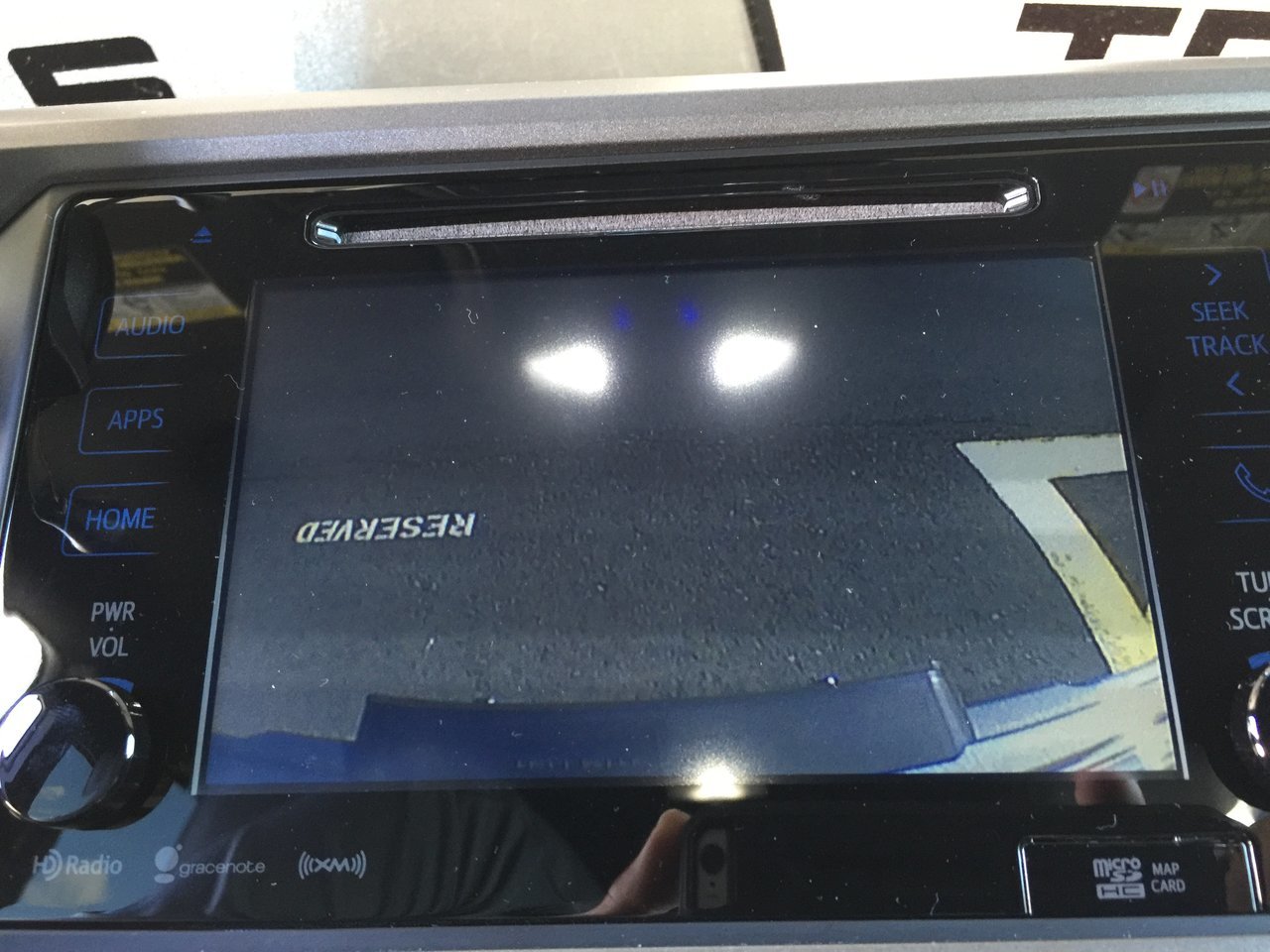

    Here is similar to what i got:
    170° Wide Degree CCD Car Front View Camera Logo Embedded Waterproof For Toyota ebay Item http://r.ebay.com/s7Dxpi
    Sorry, got some reflection of the map lights in the pic also, the horizontal lines in the screen pic is not there in real life. Dont know why it appears only when i take a picture if it. Quality seems decent, but i want more of the front bumper so looking for a 180 degree view front camera, it anyone else has found one.

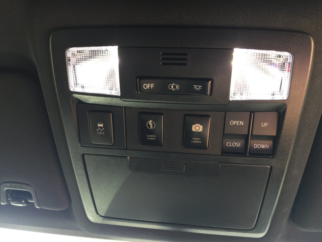

    I also got these two switches in the middle from CH4X4 custom made to order.
