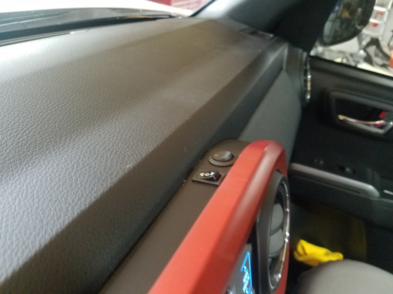

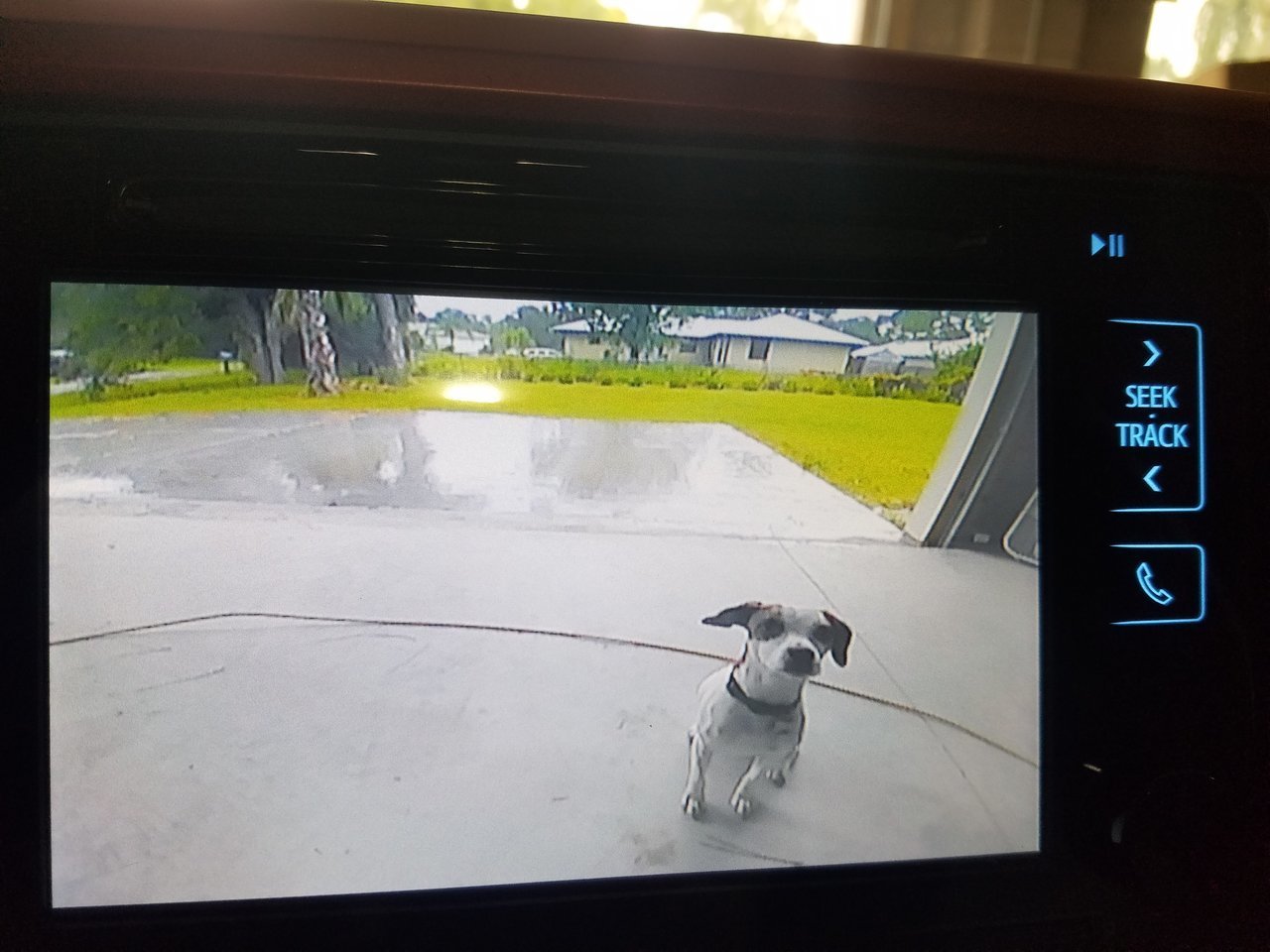

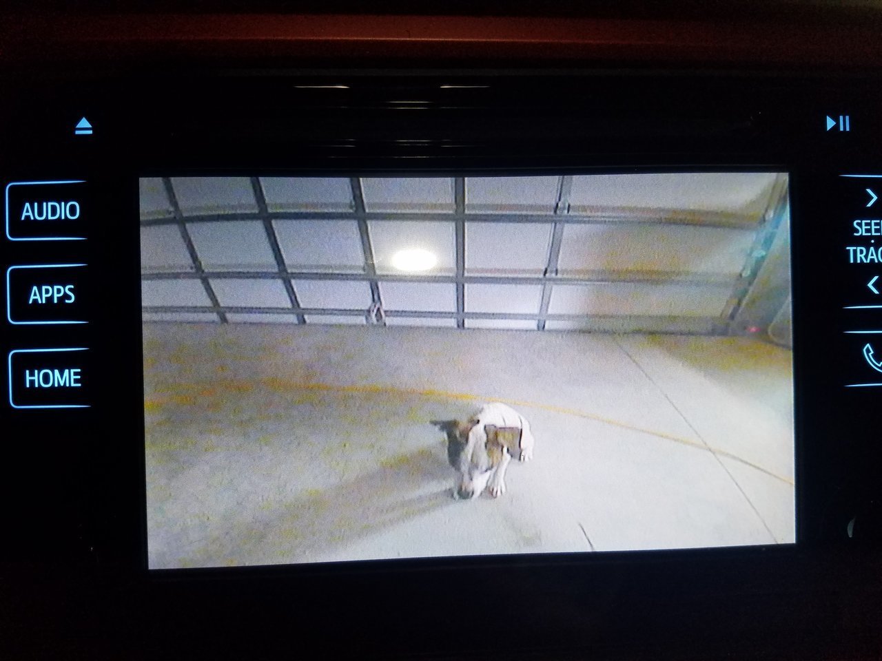

    I will give some help (from a distance) if you want . Remember that there almost an infinite number of ways to skin a cat, so feel free to ignore anything I say and do something a different way, because there is a good chance you can make it work a different way... This thread by Hoangde has pretty much all the data to let you design your own modification, although a lot is buried.
    If you do want help, I will have to know better what you want to do, and what you are using. Are you using a 28 pin cable (the HAI cable or the jshsltr cable) and/or a 24 pin cable (Axxess-Toycam3), or are you cutting and tapping into the factory harness?
    What do you want for the functions of your switch to be. (For example, on mine I have a SPDT on-off-on switch which selects forward camera, normal mode, or rear camera.)
    In forward camera mode on mine, the forward camera shows at any time the truck is on, even if in reverse. In normal mode, rear camera shows in reverse. In rear camera mode, the rear camera shows at any time the truck is on. This is accessible without using the Aux menu on the touchscreen for the head unit and without navigation override switch.
    Do you want a nav override switch? (I have one, and you need it to be able to use Aux input while moving, or if you want passengers to be able to type addresses into the Head unit while moving)
    Do you want video input installed for future use? (can be used for phone mirroring, etc)
    And I probably forgot 100 things...
