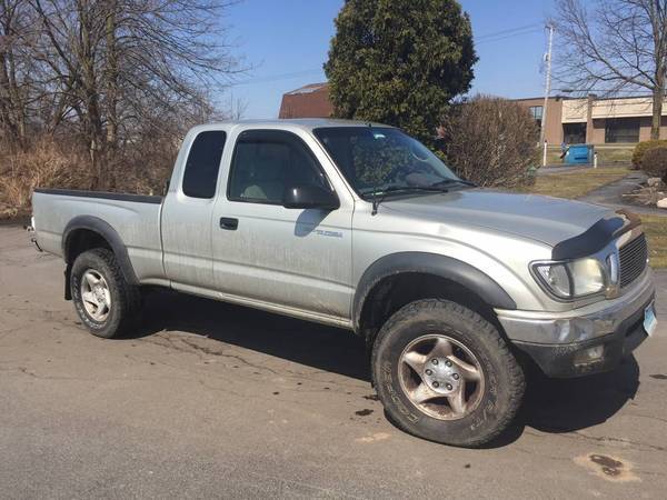

    2004 Toyota Tacoma SR5, 3.4 V6, 4X4 Xtended Cab Build
    I bought this truck in 2011 in showroom condition with 50k miles for $12.5k. The first owner installed a custom slotted grille. Now she has about 127k miles, and more than a few dents. After rolling her into a snow angel on Valentine's Day, I finally decided to turn her into the truck of my dreams. She earned it.
    This thread is a whiteboard space for that build. I haven't done much truck work, outside of changing my oil, replacing fenders, and other small projects, so this will be a huge learning process. Any suggestions, tips, etc. are welcomed.
    As she sits now:

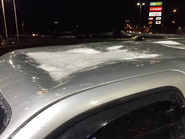

    Plus roof and fender damage:

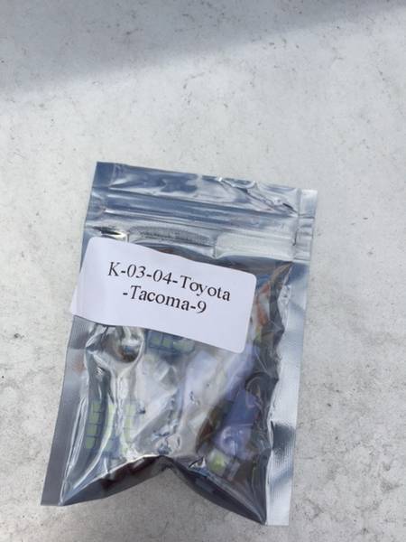

    Before work this morning, I swapped out the dome LED for white, from a 9-piece pack from eBay.
    I only needed one bulb, but the bulk pack seemed a better deal. If anyone wants one, send me a PM.

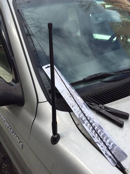

    Then I switched out the stock antenna with an AntennaX Off-Road 13-incher from Amazon. Not gonna lie, it feels like a piece of junk. The plastic is soft and the end cap isn't glued on straight. I like the short height and squat stature, but had I know about the fit and finish I wouldn't have spent the $16

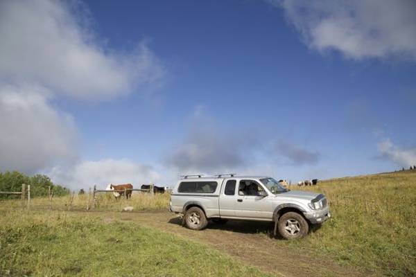

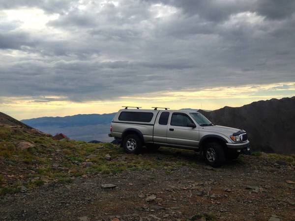

    Here she is in Grand Mesa, Colorado last September. We went to the very end of the motor roads. We were the last pickup for several miles. One day two or three an old timer came by on a quad and said, "I can't remember the last time I've seen a truck up here!" That made the trip for me.

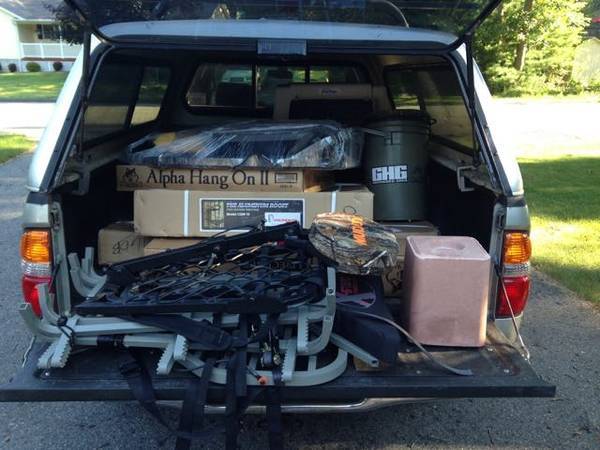

    Here she is loaded for a productive fall. That bed liner is a no-name brand some guy in my parent's town did for $500. He's already redone the edge on the tail gate once, and it's starting to peal again already. Next time, I'm going with Line-X or Rhino or another established brand.

    It's only $16 shipped, with Amazon prime, so its not a huge loss if it sucks, but I was certainly disappointed with the feel when I just installed it. One of those things that looks cool at a distance, and like cheap Chinese shit in your hand.
    I'm going on a road trip the next two days. I'm going to keep it or scrap it based on reception. I'll keep you posted.

    It worked well enough. Didn't notice any poorer reception than the stock antenna. And I do like the short, squat look.

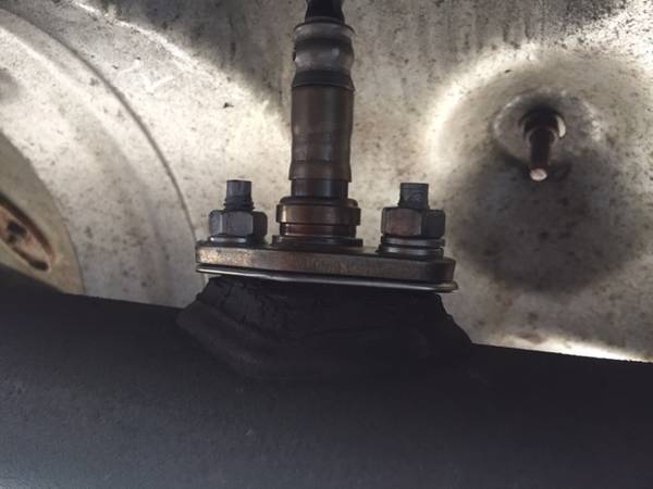

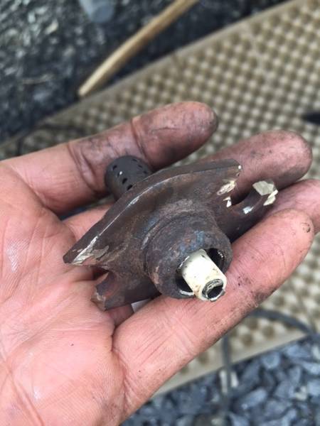

    Next I put in a fuel filter, did the No. 1 o2 sensor, and changed out the front diff, rear diff and transfer case oil.
    Getting the bolts off the o2 sensor took vise grips and a shit load of PB blaster, but I got it. The check engine light went off after about 8 miles, then came back on. I cleared it with an OBDII scanner, and the mother threw the code again. I cleared it, and then I got a different code that said the No. 2 sensor was bad. So ...
    I replaced that one, and it was a rusted wicked bad. So I took the Dremel out and cut the fucker off.
    About half way thru I figured I ruined the bolts, but tried it and couldn't believe I could thread new nuts down it. One side was a little ganked, but with an extra lock washer it held.
    The code cleared right away, and now—no more check engine light.

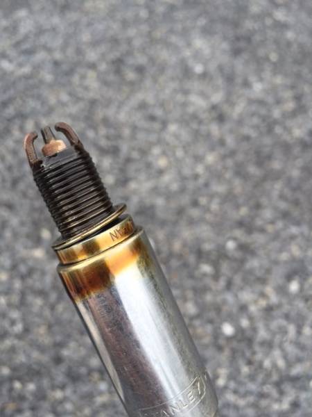

    Today I did plugs and new wires. I followed this guide and it couldn't have been easier: http://4runners.org/writeups/sparkplugs/
    The crazy part, all the plugs came out covered in oil. Some were dripping. When the Snow Angel rolled, and earned her name, the plugs were covered in oil. The mechanic cleaned them, and she fired up, blowing smoke for about 20 minutes. What I don't understand is how 2,000 miles later there's still oil in there. I figure when after a couple weeks of driving I'll check these new plugs and see if more oil is down there ... But still, it doesn't make sense to me how any oil in there hasn't burned up ...

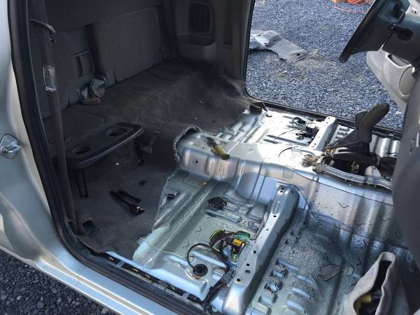

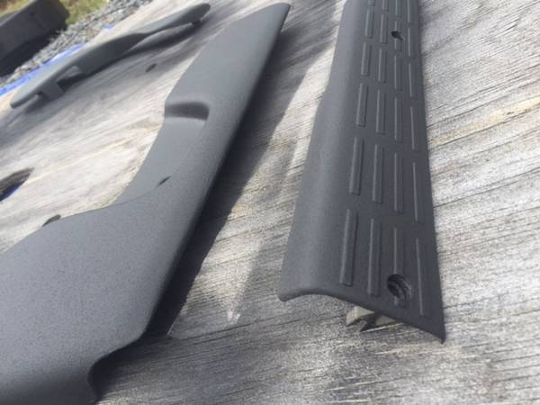

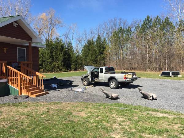

    Lastly, I pulled the seats and took out some of the interior plastic. I'm bed spraying that black and so far it's coming out pretty good.
    Tomorrow and Thursday I plan on ripping out the rest of the interior, installing dash LEDs, continuing the paint job, then cleaning the seats and installing my Wet Okole's and seat heaters. My peal & seal insulation hasn't shown up (but I got the vinyl floor liner and Mass Loaded Vinyl for sound proofing) so I probably won't finish the interior until next week. While I'm waiting for that, I'll do the fiberglass front fenders.

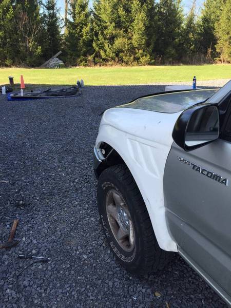

    Made good progress last week:
    This week: Peal & Seal then MLV line the interior, LED dashlight mod, tail lights.
