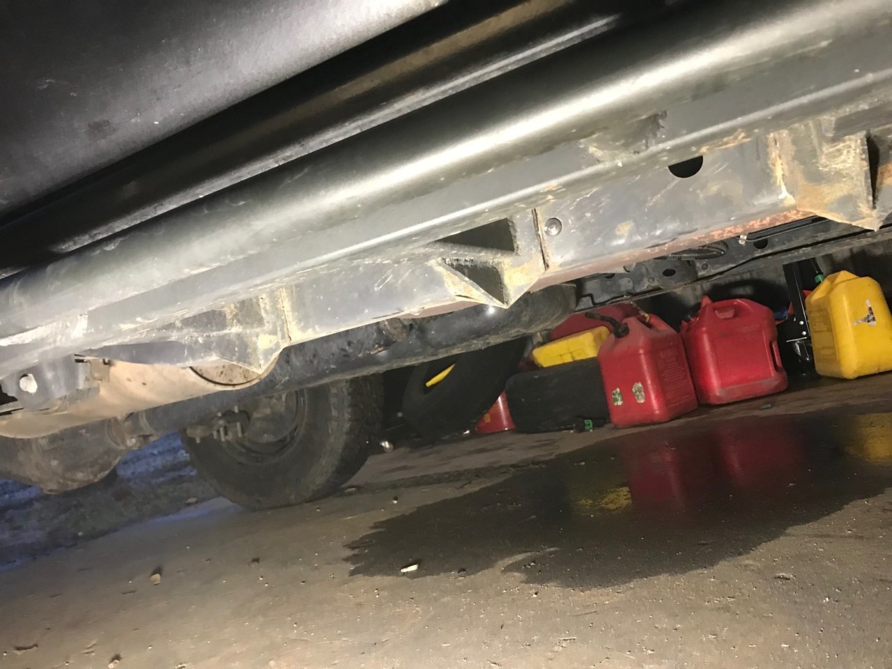

    • Passenger side slider cut off, flipped over and rewelded. *slider was installed upside down by shop that PO had them installed at:rolleyes:. Ended up having to cut 3 of the 4 legs off of the slider and move them as well, see pics, forgot an after picture*

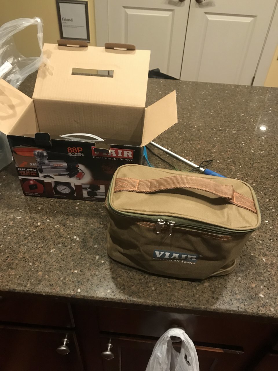

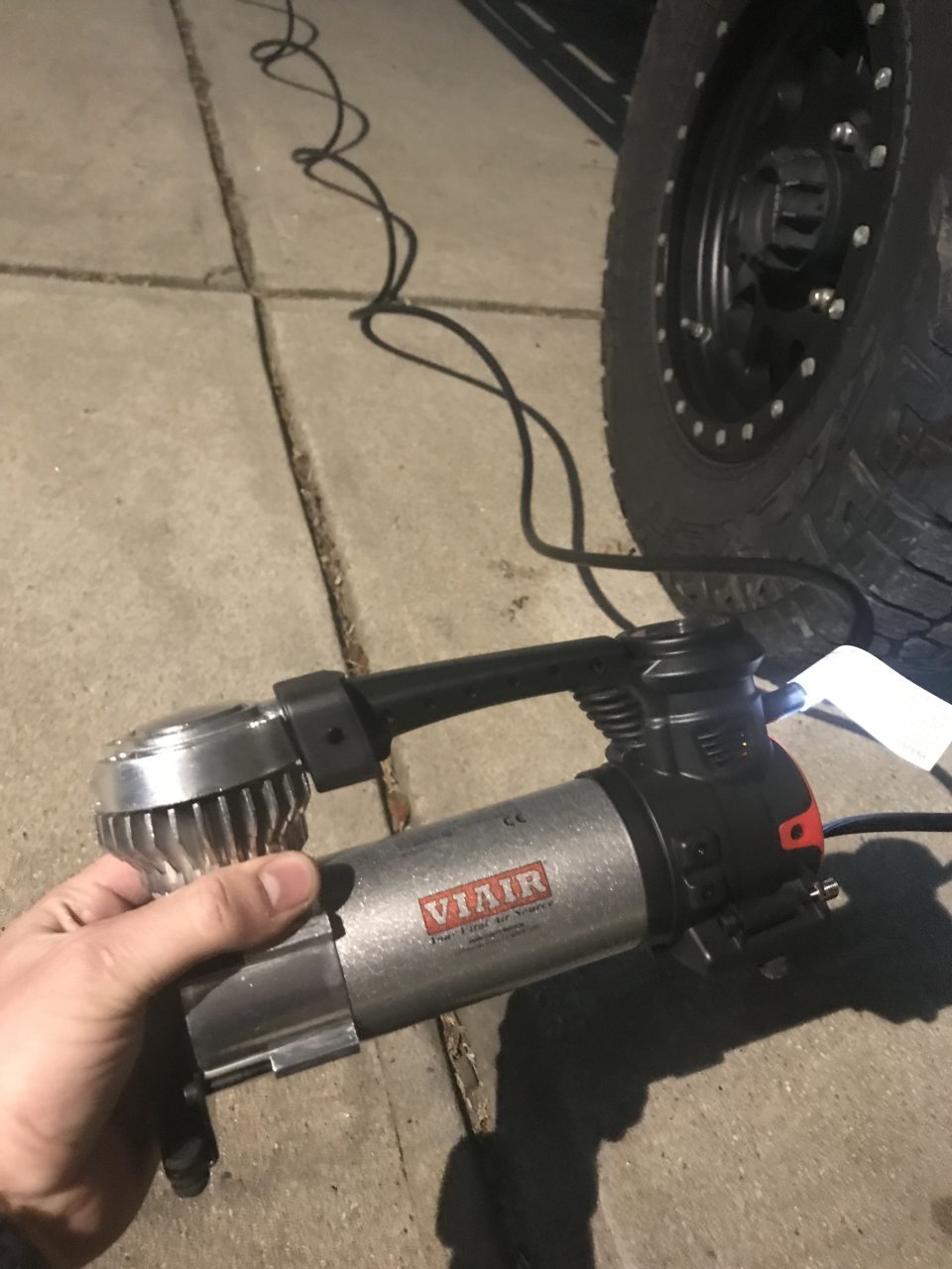

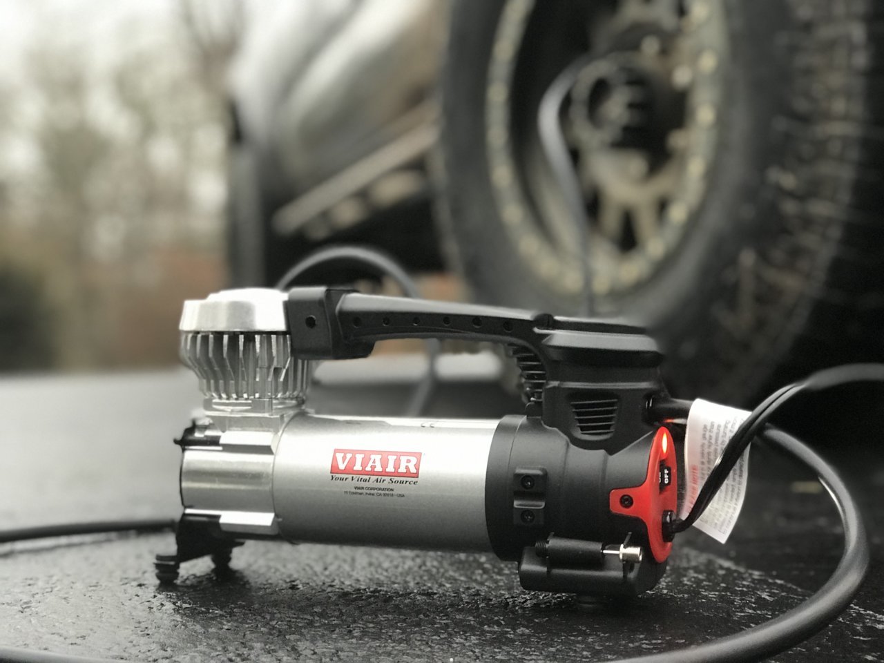

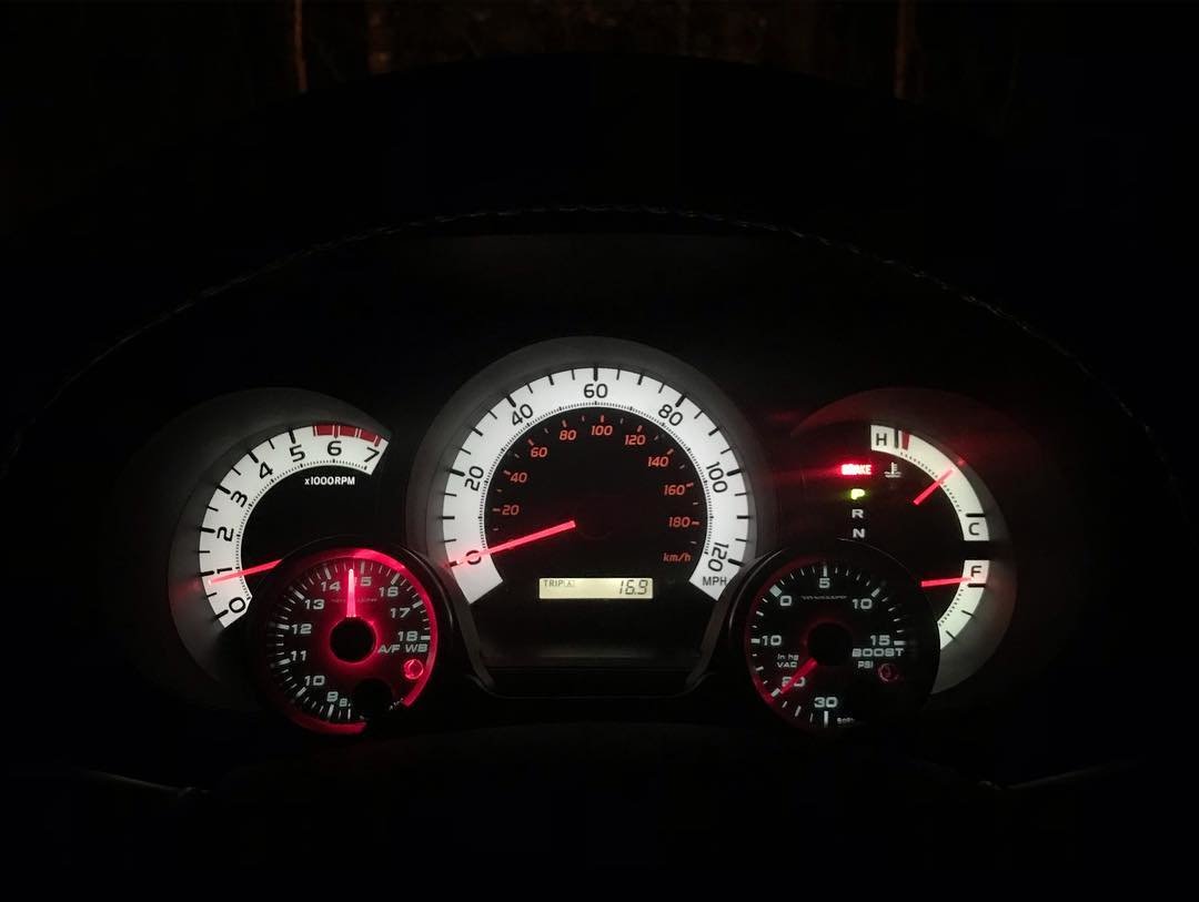

    Alright guys, so I received my Viair portable air compressor yesterday. I ordered it Tuesday at 11:30 PM and it came in Wednesday around 1PM?? Amazon prime ftw!!
    Anyways, unpackaged the unit, and first impressions are fantastic. Really seems like a solid unit. Was a little worried about the power cables/air lines not being long enough to reach the furthest tire, but it did it with room to spare. And it came with a nice tote! I think this little guy will be around for years to come.

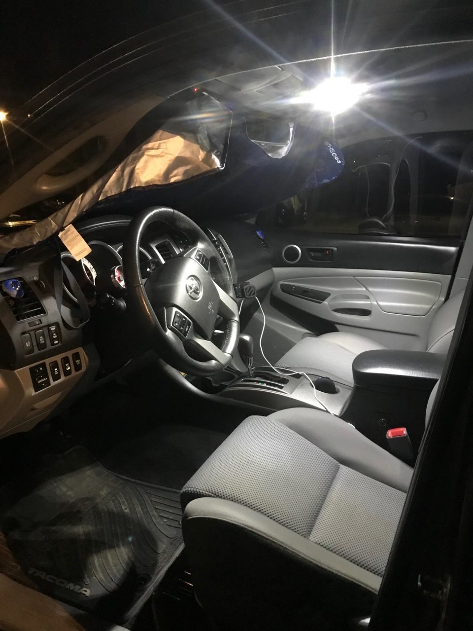

    Alright guys, its been a few days, but I got the LED interior lights installed and man WHAT a difference! Virtually put the sun in my truck! Also got the rear extended diff breather installed, i extended it to one of the tool cubbies in the bed; just in time for my little trip this past weekend. Ill post more about that later. Did the reverse light upgrade last night and what a difference. I don't currently have any pics, but will see if i can get some when i get a chance.

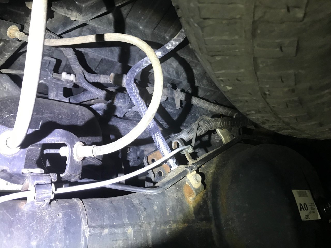

    • Replaced the highly dreaded rack and pinion with a new Cardone Select unit from Rockauto. Was not as difficult of a replacement as i initially assumed! Quality seemed solid, no issues with it so far. I have noticed that the steering wheel is intermittently straight if that makes sense. Im not sure if its an alignment issue, or something internal the rack. Will continue to monitor and report back
    • Outer tie rods replaced with OEM units (rockauto had these too, what?!?)
    • Steering rack bushings replaced with Energy Suspension bushings. Instructions here.

    Thoughts on the rack and pinion replacement:
    "So, a little R&P update, ended up ordering the NEW version of Cardone's unit from Rockauto, mainly because it came with the lifetime warranty for only $100 more. Also picked up some OEM outer tie rods because why not(actually got them on rockauto as well, they dont pull up under tacoma, you just have to search the exact part number and they are there). Finally got around to installing it this past weekend, and everything is operating properly, minus one issue which i will mention below. First, a few notes in regards to the install:
    1. Make sure you completely REMOVE the bolt holding the steering linkage to the rack! Didn't remove it and only loosened it, and it wouldn't come off. Finally thought that maybe it had to be removed completely as it being in there stopped it from coming out, and i was correct. Its probably mentioned somewhere in this thread, i just didn't remember reading it if so.
    2. The drivers side R&P bolt worried me, as I read horror stories about getting it out. I ran into the same exact issue as expected, however my remedy was quite easy. While most people were grinding the head of the bolt down, or just cutting the bolt in half, i used a ziz wheel and just cut 1/4" off the end of the bolt which gave the bolt enough clearance to be removed. I was able to reuse the bolt using this method, and it took all of 30 seconds to cut the end of the bolt off.
    3. It was somewhat of a headache initially trying to get the rack and pinion actually out of the truck. I learned that removing the passenger side bolt for the front diff and removing the front skid plate supports is very important. Once those are removed the rack and pinion slides out with almost no obstructions. I left the inner and outer tie rods on, and was able to remove it this way.
    4. Make sure to make sure your friend removes the seat belt from the steering wheel when making sure everything is operating properly and filling the reservoir with fluid!! :rofl:My buddy didnt remove it and thought it would be able to rotate with some slack, and kept telling me the steering wheel was only moving a half turn then getting stuck. I wasnt watching him to see if he had removed the seatbelt or not(i assumed he would have; granted it was 2AM) so i started stressing and researching what the problem could be. Finally i thought to try it myself when i found he had left the seat belt wrapped around the steering wheel...:facepalm:
    That pretty much sums up the install! Filled with Mobile 1 full syn ATF and have yet to see any leaks or hear any odd noises. Steering feel hasn't changed much, steering was tight before. The old unit was replaced just because it was leaking.
    Now, my ISSUE!
    Got the R&P in, and now the TRAC light(squiggly lines) is on. I thought it would go away after I got it aligned this afternoon, however I just picked the truck up and drove it a few miles and it still hasnt gone off. Will it eventually go off? I read something about possibly have to do a VSC relearn procedure, is this true?
    I will say, after i installed the rack, the steering wheel was off about 1/8th of a turn to the right. I corrected this temporarily by straightening the wheel, and adjusting the inner tie rods, and actually got it pretty damn close. I did notice when pulling the old rack off that the number of threads on each tie rod was different from each other, meaning that the distance from the center of the rack and pinion to the center of the outer tie rods was slightly different, if that makes sense. When i straightened the wheel and adjusted the tie rods, the number of threads was almost identical on both sides. After the alignment, the amount of threads on both sides is still identical. I think the PO may have had some adjustments made at some time and maybe had a relearn done with the old rack and pinion slightly 'off' so now i have to do another one now that its in the correct position?? Does that make sense or am I just making things up??
    EDIT: So, got the issue taken care of! The VSC relearn procedure took care of it. I only drove a couple miles but it didn’t come back on, we’ll see if it stays off in the coming days. Thanks for everyone’s input with this whole process, much appreciated!"

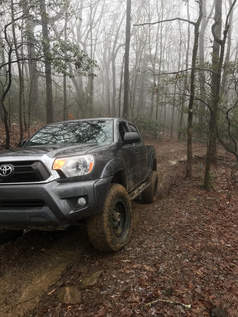

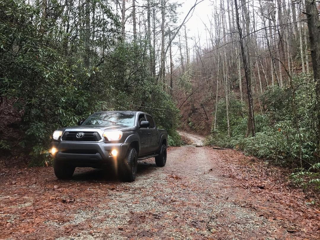

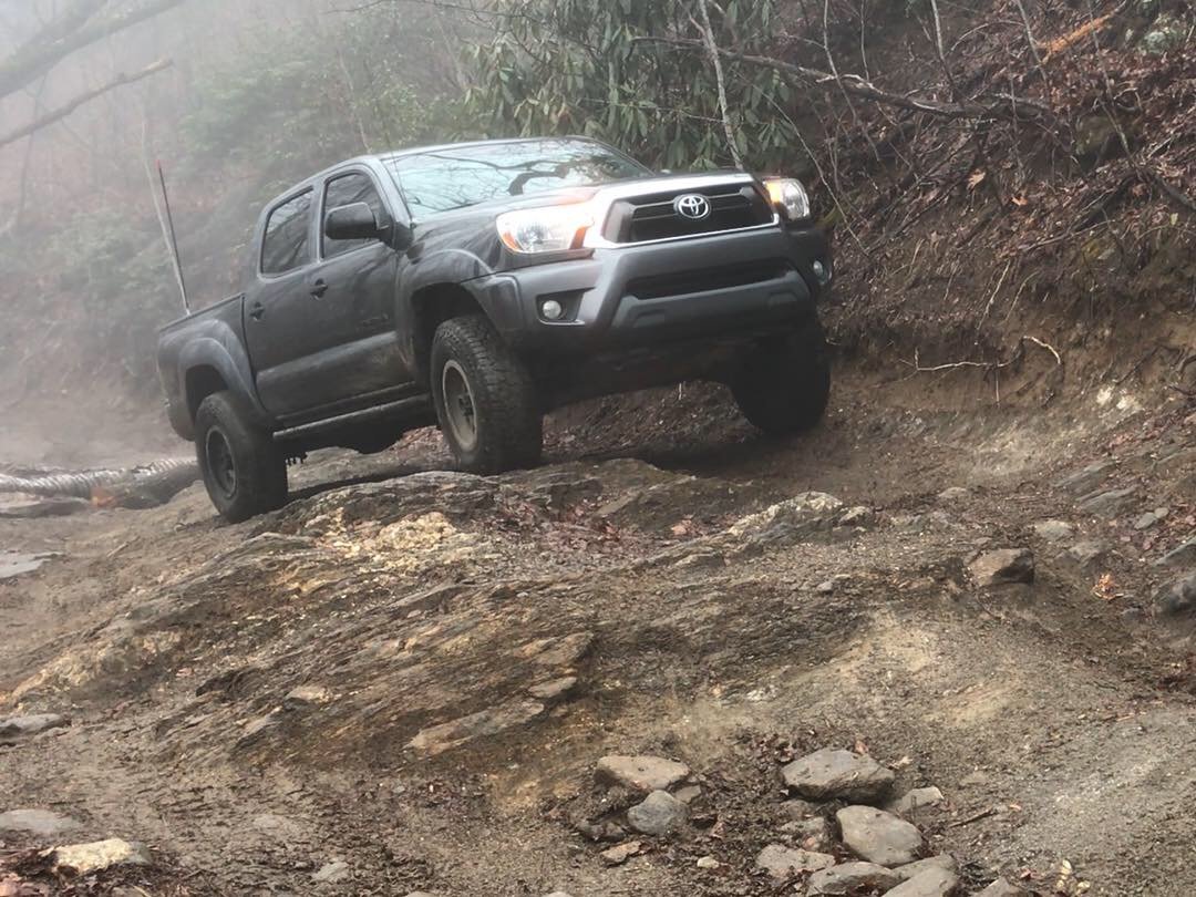

    Adventure Report 1
    Tray Mountain - 1/12/19-1/13/19
    This was my first trip since purchasing the truck. Truck performed absolutely flawlessly. Found the need for Weathertech mats, and they were ordered soon after arriving home from this trip. It was really neat to see the offroad capabilities in action, such as A-TRAC. Recorded a video of it live! Got to use my new Viair compressor and it worked great. Took maybe 10 minutes to air all tires from 8psi-32psi. Overall great trip, minus not being prepared in the camping department(not my first camping trip by any means, just got overly eggsited about wheeling and forgot about the camping part:rofl:).
    IMG_9766.jpg IMG_9748.jpg IMG_9776.jpg IMG_9705.jpg IMG_9733.jpg IMG_9700.jpg IMG_9727.jpg IMG_9832.jpg IMG_9827.jpg IMG_9816.jpg IMG_9704.jpg IMG_9787.jpg
