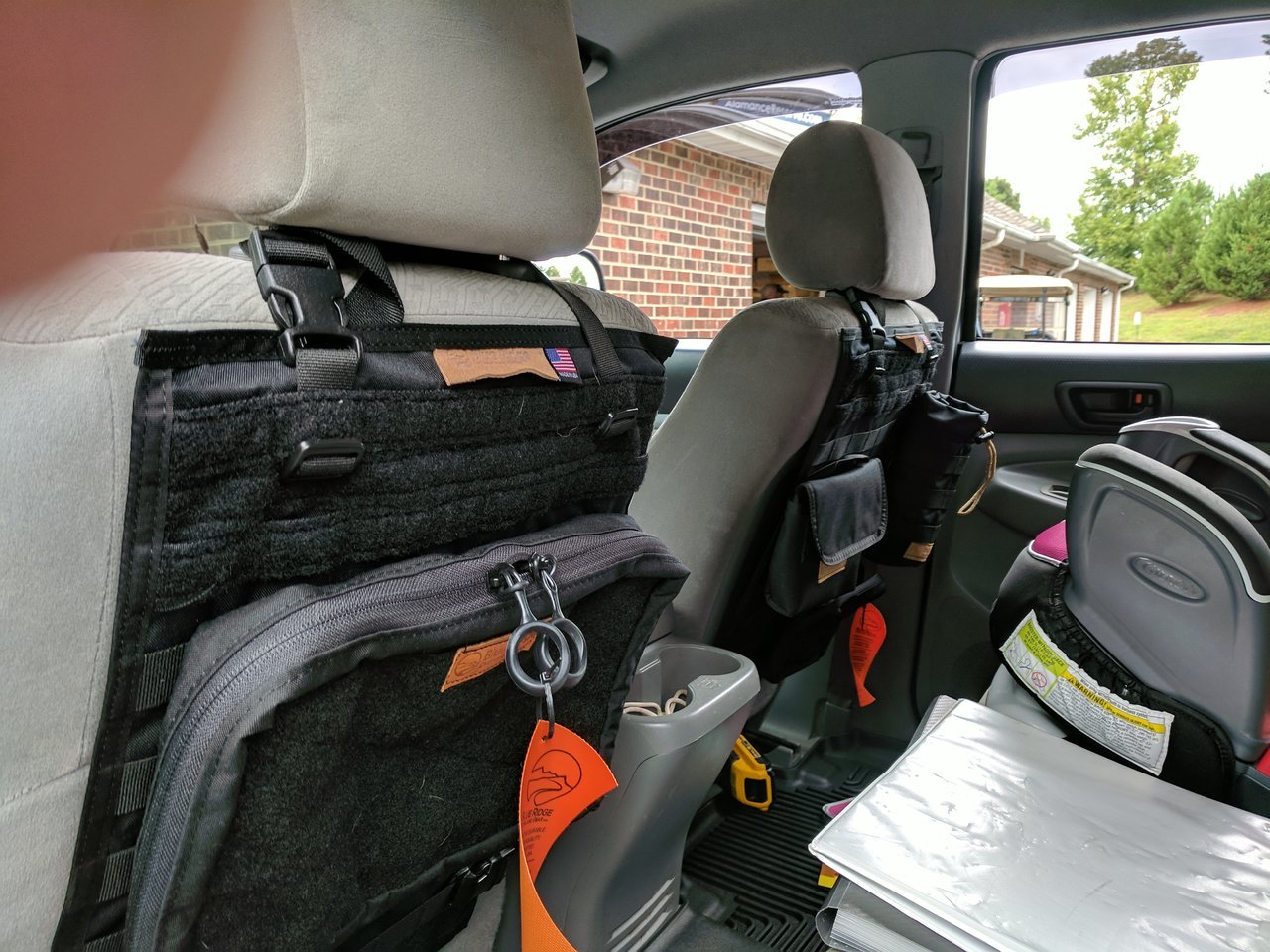

    Blue Ridge Overland Gear (BROG) Seat backs, visor organizers, JK grab handle pocket, 32oz water bottle holder, misc other pouches

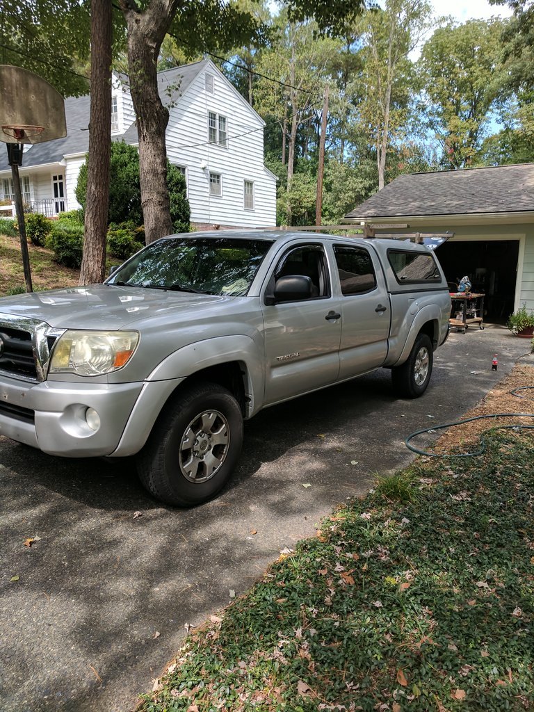

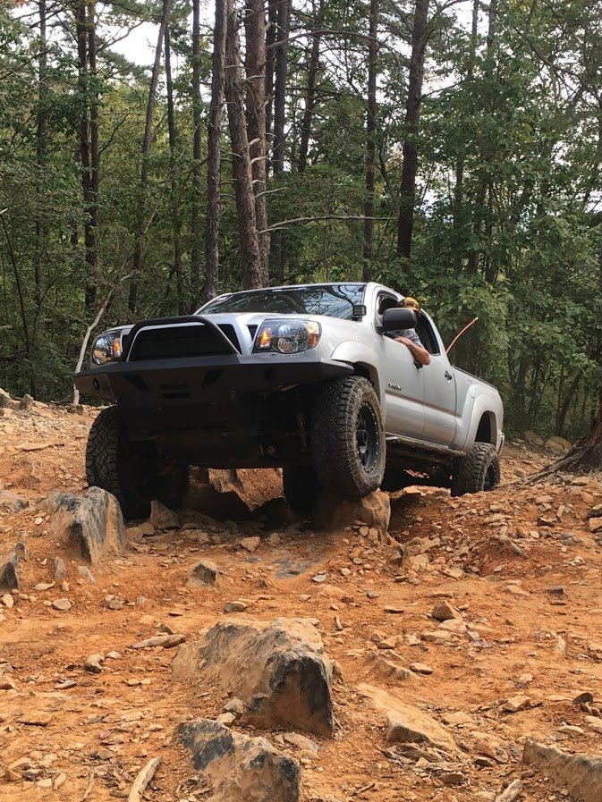

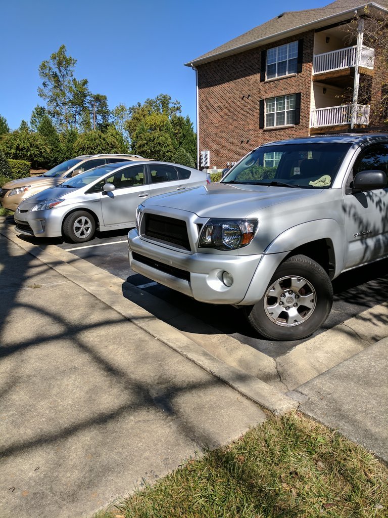

    The day I got it
    8786907698533829214%253Faccount_id%253D2_61c2d677519d2804df7b8b71e62764177cb7af4e.jpg

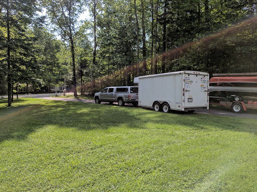

    Here she is hauling a 24' did well total weight trailer and gear was around 4500lb mark. Surprisingly enough this truck was more stable than some of my previous trucks hauling this big of a trailer and didn't get blown around badly at all. Which was a concern of mine.

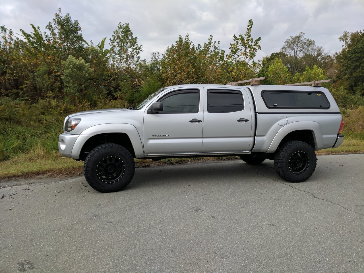

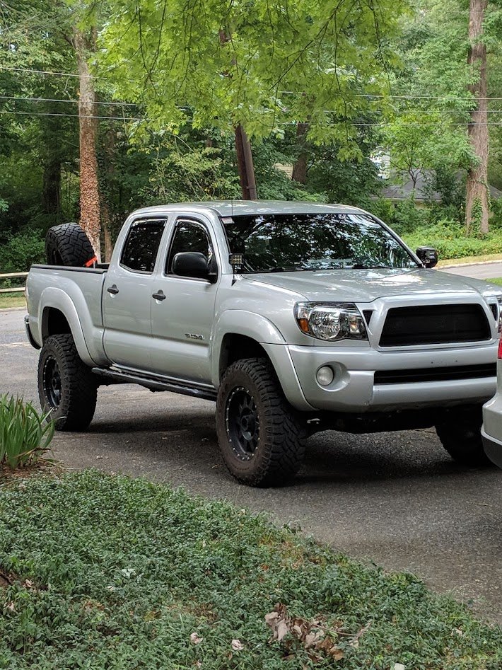

    What she looks like currently
    5nm7NxtEC41qmeJ-Ffwr6557amBgz3kISeWn_UBR_80a287e45fd2aef11b479df85c879653b0a7d6ca.jpg

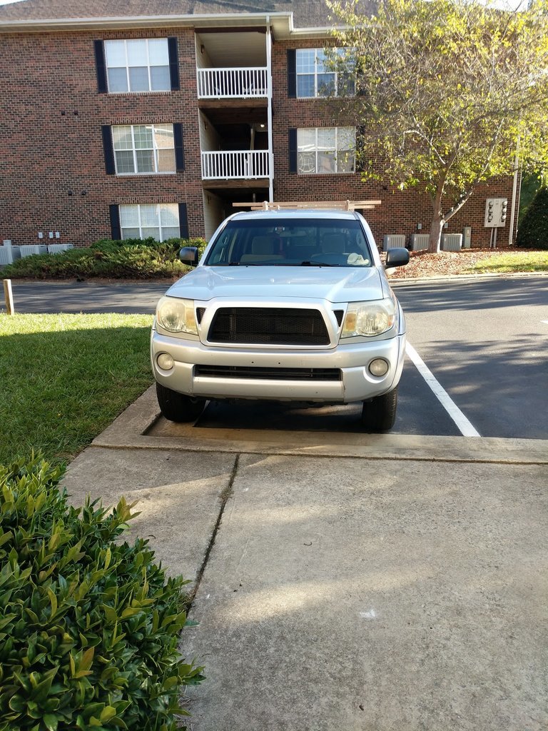

    Then thanks to @HomerTaco this came in the mail. Installed it today as well. Trying to figure out what I should for the lettering. Yota would be a tribute to a buddy of mines old 80's Toyota pickup. His was on Dana 60s, exoskeleton cage SBC, TH400, atlas t-case, running 40's. We all nicknamed him and the truck Yota because he was able to use the force to do things with that truck we thought impossible. It stuck and soon Toyota was dropped to yota on his badges. And Yes my 4 yr old daughter is helping me place the lettering.

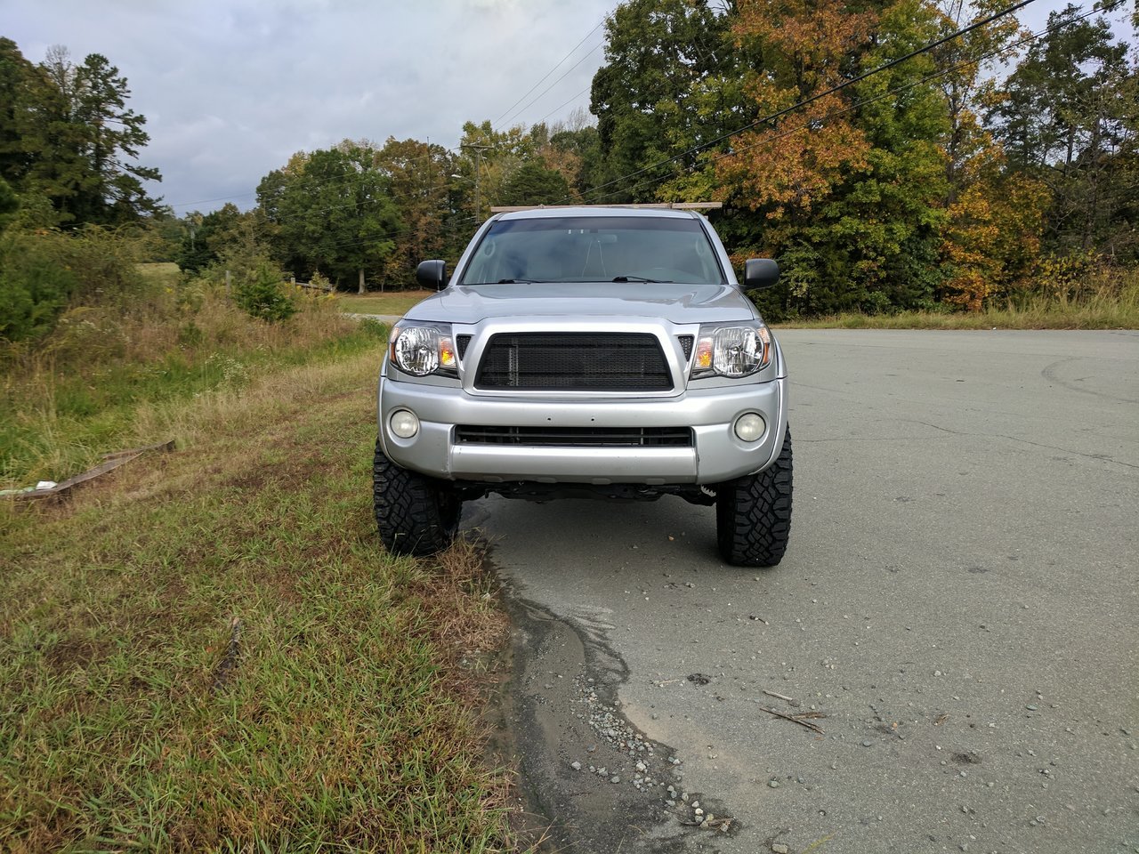

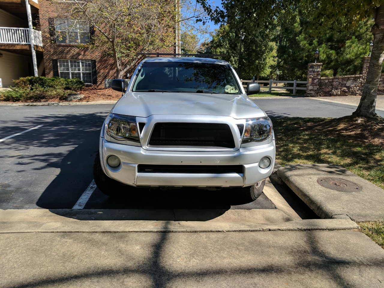

    Here it is grille installed. I have the '11 TRD factory smoked headlights these are just not cutting it any more!

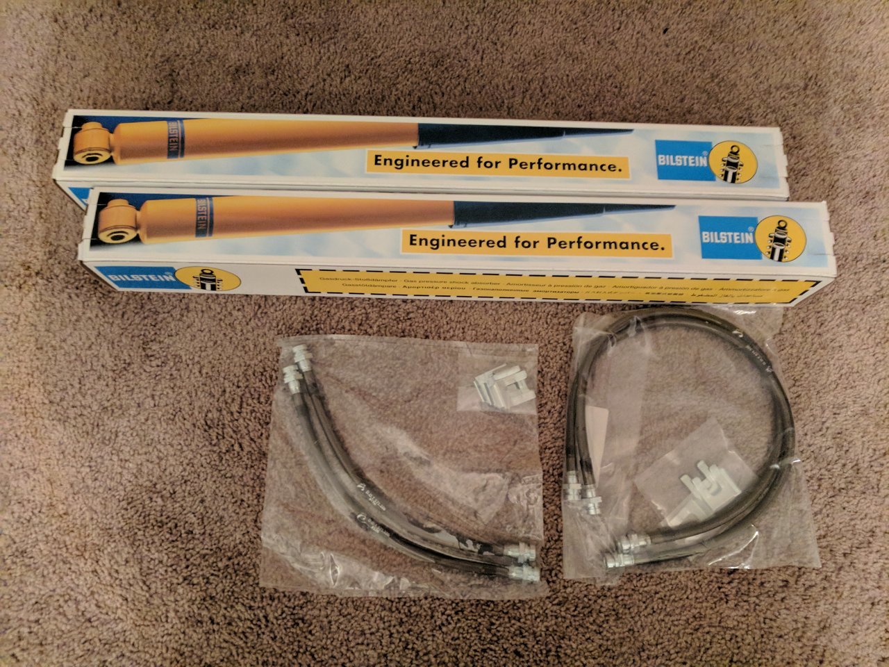

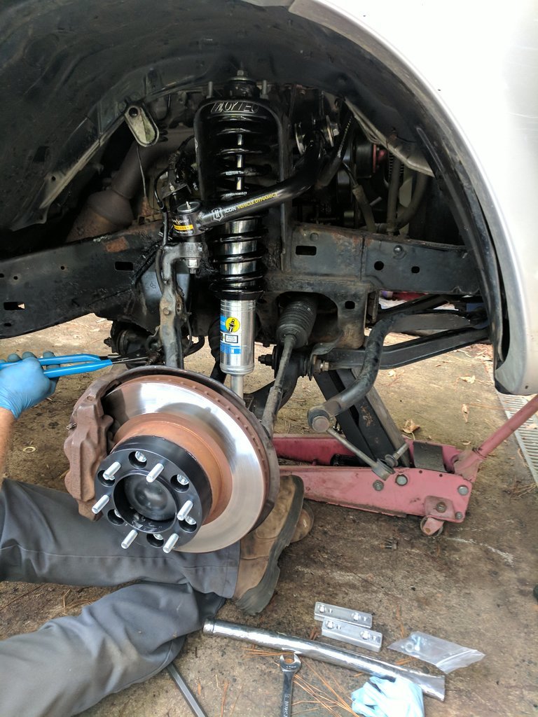

    Hopefully if all the parts arrive on time the plan is to go over to my buddy's garage and install them on the 8th, fingers crossed :fingerscrossed: on this one otherwise we will have to postpone for a few weeks. I have some plate to do a cmc then as well going to make my own fillers and am looking at doing it differently than what I have seen so far. Tires will be mounted next week and the windows get tinted next wed. as well.
    These brake lines from @HeadStrong Off-Road are some of the nicest I have seen in for any platform and I have installed and used a ton of different ones. Plus I must say their customer service and communication is top notch. The Bilsteins are typical nice looking quality, I have extensive experience with Bilsteins in the past so that's a big reason I went with them.

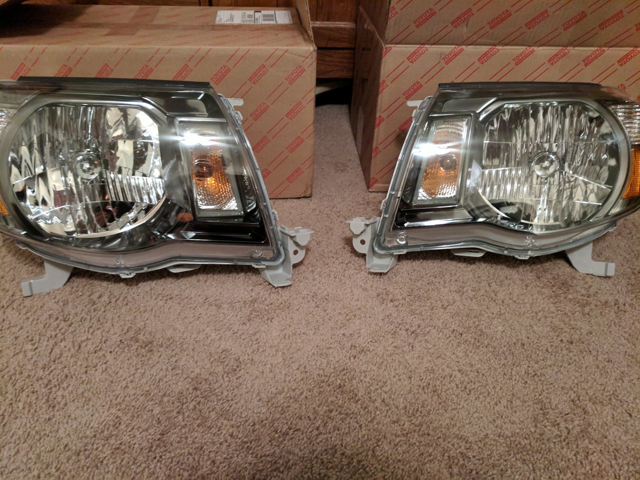

    Genuine Toyota TRD Sport black headlights the photo doesnt really show how dark the black is it almost looks like a black chrome I think this looks better than the blacked out aftermarket versions or the stock BHLM. Plus personally from having and installing a ton of aftermarket headlights the OE stuff is always much higher quality.

    Did my BHLM this morning via '11 TRD headlights looks much better now! With the grill from @HomerTaco and these headlights I think it makes the truck really looks good now.

    Installed the lift today. Sorry I didn't get many pics during the install but I think that's been done enough so people have an idea of what an install looks like. We had a little trouble but nothing to hard to overcome. I do have a slight rubbing on full lock hard to tell where when we finally finished in the dark. So a daylight diagnosis will have to do. Both factory bump stops snapped had to drill them out and through bolt them no biggie. Will be getting an alignment tomorrow morning. I must say I was a little worried I would have a pretty decent rake but in reality i don't have hardly any at all. The Bilstein 6112 with the toytec aluminum mounts gave a true 3 in lift and worked great. The rear Deaver U402 expedition springs in the 700+ variety really ride extremely well for the 50 mile ride home tonight I thought they would be a lot rougher but not really much harsher than factory. So far from the ride home I am really impressed at how well the suspension and tires handle. With no alignment done yet I was surprised that it didn't have any adverse effects for the ride home and can get it all dialed in tomorrow.
    The one picture I got during the install will get an after tomorrow and post it up. Yes I know there is some rust but I am going to take care of that hopefully soon and make the frame all nice looking again it looks a lot worse than it really is.

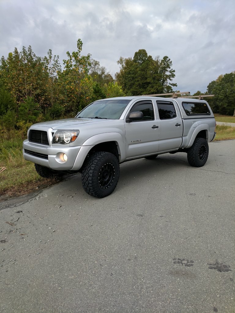

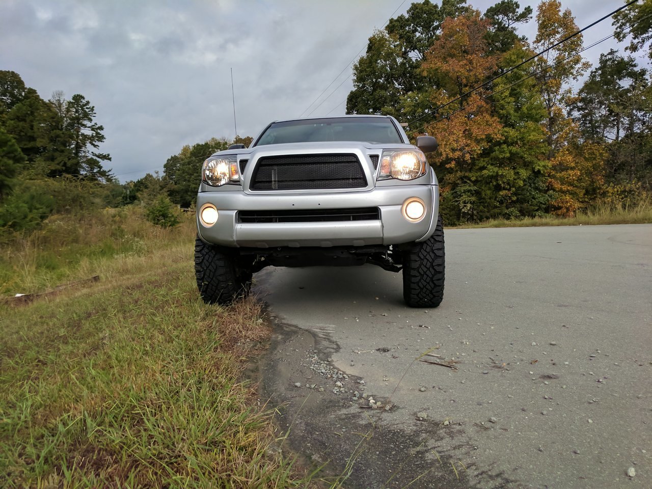

    Here are some after pictures I took today.

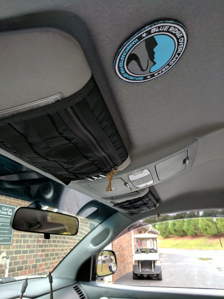

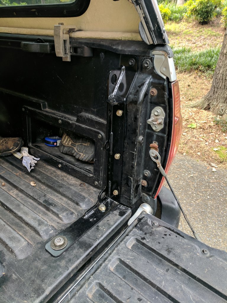

    I took a trip to Blue Ridge Overland Gear. They have a lot of good stuff for organizing and outfitting, plus I wanted to take a look at the James Baroud rtt which they are a dealer of. I like the idea of a hard shell clam shell style of tent vs the flip top. Also they are the ones contracted to be the manufacturer of the deadman off-road earth anchor. Seeing their attention to detail and their products being made first hand I believe their products as well as the deadman are extremely well made.
    I got to see these being made.
    Here is what I got.
    Sorry for the finger in the picture. I am still working on the placement of the different pouches and I need to remove the tags Even the tags are super high quality they feel like they are made of the same material warning tags are made for missiles and our jet fighters. Not super cheap gear but not overly expensive either. I think it is a good value for the price and quality. They were super low on stock because overland expo east essentially depleted their whole inventory. If you guys watch Mountain State Overland on youtube Jason had something made called the Taco attic made for his rig and now it is a production item. I was told it should be back in production this week and on the website this week.
    MarX, Toyoma17, ready6delta and 5 others like this.
