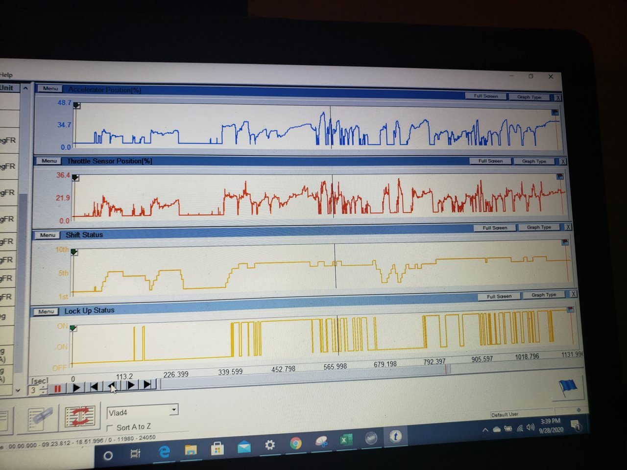

    I've tried to use VF tuner to log shift points with ZERO success. Is there an easy way to tell exactly what gear I'm in to better log my shift points for adjustment instead of holding up my fingers as it goes up and down and guessing when it's an actually shift and not the torque converter locking / unlocking / half locking.... actual throttle position would be great as well.

    OBD Fusion will report gear and TC state. That is just about the limit of my knowledge with the AutoMagic side of things.

    I drive with techstream. OBD fusion is too slow, sometimes 2 to 3 sec slow to display.
    I have condensed techstream parameters to 20-25 and you can see a better picture. Very fast and you can get more data points/sec.
    However, I still don't know if VF has and angle or % for accelerator and throttle, cause TS does not have accelerator degree..

    Do you have Techstream installed? I've never used the OVT logger or OBD Fusion, but I know you can do it in Techstream. You can get the TC lock status too, along with pretty much anything else you would like to log and more.....
    Download link is in my signature.
    Here is a video of installation. (ignore the part about copying files, you will use the keygen included in the download.)
    https://www.tacomaworld.com/threads/how-to-log-data-using-techstream.543307/#post-17601385
    Here is how to run the software and set up for logging.
    https://www.tacomaworld.com/threads...ine-ecu-reflash.515734/page-179#post-17404450
