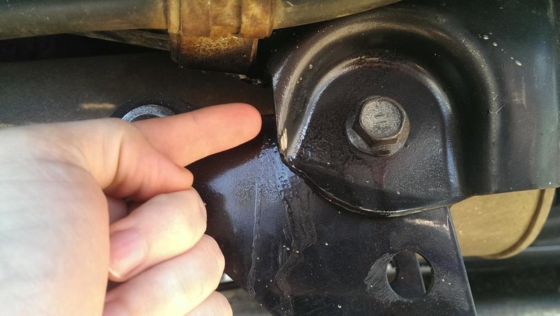

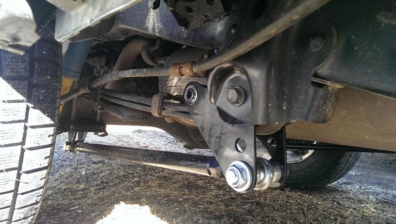

    I only read the first page and then skipped to the end.I don't know if the OP found a solution to this problem? I Just installed a set of Caltrac traction bars last night and IMMEDIATELY my acceleration vibrations were gone. I used to have them bad accelerating with any sort of gusto from 5-20 mph and again (sometimes) when braking from 40 and down to 15 or so. Both vibrations are completely fixed! Sadly I had to cut a tiny bit of my bracket off where the spring mounts due to a fitment issue (which made me cringe), but other than that. It gave 3 benefits in one. Smother power delivery(no wheel hop), Eliminated vibrations and also dampened bed hop on the nasty pothole roads. The ride is a tiny bit firmer but more planted. Sorry for rambling, I just didn't think it would fix as much stuff as it did.
    Also, I had my vehicle in twice for some TSB stuff to fix the vibrations. They replaced my drive shaft, hanger bearing and even transmission mounts. In fact they made everything worse! So I gave up and did the traction bars.

    Can you post a link or give us the name of the traction bar used? Can you post any pics of what it looks like installed and/or a pic of the part of the bracket you had to trim? Thanks.

    Sure thing, gimme like 15min and I will get a pic up. The tractions bars are called Caltracs and they are manufactured by Calvert Racing in California. They are excellent to deal with.

    TRD Supercharger, Speedhut TRD Boost Gauge, Speedhut TRD AFR Gauge, PLX Wideband Controller W/Bosch O2 Sensor, Cravenspeed Boost Pod, AFE Pro Dri II Si Intake, Calvert Racing Caltrac Traction Bars. URD Catback Exhaust, URD 2.825" Super Grip Pulley, URD Spec-U Equal Length Headers, URD 255lph Fuel Pump, OEM FPR Mod.
    Here are the images. I was kinda rushed at the end of the night so I need to re-spray some paint on some of the exposed metal. As you can see, where my finger is pointing is where I removed the material. The brackets will move up and down slightly with suspension flex and was bumping a little. I may have cut off more than needed but I didn't want to have to do it again. I took off a triangle of material about 1" tall and 1/2" wide.
