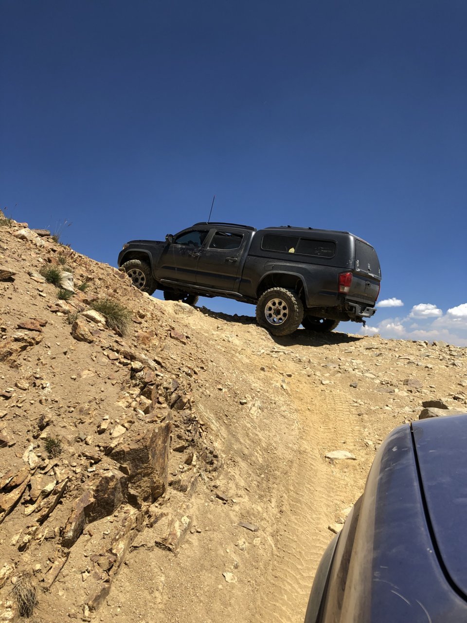

    Saturday August 15 - Had a blast riding with @johntoyota on Red Cone, Radical Hill, Middle Fork Swan River, and SOB Hill up to Georgia Pass. What a great loop! I am again amazed at our trucks' capabilities especially wheeling up Radical and SOB. The Red Cone gatekeeper obstacle seemed meager to me this year compared to the two times I climbed it in 2018.
    Top of Red cone:
    John climbing up Radical:
    Looking up Radical's shelf. Still some snow up there:
    Radical's higher shelf sections provide me the closest feeling to flying without wings because there is nothing around. It reminded me of being in a little 2 seater Cessna 150...
    ... especially around this switchback.
    My mechanical mountain goat hanging with real mountain goats at the top of Radical Hill:
    Middle Fork:
    Up:
    And Over:
    The beginning of SOB Hill with its steep loose boulders is like mogul skiing up hill. Pick your line (rear locker engaged) and GO! Definitely gets the adrenalin flowing.
    Top of Georgia Pass looking North. I'm thinking the smoke plume(s) are either the Williams Fork and/or Cameron Peak fire.

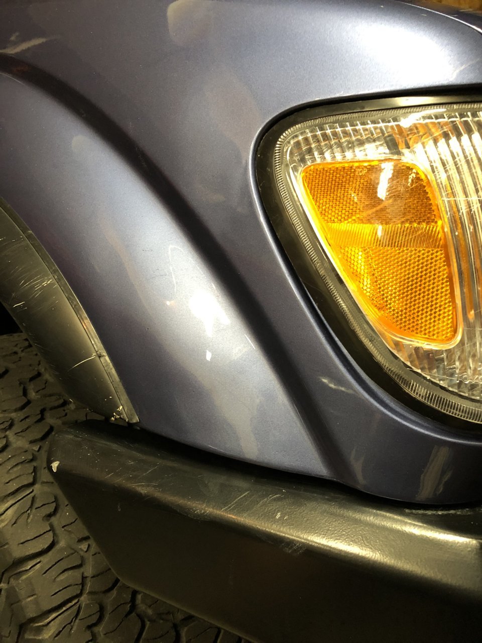

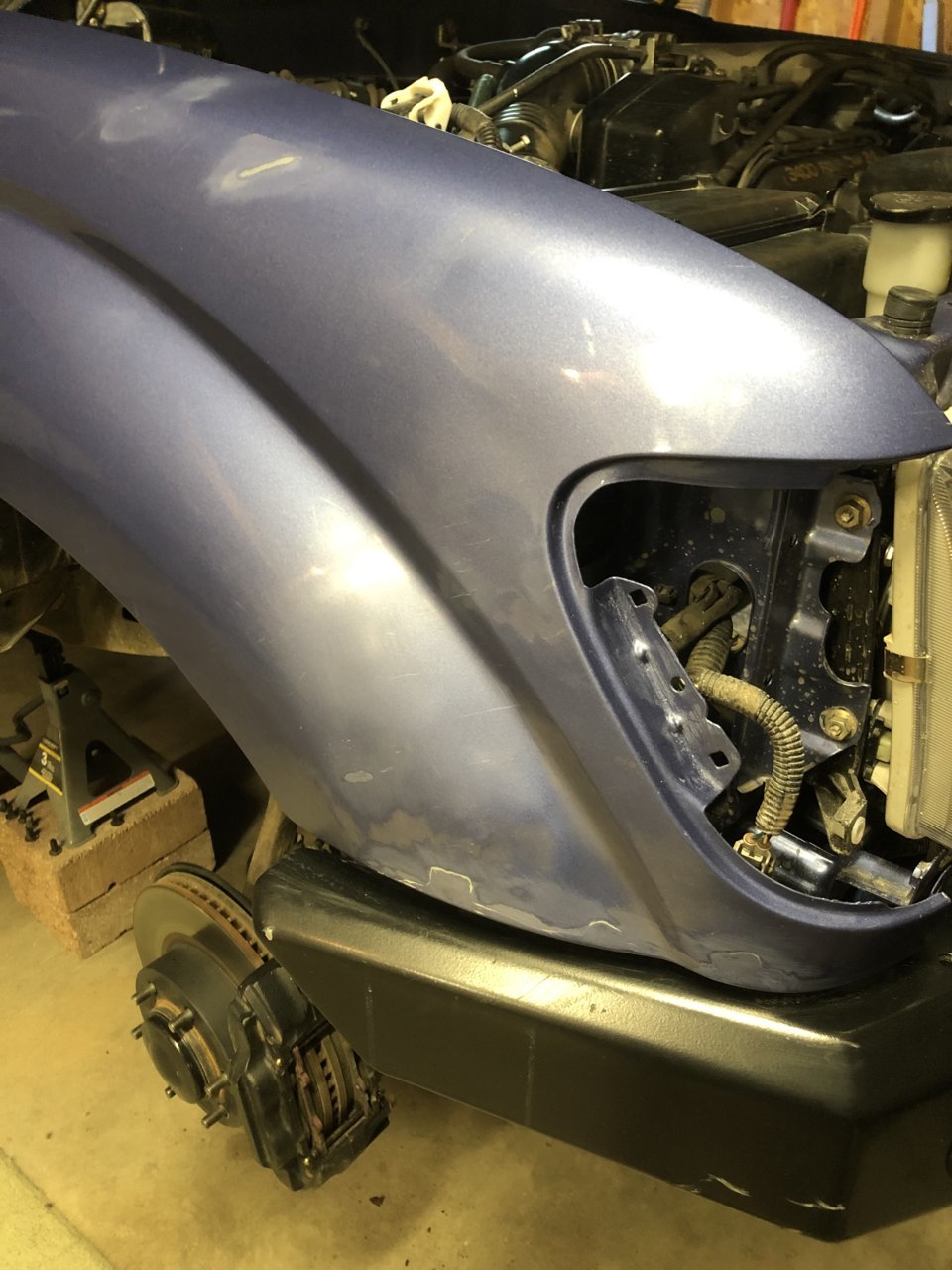

    Winkle received his first war wound wheelin' at Wheeler Lake. As I was climbing the last obstacle before the lake, a large boulder kicked the front end into the embankment, denting the passenger fender:
    I pulled the fender, supported it on the grass at angle that would distribute the load as even as possible, and then hit the deepest indentation with a dead blow hammer. Much of the crease bent back into shape. I cleaned up the remaining undulations with a fender repair tool set my brother kindly let me borrow.
    I sanded out the scratches the best I could. I know it is not perfect. I didn't spend the time to get all the undulations out, but it is good enough for its next round of Colorado pinstriping.
    Frank at Maaco was most helpful. I stopped by before work and asked him to paint the fender as is. The fender was ready to pick up in the afternoon before I left work. I was very please with the results. They blended the paint very well with the existing 8N1 Blue Horizon Metallic and hid many of the preparation imperfections I made from my first attempt at fender repair.

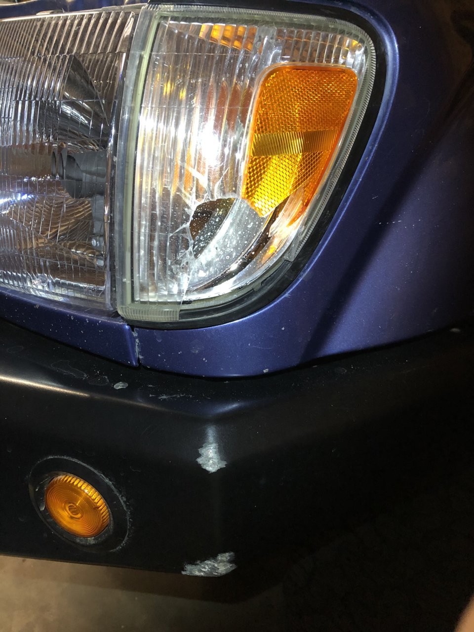

    Also had a little Oops at SOB Hill. I didn't quite clear a boulder and nicked my side light:
    Easy fix. I ordered another side light off Ebay and installed. I'll touch up the bumper when I perform my yearly armor touchups in the spring.
    Winkle is ready for the next adventure in Moab Oct 22 at ROCKtober Therapy.

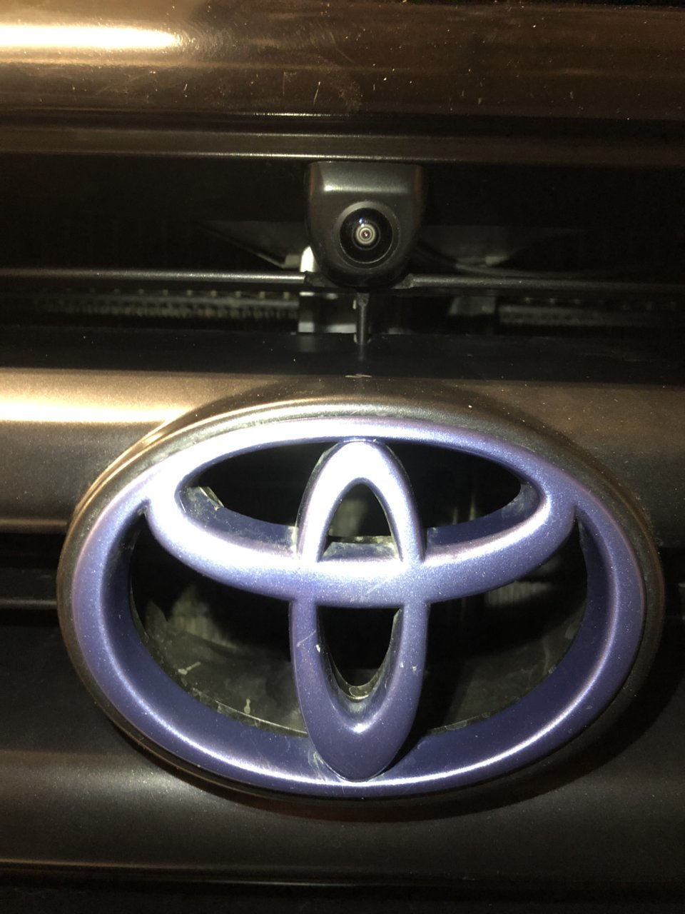

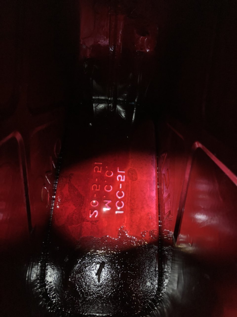

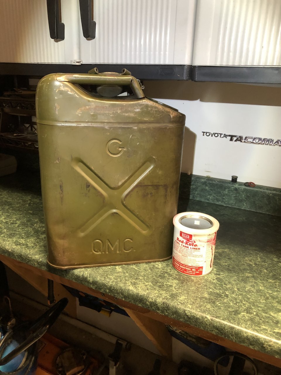

    The front camera image shows a Jerry can that I picked up from @Backcountry chef a few weeks ago as a covid project. It had some expected rust and needed restoration. I ordered new gaskets and a new screw on spigot with a smaller diameter tube that fits inside the Tacoma gas tube. As I waited for the parts, I poured cleaning vinegar (6% acidity vs 5% for regular vinegar or apple cider vinegar) and some old chains into the gas can and shook it periodically over a few days. The rust cleaned up pretty well but there was still some minor scarring at the bottom. I added Red Kote fuel tank liner to help preserve the Jerry can and to keep the gas clean.
    My googlefu revealed that the US 5 gallon gas can originated early in World War II, copied from the German "Wehrmachtskanister" or "Benzinkanister" made in the 1930s. The name "Jerry Can" comes from the slang World War I name for the German soldiers. The X stamped on the side of the can provides strength and allows for expansion as pressure rises from increasing temperatures. The G stands for Gas and the QMC stands for Quartermaster Corps.
    Picture of the interior after Red Kote applied, shows the markings stamped on the bottom and the rust scars on the lower portion of the picture.
    The first line, ICC-5L, is the standard the can conforms to, the second line, M.C.C., is the name or initials of the manufacturer, in my case, Melvina Can Company and the third line, 20-5-51, is the capacity and date, 20 liters-5 gallons, made in 1951. The screw on cap was made by Rieke in Auburn, Indiana.

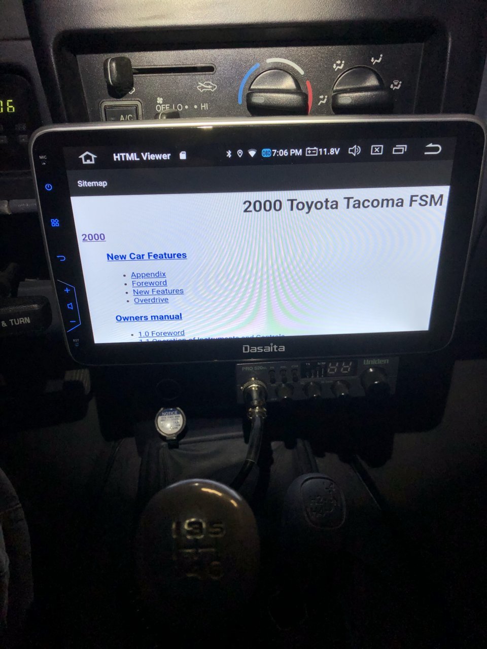

    I loaded Moab maps for offline GAIA use and I loaded the 2000 Tacoma Factory Service Manual into my head unit so I always have it ... just in case.

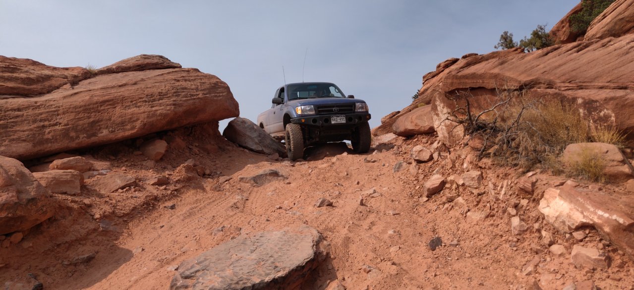

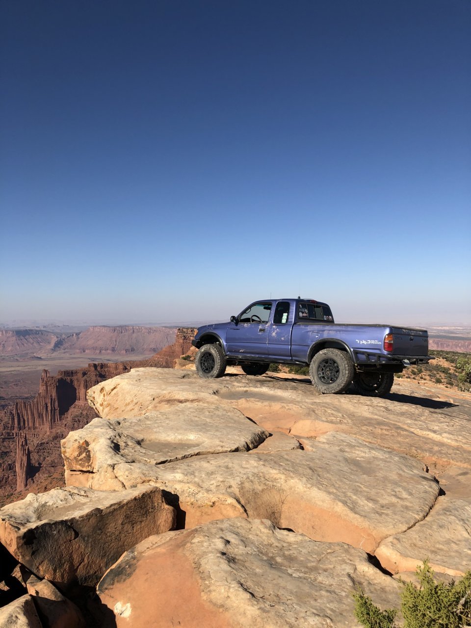

    My Tacoma again proved how capable it is in Moab.
    I hit the trails I planned, Top Of The World, Rose Garden Hill, and Onion Creek, plus two others Flat Iron Mesa and Steel Bender. There were some ledges where I had to get out and stack a few rocks especially taking the more challenging route left (clockwise) up the ledges to Top Of the World. There where times when the rear locker came in handy. I bypassed the chute on Flat Iron Mesa and one or two obstacles on Steel Bender near the end but otherwise the truck just bombed through everything.
    All the armor has new battle scars, the 0.25 inch thick Trans skid plate with angle stiffeners along each side is bowed about 0.375 inches from impacts on the taller ledges. The rear diff has some new minor scratches. Everything else is clean.
    The head unit with Apple Car Play maps (highway) and GAIA maps (trails) kept me on course. The front camera was my spotter as I inched to the edge of Top of the World.
    Here are some pictures:
    Top of the World

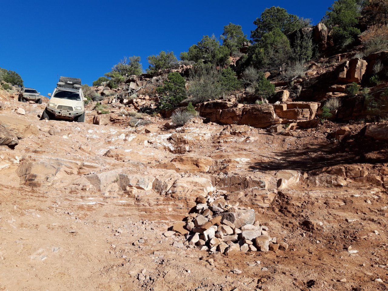

    This is an example where I had to stack some rocks to allow the rear differential to clear the ledge.
    The front camera has the green, yellow, and red guidelines and I stopped the truck when the red guideline went over the edge.
