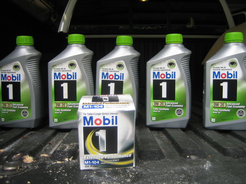

    Total supplies needed:
    9qts of 75W-90 Oil
    6.1 qts of 0W-20 or 5W-20
    1 can throttle body cleaner
    1 toothbrush
    1 oil filter
    1 engine air filter
    1 air filter

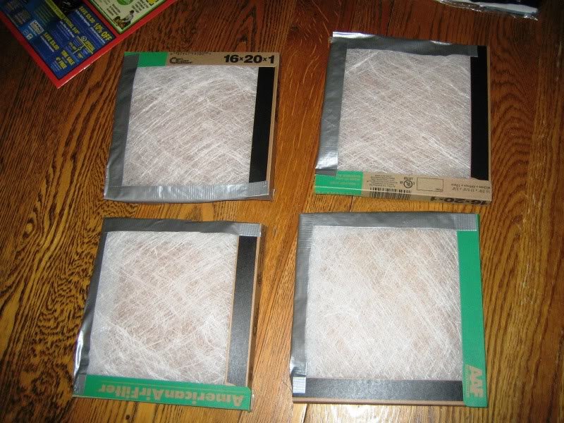

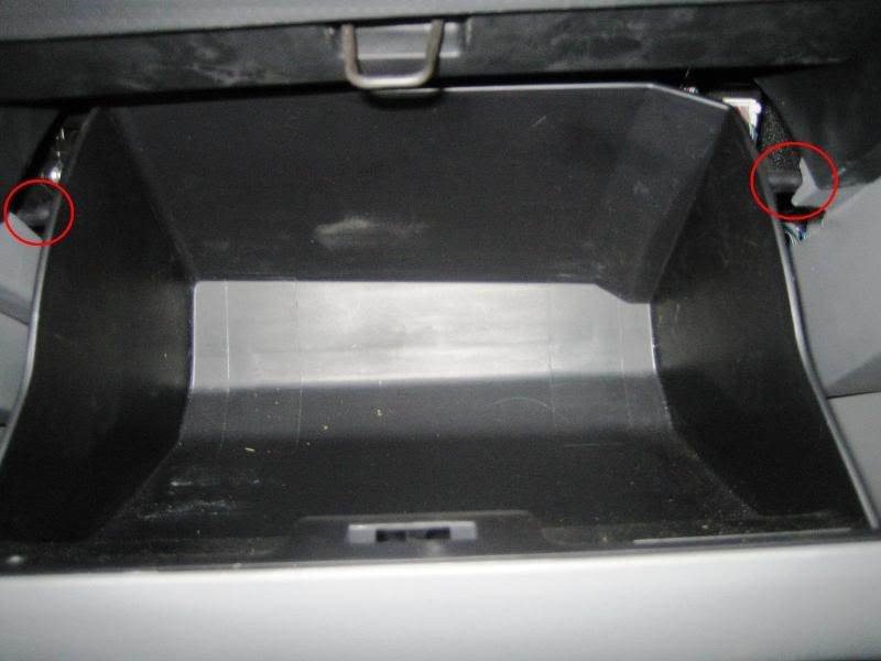

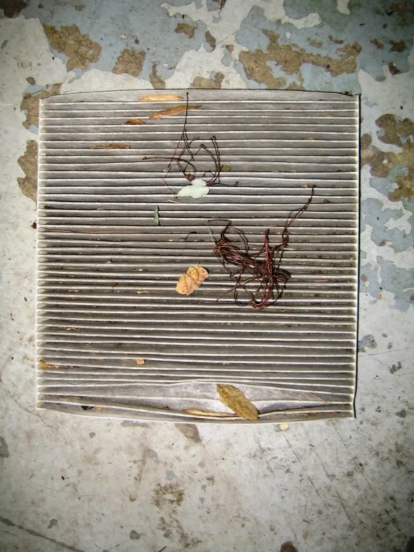

    Here is what I did for the cabin air filter. The dealer quoted my dad $45 for a cabin air filter.
    So I bought a 16x20x1 furnace filter from Sears Hardware for $.89. I removed the old factory filter, and used it as a template.
    I cut the furnace filter to size, leaving two cardboard edges on each of the four new filters.
    Then I made frames on the remaining two sides of filters using duct tape:
    Now I have four air filters for $.89 + duct tape instead of one installed for $45. I bought the filter without wire because I was not positive what I could put in the truck. But I will change these more often then prescribed, because these don't seem to be the best quality.

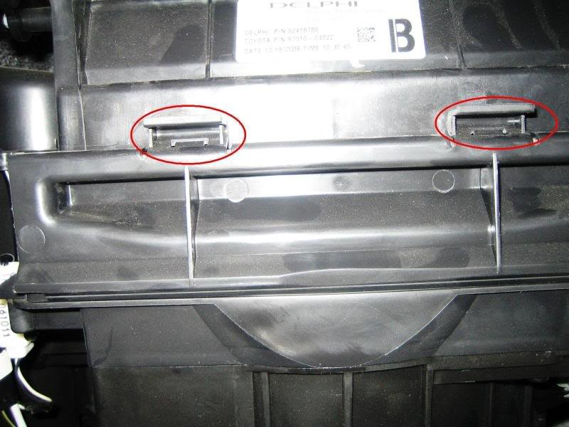

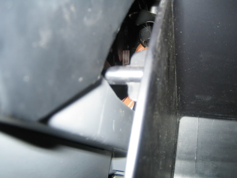

    Now on to the glove box:

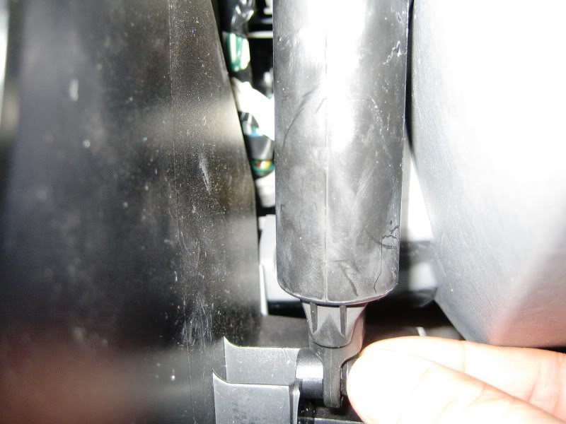

    First you have to remove the dampener (device that lets the glove box open slowly). There are two clips/pegs holding it in: One at the top attached to the dash, one at the bottom attached to the glovebox. The one at the top, I just pushed at the top of the dampener toward the glovebox itself. For the bottom one I pushed the clips at the end of the peg in while pushing out at the bottom of the dampener:
    Then you just flex the glovebox inward at the two pegs holding the top of it to the dash:

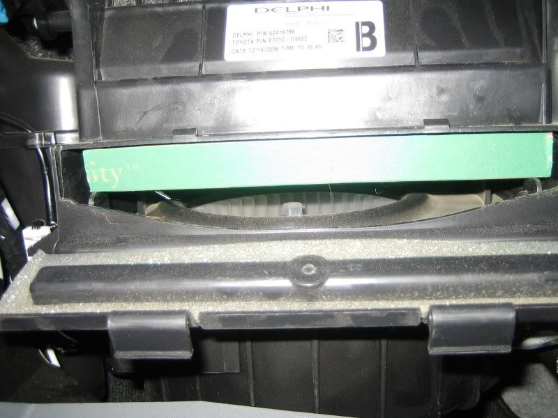

    Then the filter compartment is right in front of you. Just release the two clips:
    And open it up. Pull the filter out:
    And slide the new one in place:
    Now close it all up!

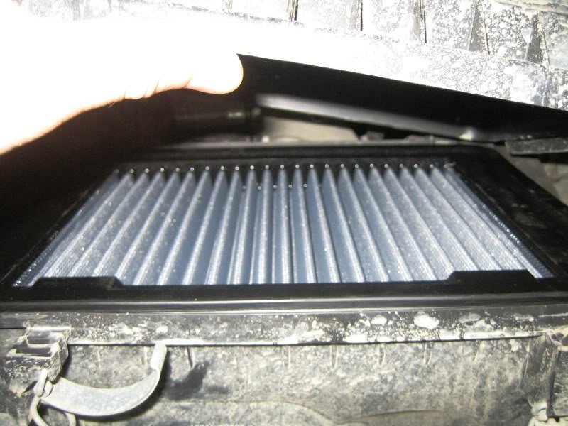

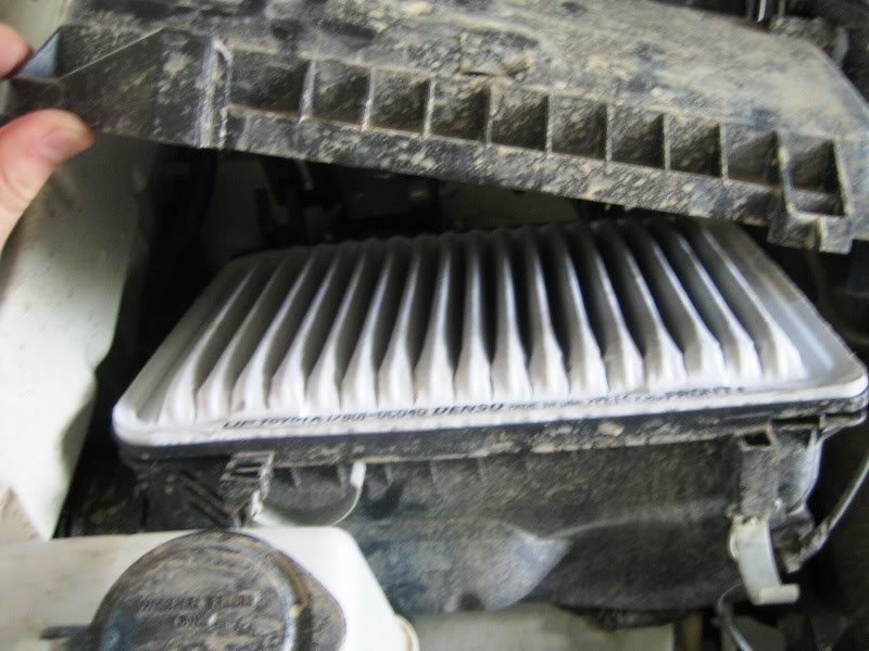

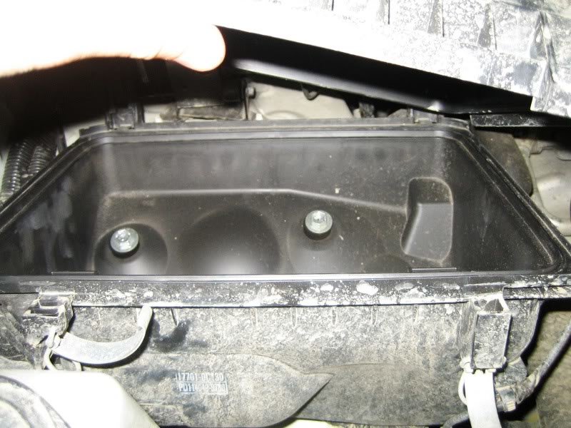

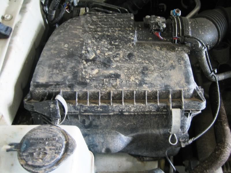

    One of the easiest installs! Pop your hood then find the air box at the front, passengers side of the compartment:
    Pop open the two metal clips on the front and carefully open the air box:
    Then remove the stock paper filter:
    and install the replacement filter:
    Close it back up and you are done!

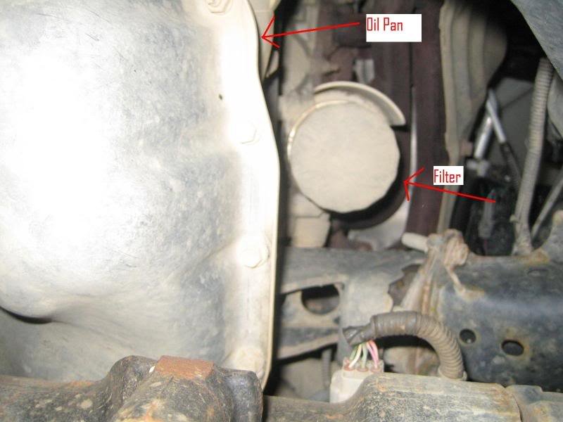

    Just some notes to help you out on location:
    Get under the truck and locate the oil pan. It is toward toward the back of the engine compartment

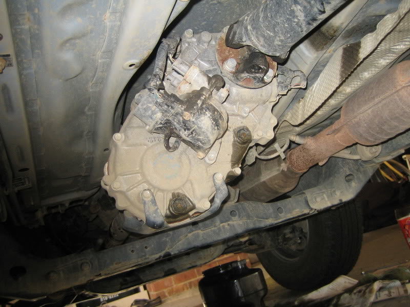

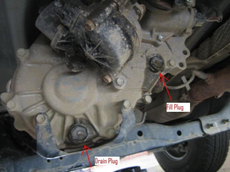

    Materials/Tools:
    24mm breaker bar
    1-1.1 qts 75W-90
    oil pan
    The transfer case is extremely easy to change fluids. Just crawl under your truck and find the 2 piece driveshaft. Follow the driveshaft to the front, and you will find the transfer case.
    Locate the fill and drain plugs. Break them loose then finish removing with your hand. Remove the fill plug first, then the drain plug and be ready to catch the oil as it drains:
    While the oil is draining, clean off the plugs with a rag. Once it has drained, replace the drain plug and fill with just over a quart of oil:
    Once oil begins to overflow a bit, replace the fill plug and you are done!

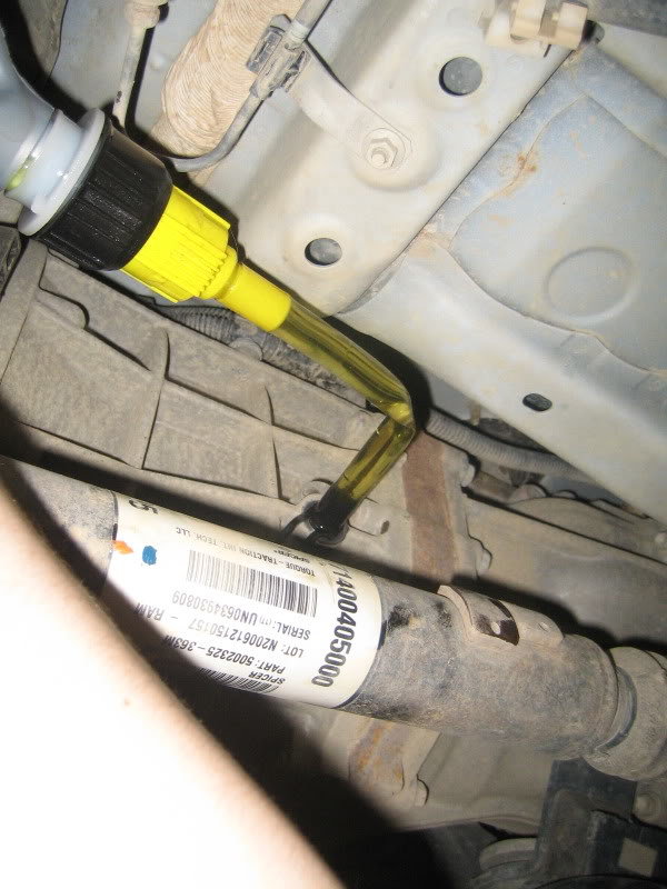

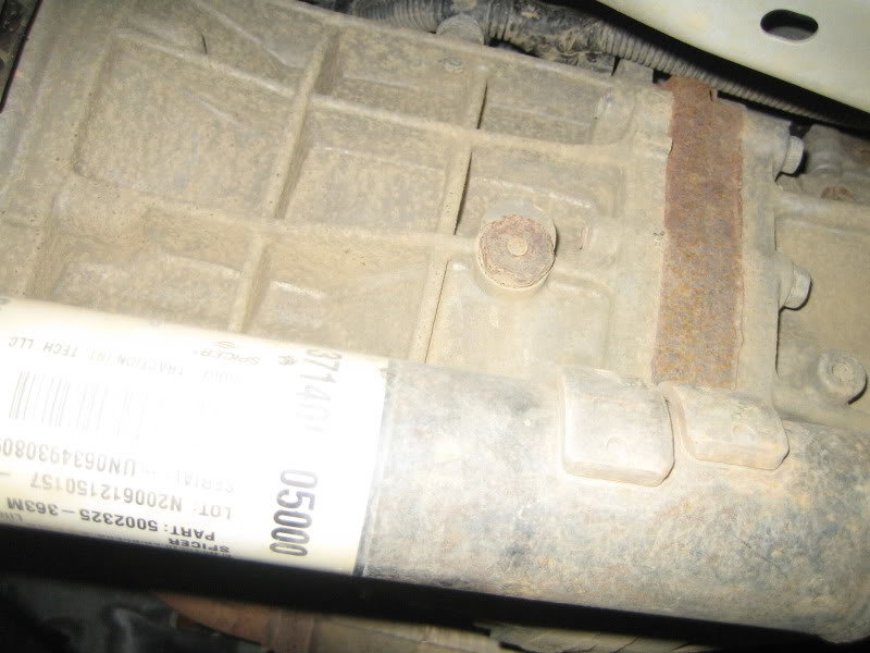

    Materials/Tools:
    24mm Breaker bar
    ~2-3 qts 75W-90
    Oil pan
    Hand Oil pump/hose

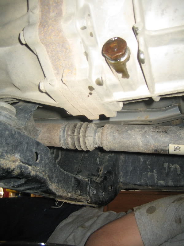

    Crawl under your truck and find your transmission. On the drivers side about half way up and half way back you will find the 24mm fill plug. Break that lightly then remove by hand:
    Then on the passengers side, about half way back and near the bottom of the tranny, is the drain plug. Break that free, then finish removing by hand, prepared to catch the flow of used oil the plug is holding back:
    Once the oil is drained completely, re install the drain plug to ONLY 27 ft*lbs. Then fill with oil until the level is withing 0-5mm from the fill plug:
    Then replace the fill plug and you are done!

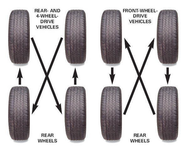

    For tire rotation, I followed this diagram provided to me by bobwilson1977:
    I recommend you take them to a place that will rebalance them as well. Check with them before you rotate, because they are usually willing to do it all for cheap.

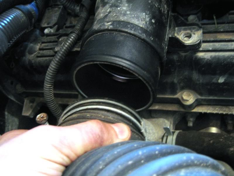

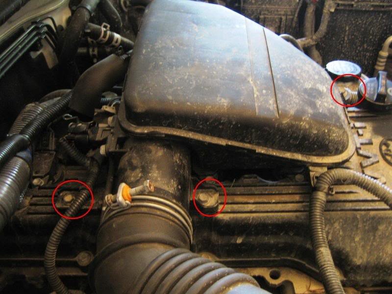

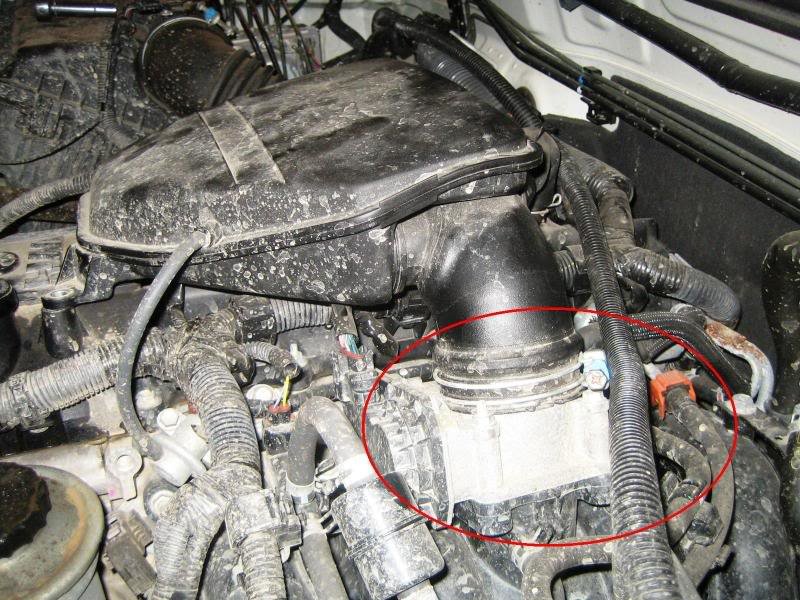

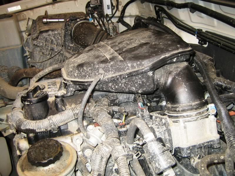

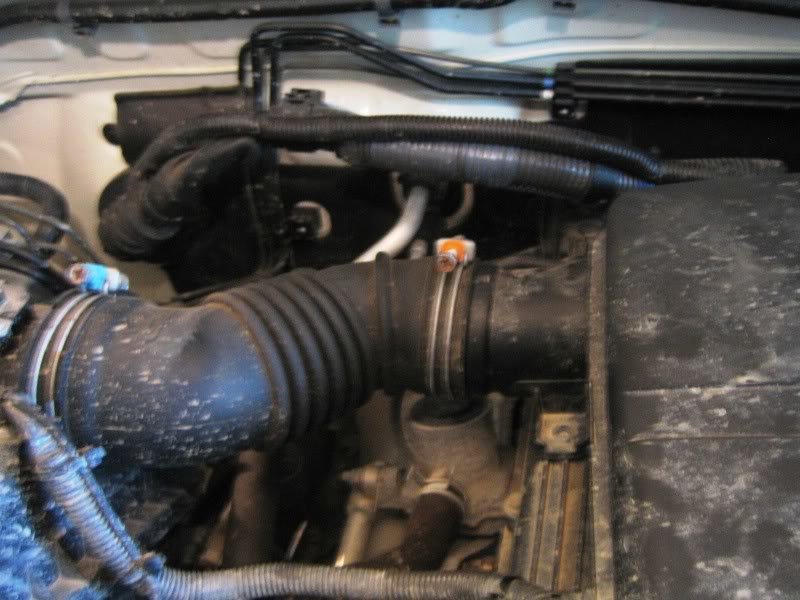

    First pop your hood and locate the air box. Follow the rubber hose from the air box to the top of the engine.
    Loosen the clamp by unscrewing it with the philips head and wiggle the hose of of the plastic housing:

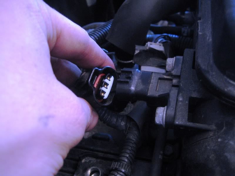

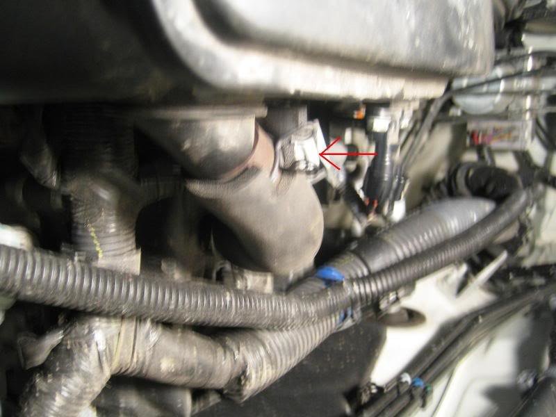

    Now locate the wire harness that is attached to the back of the plastic housing:
    Press the clip on top and unplug it:

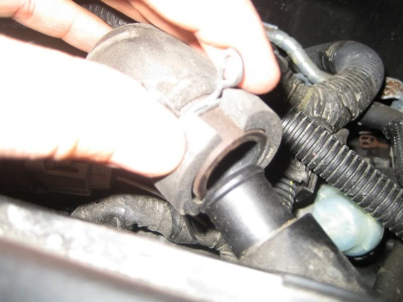

    Next Locate the small, insulated hose on the back of the plastic housing.
    Press on the clamp arms to loosen it enough to unplug it:
    The last step in dis assembly is to remove the 3 10mm bolts holding the "home plate" shaped plastic housing to the top of the engine:
    Then loosen the clamp on the final air hose:

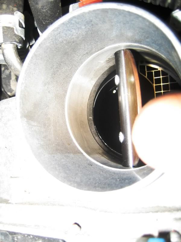

    And now you can clean the throttle body:
    You have to hold open the "butterfly" disc that is just inside the throttle body:
    Now spray the cleaner down in there and scrub away with a tooth brush. This pic shows the difference in the clean side, and the side still covered in carbon.
    Once you have it clean, I used some compressed air in an aerosol can (such as dust off) to help dry it out a little bit. Now just reattach all of your duct work and lines.
