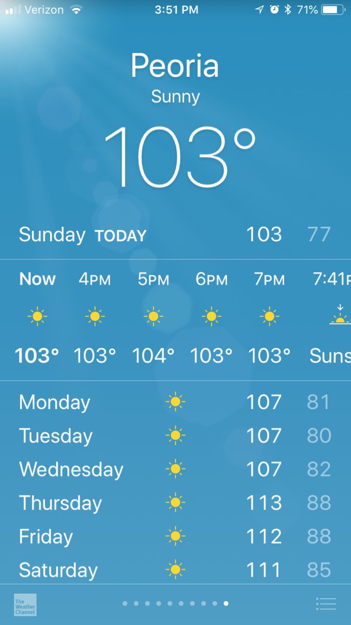

    I’m probably imagining things. But, I’m currently sitting out in the hot parking lot of Party City while the wife ran inside to find some plastic champagne glasses. :crazy:
    Truck is idling. It’s plenty hot out. AC on high. Recirc on. I’m plenty comfortable.
    I need to get a little thermometer to check the vent temperature. But, the butt AC dyno seems to say it’s a tiny bit better that it was last week in similar situations.
