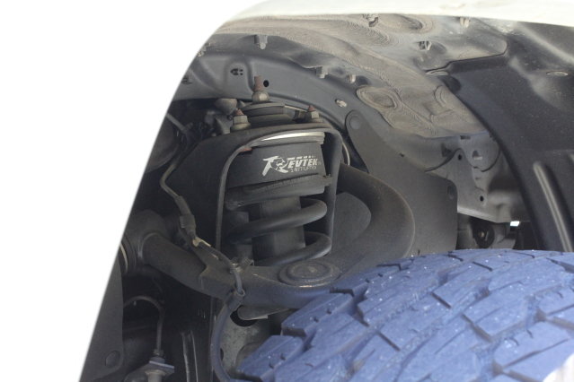

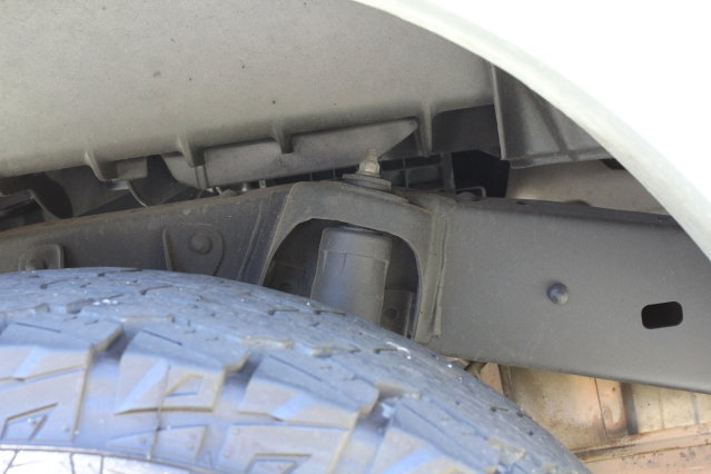

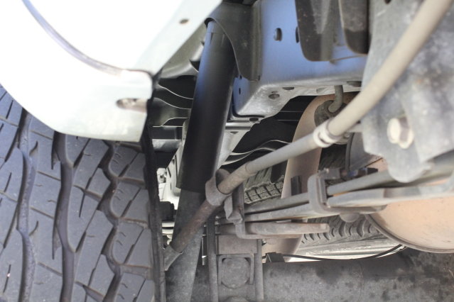

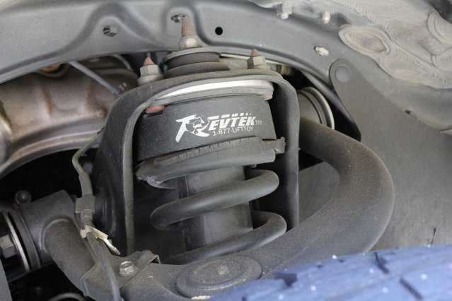

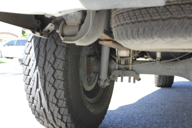

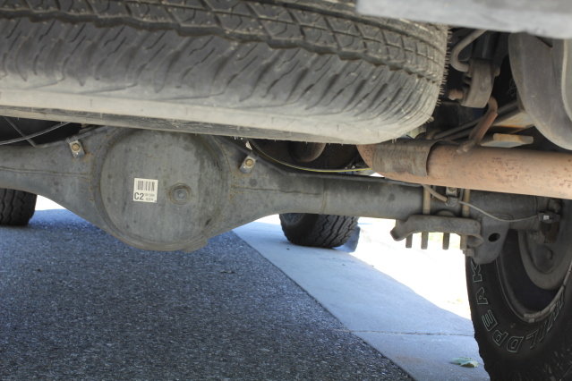

    Thanks for the replies
    Wheels are: Wild Peak A/T Off-Road Tires - 285/75R16 122Q
    Would you guys recommend me to downsize to 265/75R16 wheels then? Would I be able to make some money from that [selling/trading old ones]? Don't want to have to spend a lot of money right now.
    I think it'd just look too silly if I went to stock wheels.
    Here are pics that I got:

    x2 to both. And he's right, that frame looks nice and clean! You should see the underside of my 2007. It's got 88k miles on it and looks 20x worse because of the lovely New England winters :laugh:

    Nice! My tip is to stop calling your truck a car...
    I also agree to get rid of the spacers and blocks and put on some 265/76/16 tires.

    So for my truck I will get 265/75 tires after these current tires need replacements.
    Could you explain the spacers/blocks? Is that just basically the Revtek lift kit?

    Your Revtek kit is a spacer/block kit. The rear is lifted by using a block between the leaf spring and the axle and can promote axle wrap. The front is lifted by stuffing a spacer on top of the coil. It preloads the coil and gives you lift but can also stiffen the ride.

    So after these tires wear down, I'll move to 265/75/16 or 245/75/16 stock.
    Don't have the tools to remove the Revtek kit, maybe my neighbor does. Is it hard to remove? Will it require a shop lift?

    Getting that lift off will be relatively easy. We will need a spring compressor. Where do you live in Bay Area?
