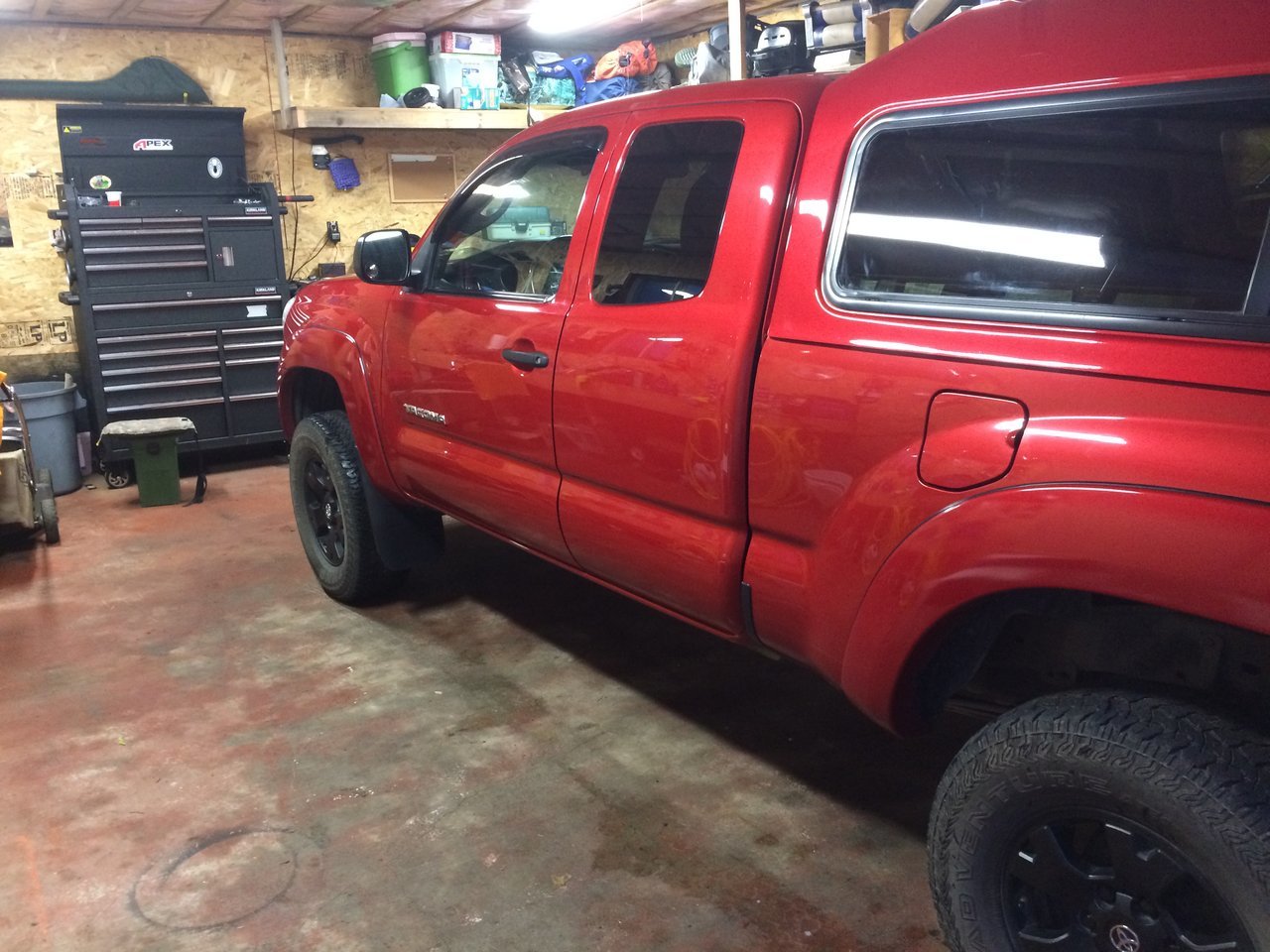

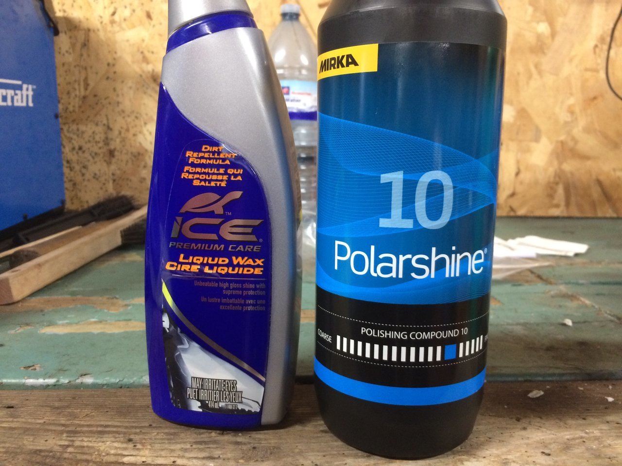

    Sooooo! I've just finished washing, hand polishing (first tine of its life), and waxing (first time in a year and a half). Took me 3 hours and a few beers lol its been a while since I had the truck clean like that! Feels good!

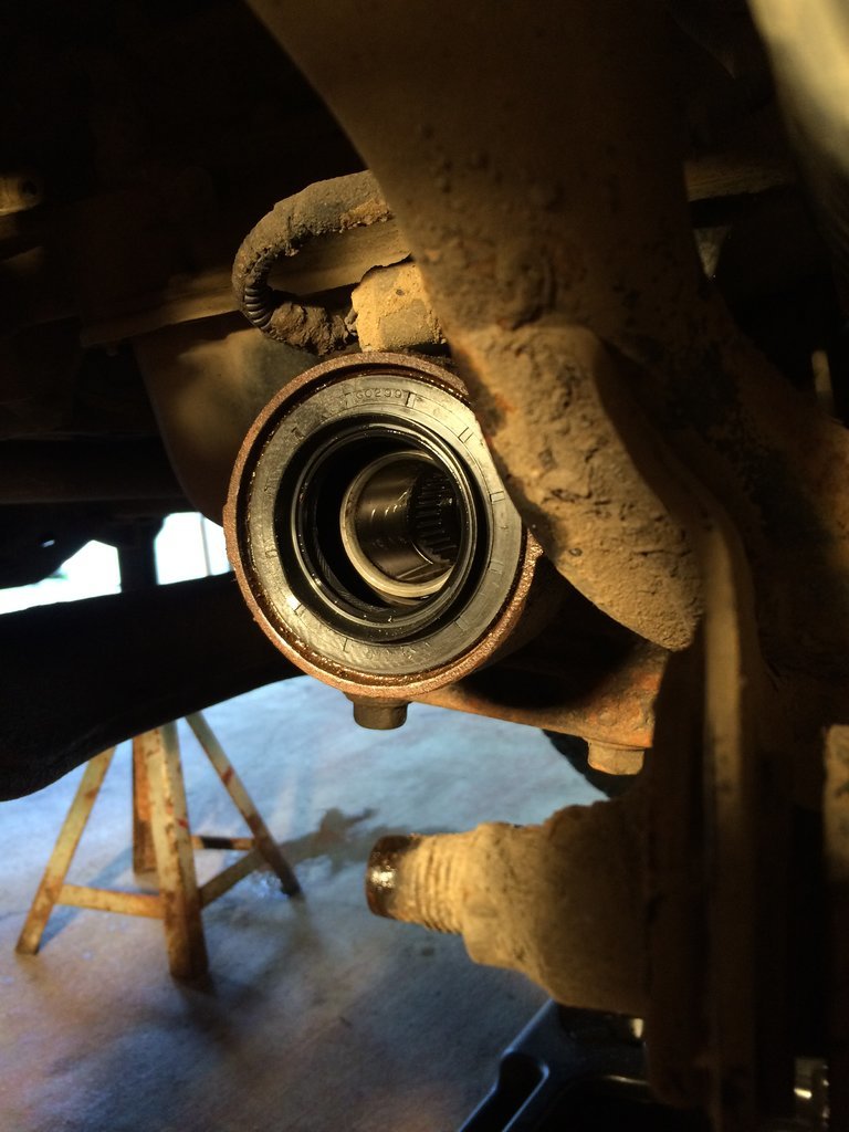

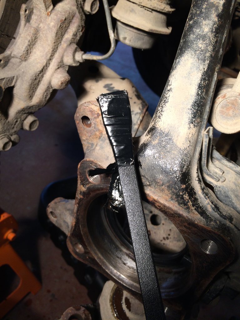

    So yesterday was cleaning, today is a little mecanic. Passenger side axle seal at the diff is leaking since I put the new shaft in, so my guess is that I damaged it when I pushed the new axle in... So today I am take everything apart again to change that seal. Starting it now

    Just took the seal out! That is the hardest part! Used a prybar with tape on the tip as described in this thread : https://www.tacomaworld.com/threads/help-with-front-axle-seal.165522/
    Really useful! But I highly recommebd to have a seal puller since I had to use my foot to push on the prybar to apply enough pressur! Nearly knocky my face in the spindle when it popped out!

    Weapon of the crime...

    Now to put the new seal in... don't know how in hell I'll put it there with all the pressur needed...

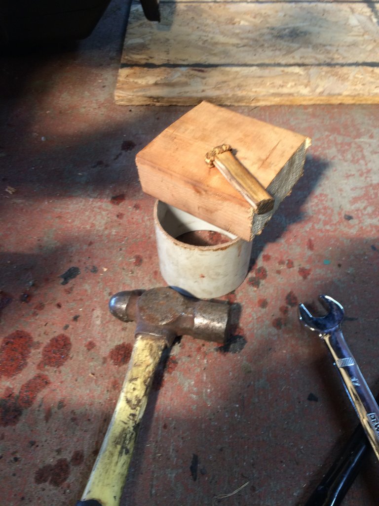

    New seal in. Now to put all back together and go get a 10mm hex head socket to drain the front diff and fill it up with new oil! Hope the seal won't fail since I didn't had the right tools to put it there... if it leaks again I'll get al the tools! Buying tools is an investment!
