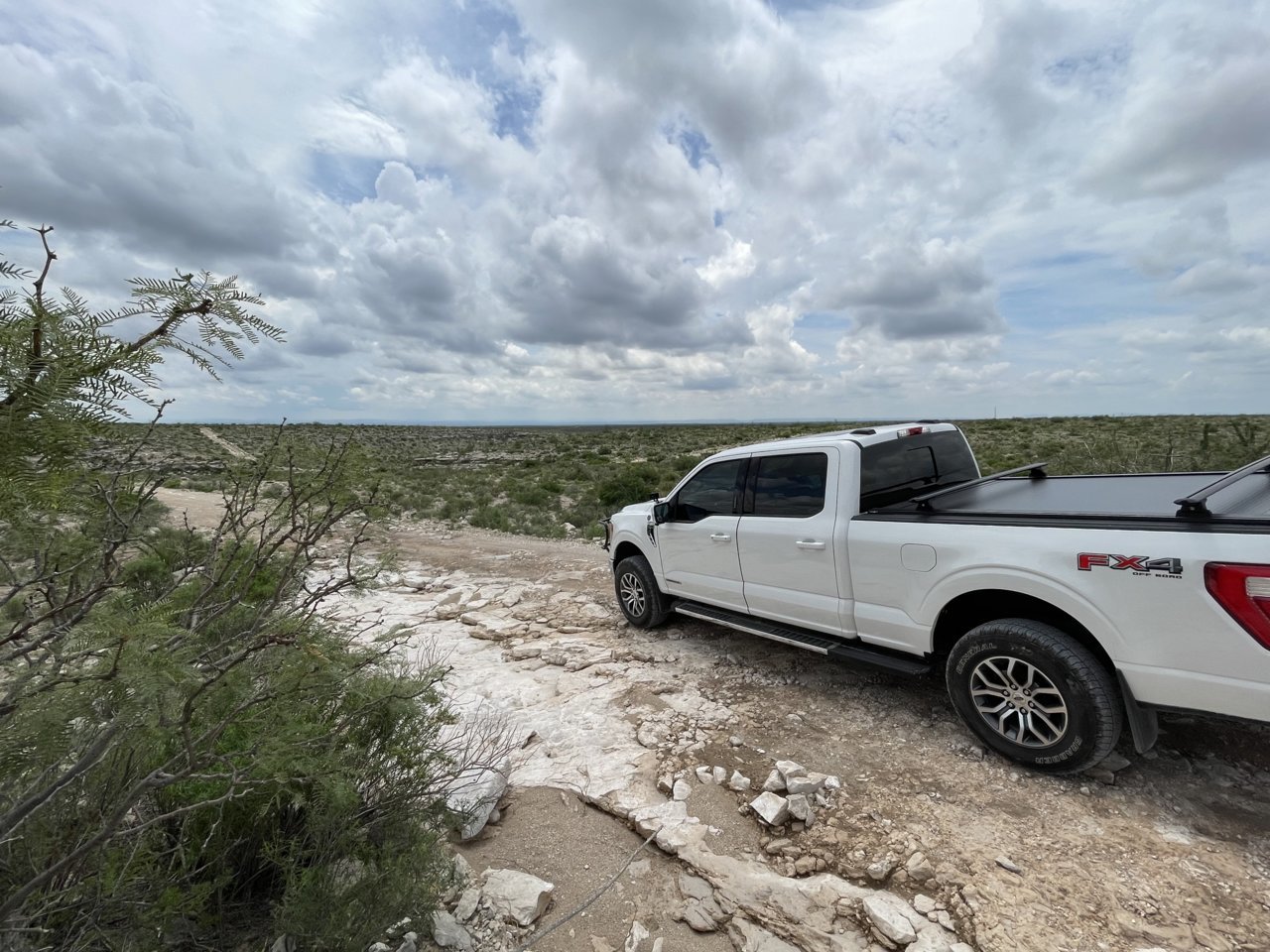

    IMG_9714.jpg New Truck / work truck
    Truck is gone

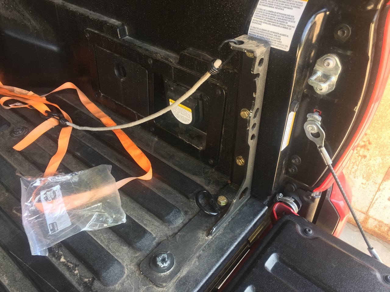

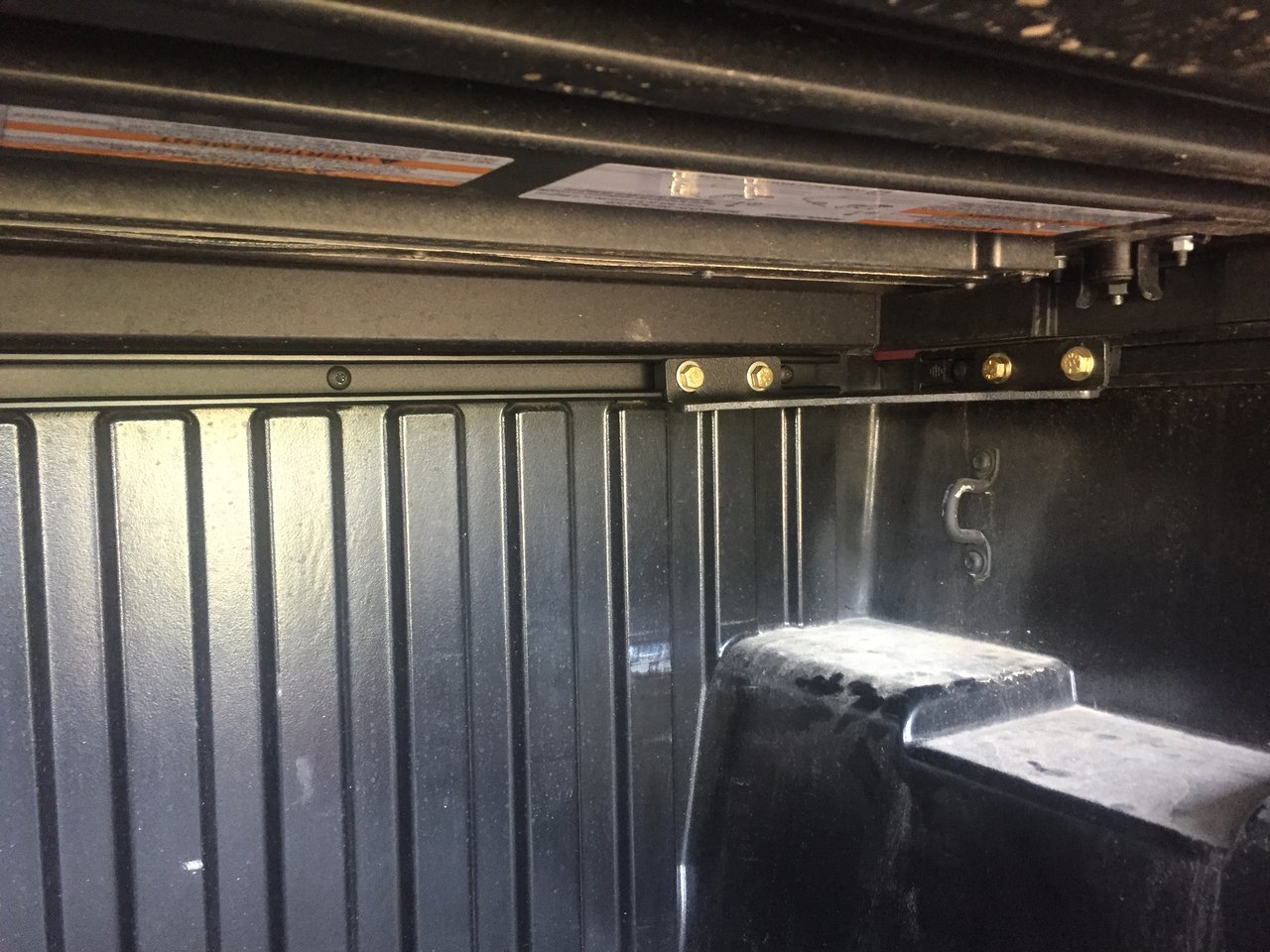

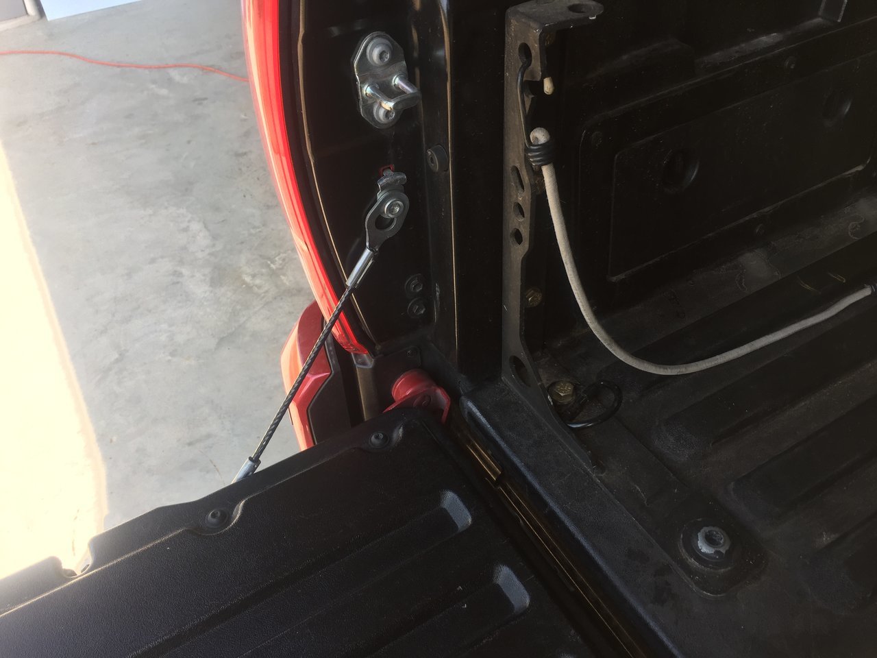

    Just tracking part numbers, end caps for the tonneau cover.

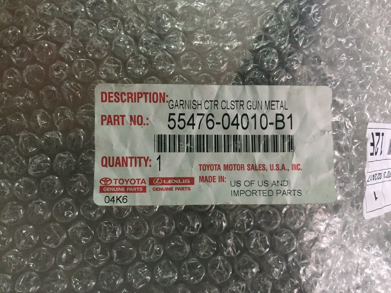

    Dash part numbers.

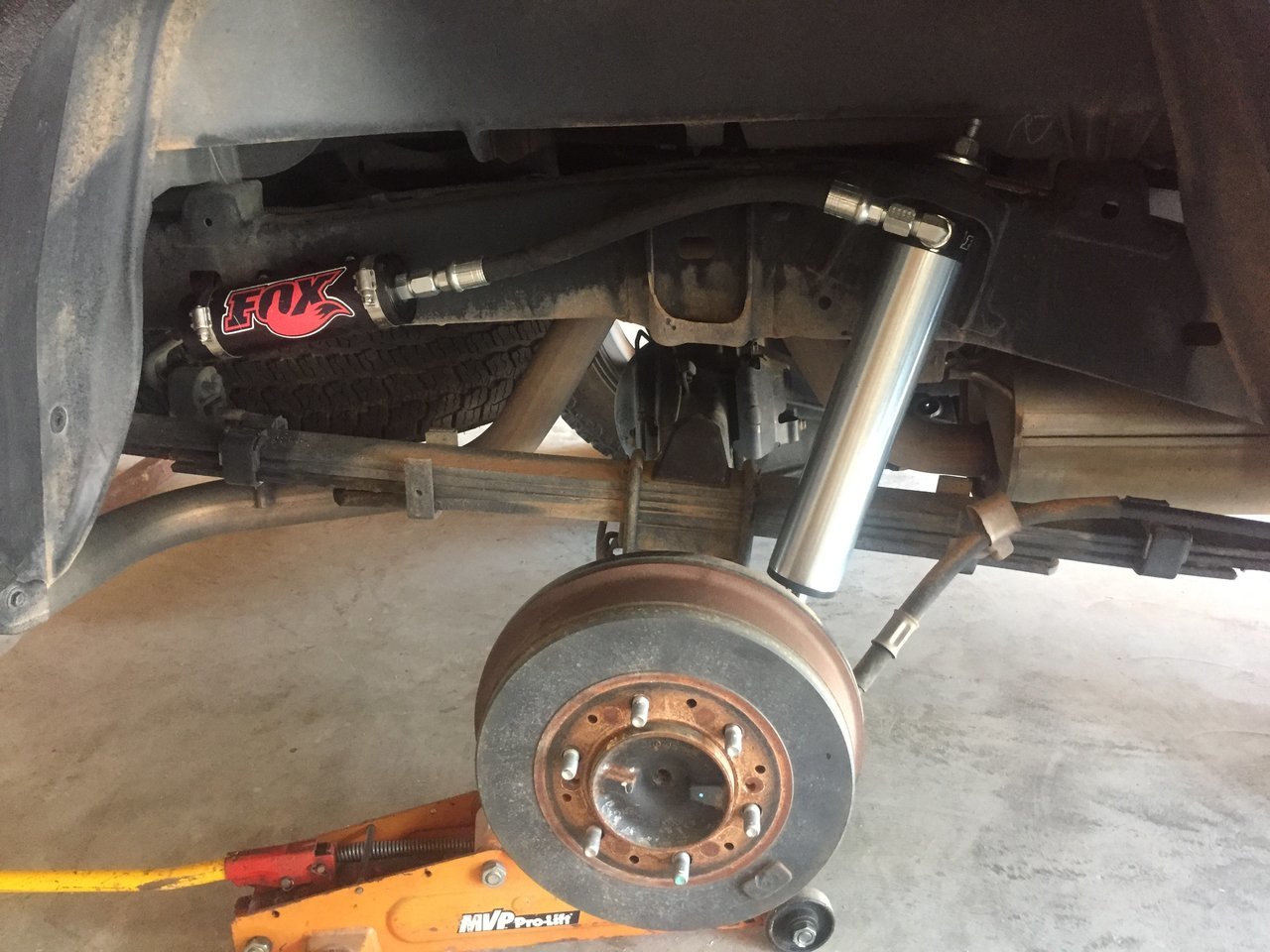

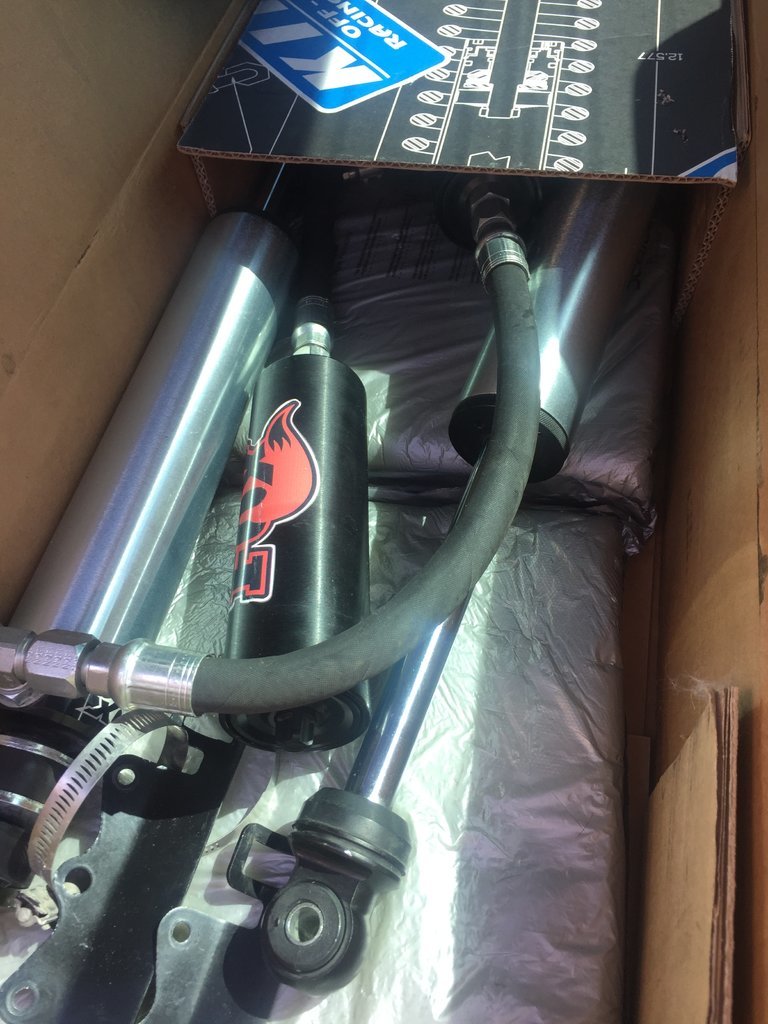

    Did you end up putting these on? They look awesome!

    Sure did.

    Damn that looks sharp! Did you sell the used 5160s I saw you mention in another post?

    Yes, sold those.
    These will be sold once I get my new leafs.

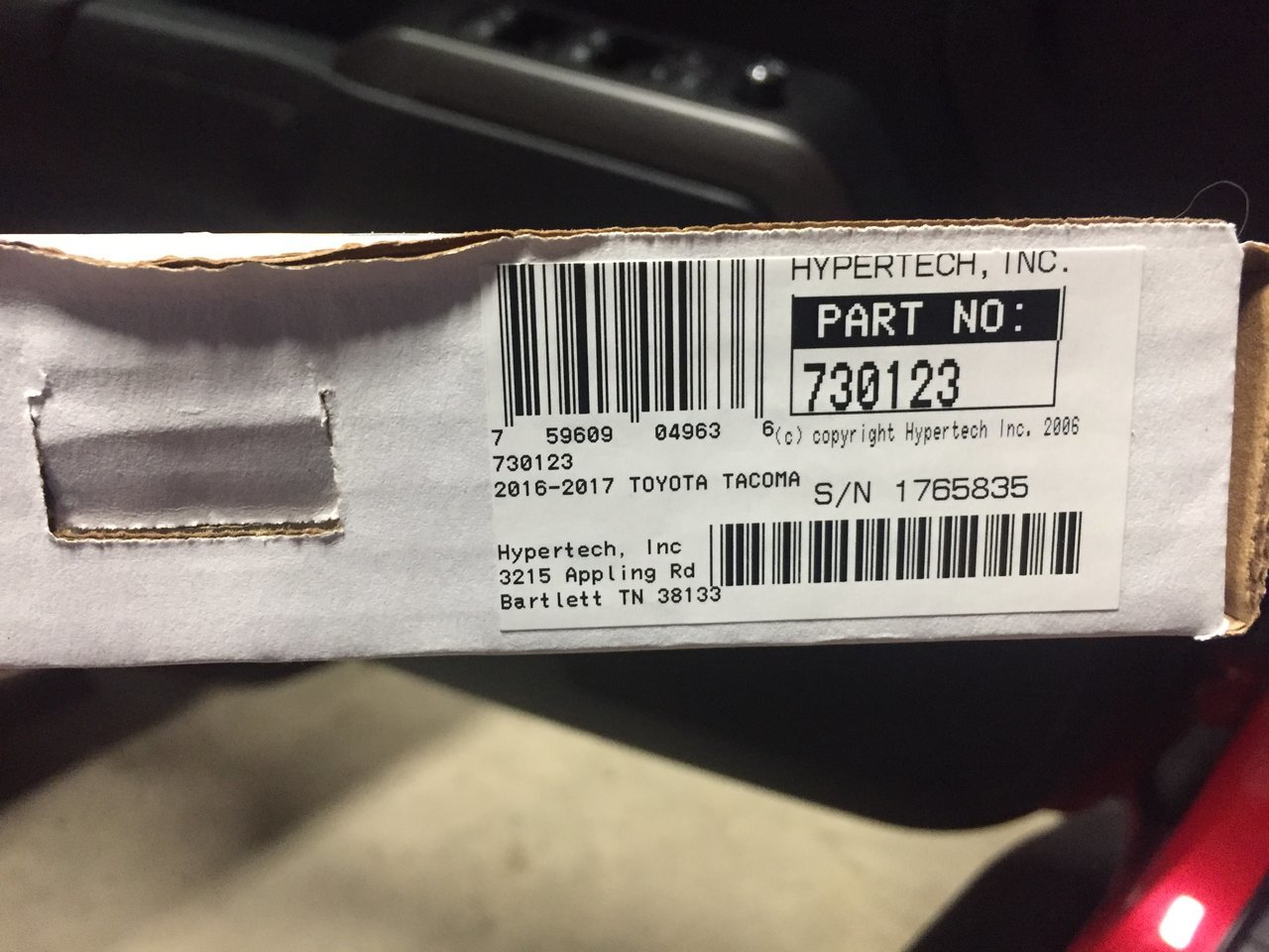

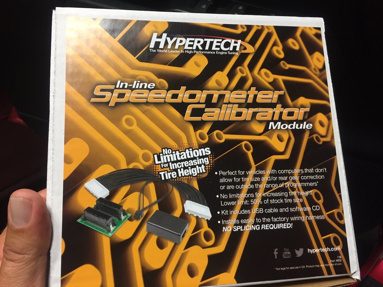

    Well this cleared up the speedo, but the digital one didn't match the analog one so I just changed the settings to not see the digital one. Besides who needs to look at two speedo
    's.
