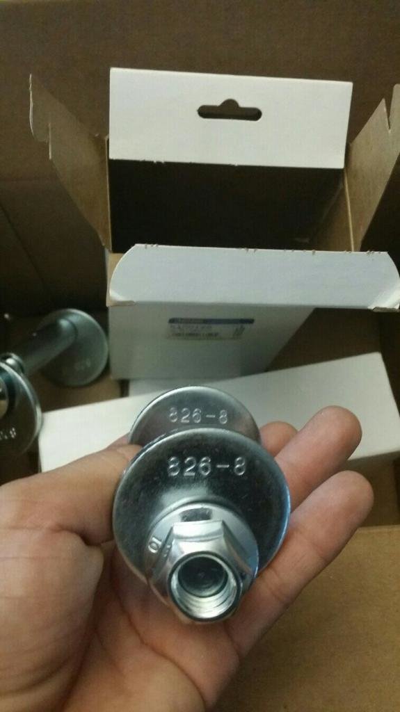

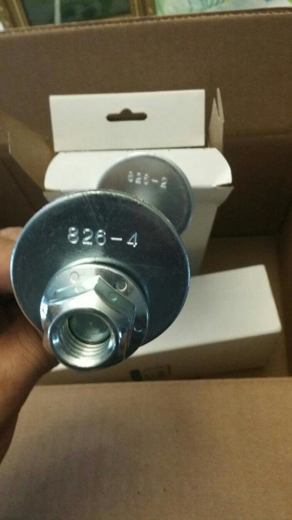

    Update: Now that the proper bolts appear to be shipping with the kits, there have been some questions about the correct part numbers for the "cam discs" placed at the end of the bolts, that move against the alignment tabs. I can confirm that my kits included one 826-2, one 826-4, and two 826-8 discs, and they worked properly. Some people have reported receiving an 826-3 disc instead of an 826-4 disc. Please post if that part has worked for you, or any problems with the kit.

    Photos of the correct parts included in one kit (thanks V5ioV). Each LCA requires a kit.
    826-2and826-4_zps8a1fb8ad_161a6bbf5153db493fc1a6d509a342736fc499e2.jpg826-8_zps27c24aad_5b9e0b6d836b22437a68f670f750a6db2ba2b86b.jpg

    fail... :(
    I got all 4 the same size. :pout:
    I know a certain parts supplier that's going to be getting a phone call tomorrow...
