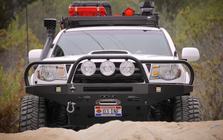

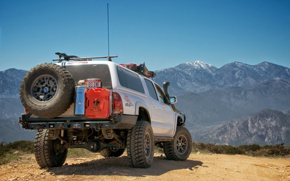

    2006 Toyota Tacoma 4WD w/TRD Sport Package and OEM towing package
    EXTERIOR
    • All-Pro IFS skid plate
    • Armortech rear wrap-around bumper (modified by Demello Offroad) Build Link
      -Hi-lift points
      -Recovery points
      -Rear Rigid Industries SRM Backup Lights
      -Integrated hitch

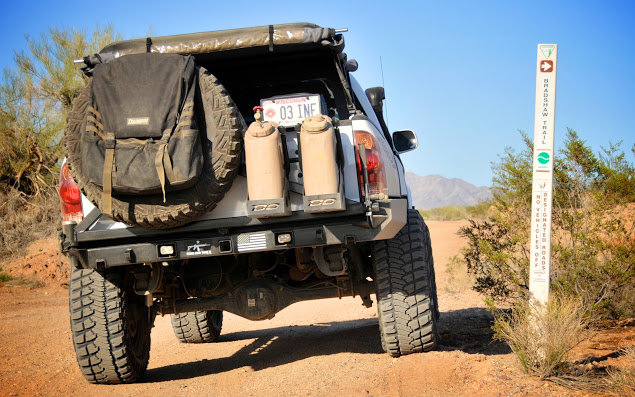

      -Demello Offroad Tire Swing-out
      -Adventure Trailers Aluminum Scepter Can Holders
    • Blacked-out front Toyota emblem
    • Debaged emblems
    • Demello Offroad Bolt-on sliders Manufacturer Link
      -Re-coated in August 2015 with POR-15
    • Extended rear differential breather DIY Link
    • Flowmaster 40-series muffler
    • Gator-Saver tailgate reinforcement
      -Line-X covered
    • Toyota OEM bed mat
    • Window tint 35%

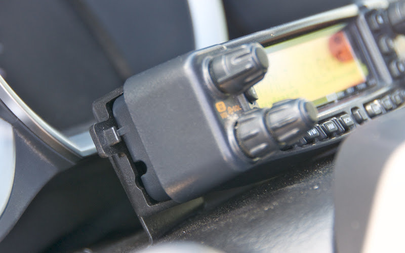

    • Yaesu FT-8800R HAM radio
      -External speaker
      -Larsen 2/70B NMO antenna

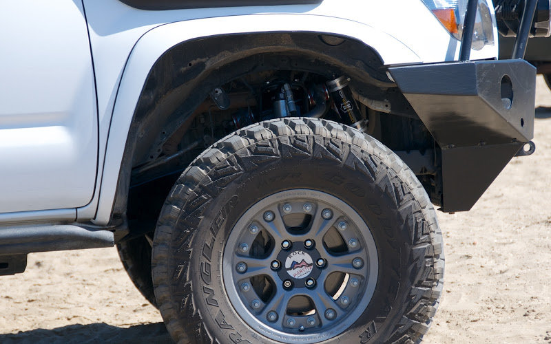

    FRONT SUSPENSION
    • Total Chaos Toyota Tacoma +2" Long Travel Manufacturer Link
      -Toyota Tacoma 05+ Tacoma Extended Axles
      -Icon Vehicle Dynamics 2.5 remote reservoir long travel coil overs with King 700 16" springs
      -Total Chaos alignment cam gussets
      -Total Chaos spindle gussets
    • Removed front sway bar
    • Timbren Bumpstops
    REAR SUSPENSION
    • All-Pro Rear U-Bolt Flip Kit
    • All-Pro Expo Springpack
    • Timbren Bumpstops
    • Icon 2.0 remote reservoir shocks
    DRIVETRAIN
    • ARB air locker (rear)
      -ARB 4x4 Accessories CKMTA12 Twin Air Compressor Kit Product Link
    WHEELS AND TIRES
    • Goodyear Wrangler MTR w/Kevlar 35x12.5R17
    • Power Stop Extreme Performance Drilled and Slotted Brake Rotors Rock Auto
    • Power Stop Truck and Severe Duty Brake Pads Rock Auto

    Desert Rendezvous, Red Canyon Jeep Trail, Bradshaw Trail Mar 15-16, 2013

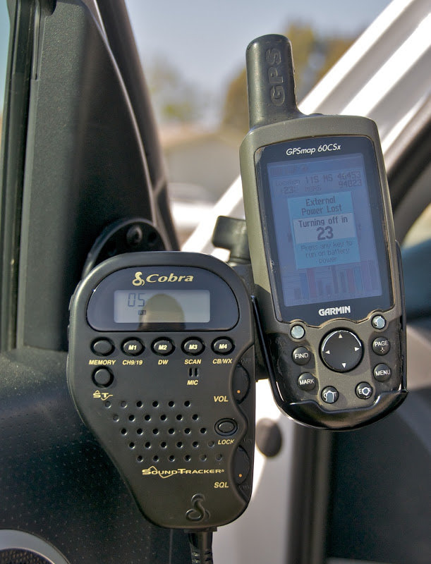

    I mounted my Garmin GPS 60CSx in the corner of the window where the black plastic piece is. This is the best location I have found for this unit for visibility and ease of use.

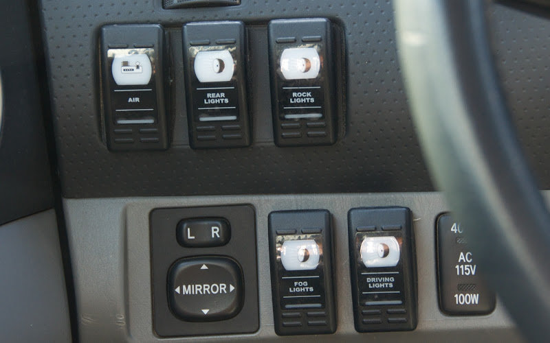

    Switches for front lights.

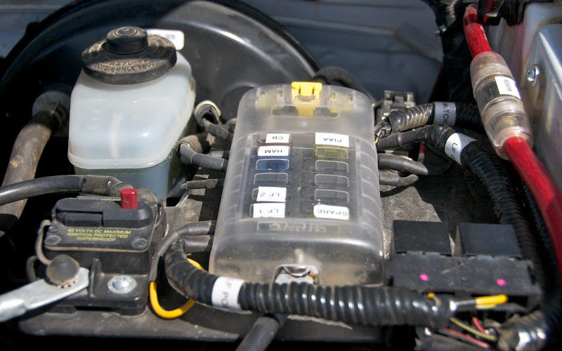

    Fuespanel for misc electronics I have been adding.

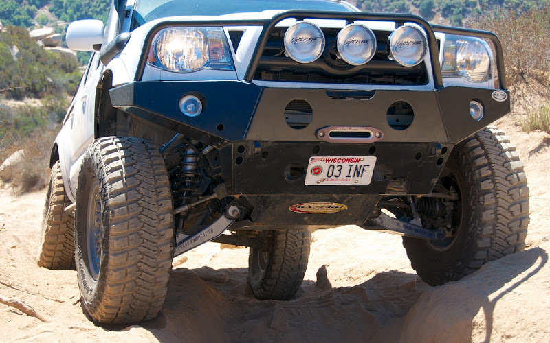

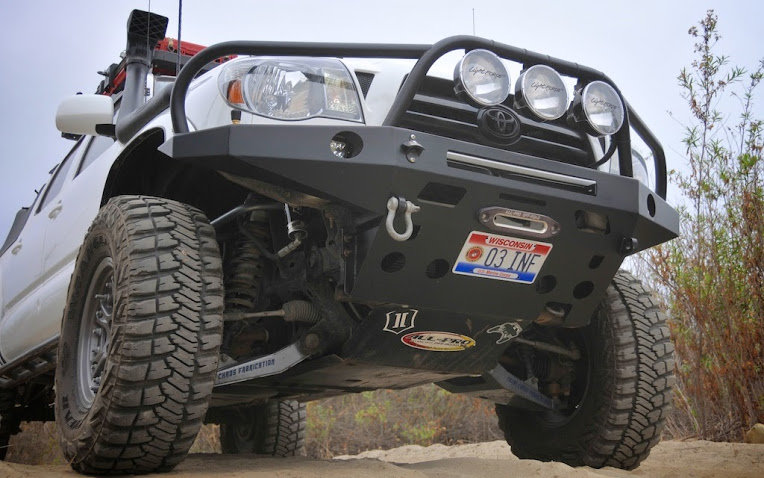

    Lightforce lights mounted to an All-Pro plate bumper.
    All-Pro plate bumper. Here she is with the new tires (BFGoodrich Mud Terrain TA KM2 in 285/75-16) mounted on Wheelers Alloys 16x8.

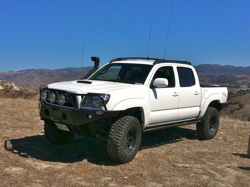

    I took the plunge and added a snorkel from Safari Snorkel.

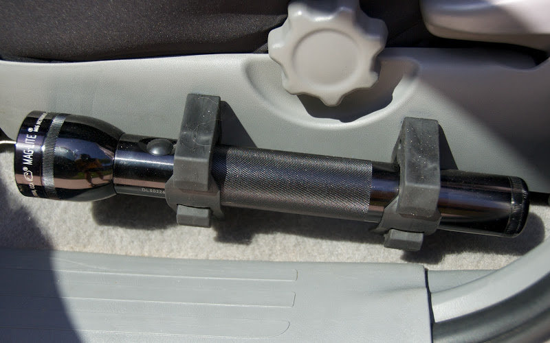

    More quick fist for a maglite added to the drivers side seat

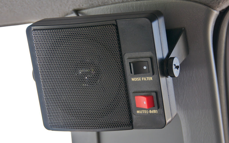

    Speakers for CB/HAM mounted on center pillars. Drivers side is HAM, passenger is CB. These were like $15 for both on eBay.
    Current switch setup.

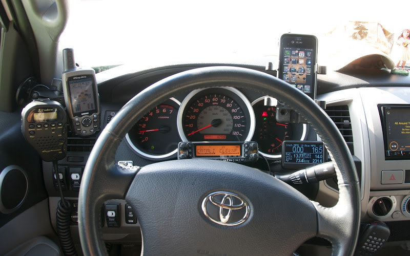

    I upgraded my radio to a Pioneer AVH-8400BH and with it being a double DIN, it gave me the excuse to go ahead and get a Cobra 75WXST CB radio. I also moved around a few items and cleaned everything up a bit.
    This is the new setup. I wanted everything within plain view for the driver.

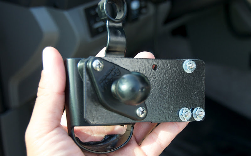

    The 75WXST was mounted next to the Garmin GPS. I used a piece of flat metal from the hardware store and mounted the mic holder up.
    The Yaesu was also moved up on top of the steering column. I used two l-brackets that costed $.60 from Lowes and painted them black. For the mic, I put velcro on the back and mounted a velcro strip below the AC controls.
    Front of plate with the mic holder for the 75WXST. The mic holder I got off of ebay. The mic won't fall out when you are out on the trails with this holder.

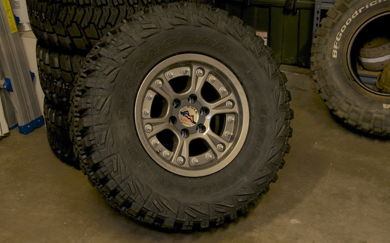

    Finally got around to start assembling the Hutchinson's.
    Had my little helper doing what he always does...cause trouble.
    1 down, 4 more to go.

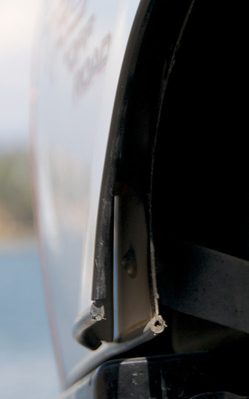

    Spent the day at Fiesta Island today. Flares are about 90% complete. I eventually chopped 4 inches off of the flare. One of the pictures shows the flare. May not be as clean as it can but I like it the way it is.
    Picture of the flare.
    Full profile
    Rear fender well
    Front fender well
    Had a chance to test out the new suspension and air locker today. Air locker has made a load of difference. Places that I had some trouble getting up before I had made it up in one shot with no problems. Got my moneys worth out of that today.
    At one spot it was a battle between the fender flares and the tires. Tires won. My steering wheel is now cocked at a 20 degree angle to the right. Going to get it re-aligned tomorrow afternoon.
    I am very pleased with everything so far. Now I just need the new Icon shocks to get put in. The fox's are garbage and are worn out.
    Tires - 1, flares - 0

    Pelfreybuilt bumper added
    35's rubbing on the All-Pro bumper going down a hill on Cleghorn

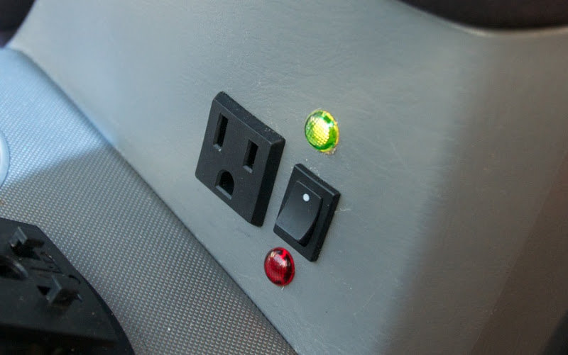

    Hey boss,
    where did you get the fuse panel? That is great if you are going to have a bunch of accessories.
