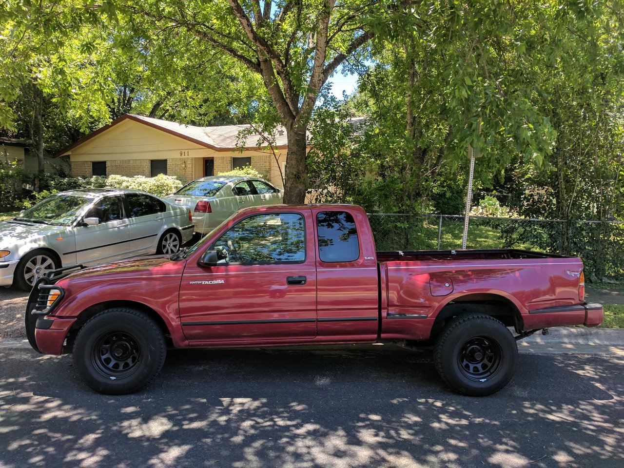

    With 3” lift max tire size will be 30x9.5 with minor trimming, anything larger will require more modifications.
    With 6” lift recommend tire size is 32x10.5 with trimming max 32x12
    With leveling kit it is possible to run 30x9.5 tires with minor trimming but you will still rub alot, would recommend 28x8
    Rubbing issues with larger tires have to do with rubbing on the back of the wheel well where the pinch weld is, on the frame during full lock, and top of the wheel well under compression

    Official part numbers for my rear setup:
    Bilstein 33185590 Shock Absorber
    Bilstein 33185606 Shock Absorber
    2 of Energy Suspension 9.8108G 3/4" Hourglass Shock Eye Bushing
    Explorer Pro Comp 13120 Rear Short Add-a-Leaf Kit
    Fabtech FTS200 Soft Ride Add-A-Leaf Kit
    This yielded about 4" of lift and increased shock travel to ~8.0-8.5 in
    I just went to Autozone to get longer U-bolts. The center pins for the AALs were included in their boxes.
    Here's a pic with the Daystar spacer lift on the front and freshly installed rear parts mentioned above.
    There was still about 1/2 - 1 inch of rake when I installed the DT spindles, but it looked fine after that.
