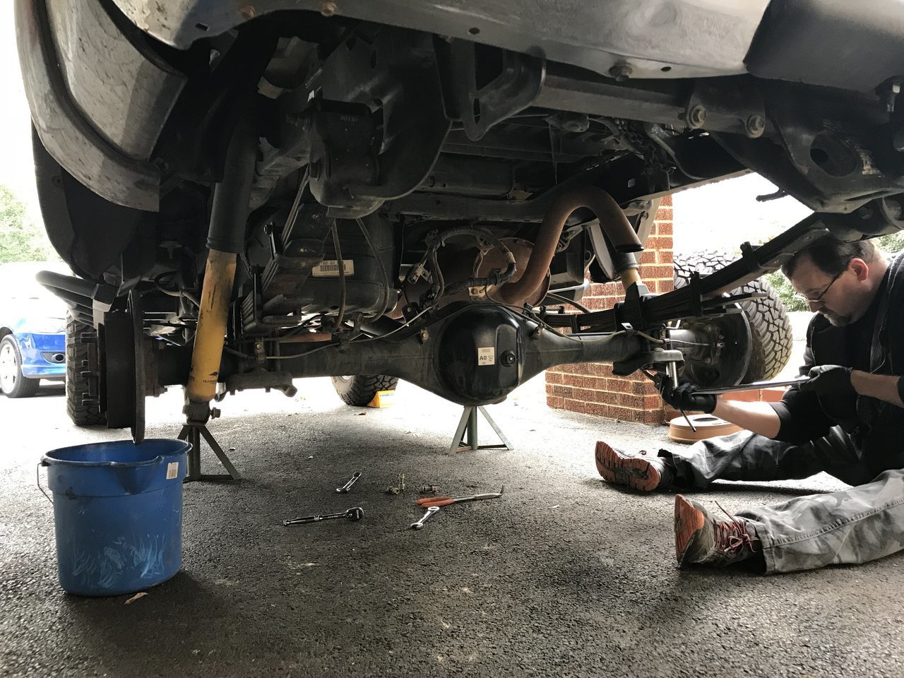

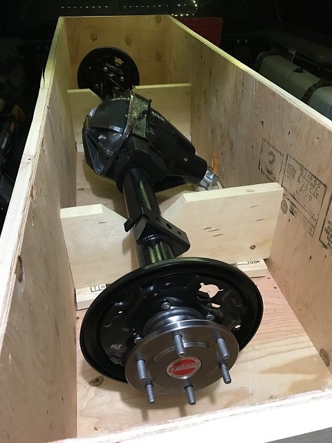

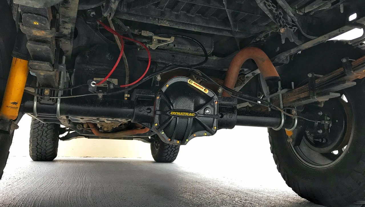

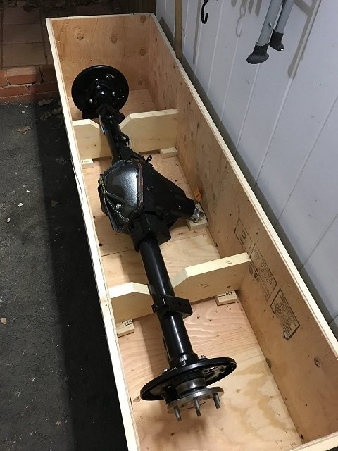

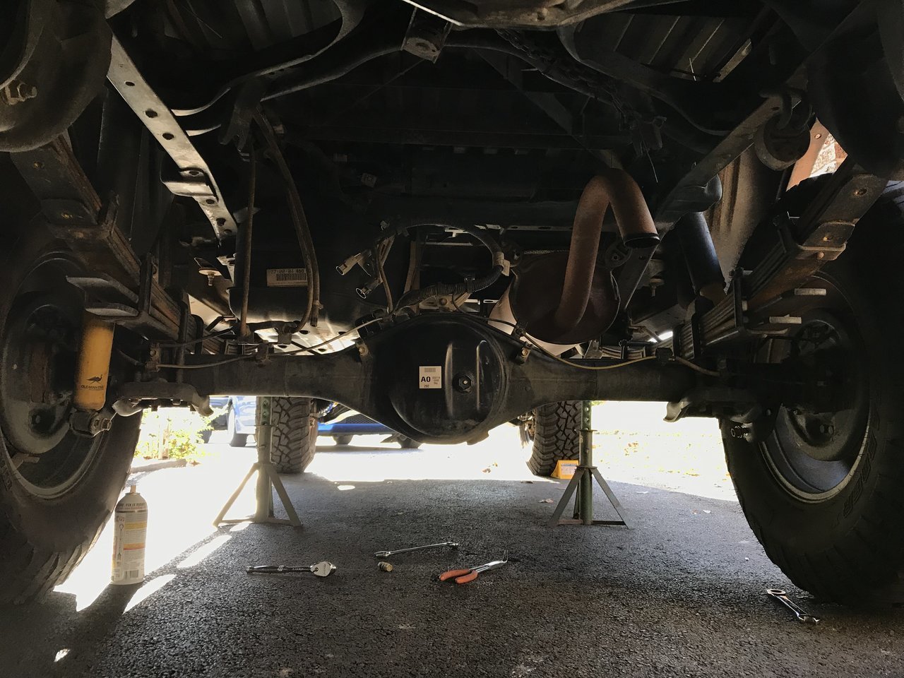

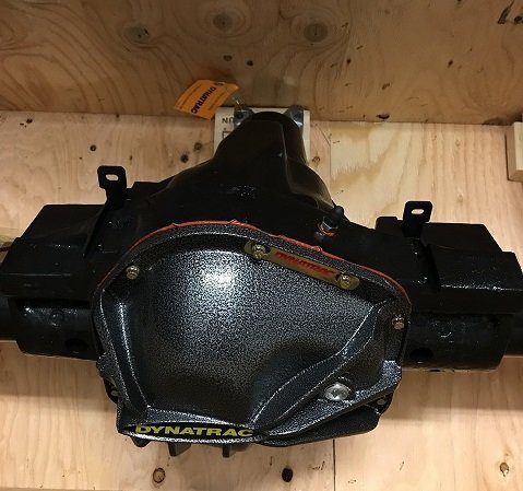

    Dynatrac Rear End Upgrade
    This story starts back around January 2017 or so if I recall correctly. A friend of mine tagged me in a post on Instagram about a giveaway from Dynatrac for a ProRock 60 Tacoma Builder's Kit Axle... I went ahead and entered because why not.
    Fast forward to May 11... I get this email...
    So the past couple of weeks have been some back and forth emailing with Dynatrac and the Marketing people for them to figure everything out and so forth along with talking to a few people on the best route to go with this in the long run...
    Fast forward to May 31st... Order placed today with Dynatrac for the other components of this setup and for them to set it up for me.
    September 14, 2017 Update - Still about 3 weeks out before shipment to me on this...

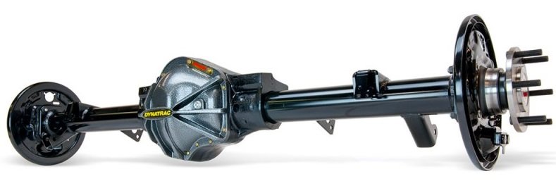

    https://www.dynatrac.com/axle-assem...r-s-kit-for-tacoma/prorock-60-for-tacoma.html
    • High-pinion ProRock 60 housing
    • High-strength 35-spline axleshafts compared to the stock 30-spline shafts
    • 9.75-inch ring gear compared to the stock 8.0-inch ring gear
    • Axle tubes have 0.3125-inch wall thickness compared to 0.200-inch from the factory
    • Pro Series™ differential cover
    Locker
    ARB Air Locker - http://store.arbusa.com/Air-Lockers-C7.aspx
    ARB Air Compressor Mounted in Engine Bay for Locker and Airing Up on a Slee Mount
    Gearing
    4.56 Gears from Dana Spicer
    Misc
    - U-Bolt Flip Kit by Wheelers with Upgraded Bump Stops
    - Extended Brake Lines
    Arrived 11/27/17
    Installed 12/16/17

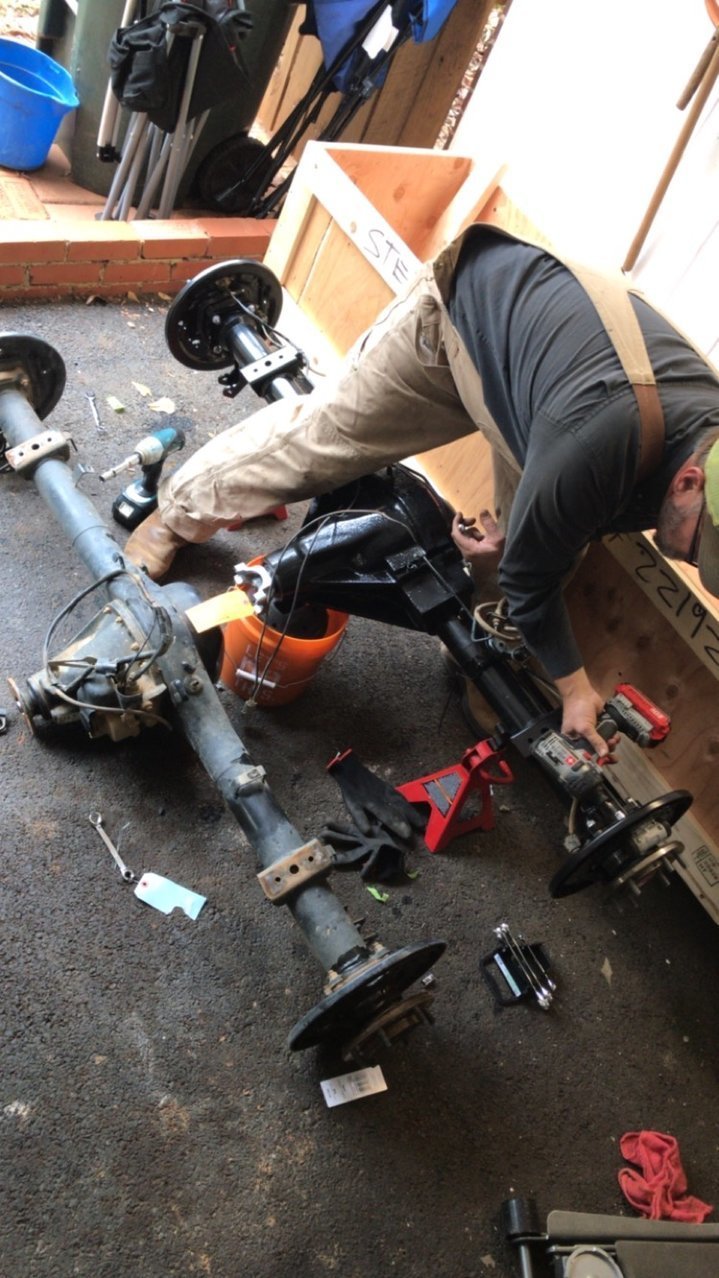

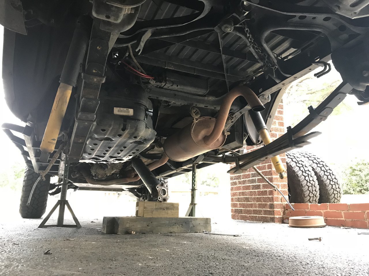

    Before we started the disassembly of the stock rear end
    Still taking things apart!
    Stock Rear End is completely out finally!

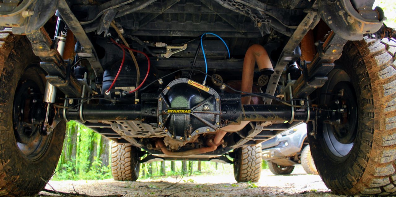

    Stock Rear end vs Dynatrac Rear end
    Dynatrac Rear End Installed and Bolted Up to the Springs with the new UBolt Flip and Bump Stops
    Everything buttoned up but still on the jack stands... still needed to bleed the brakes and drop the drive shaft still.
