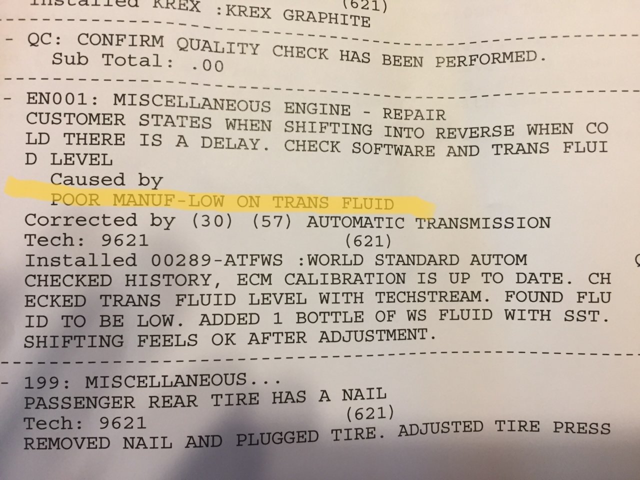

    2018 TRD OR. Built in Mexico July 2018. Purchased from a Northwest dealer. Had my mechanic who is a Toyota and import tech check all of the fluids (after reading a bunch on this thread I didn't trust the dealer). Happy to report that the diffs and transfer case were full. The zerk was greased but not much. He did not do a manual check on the trans, did the Techstream. I haven't had any of the issues reported with clunking or weird shifts.
    Thanks to @Lord Humongous I'll be further draining my wallet doing the trans cooler upgrade since I tow a 4,000 lb. travel trailer every so often. Getting all the parts on the way along with a ScanGauge II and a few quarts of Toyota ATF. Thank you guys and @gearcruncher for all the good info on this thread.

    You have to manually check the fluid to get a truly accurate reading.

    Yep, doing that as soon as the fluid gets here.
