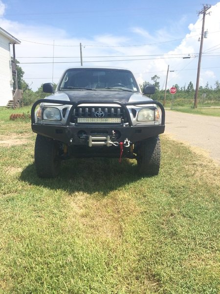

    Got a Smittybilt XRC 9.5K winch to install, and got my LED bar installed.
    Also ordered a blue sea fuse block, rocker switches for the winch (In cab controls) and a paranoid fab 4 switch holder for the ashtray spot.
    thinking about cutting some square holes in the bumper for LED pods while I have it off.
    (5/23/15)
    Finally finished my bumper, got my suspension upgraded (OME nitrochargers with 883 coils) and should be getting a winch in the next few weeks (Smittybilt XRC 9.5) Gonna clean her up and take some pics soonish.

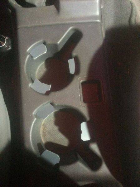

    And I fixed the upholder tabs. Followed this write up, and used this material (Pittim recommended it)

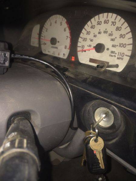

    Got my scangauge2 installed, really happy with it.
    (05/6/14)
    Bought an scan gauge 2, and plasti-dipped my hood.

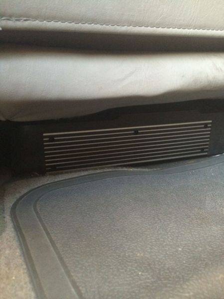

    Bought and installed a powered sub under the drivers seat, really happy with it.

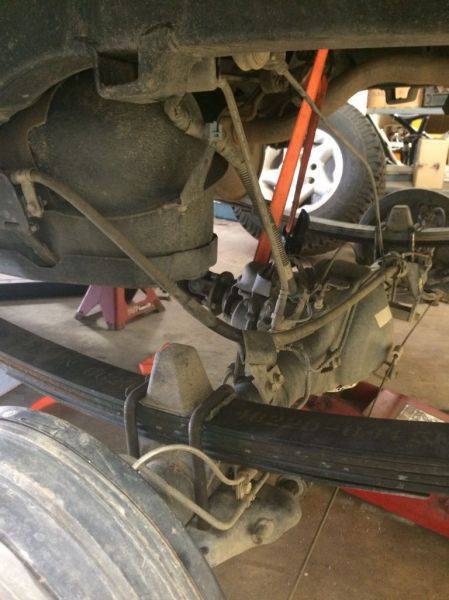

    Got my new leafs and shocks installed today, I haven't measured how much lift it gave, but i'm now sitting stinkbug.

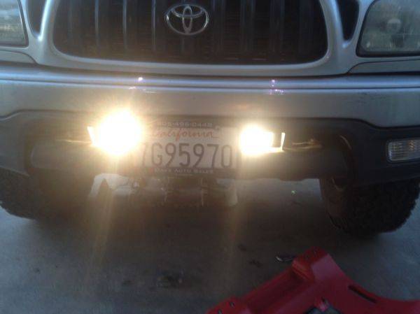

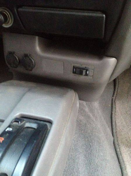

    (01/25/14)
    got my lights mounted and wired
    put the switch in the right blank by the shifter
    then built the mount for the lights (100% bolt on)
    and the lights wired up and working

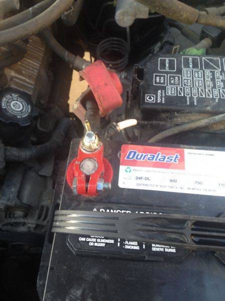

    added a "marine grade" battery terminal on the positive side, and cleaned up and painted my battery tie down.

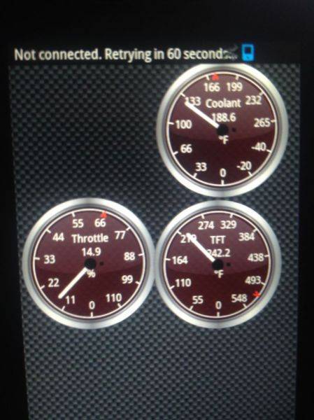

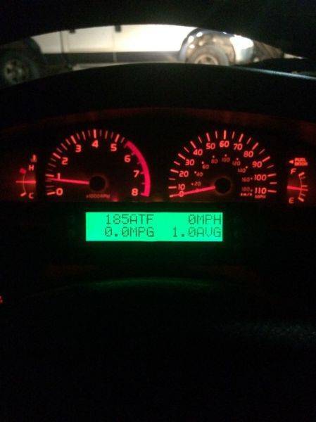

    and got a PID setup on torque to read my trans temp and i'm getting screwy readings.

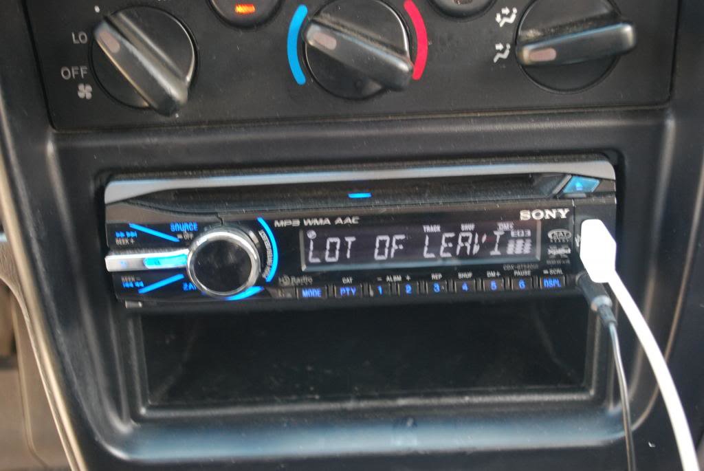

    stereo -$ free (for me)
    powered sub -$169.99

    Fixed the cup holder tabs with this material

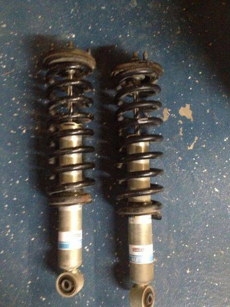

    (installed lift on 9/23/13, truck had ~108,500 miles)
    Installed my shocks today set at the middle setting, took me about 9 hours from start to finish.
    front right before lift
    Front right after lift
    front left before lift
    front left after lift

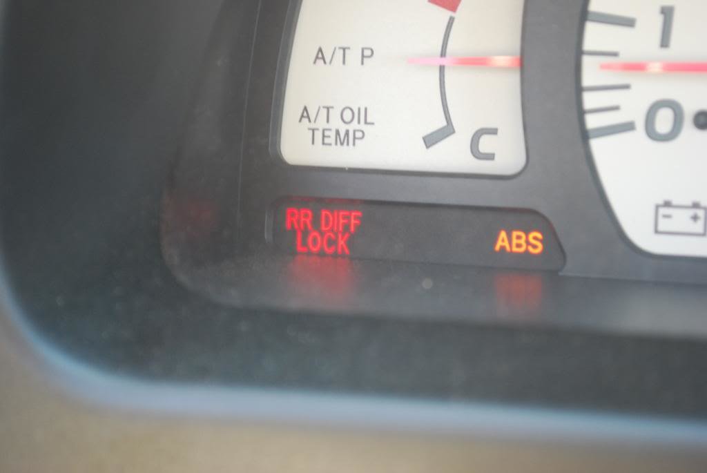

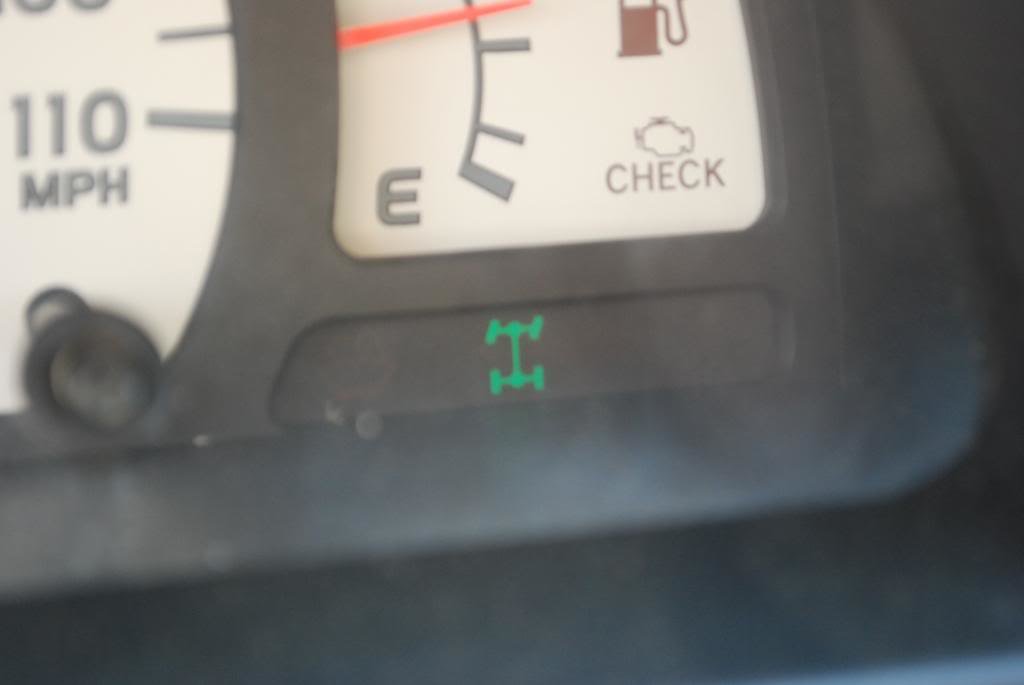

    Diff lock works
    and 4x4 works

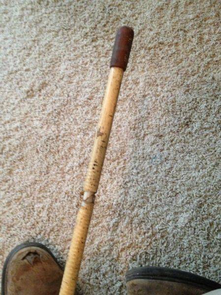

    Had to cut this off
    Front left post lift, pre settle, i'll get more pics after i get an alignment and everything settles
    Her new stance.

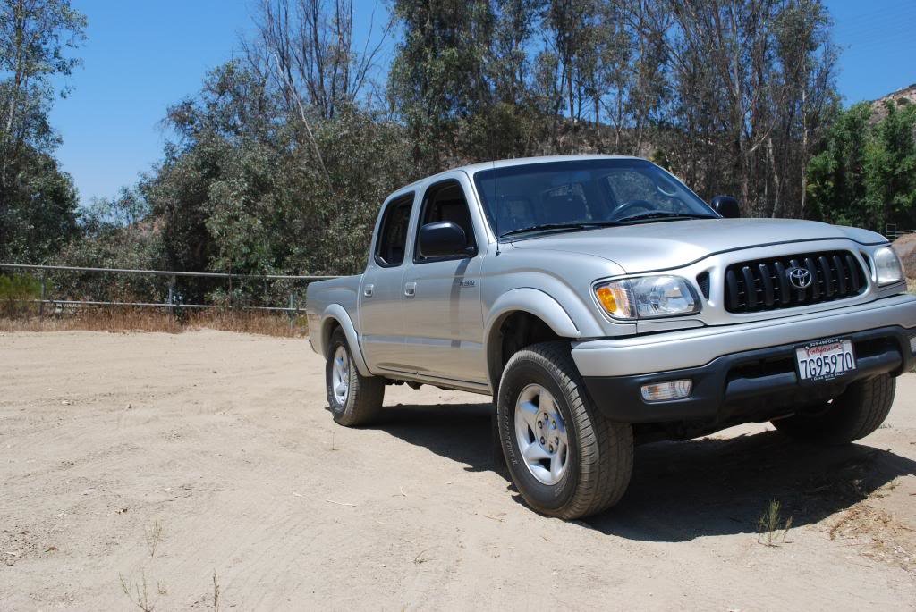

    Wow... this is a clean truck Jake !! Excellent find , If you haven't already
    start engaging /dis engaging locker , probably hasn't been done for awhile...I see a grey wire MOD in your future.... best MOD for 1st gens..:thumbsup::thumbsup:

    thanks, i worked the 4WD system and the locker today and yesterday.
    Gonna do the grey wire mod when we get back from up north.

    Did the grey wire mod today, and the 2 lo mod.
    Thoughts:
    Locker doesn't help as much as i thought (at least in my terrain), and 2 lo is awesome (options are always awesome).

    Got these from doug tonight (thanks doug), not sure if i'm gonna set them to 1'' or stock height, but i'll be putting my coils on them (the current coils are for the 4 cyl engine), and eventually get some 881's or 883 coils once i get skids or a bumper.
