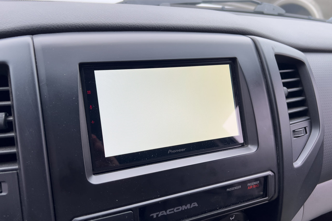

    Having some ongoing issues with my Pioneer DMH-W4660NEX headunit unexpectedly rebooting itself.
    Making this entry in my build log to capture all the dates/times to help better see a pattern.
    More details/photos of this stereo on old posts [#46][#50][#70].
    Disclaimer: This is 100% not a complete listing since I didn't start paying extreme close attention to dates/times until it really started driving me nuts in Feb '22 after already doing 2 RMAs to Pioneer.
    Pioneer DMH-W4660NEX unit number 1: RMA under warranty within 6 months
    02/24/21: Ordered brand new from ABT Electronics, delivered a few days later. Waiting for other parts to arrive before installation.

    Pioneer DMH-W4660NEX unit number 2: Dead as of October 2023

    09/28/23: While I was on like day 4 of a 3-week road trip, the screen went completely white and stopped responding to touch input. Still played audio automatically from my connection for a brief time. I had to make a tough and/or stupid call, so while at the local Best Buy I bought...another Pioneer 4660. I didn't want to and I really hate it. But it was plug-and-play and I fixed it in the parking lot to continue my trip. The brand new unit also randomly reboots itself so there's that, hooray! Sending it back to Pioneer for repairs and from there it's going into one of my other vehicles.
    12/03/23: Pioneer charges a $80 fee just to send back and RMA and investigate. Then they quoted me nearly an additional $300 for repairs. Total that would be far more than halfway to a new unit. Decided not to throw bad money after good and told them send it back broken. First unit is dead. second unit lives on, and I guarantee I will not be buying another Pioneer again.
