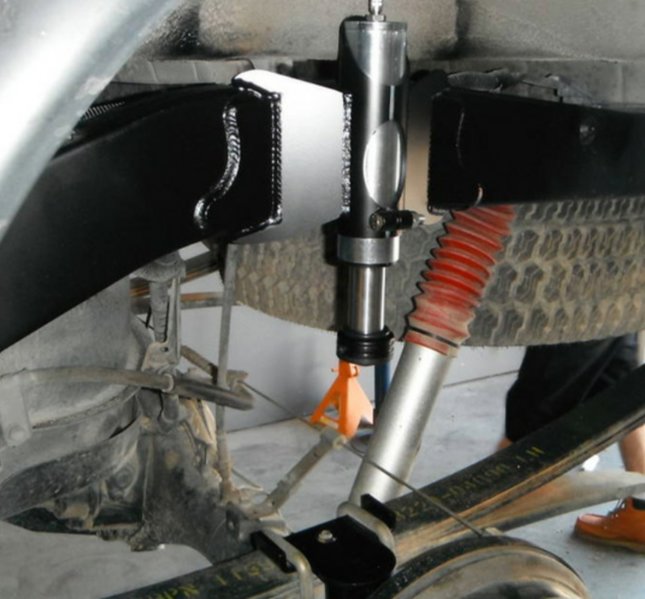

    • Rear - Icon 2.0" aluminum series 13" travel shocks mounted outboard of frame - pics HERE, flexed out HERE

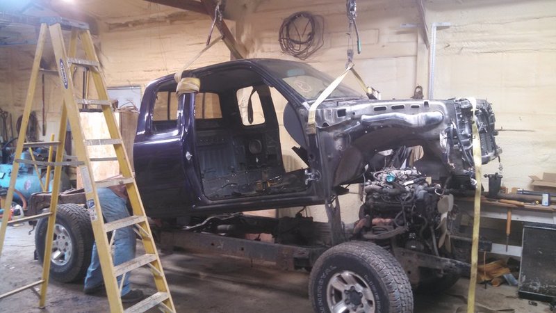

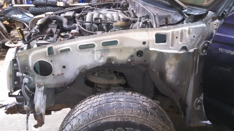

    Once we got the fenders off we realized that to get the cab off, the inner fenders and radiator support was coming with it. So we started disconnecting anything that wouldn't come up when we lifted the cab.
    Got everything disconnected.
    Had to cut some of the cab mount bolts
    First attempt to lift the cab...didn't work.
    Second attempt got it.
    And with a little bit of picking the rear end up and swinging it around...its free!

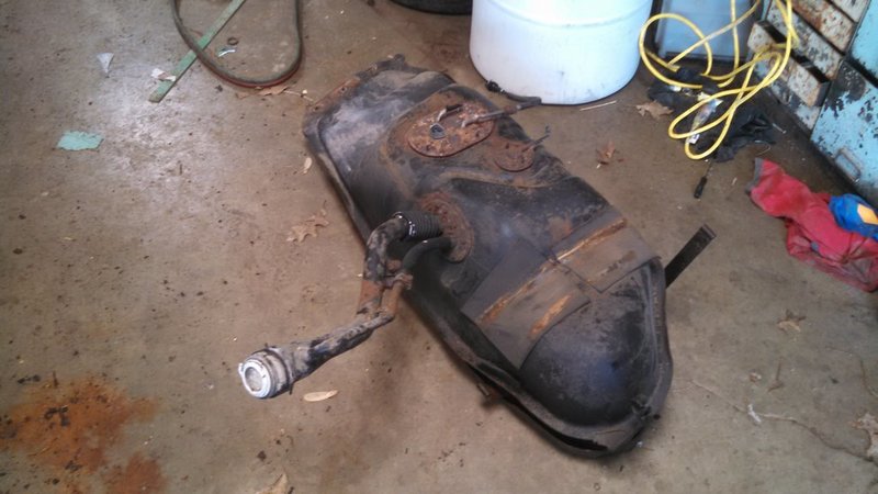

    Got the Dakars, greasable shackles, and new bushings in and candy! Does anybody know why the dakars are different, and this pin looks like its sheared of.

    They're different because of the gas tank, they're side specific. I'm pretty sure mine looked just like that. Can't remember if the pin was that short or not

    Made another thread and put those pics on, and we concluded that the clamp on one had the rivet sheared off during shipping and then they just moved it to the other side. We are just going to weld it back on instead of going through the hassle of shipping it back. And one spring has a + the other has an O shape. Doesn't that mean one exceeded spec and one meet spec?

    In the part number one should have an A and the other a B. I have no idea what the + or O shape mean. Are they stamped on the springs? Try calling wherever you bought them?

    No there just painted on, I'm pretty sure I read in another thread they indicate how close they are to there factory specs. And which one goes were? Does A go drivers side?

    I believe A goes on the driver side.

    If i do go with air bumps i will be doing something like this.

    Took some pics of the frame after my dad got everything level and straight. The back drivers side rail is rolled in a little still, we are going to try to roll it back out. We need to mount the leafs to back sure they line up. As well as set the new bed on to see if it lines up.
    muffler is pretty shot as well... what isn't? haha
    Got the monstaliner and chassis saver in
    Started sanding on the cab a bit.
    We really need to set it down on something...
