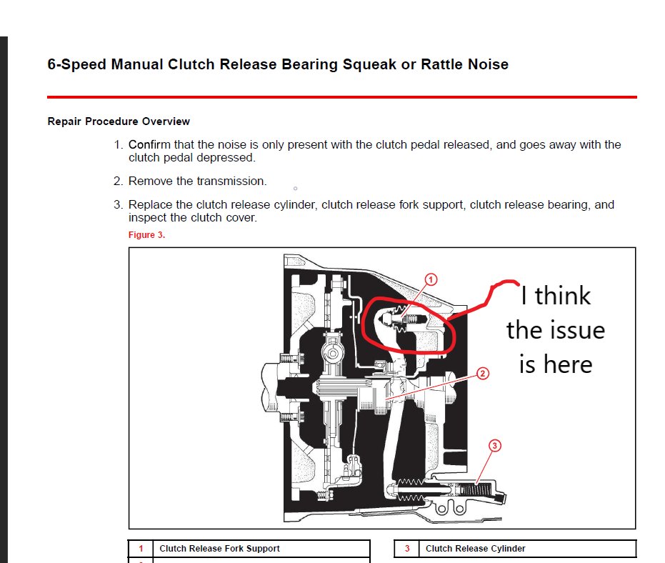

    So i have found this post to be contradicting is self about if the release bearing should be touching or not touching the forks. After doing many hour of research i have found the the bearing should be touching the pressure plate forks.
    So originally my release bearing was replaced once by Toyota around apx. 30,000Km because of the squeak noise it cause, so I had to pay for half the install after fighting with my local dealership about warranty blah blah blah. It fixed the issue and never had that noise or chatter noise after that.
    So now I am having issues with my bearing. Here is what is my situation. Old clutch has been burnt out from me playing hard with my 2009 Tacoma V6 6 speed manual TRD access cab, So i went with URD clucth, Heavy Flywheel, Pressure plate, ARP flywheel bolts, rear main seal and (got my release bearing from my local parts store) So my local transmission shop did the install and i found out the local parts store got my the wrong bearing so the transmission shop ordered OEM one from Toyota (i need to double check if it was a OEM aisin or luk bearing) So the transmission shop did the install said that everything went well and there was no issues.
    So after breaking the clutch in after a couple weeks i started to notice a rattle / chattering sound coming from my transmission area, so after playing around my clutch pedal ( pressing in and out ) i notice the sound would go away when pressed in. So I i pinned pointed it was the brand new bearing making the noise. So did some more research and found the TSB on this forum post (Wish I found it before i had my transmission removed), So i decide to try and replace and the Salve cylinder and put in new transmission fluid as well transfer case fluid plus i also flushed out old clutch Dot 3 fluid as well. So after all this i found the noise did go away when everything was cold but after driving for a while and everything got hot inside the transmission i still have the chattering noise :mad: but its not as bad. I did notice the slave was had a long rod and the spring was also stronger too but was not enough to stop the noise. I also notice the clutch fork has lost of slop or play moving left or right on the fork support when i had the slave cylinder removed (not sure what is normal play?)
    I really feel that there is to much play inside caused and is allowing the bearing rub against maybe the clutch fork ?
    So now I am at the point of pulling the transmission my self out and going to replace the the Clutch fork and the Fork support that is in the TSB also compare the brand new bearing with the one that toyota put in @ 30,000KM and try to see what is rubbing and making the noise.
    I am to the point of the last straw with this noise. If anyone else can think of something i am missing to replace please let me know.

    Your best bet is to go with the URD sleeve kit. It stops the noise for most people for some time, some longer. Also heard others say it comes back. I've also seen users on here that report 200k or more miles on the chirping TOB, with no failures. There is a company that makes a hydraulic bearing design, URD used to, but i have seen failures on those that left users stranded. I have decided to just live with my chirping unless it gets so bad i cant stand it and/or wait and see if it ever actually causes a failure that leaves me stranded. Mostly highway for me, so dont hear it driving, just outside the truck.

    Its more of a chatter or rattle then a chirp sound. I had the chirp noise in the past and toyota fixed that once by replacing my bearing. This is something different. After taking the dust cover off again and wiggling the Fork i noticed its had some play moving from left to right ( not sliding it) about 3mm to 4mm
    and I am not sure if that is normal or its lose on the other end of the fork where it rides on the fork support. I wish I had replaced the fork support when I had the transmission out but I didn't know about the USA TSB on the bearing chirp/rattle that toyota posted. I also took a long screw driver and had a listen around the transmission to see where i could pin point the sound is coming from. Please see photos. I noticed it was the loudest just behind the bellhousing where i think its called the output or input shaft running the where the gears are changed. I have a feeling it could be the bearing that the shaft rides on because it gets worse when the vehicle is hot so everything expanse but that doesnt explain why the sound goes away when pressing in the clutch pedal in. So that makes me think it could be the fork support being to small and is maybe rattling inside the fork end.
    Here is a couple picks where i notice the sound the most. its seem to becoming from behind the bellhousing and the section behind it. Not sure what that area is called yet. But that sound could be just traveling down the shaft into that area.

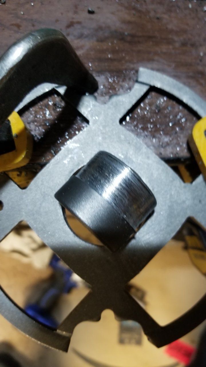

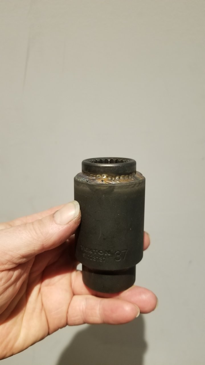

    For anyone looking for an input spline socket that will go the distance. I got a $40 ebay clutch disk and a $20 37mm deep socket. Using a grinder to shave off the 4 rivets holding the clutch disk together and then a 1-5/8" holesaw I cut the center out. Then I simply welded and for $60 all in I have a spline socket that will never fail. If I had an old clutch disk I would have used it and then only been the cost of the socket.
    Anyway for anyone with the means it's a much cheaper alternative to the ridiculously expensive Toyota tool.
