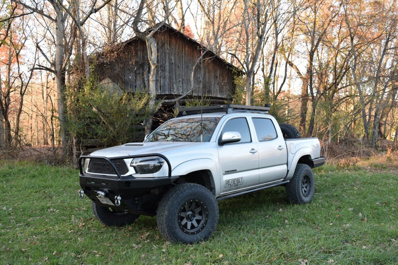

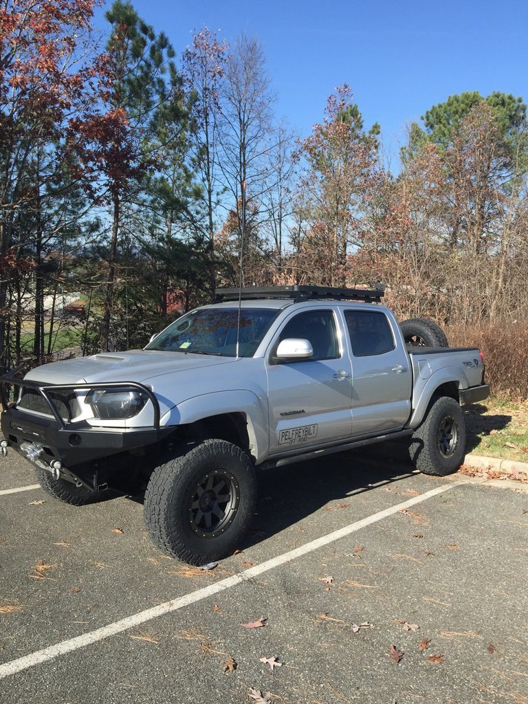

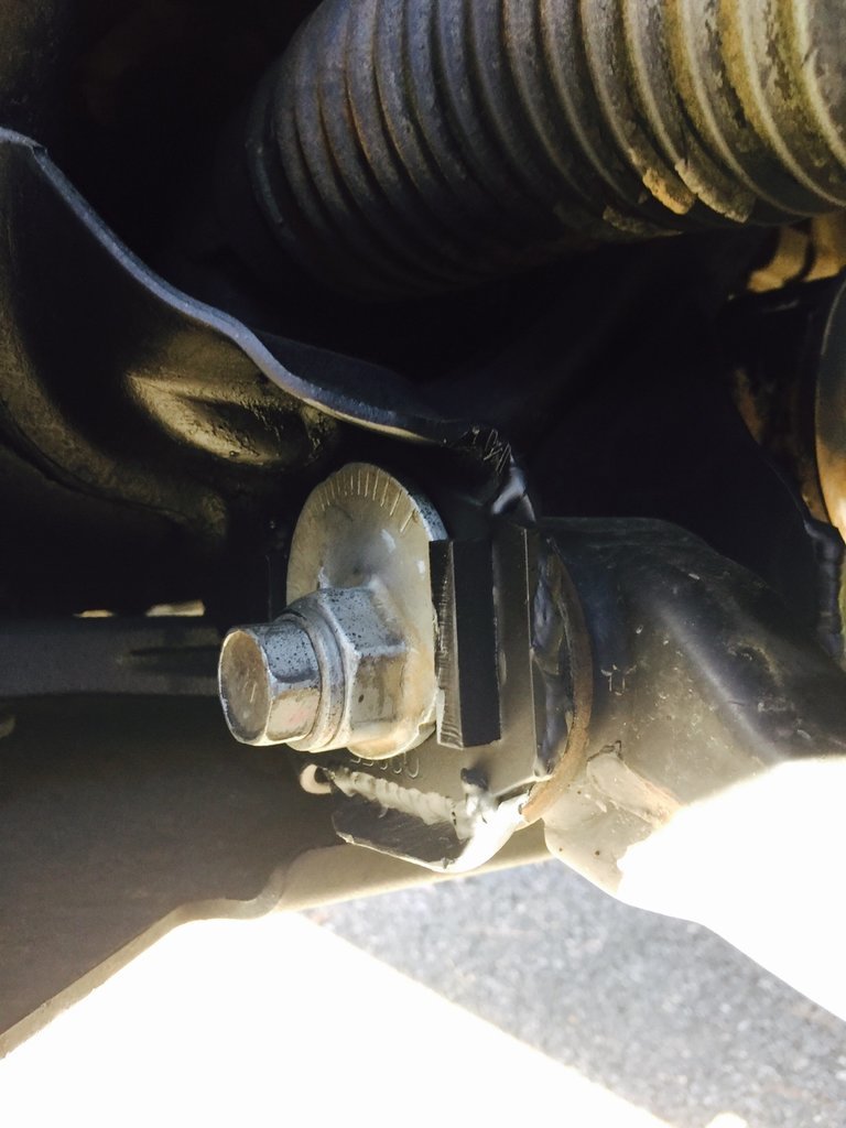

    First picture I've been able to take during the day, picked it up from the tire shop yesterday:
    285/75/17 (34X11.5) Toyo AT with SCS Sr8 wheels in gunmetal

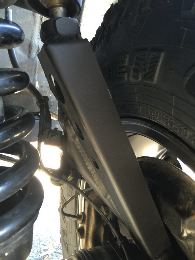

    Total Chaos Spindle Gussets:
    Total Chaos Cam Tab Gussets:

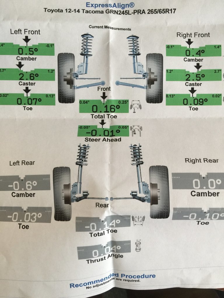

    Alignment numbers best caster I could get with my current set up:
    Rubbed a fair amount on the bottom of the fender so cut that up real quick to drive to work today. Can tell I need to cut more cab mount on the drivers side and more fender/fender liner when flexing.
    I'll get the real camera out this week for some nice pics :thumbsup:

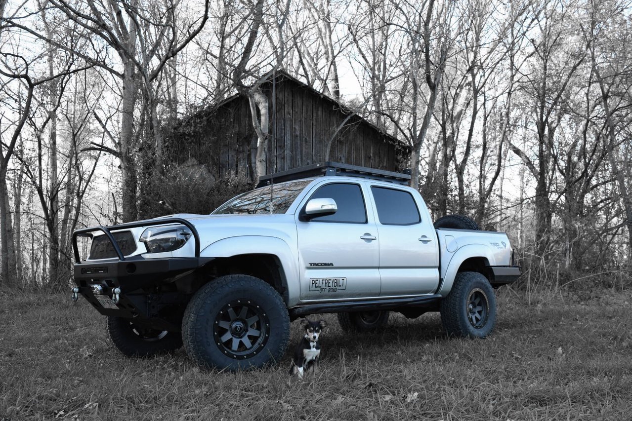

    Got some shots with the camera in the day time finally before it got dark. Happy Thanksgiving everyone!

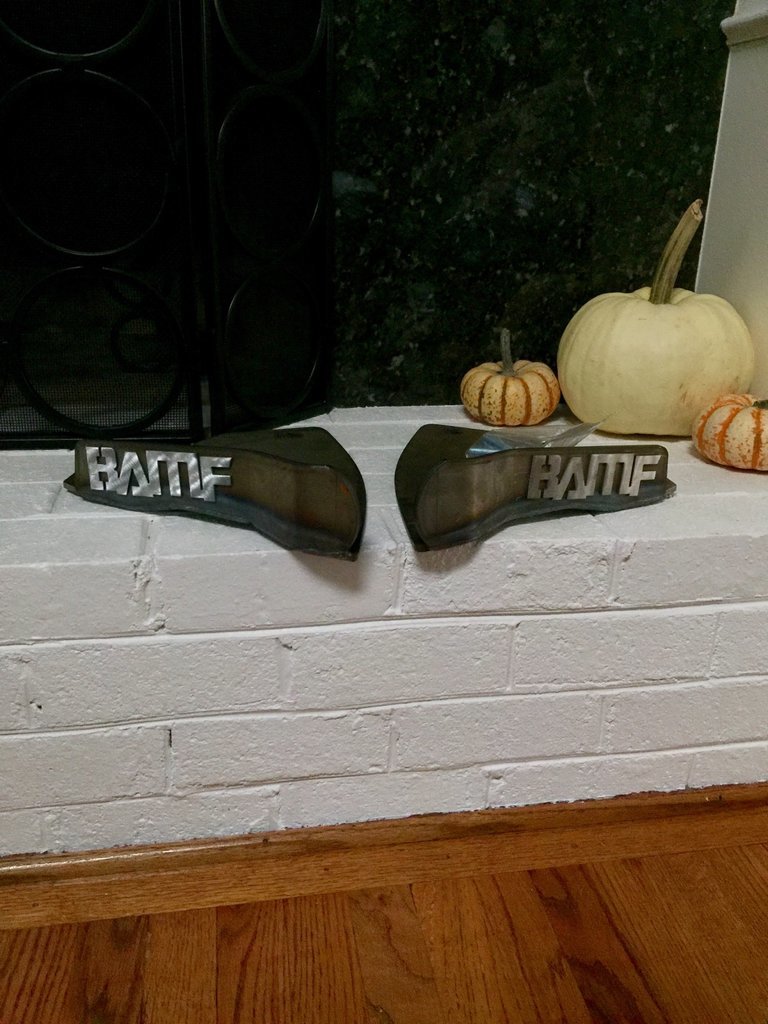

    These came pretty damn quick.
