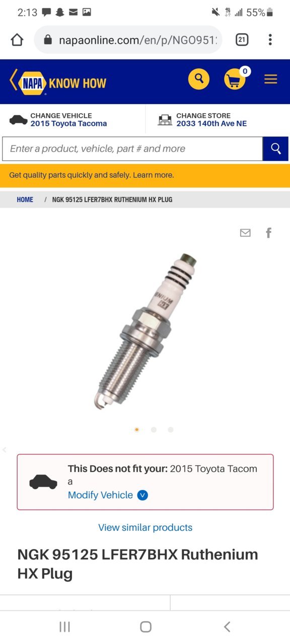

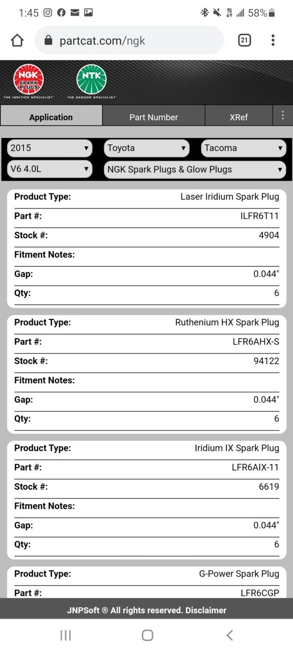

    I just wanted to let everybody know that the
    NGK Ruthenium plugs part number that shows up on NGKs website is for NA applications. I learned that the ones listed in this forum are the correct plugs if you are supercharging. The flat top was concerning to me but I am under the impression that these will work with you coil packs.
    Forced Induction: LFER7BHX/ 95125

    That looks like it would be for the N/A truck. The heat range is anyway.

    That would make sense as they were picked to be more in line with boosted applications which likely would not show up on a search.

    From what I can tell the plugs are the same on the side that is in your combustion chamber but the coil side is flat.

    They may look the same but they are indeed different. And the "wrong" ones have a flat top also. The heat range of the ones you are listing are different than the heat range of the "wrong" ones. That is the difference. And maybe the resistance. The only thing different about the "wrong" ones from the Denso plugs that come with the s/c are the materials used and the resistance.
