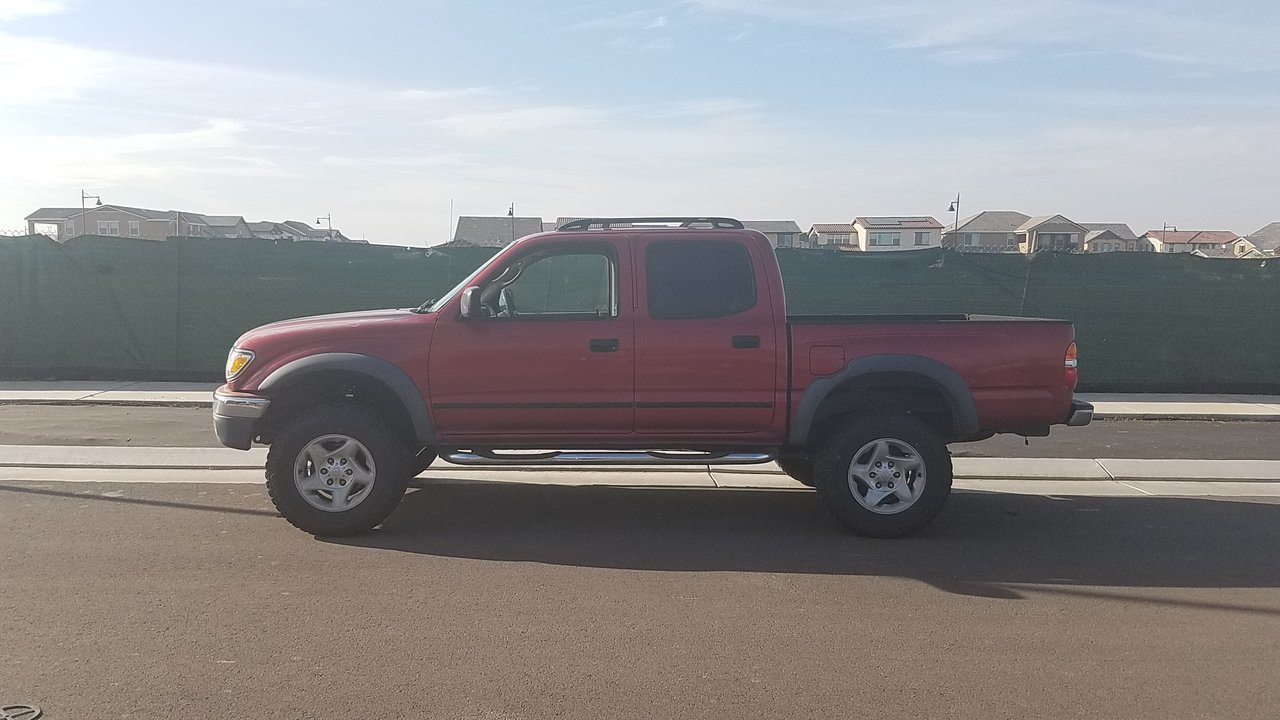

    Here's how the truck looks at the very beginning.. the last hunting/camping season it will see stock.
    This past hunting season made me realize a few things.
    #1 How much I love my truck (and didn't even realize it)
    #2 How much I ask my (2x4 stock height) truck to do, that is probably more than most ask of their truck.
    #3 How much my truck is in dire need of fresh steering and suspension componants.
    So, once I started realizing these things, I decided that after 13 years of owning the truck and about 180,000 miles of driving it (260,000 total on the truck, I'm 2nd owner) I need to make it "cool"... and more importantly more functional on the fire roads and trails I take it on.
    Since I need to replace a bunch of suspension componants anyway... well... it's going to just have to get lifted, right?
    I figured it might be cool to keep track of the progression. I figure it will be slow and steady, but we'll just have to see how it goes.
    Updated Pic

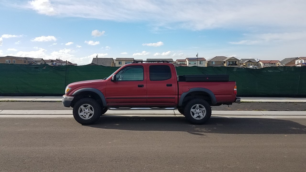

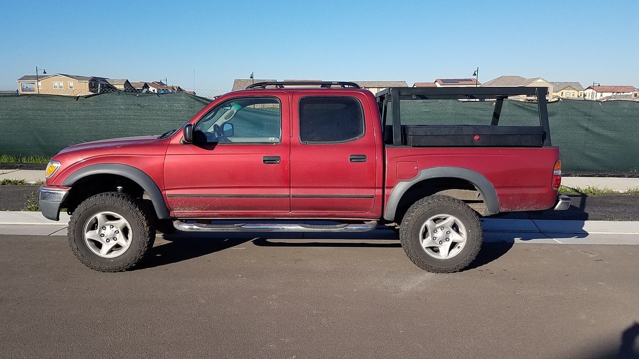

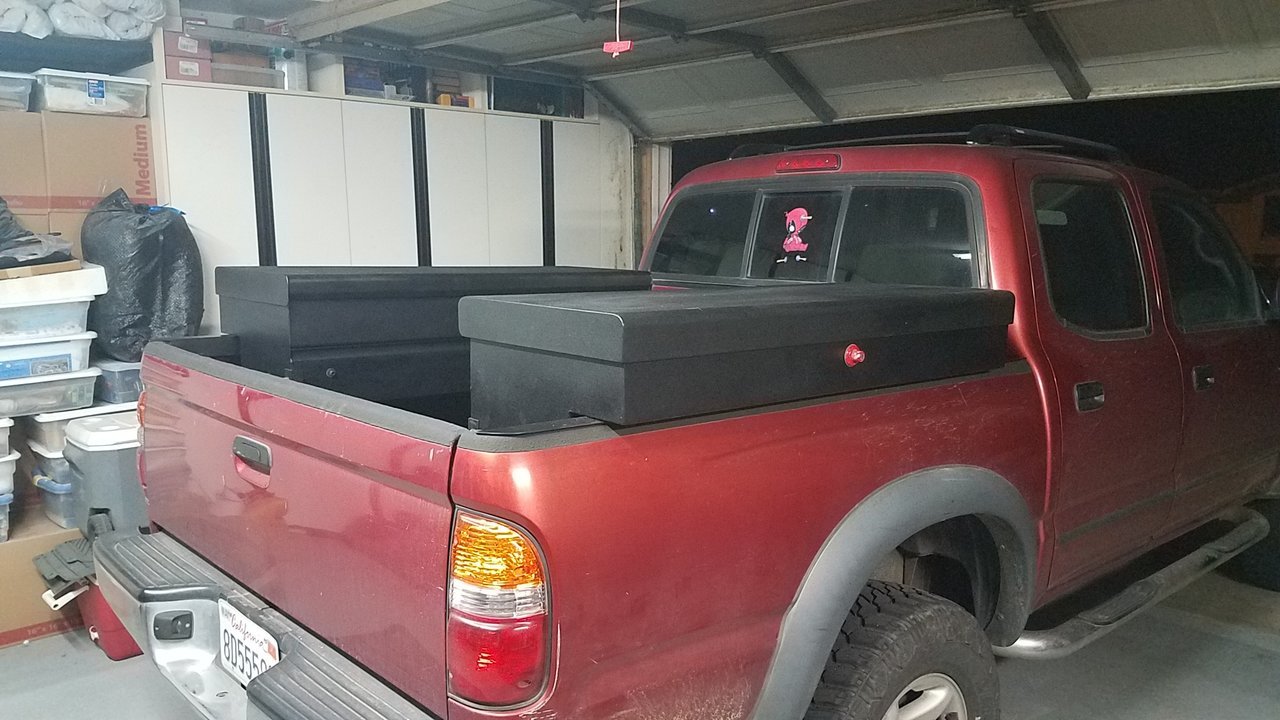

    Before any work =
    After Bilstein lift 1.5 inch in front, Wheelers 1.5 inch AALs =
    After truck boxes were added =
    After the RTT rack =
    After another lift, wheels and tires.
    Bilstein 5100s with ToyTec 620# springs
    Rear lift is Wheelers 1.5 AAL and middle leaf from a 5 lug Tacoma
    17x8.5 wheels with 4.5 inch backspace.

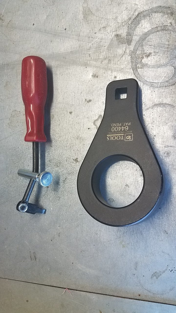

    So the first thing I did was change the spark plugs. The last weekend of deer hunting season it started really stuttering on me. When I got home, I decided to pull one of the plugs (no pics on this one, wasn't thinking). The electrode was nearly gone. I pulled the rest, and they were all in nearly the same condition. Replaced them all with NGK dual electrode plugs. Man, it runs smoother... and with better gas milage.

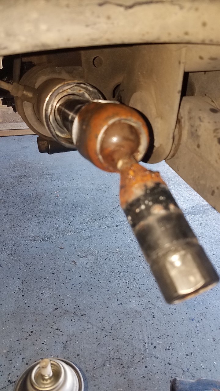

    The next order of business is the shimmy while breaking and wierd wear pattern on the front tires. I know the breaks aren't the cause of the shimmy as I just replaced the rotors about a year ago and the pads have a lot of meat left... and they look to be wearing even.
    Decided to replace all the tie rods...
    https://www.tacomaworld.com/threads/tie-rod-end-replacement-suggestions.523928/
    And decided to replace the steering rack bushings.
    www.tacomaworld.com/threads/steering-rack-bushing-suggestions.523952/

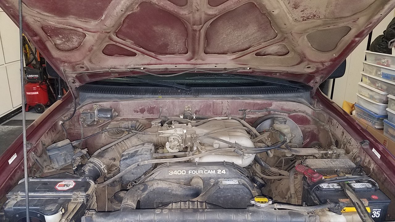

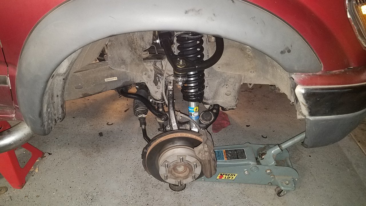

    So here's one last look at my (basically) bone stock Taco, before the improvements begin.

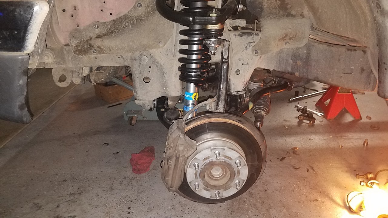

    Later on the same day... I basically tore the entire suspension off the front end... let the fun begin!

    Well... Had a long stress filled weekend of tools not working parts not matching with the part numbers on the box... etc, etc. But all in all we got er done.
    New UCAs, LCA bushings, coil overs, sway bar bushings, and sway bar end links are installed.
    Wheelers 1.5 inch AAL and rear Bilstein 5100s were also installed.
    It's always nice when you check the part numbers on the boxes, and think you have an R and L lower ball joint... only to open the boxes to find this.

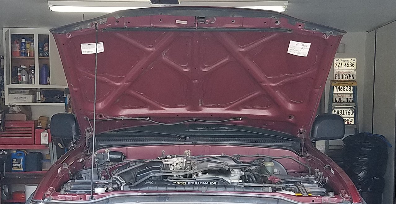

    Bought a second K&N air filter to put in, so I always have one cleaned, dry, and oiled to swap out. Cleaned the Mass Air Sensor... and did the "deck plate mod" since I didn't think my plate was full enough for the weekend already.

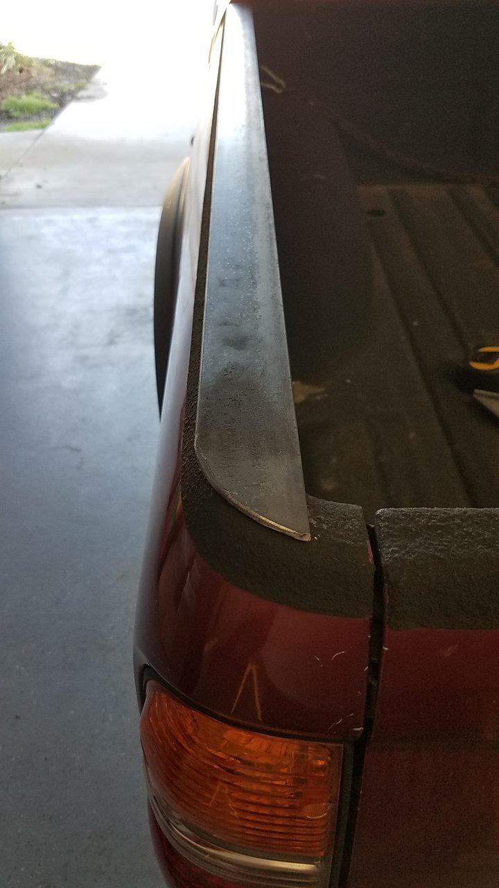

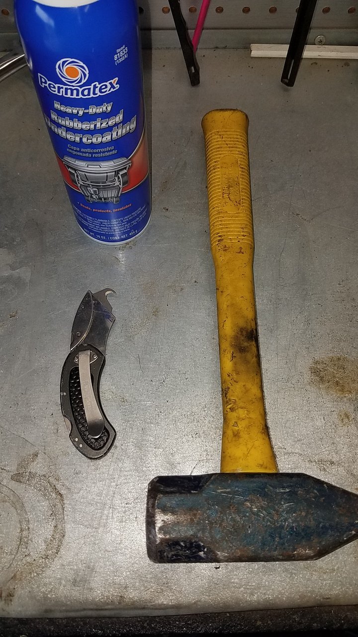

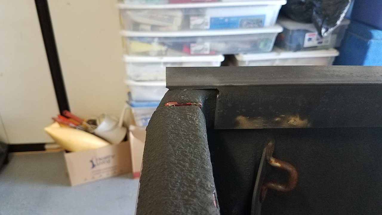

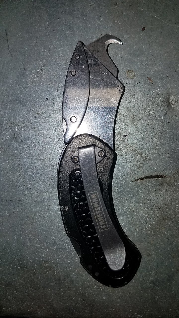

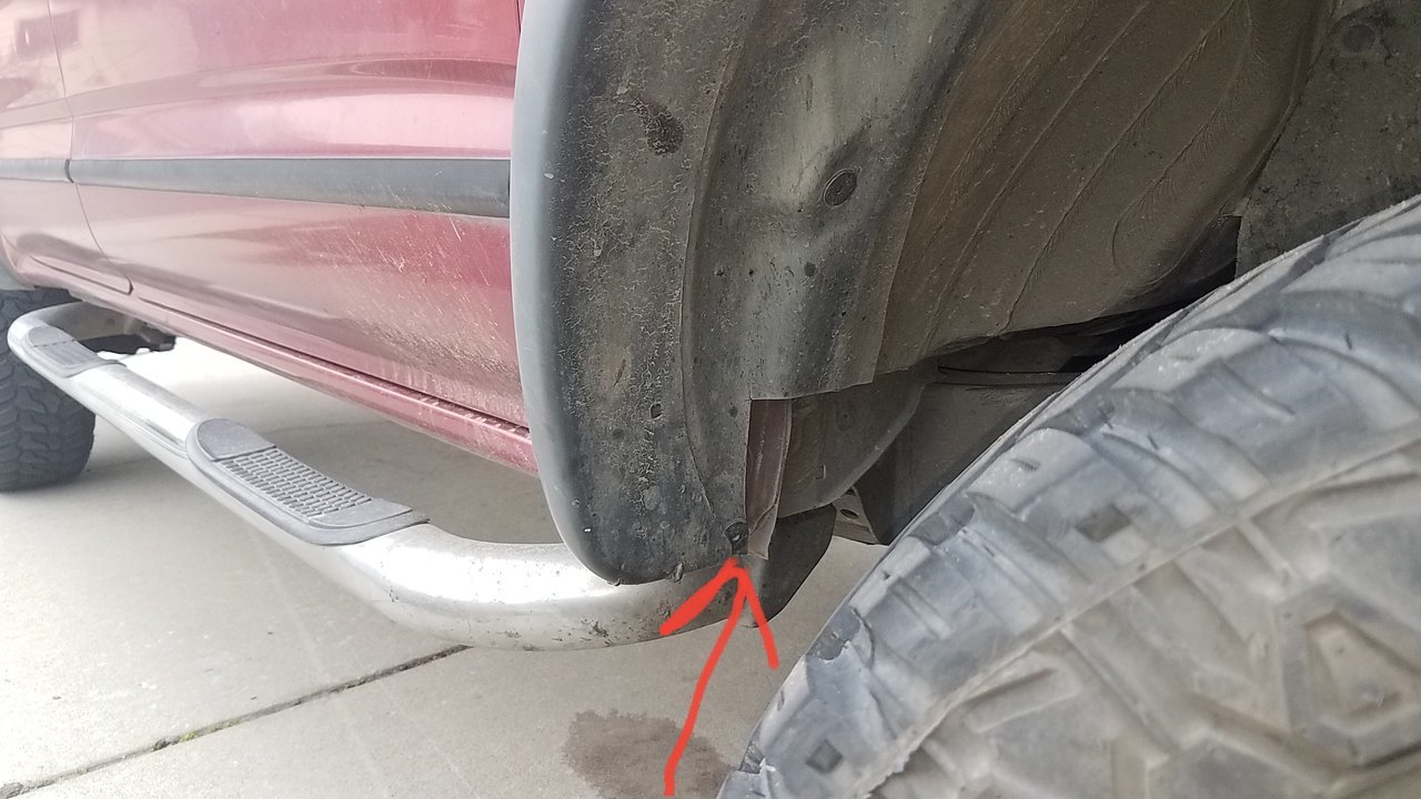

    So... I got bored yesterday. Decided to do the pinch weld mod. I don't need it yet, my tires don't come close to rubbing. But who cares, I'll probably need the clearance sooner or later.
    It ended up being easier than I thought it would be... like 15 minutes easy. I figured I would add this for someone who may be looking at this thread and didn't know about the pinch weld.
    Here's what I used.
    This guy here is your friend. It's a roofing blade. You can pick them up at Homey D for like 5 bucks for 5 blades. This blade cuts straight, and like butter through your wheel well plastics.
    You want to find this area right here.
    And cut it something like this. The arrow is pointing at the pinch weld. That's what you want to wail on with your BFH (big f'n hammer). I bent it towards the center of the truck.
    Then just spray a little bit of Rubberized Undercoat on the area you just wailed on and your done.

    Been a while since I updated this thread. I've been staying at it, but mostly doing things to make the truck more functional for my personal purposes.

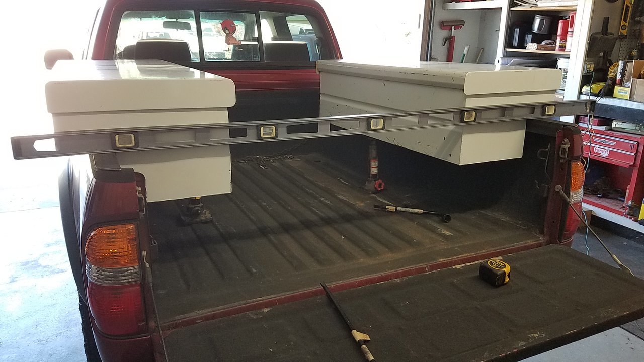

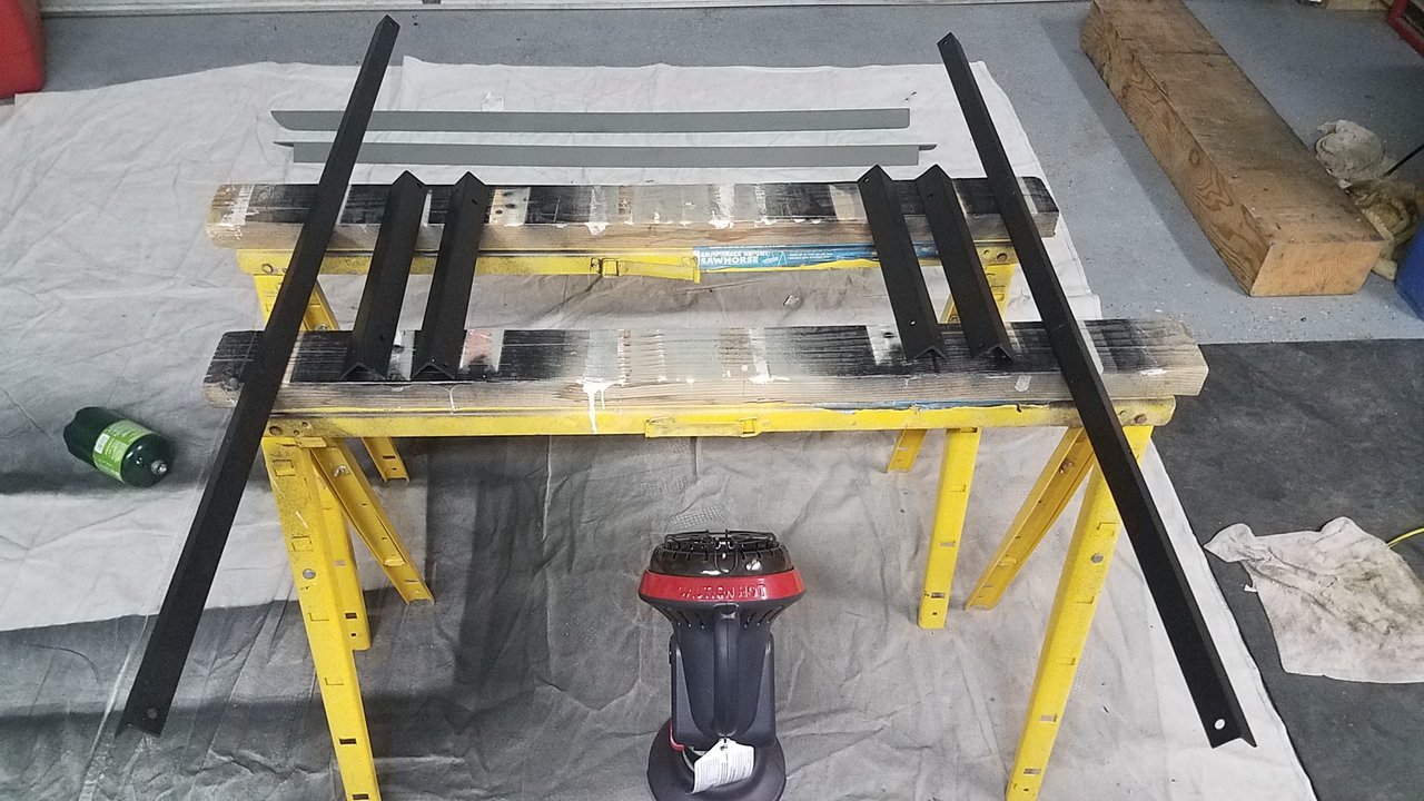

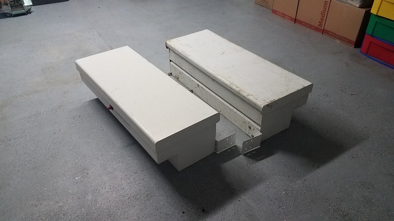

    Found a couple Weatherguard side boxes on Craigslist for 100 bucks.

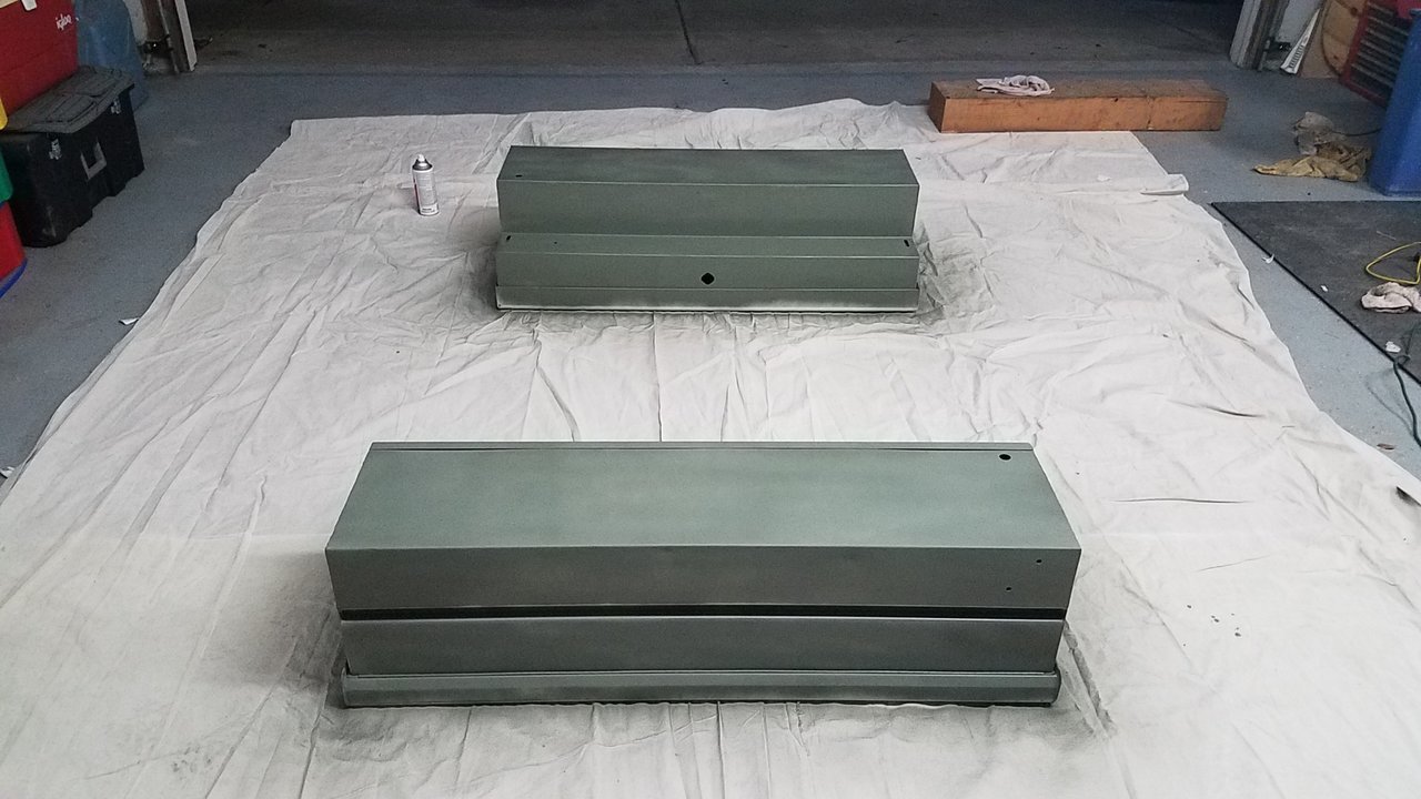

    The boxes were in decent shape, but I wanted to go ahead and refinish them. Started by mocking them up in the bed, to get my measurments for the brackets I'll be mounting them with.
    Before I could mount them up properly, I fabbed a bed rail that will be mounted under the boxes. This rail is for extra support under the boxes... but more importantly, it's the rail the legs of my roof top tent rack will, eventually, be mounted to. This rail needed to be in under the boxes so I got the right measurements for the brackets. If I added it later, it would have caused the boxes to tilt up at the bed rails when it was added later.
    Sanded the gloss off the boxes and used self etching primer.
    Used Rustolium Truck bed spray for the top coat.
    Painted the brackets with Rustolium truck bed spray as well... needed a little heat to get things drying.
    And here's how they turned out. Decided to bolt the brackets instead of welding them, in case I ever need to take them out and store them. The boxes may be bigger than some would choose, but they give me options for secure storage. (Great place to transport rifles during hunting season). They also give me a place for tools and possibly a location for a second battery.

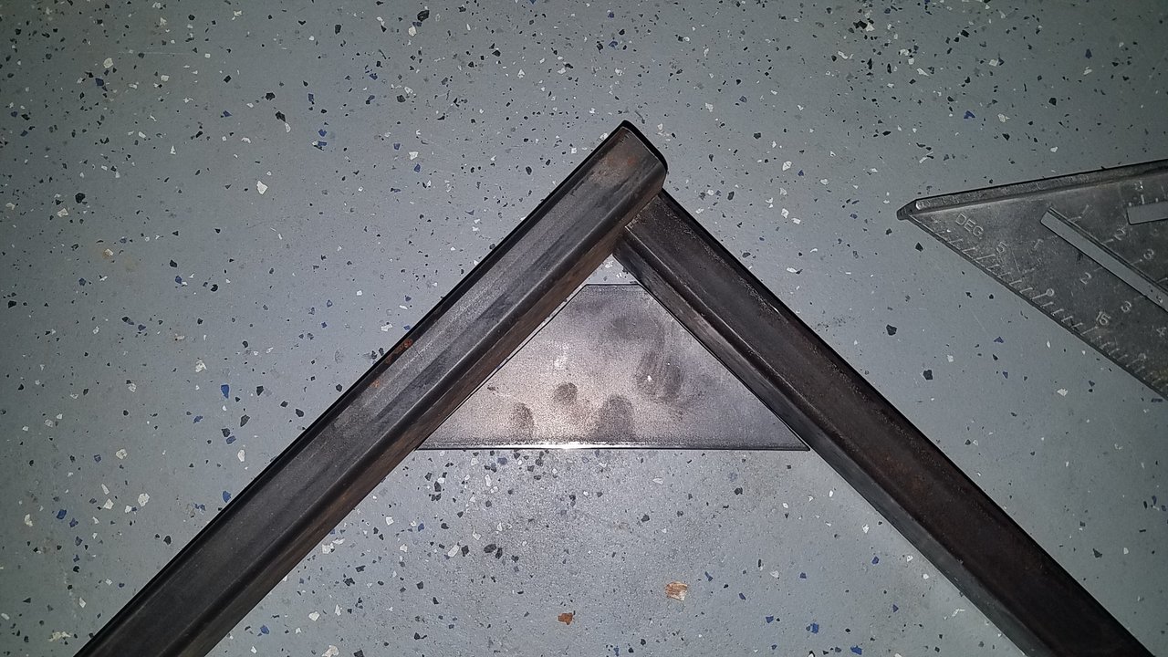

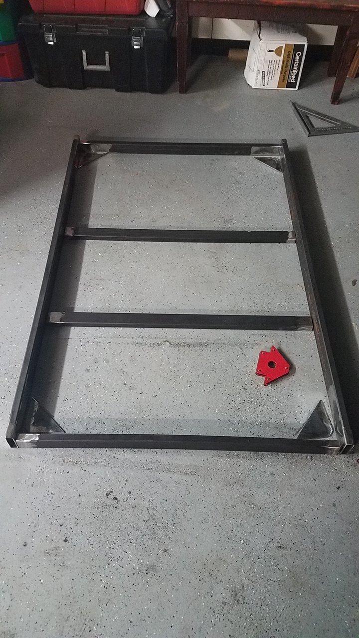

    Next project is the Roof Top Tent rack. Not even sure when I'm getting the Roof Top Tent, but want to get this completed before this camping season because it will also serve as a place to mount work lights for bed illumination.
    Got a 20' stick of 1"x 2" steel and a 20' stick of 1"x 3" steel... the yard cut them in half for me, since I'm in a DC Taco with a 5' bed... lol

    Took a look at what I have going on with the truck bed/boxes/etc... got what I thought would work for measurements and started cutting... All the sudden, I had a bunch of pieces to mock up for the platform of the rack.
    Cut some corner angles to act as mounting tabs for 4" led work lights in each corner. They are also, essentially, corner gussets that should add some strength.
    Got all the weld locations ground down to bare, clean, metal.
    Borrowed a buddie's cheapo Habor Frieght MIG welder... and lets get this going... (I've never welded anything in my life, but fook it)
    My welds, so far, are not all that pretty... but the rack is definately strong enough to do it's job.
    Mocked the rack up on the truck, to get angles and measurements for the legs.
    And then cut all the legs... still need to clean them up and practice my welding a bit more, seeing as these welds will be the most noticable. (All of the cuts on this rack have been made freehand with a 4" angle grinder)
    Will probably try and complete the rack next weekend.

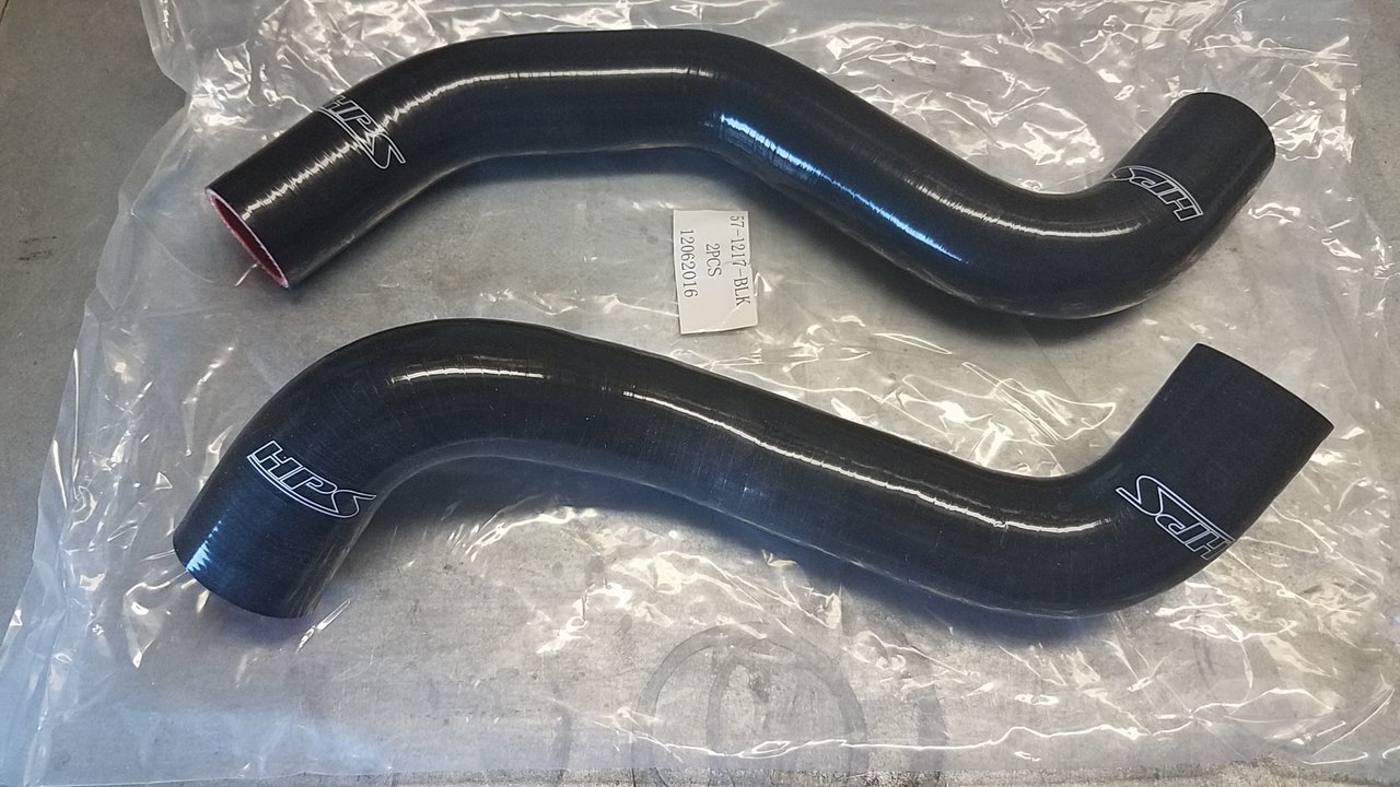

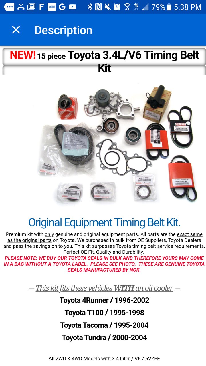

    Also started collecting parts, and tools, for replacing the timing belt, waterpump, and the other associated parts. Still havent bought the kit, but this is what I'll be using.
    While I'm doing the swap, I plan on replacing some other items associated with the cooling system.
    The guy in the big Brown Truck has stopped by with a few things so far.
    High pressure, high heat, silicone, upper and lower hoses.
    All aluminum 3 row radiator.
    Seal puller and harmonic balancer tool.
    Hope to get this project started soon. Need a few more things, but I'm getting too many irons in the fire.

    Figured it would be a good idea to clean up the engine compartment. Will do it again when I flush the cooling system before doing the Timing belt etc.
    Before =
    After =

    I pretty much did what this video suggests. I didn't go all the way to some of the extremes (painting stuff etc) and wasn't quite as detailed about it.
    https://youtu.be/PRSoRkM8GcM

    I've had mine for 13 years... never cleaned under the hood. Ya, I know what you're saying. It took me and my son a couple hours to do, but it'll be worth it when we start pulling things apart to get to the water pump.
    I took a lot of the big, easy, stuff off (air box, battery, intake tube) to allow room to get down in there.

    So... last night, my son and I got the RTT rack to this point. Mocked it up and tack welded all the legs on. When we got the boxes pulled and went to pull the rack off the truck, all the tack welds failed on the legs.
    I have no pictures of the aftermath... I think there was a couple profanities invloved, but not that many. I was so pissed, I think I went to my "quiet space."

    So... we started again this morning. This time my tack welds didn't fail.
    ----> :yes: this is my happy face.
