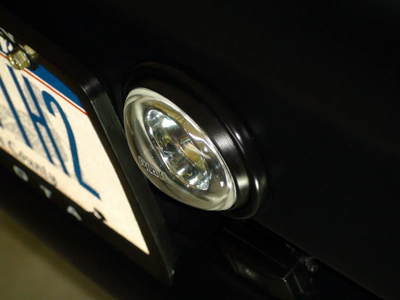

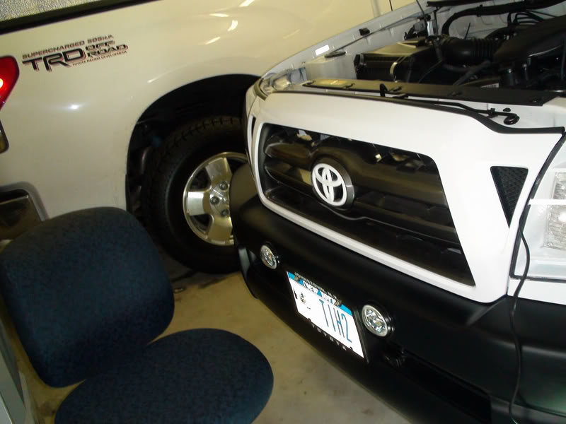

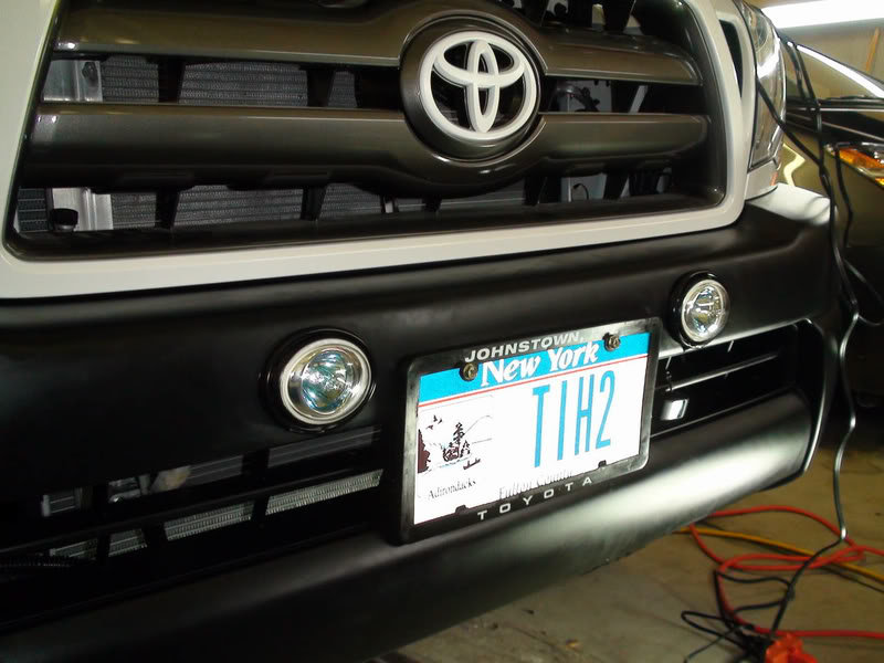

  17. Jan 28, 2009 at 8:41 PM
    #417
    sunruner19
    sunruner19 Senior Senile Member
    Dec 22, 2006
    #546
    312
    Bill
    Great Sacandaga Lake region Northville NY, South Y
    09 Tacoma 4WD
    supercharger, ARE series 2 lid.
    After doing the intermittent wiper mod on my 09 reg cab, and a few other mods, I needed to do something that to my knowledge, hasnt been done before. In other words, I was freeking bored again, and tired of watching idiot politicians playing with our money on the news channels.
    Went out and purchased a set of Piaa 1000 driving lights with no clue as to where I was going to put this on the Tacoma. I didnt want to buy a brush guard, or bull bar just for the purpose of holding those lights.
    After staring at the front of the truck for awhile I came up with this idea of putting them into the bumper instead of on it. Using the disassembled light as a template, I cut two oval holed into the front. My initial cut was smaller than the actual opening that I needed. Placed the back half of the light housing into the back part of the bumper, attached it using their supplied 3M type adhesive pad to the mounting plate and placed that on the top inner bumper. Using that as a guide, I dremeled the opening larger to accept the front lens. I then enlarged that by 3/8ths more for adjustment of lights and to add a trim strip around the opening. I then used satin black paint over the chrome housing of the Piaa. Once that was done, and wired up to the dash, I decided not to use the PIAA suppled switch as I did not like the way it mounted to the dash. I purchased two fog light switches, two connectors for the switches and 8 terminals for those connectors. I used two of the openings that had blanks on the left side of the dash board. The other switch powers the fog lights in the existing openings of the front bumper. Total cost of the piaa drivng lights and the switches were under 200.00 Approximately 5 hours were spent doing this mod, mainly because of a problem with one of the PIAA's being defective. I used the rubber trim that you find on the fender flares to finish off the opening that I cut into the bumper to give it a more finished look.
    In the third pic, just below the piaa, is my front cam, which helps me park the truck in the garage, its kinda tight in there now. Actually, my depth perception sucks now, lol.
