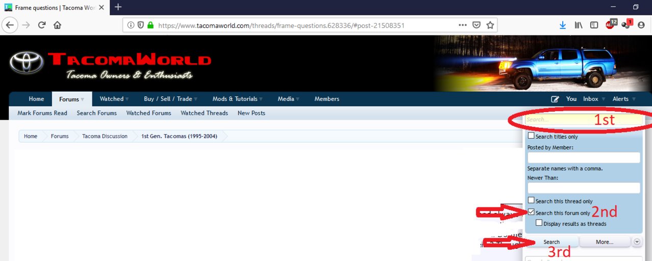

    I did not know this when I first joined.
    This would have helped me, it might help some others with searching.
    otherwise you end up searching all the forum and who really cares about anything else but first-gen/best-gen (-frame) lol

    that is very detailed for the advanced search feature!
    i just mark search this forum and titles only which sometimes needs an exact match if you have too much criteria, does not often yield the nitty gritty

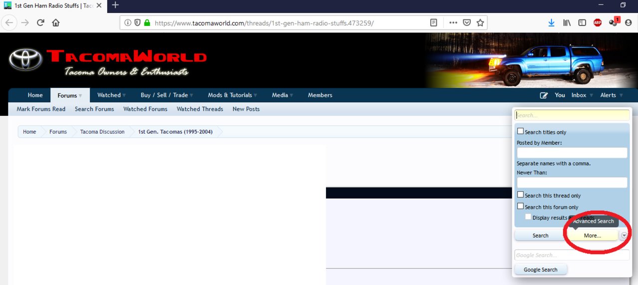

    Is this better?

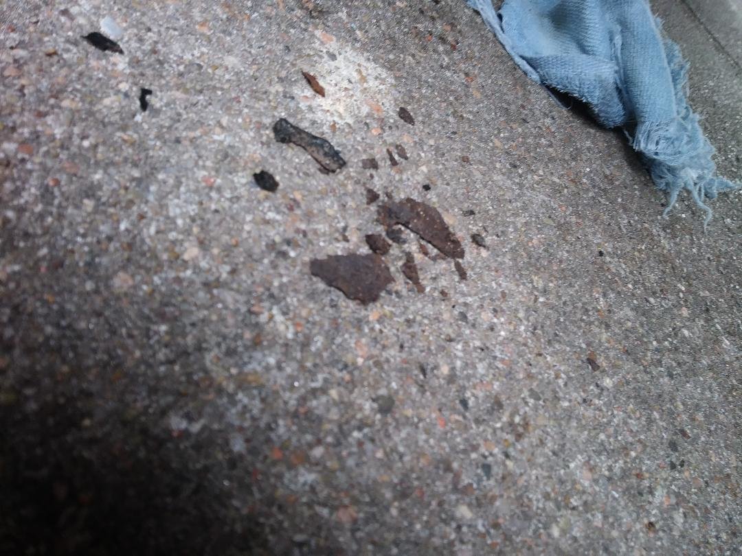

    i have many questions, i shall direct here maybe
    had my rear up on ramps and hosed from the back with highest setting on garden hose
    this defective paint stuff started accumulating down in the front and not a place to go and was plugging the front drain hole
    is my frame shot and will fall apart on the road now
    this is all my big skinny finger could muster to pull out of the bigger hole in the front on the side
    there is a large amount of this up front and will start clogging the itty bitty drain holes now and rot rot rot if i dont do something about it immediately
    can i just push this accumulation out of the front somewhere with more hosing or does a more evasive measure need to be employed
    all i felt before was sand and dirt inside until I took the hose to it! what now?

    :eek:
    Being proactive is smart!
    Me personally, I would try to get as much as I could out even if it meant drilling some more holes. Shop vac, pipe cleaner on drill, or what ever you can think of.
    then once it is completely completely dry
    https://www.youtube.com/watch?v=9HE5k5zU31I
    https://www.eastwood.com/eastwood-i...Nsk1GcMNRlIv1lgS5lI4wXvS8CWwbrexoCFq0QAvD_BwE
    When I had my bed off I welded a new rear frame section on, I ran an all thread on a drill with a small chain welded to it up the entire frame. Then I followed with a chimney sweep, then I bolted a flat iron on the end of the all thread and drug out all the debris. Then I ran a shop vac in with pvc extensions and a 90 at the end.
    I welded all the safe-t-caps on, then I drilled a hole high in the frame by the engine, before the cab, taped all the holes up and poured in https://www.amazon.com/Magnet-Paint-Co-Chassis-MPC-UCP99-04/dp/B00EP8BYNK/ref=asc_df_B00EP8BYNK/?hvadid=312061936460&hvpos=1o2&hvnetw=g&hvrand=1962155880274436956&hvpone=&hvptwo=&hvqmt=&hvdev=c&hvdvcmdl=&hvlocint=&hvlocphy=9030802&hvtargid=aud-801381245258%3Apla-570672557211&psc=1&ref=&adgrpid=63195598478
    chassis saver magnet pint with a funnel and let it cure.
    Then I used the eastwood frame coat to get the sides and the top of the inside.

    Yes, tundra, sequoia, 4runner, FJ Cruiser, all of these are just as prone to frame rust and rot. What causes frames to rust is the winter salt and chemicals. But it's not just toyota, any vehicle no matter the manufacturer will rust to shit when exposed to this crap. Then of course, the type of alloy and the quality of the steel itself play a role in how long it will take before it will rust through...
    But even the best quality of steel will end up rusting if exposed to a corrosive agent, like winter salt
    @GQ7227 I did use a small magnet attached to a string to get flakes of rust out of my frame. I pushed it as far as I could in the sqaure holes on the frame rails and I dragged it out. Did this on all holes and in both directions (left/right) until I stopped geting flakes on the magnet

    did you back it up on a ramp or hill and flush with a hose what you could to the front area?
    my new aftermarket catback exhaust/muffler is made of aircraft grade steel guaranteed to 1 million miles and is non-magnetic
    it has not seen its 1st winter yet so will have to monitor it
    i will try the magnet method, i was going to try to tape up all the holes except for the biggest one and try to use my heavy duty shopVac as a suction tool. if it siphoned two washing machines full of water it should have enough sucking power :notsure:

    no, I didn't need to put it on a ramp, there wasn't enough crap in the frame for me to do that. Unless you have big rust holes all over your frame where the water can drain out, do not put water in it, because the trapped residual water will cause your frame to rust.
    yes, a shop vac with a long flexible hose taped to its end will take care of most of the flakes when inserted into the square holes
