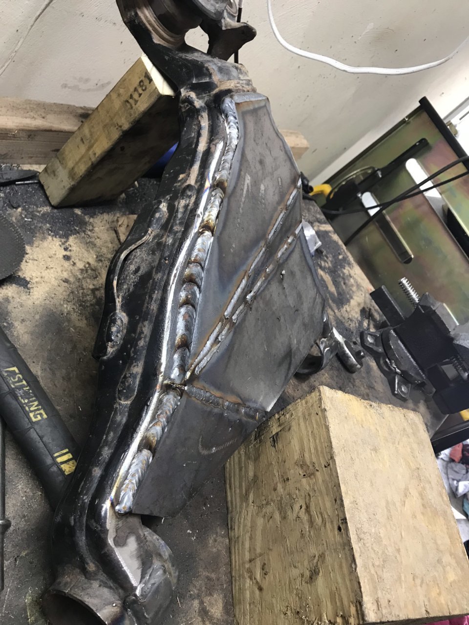

    gusseted LCAs like @EatSleepTacos

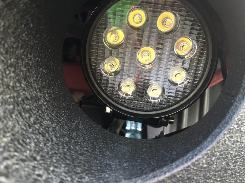

    Some updates! Last week I installed some 4" Amazon LED fog lights, as I missed having fog lights for inclement weather. Super easy to wire. Took like 5 min to solder and then it's plug and play. I aimed them way down to not blind others on the road as well.
    Output is much better than oem fog lights!

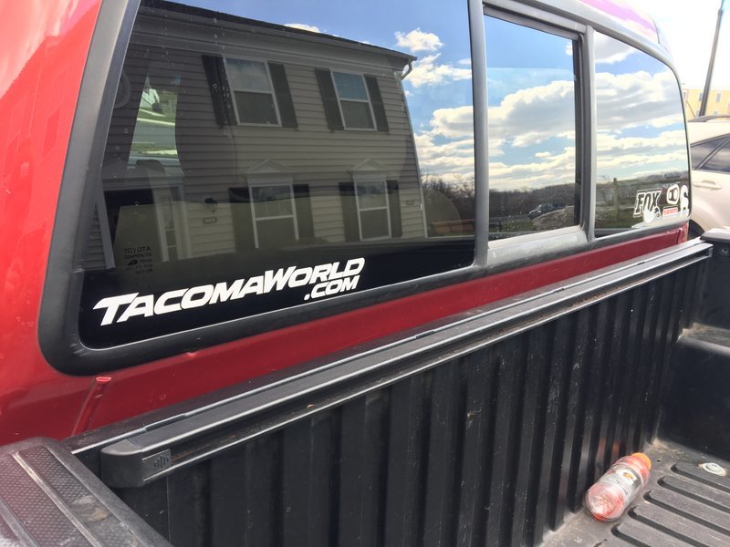

    All my parts are here except my poly bushings! So excited to get old red lifted!
    Also, posting these pics, to add bed stiffeners to the list...
    ChadsPride likes this.

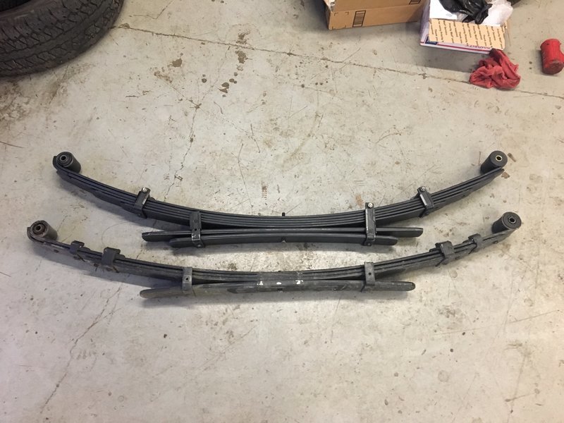

    Less than 3 hours for full install of fronts, rear dakars, U bolt flip kit, extended SS rear brake lines installed and bled, and a test drive. All thanks to @Urineovrurhead! And thanks to @Firebird for support!
    Ride report: it rides way better than stock! No alignment yet (getting one tomorrow) but it's straight as an arrow. No more sway bar but it rides about the same. I did have to turn sharp at 65 mph to avoid being hit by a work van, and it freaked me out how much it rolled, but that's about the only situation I can tell I don't have one. 886s in the front with weight are perfect and it drives so much better over everyday bumps. Dakars are with no weight in the back are not too stiff at all. Brakes feel a bit firmer but in a very good way.
    There is a slight shudder from take off at 10mph but it's hardly noticble. CB drop will take care of that!
    Overall extremely pleased with how it looks and even more pleased with how it performs. I can't wait to take it to Rausch Creek!
    All I need are bumpstops!

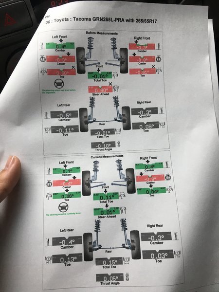

    Sliders were ordered sometime last week!
    Alignment today!
    Although the cam tab is now bent :(

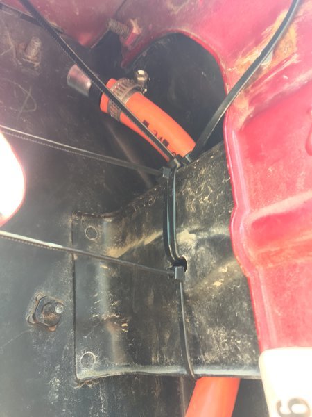

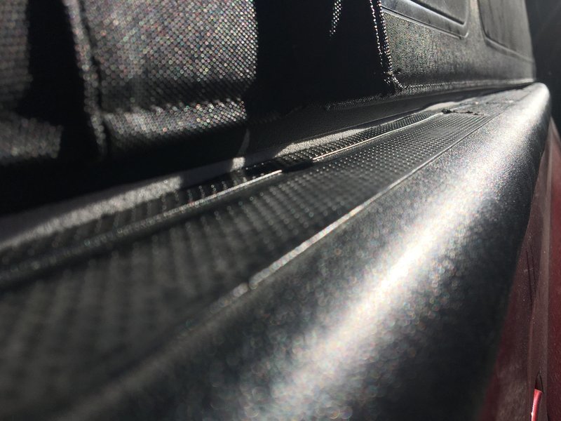

    2006 4x4 DCSB
    enough to have fun
    Rear diff breather mod
    Sealed my bestop better on the sides
