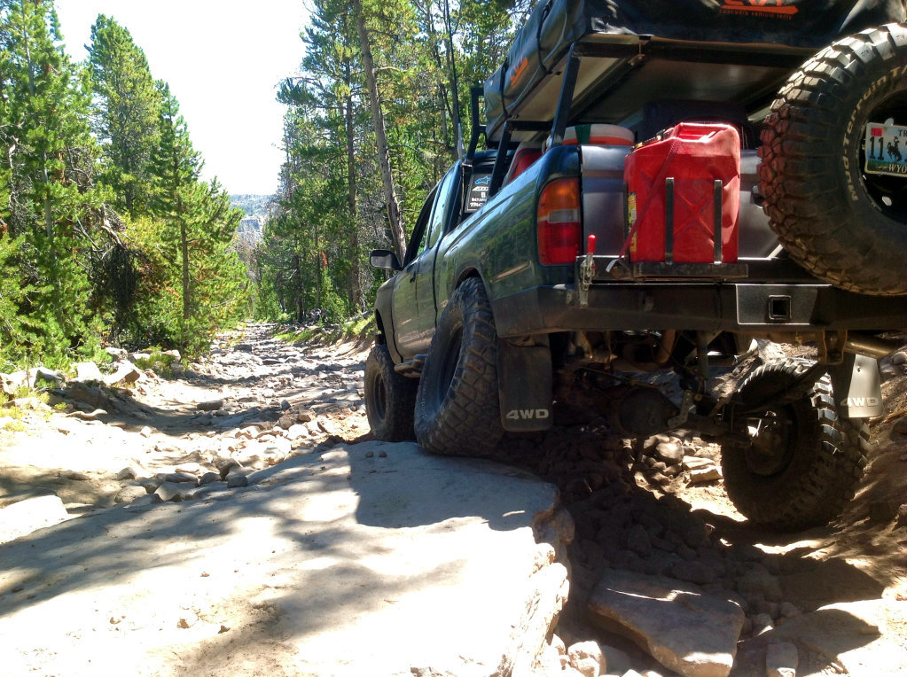

    Hello and thanks for lookin at my build! :D

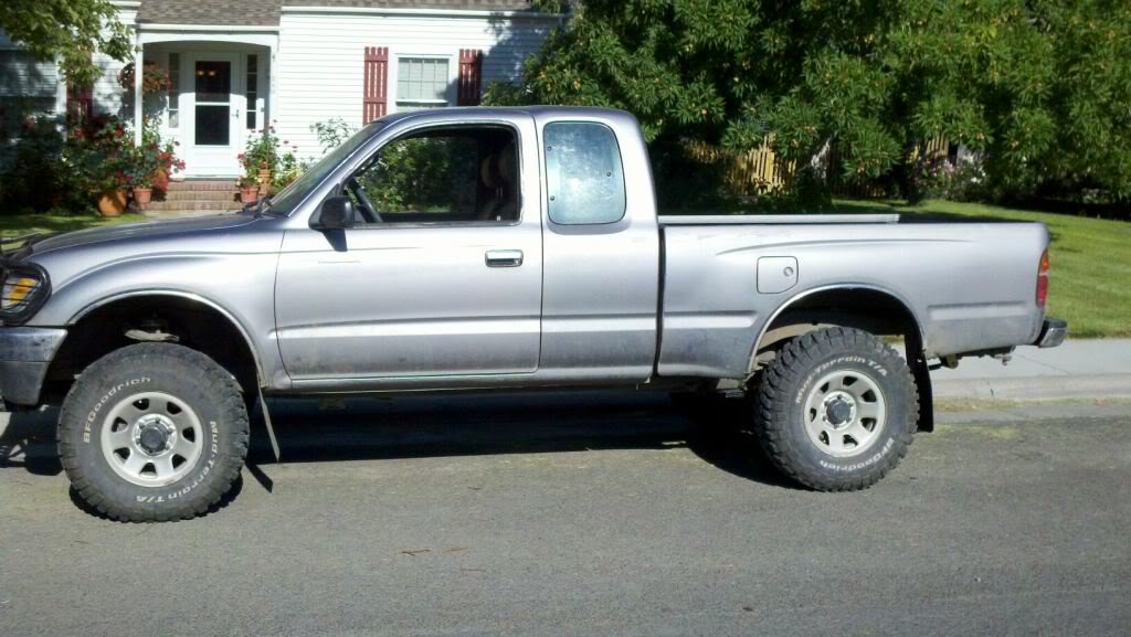

    How it currently sits:
    [​IMG]Family 4th Camping-69.jpg by Monte Nickles Photos, on Flickr
    [​IMG]Family 4th Camping-71.jpg by Monte Nickles Photos, on Flickr

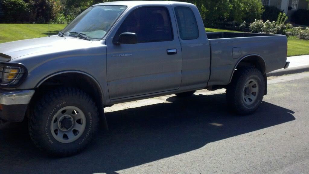

    My truck is a 96 4x4 v6 5 spd Tacoma and has been dubbed Frankenstein. Why? well..because most of the parts on it are not original. And by the time Im done with it, hardly anything will. I rolled the truck in May 2012 while at the Taco Take Over meet. Was a great meet..besides the roll over and my hand breakin. But you should go!
    anyways, i did't have full coverage on insurance and didn't have any money for a new truck. I found a 2wd 1996 body for 500 bucks in ID and bought it and swapped it onto my 4wd frame and drive line over the period of the next 2 months. That is why you'll see some of the earlier pictures of my build are the awesome cool metallic silver, and why now its the dark green. Hope to repaint it one day maybe.
    Anyways, that is why this thread is like 2 builds in one. Pre roll over, and post roll over. The first 45 pages or so are pre roll and 45 and beyond on post roll over.
    I have gone through and tired my best to reorganize this post so everything should be linked. This thread is much longer and filled with lots of info and BS haha i have done my best to try and help you find specific things in my build for you. But please. Don't hesitate to flat out ask. I love how open this thread is about people asking questions and it doesn't even have to be related to my truck. We will help you!
    Basically if its blue..its click able and will take you to a specific post in this thread or other where i have done write ups or how to's and trip reports.
    Mods:

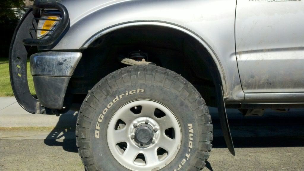

    Suspension History:
    • 1st Setup: Click me to go to post of Install
      • Front:
        • 5100 set at 0''
        • 620lb 3'' Eibach coils form Toytech
      • Rear:
        • Wheelers Alcan 5 packs
        • Toytech 1'' Lift shackles
        • 8.5'' 5150s
    Total lift: 3.5'' Front, 3'' or so out back. Tires are 31x10.5r15 BFG KM2s

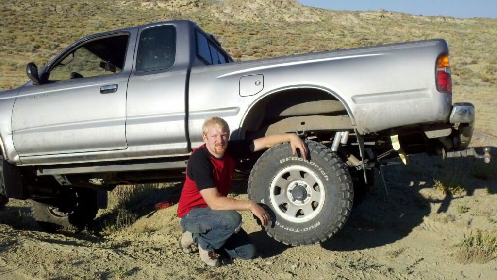

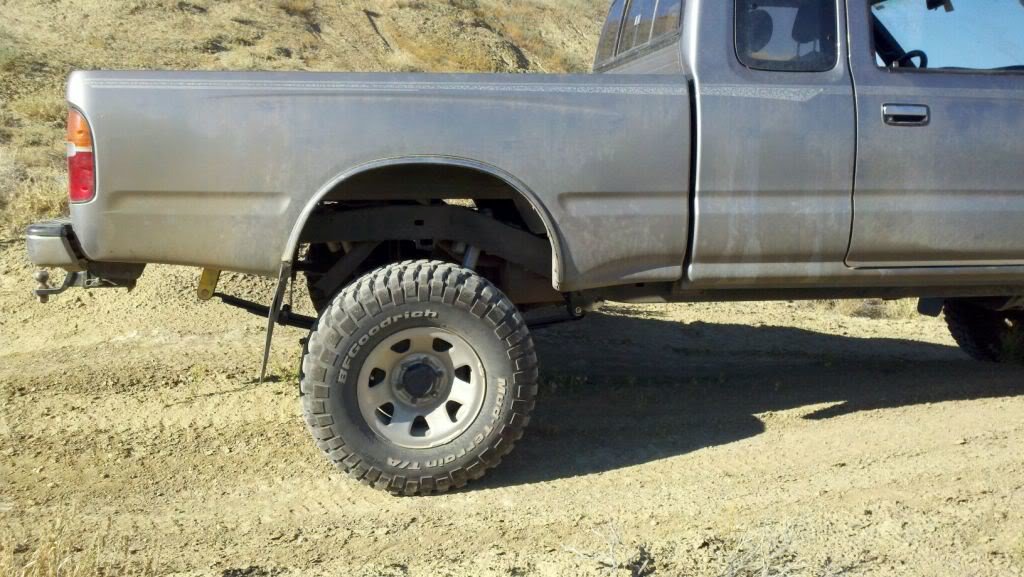

    • 3rd Setup:
      • Front: Same as Setup #1
      • Rear: Frankenstein Leafs! This took several attempts to find a combination I liked.
      • 1st attempt HERE
      • Final setup: HERE
        • Wheelers 5 packs
        • Wheelers AAL
        • One Addition leaf from a SkyJacker Leaf pack
        • Toytech 1'' Lift Shackles
        • 10'' 5150s

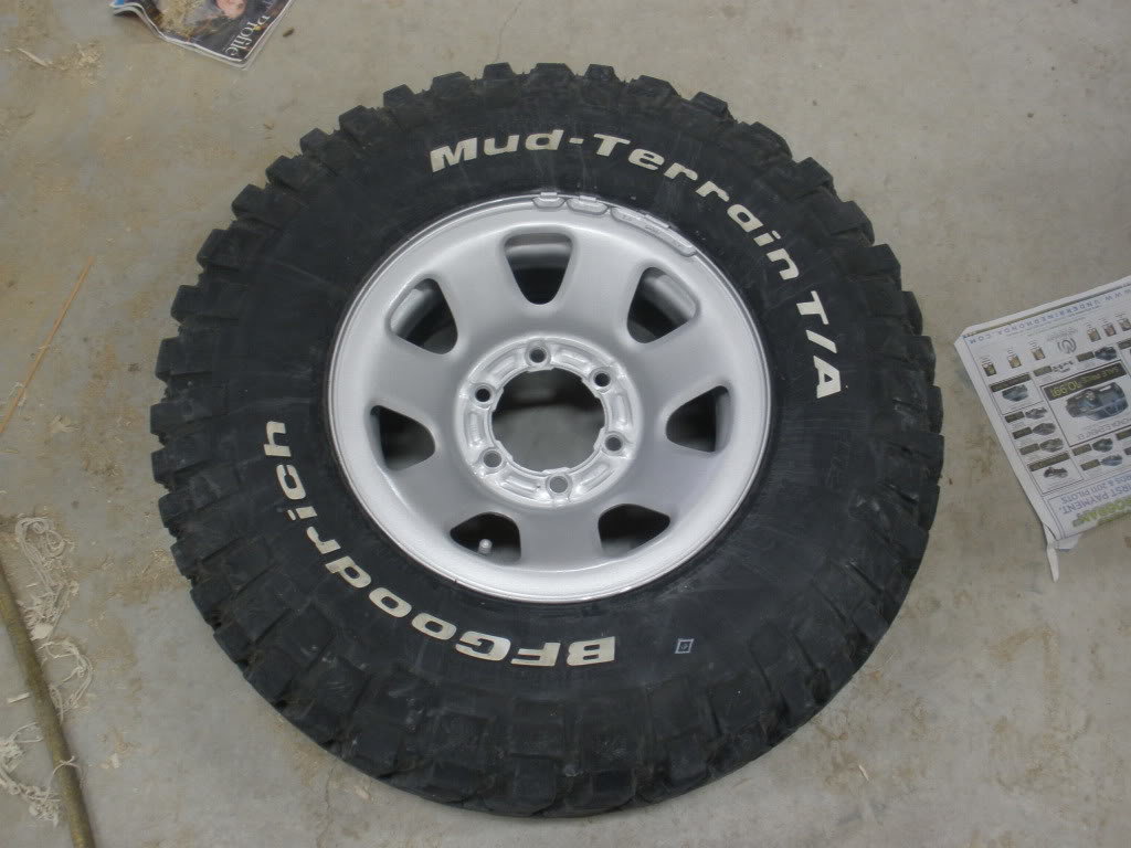

    Wheel and Tire history
    • 1st Setup:
      • Stock 15'' rims. Repainted Silver. Write on how to repaint HERE
      • 31x10.5r15 BFG KM2 Mud terrains
    • 2nd Setup:
      • Same as 1st BUT added Allpro 1.5'' spacers and extended front lug nuts. Install HERE
    • 3rd Setup: Install HERE
      • Wheelers Type B 15'' wheels. 4'' Backspacing
      • 33x12.5R15 BFG KM2 Mud terrains. Pictures HERE
      • Eventually added the 1.5'' spacers again to keep tires off frame. Plus..looked bad ass. Stripped the fender chrome too. Pictures(pinch weld mod here too) HERE and HERE

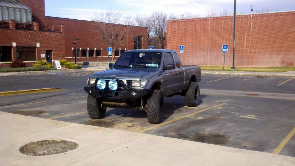

    Armor:
    • Front Bumper:
      • Elite Offroad Custom Bumper! 3/16 and ¼'' plate steel. Half guard option, Fog light option, Custom TACOMA cutout option. Install pics HERE and HERE...pics of it all over after this point really..
      • Had to repair the bumper later after bending it. Used ¼'' Boiler plate to reinforce it.
      • Also relocated the blinker lights as bumper gets rid of stock location. Did a write up on the FREE Blinker Relocation MOD HERE
    • Rear Bumper:
      • Elite Offroad Custom Rear Bumper! 3/16'' and ¼'' plate steel. Custom made Swing out by Tim. This bumper under went several work overs by myself to add new features and a better latch.

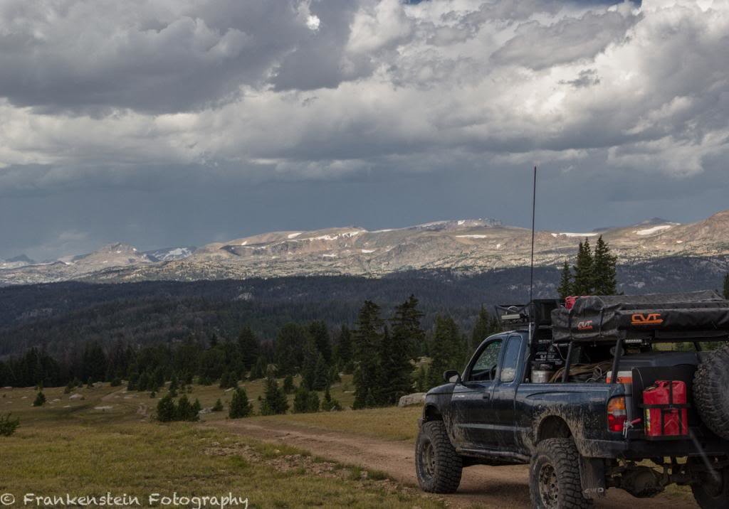

    As it sits now after the rebuild!

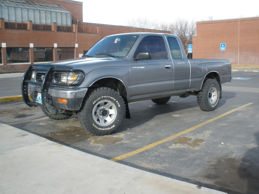

    Old body, it shall be missed..
    315064_749694920408_219704646_36719073_1_4bd4433933fe2bdc0e69d063b1a9a1f52a0bdd25.jpg
    This is what she looked like when i bought her.
    6768_1025757304639_1846480219_56057_1178_137b3fa24ae04f903df6c905f782281e4cd37f57.jpg
    6768_1025759104684_1846480219_56063_5153_91c4792711905e61340c8aec5fc5ddc81e6147a8.jpg

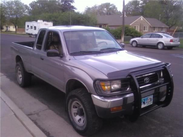

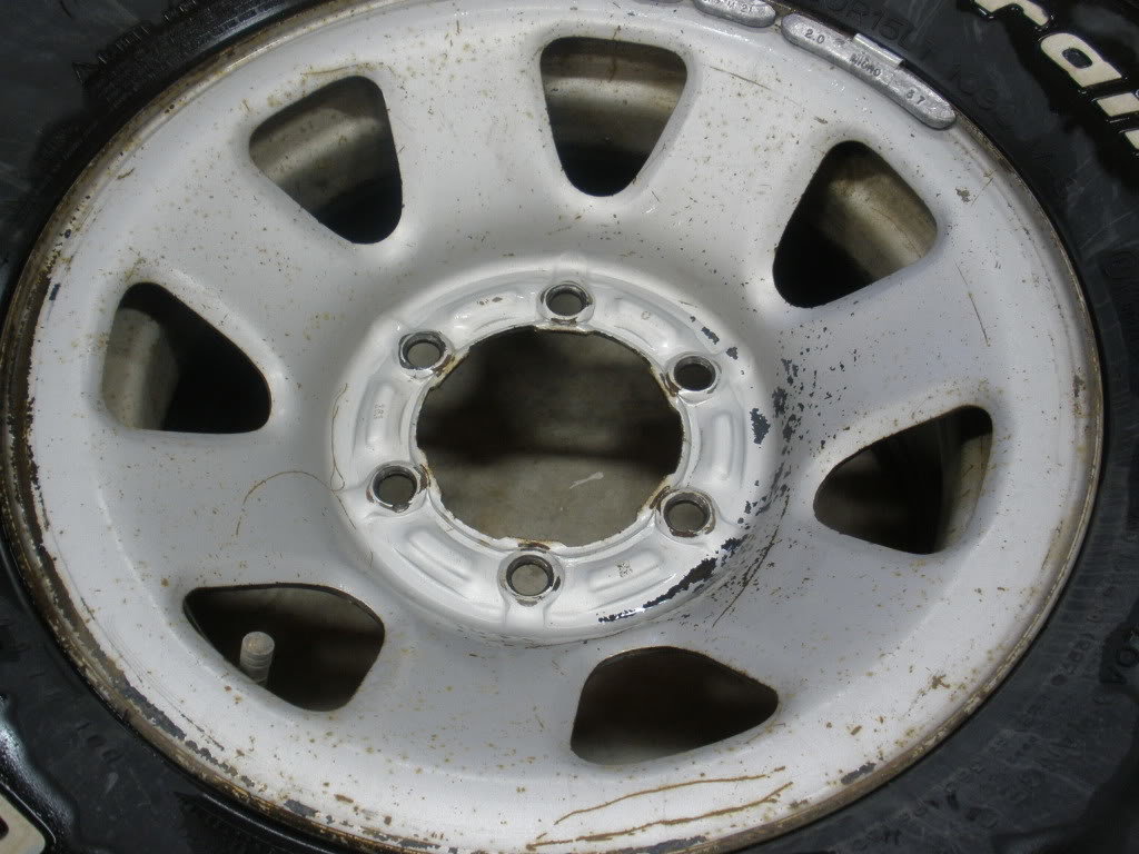

    Rims and tires where crap so they got replaced first
    cleaned up all the rims. Painted em myself :) look amazing when clean. Also got some mighty KM2 tires. 31X10.5
    Really changed how my truck looked!

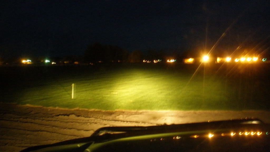

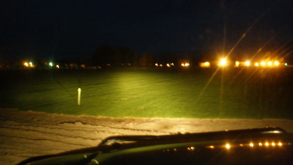

    Just put on two of my four Hella 500ffs converted to HID. They are 55w, two are 4300k and two are 6000k. My silly bull bar had two places for light on it already but i think i might drill all new holes to fit all 4 lights i think...idk about that yet.

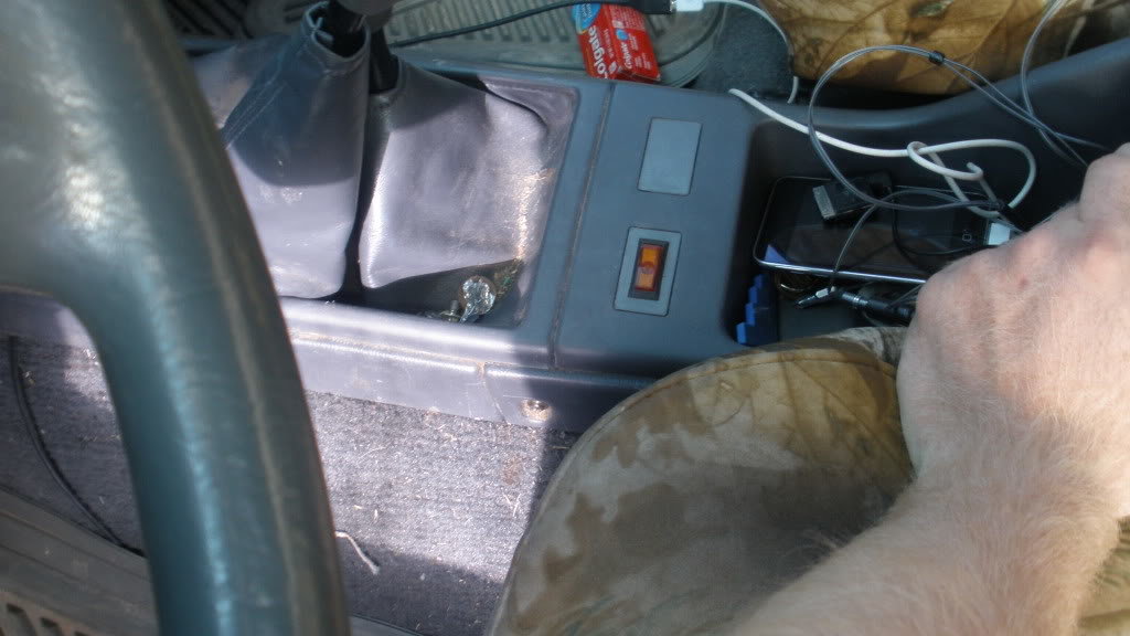

    here is my switch location. I tell ya, that was a PITA to make that hole for the switch in that plastic plug. But turned out great.
    And the lights
    Low beams(stock)
    high beams (stock)
    Hellas!!

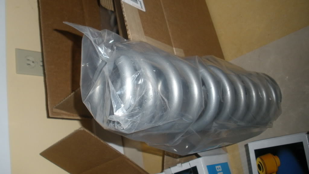

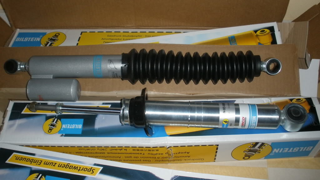

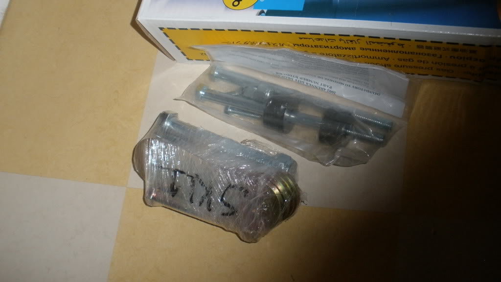

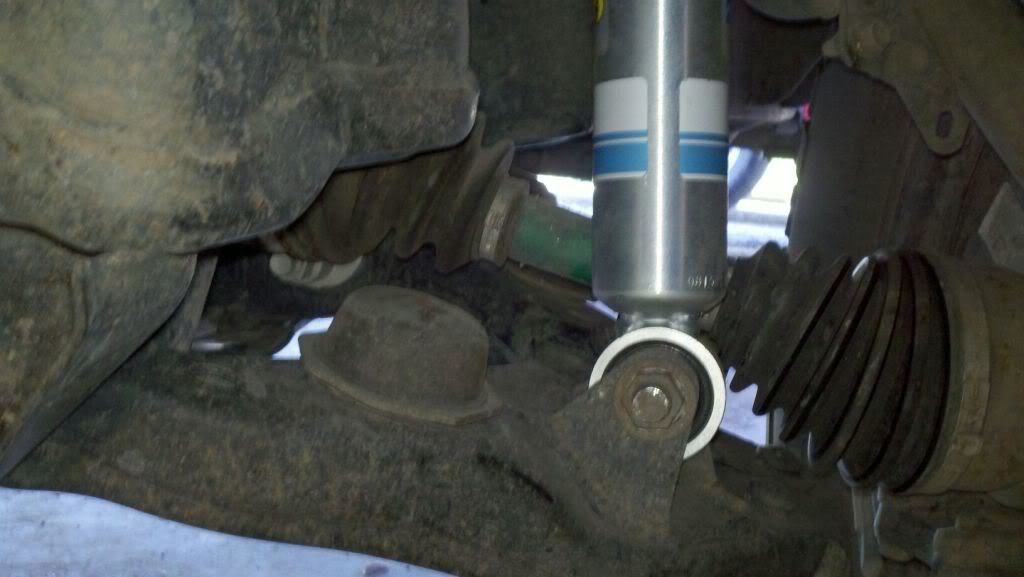

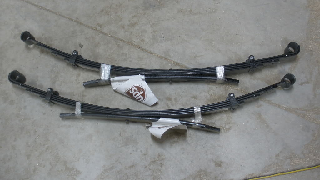

    Woot new parts! Can't wait to install this weekend!
    Billys
    Eibachs :)
    Shackles and diff drop
    And the leafs :)

    and socar i didn't do a write up really on the lights. However i have to install a second relay and switch anyways so i will be sure to do a mini write up then of how i put the switch in. I can tell you now that it was a big PIA but well worth it IMO :)
  7. Jul 28, 2011 at 9:33 AM
    scocar
    scocar Patron of the Farts
    Nov 11, 2009
    #25814
    40,176

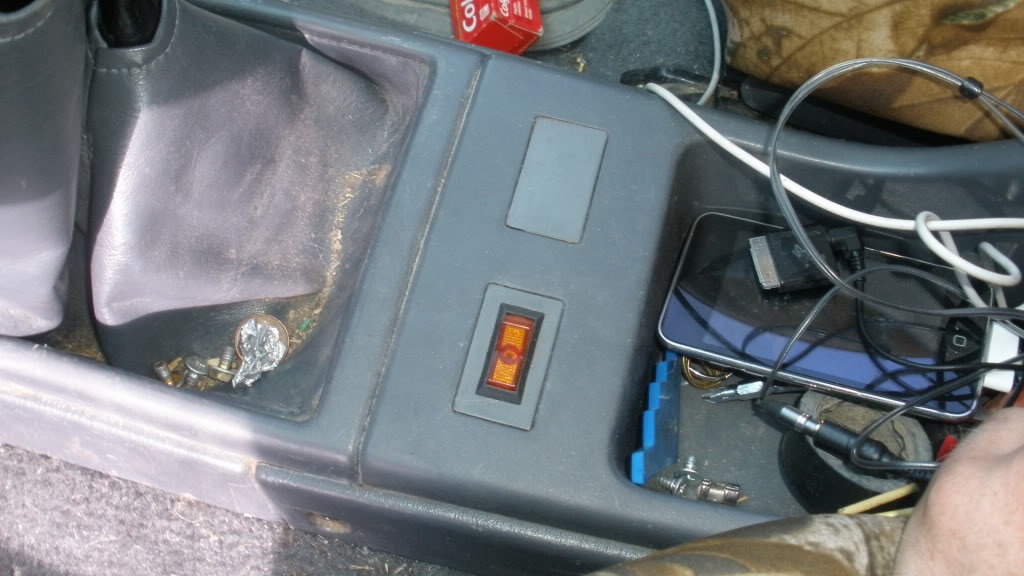

    No, I wanted a write-up on the pile of crap in your console! :D

    ohhhh well that my friend is very excruciating mod. That takes Years of mowing lawns and camping and hard work to get it JUUUUUSSTTT right :cool:

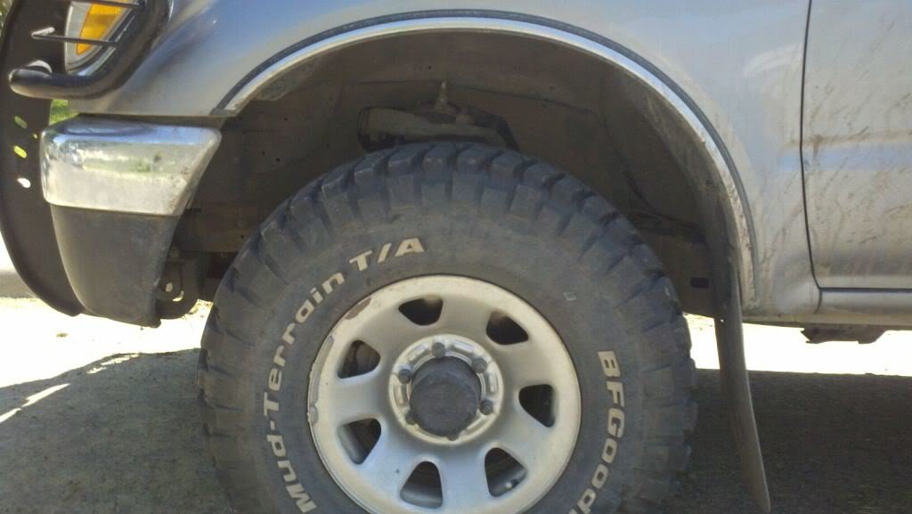

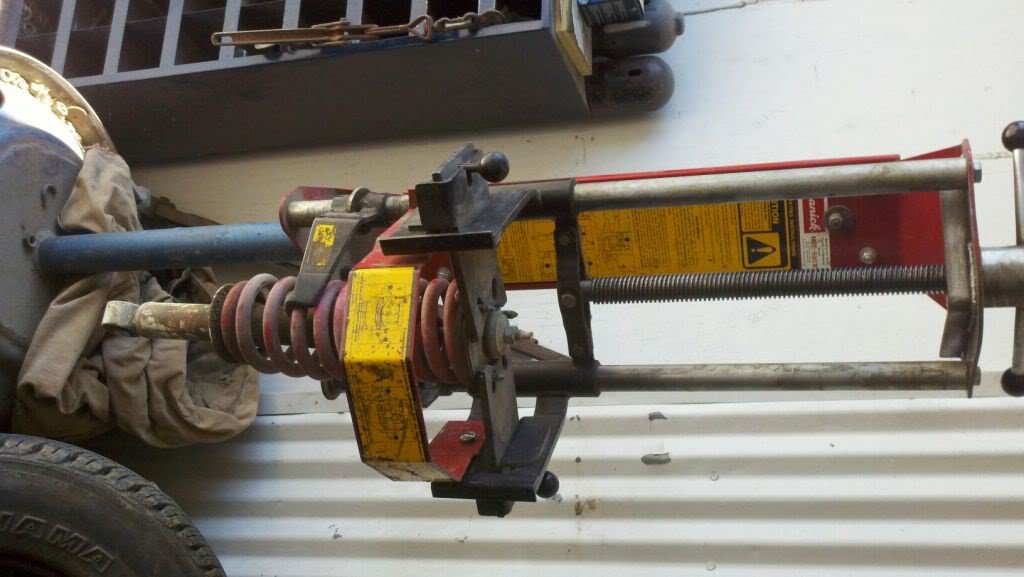

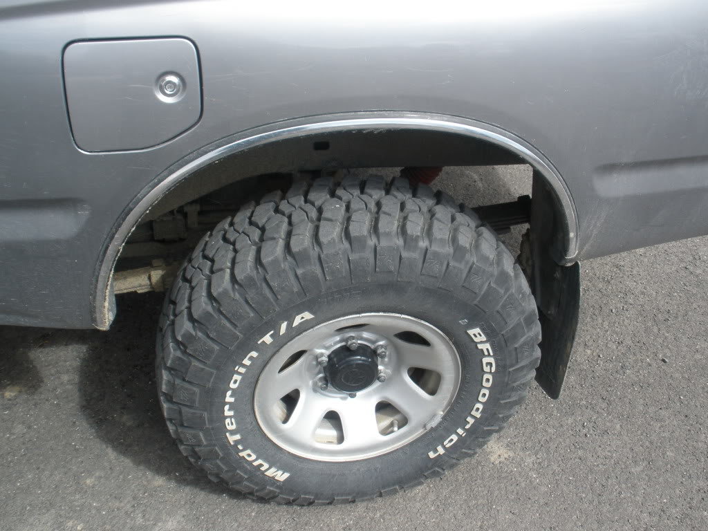

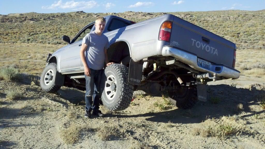

    Got it all installed! Even got my dads 2008 old Ubolts which were pretty much new. Got to use a coil compressor at a tire shop for free too :D I must say i was kinda disapointed in the lift the leaf packs gave with the shock shackles, so i ended up using my Toyotec 1.5'' shackles. Here are all the pics!....now i need bigger tires...
    Before:
    Resampled_2011-07-29_11-24-57_839_ed9b07d0a6f7f6acc519b19a7fbfa868a171ffe8.jpgResampled_2011-07-29_11-25-09_218_ae87c8aec4826eaa6d684500343901dcaf6ab076.jpg
    Ring compressor
    Before diff drop
    after diff drop
    Ubolts 5pks and 5150s!
    Aftermath!
    Took her for a spin :p nice flexin....think i shouldve maybe gotten longer shocks tho...but maybe not

    nice, it looks good IMO, What lenght 5150's did you end up with?
  11. Aug 1, 2011 at 1:50 PM
    Blackdawg
    Blackdawg [OP] Dr. Frankenstein
    Dec 31, 2010
    #48500
    81,652
    Monte
    Wyoming/St. Louis
    The Trifecta of Taco's
    i went with 8.5s....but now i wish i had gotten longer. I am gonna need longer ones as ill prolly get the Wheelers AAL that they have for their packs. The rear is just a tiny bit lower then the front and id rather have a high rear then a lower one. Dan said id get about 1-1.5'' of lift from the AAL unloaded. So i think ill need the longer brake cable after that(i defiantly don need it now, have plenty of slack) and ill prolly get longer shocks too. so if ya want these, ill be selling em soon me thinks :p lol

    ah yea, i kinda wish i had gotten expos now..cheaper and get tons of lift. But i think JLee is running the 10'' ones...i think..not sure. He also has much bigger bump stops too.
    Edit:Yea man JLee has the 10.5'' shocks with the Expo packs. He also has them custom mounted different then stock. And has drop shackles so he has like 4-5'' of lift in the rear.
    You can always install the packs then do the measure test to figure out what would work best for you.

    Still..sometimes i wonder why i went for $459 5pks(soon to be 529 6 pks) when the all pros Expos are 349...*sigh* oh well..thats what i get for not shopping long enough haha i got mine in the Wheelers GB.

    :woot: yay AAL from Wheelers ordered!! I also realized today that i put on the leaf packs on the wrong sides:facepalm:So i am going to fix that when the AAL comes :p
